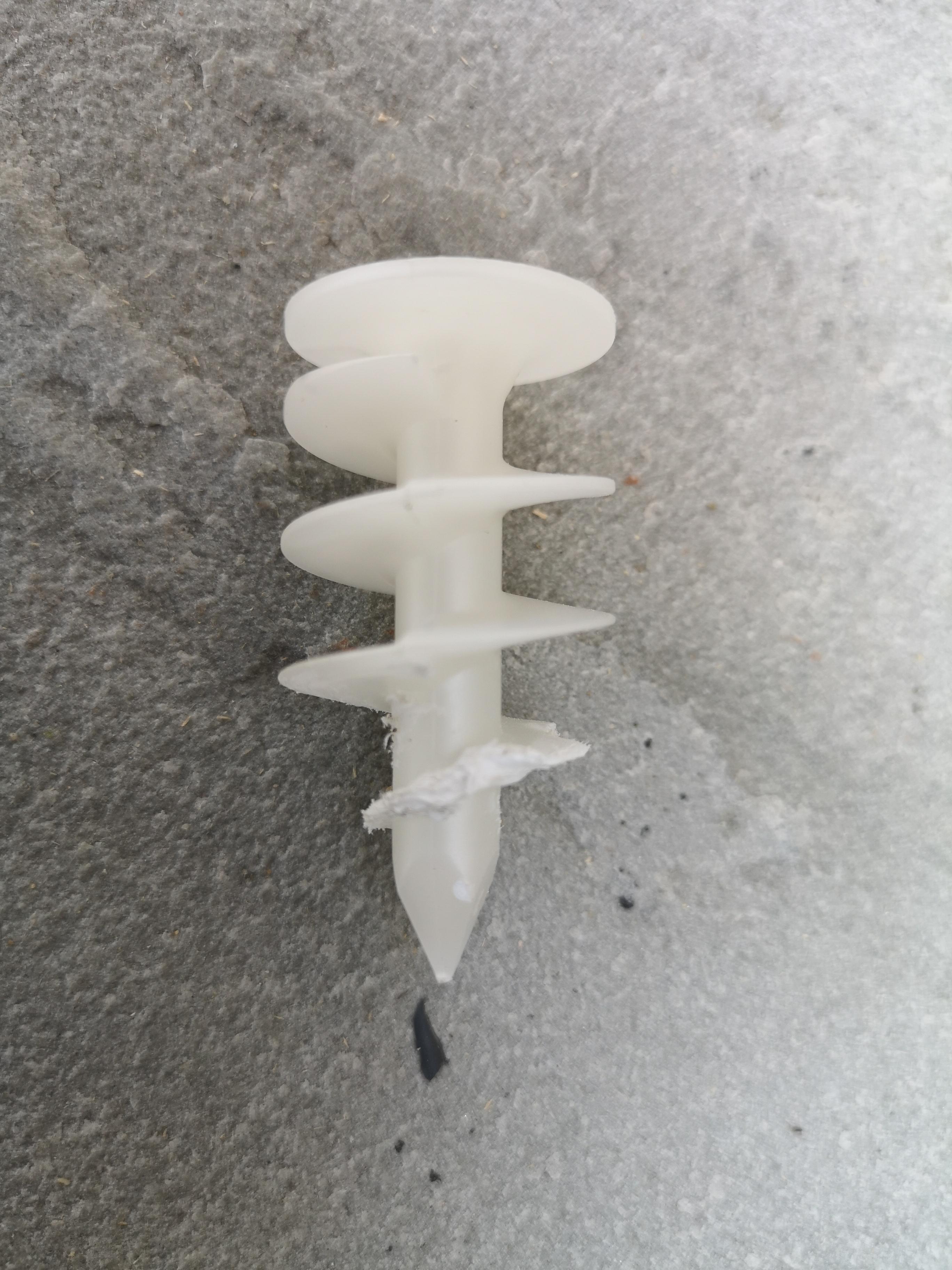

  1. Anyone have any experience using these fixings in EWI? They are designed for exactly that, but i cannot get them to screw in thru the render. Apparently, predrilling shouldn't be necesssary with thin-render systems, but, even after predelling a 9.5mm hole, the render just eats the plastic spiral - see photo. For info., the (silicone)render should be 1.5mm thick.
