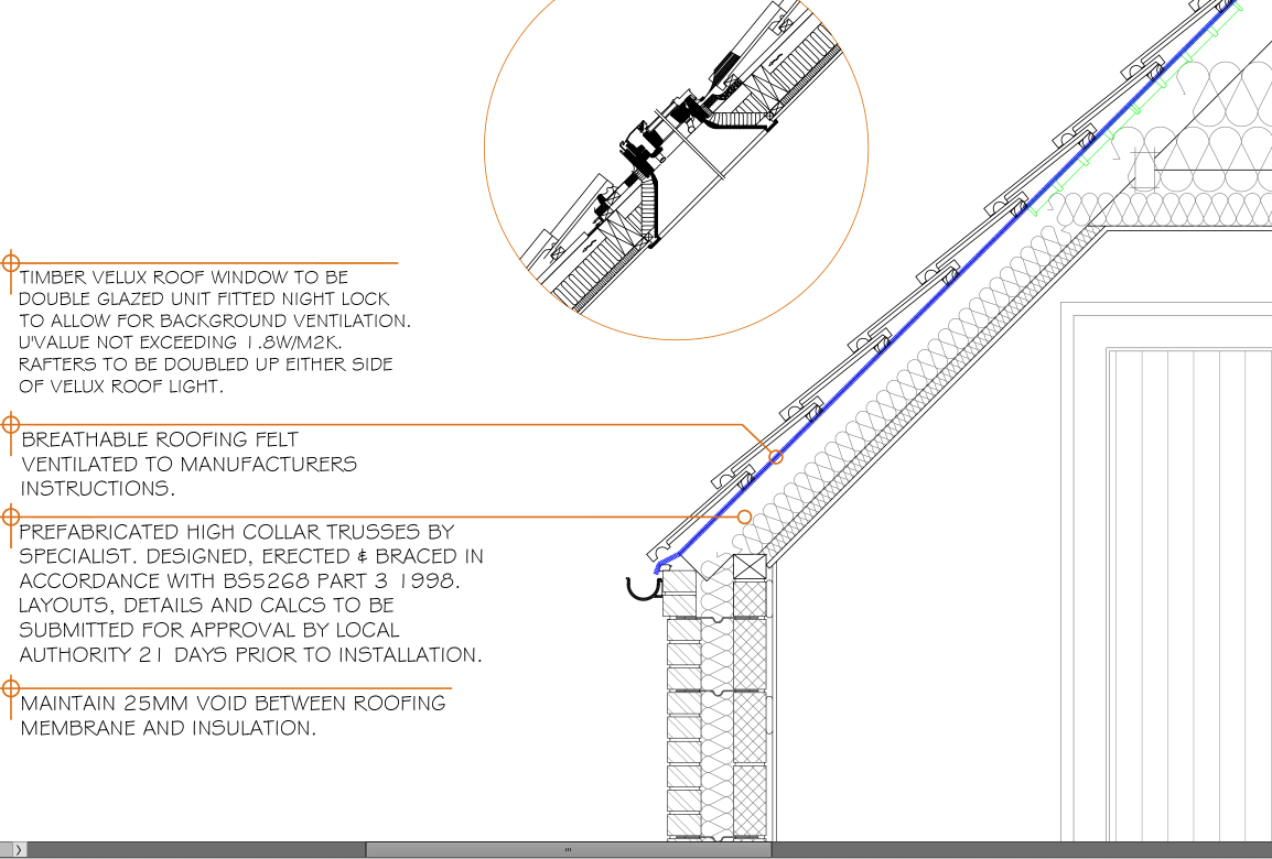

  19. Hi Moonshine, The building spec shows 25mm minimum gap. I've attached a screen shot for you to see
  20. Hi All, My building reg drawings for a new self build, show a pitch roof being insulated with 90mm Kingspan between rafters and 40mm Kingspan with plasterboard to achieve a U-Value of .18w/m2k My plasterer has specified 100mm Xtratherm between rafters and 50mm Xtratherm with plasterboard Would anyone be able to answer my questions? Will I achieve the same U-value? Could there be an issue between the rafters with the xtra depth? I have also noted that 32.5mm Kooltherm 118 is specced around a roof lantern but the plasterer has specced Gyproc thermaline 30mm basic. Any thoughts on this? Thank you
