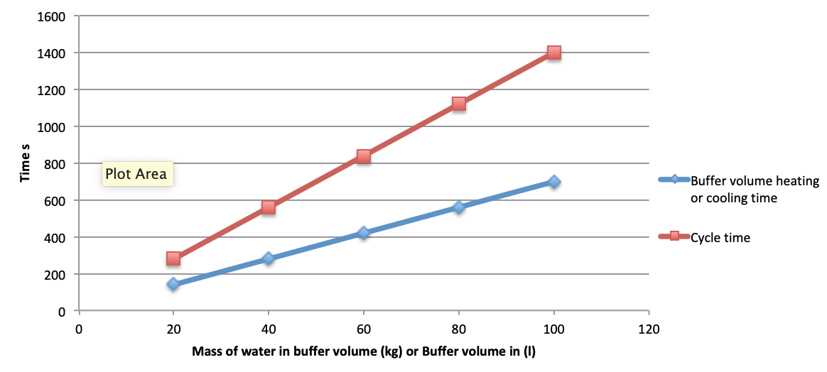

Sounds good, at the very least it will be a good idea to confirm the problem and give an indication of how much additional volume/heat loss will impact the cycling. I was assuming that when operating the underfloor heating only (most of the day) I'd need to close the TRVs on the majority of radiators (instead of the overall radiator zone valve as current) in order to avoid upstairs being heated when it's not required then open them again when heating upstairs is called for again. Not sure how a standard £10 thermostatic valve will do that or am I missing something? @DamonHD's Radbot seems to be able to achieve something similar, instead of me telling the system when I'm not going to be upstairs Radbot would automatically detect that I'm not there but it's a similar cost to other smart TRVs (£50). Anyone have any guidance on an acceptable boiler cycling frequency? Assume that's going to determine how many radiators I'd need to run with the underfloor heating or the size of a buffer tank. -

Radiator circuit open option does sound like the easiest option. How would you close all other radiators so that you only get flow through the one? Smart thermostatic valves on all other radiators? My initial thoughts were that it seems a wasteful to dump the extra heat being produced by the boiler into rooms that are unlikely to need it. I'm sure there are significant limitations however I had a shot at initial buffer tank volume calcs using a similar method to @Temp. Underfloor heating buffer tank initial calcs.xlsx -

Thanks for the thoughts guys. @Temp Yes the UFH works well otherwise, when the radiators are running as well and there's a consistent feed of hot flow to the UFH manifold it heats up reasonably quickly. I agree with @Nickfromwales derating the boiler for UFH operation only (if it could be done) would limit direct hot water and potentially operation with both the radiators and the underfloor heating. Seems that there aren't any nice quick fixes with setting changes (damn!) which still confuses me given that most UFH installers treat this as a standard setup. As @Temp has suggested next steps are to select a buffer tank configuration and size it to see if it can be fitted anywhere in the house or whether there's still potential to draw through the highflows internal tank. Can anyone help with this or suggest a company that would be good to contact? I haven't found any companies who are proposing thermal stores for this particular application. I got as far as looking to confirm the min power of the boiler and compare it with the power requirement from the UFH. From gas usage and the boiler display it gets down to around 11 kW during one of it's short on periods. Heated floor area is approximately 60m2 by 4 ~90m loops typically operating with 40C in and ~30C out. Multiplying the floor area by an approx heat requirement of 0.1kW/m2 gives a power requirement of ~6kW. As another wild card are there any tricks that can be used with a low loss manifold? -

@ProDave That's where my head is going at the moment but there seem to be a lot of systems without them working fine. @Temp The mixer in the manifold is set to 40C in order to limit the temperature in the engineered wood flooring. I agree that increasing this will help the cycling and should be able to get away with a slight increase but probably not a lot. Wood suppliers advised a wood surface temperature of <=27C which we get close to if it's run for a while. The UFH manifold is a JK Basic (see link below) with a max temp pump cutout at 55C. FYI they have a clever router that cut the UFH channels in the existing screed without raising the floor height. https://www.jk-gb.com/downloads/jk-quick-start-manual.pdf -
