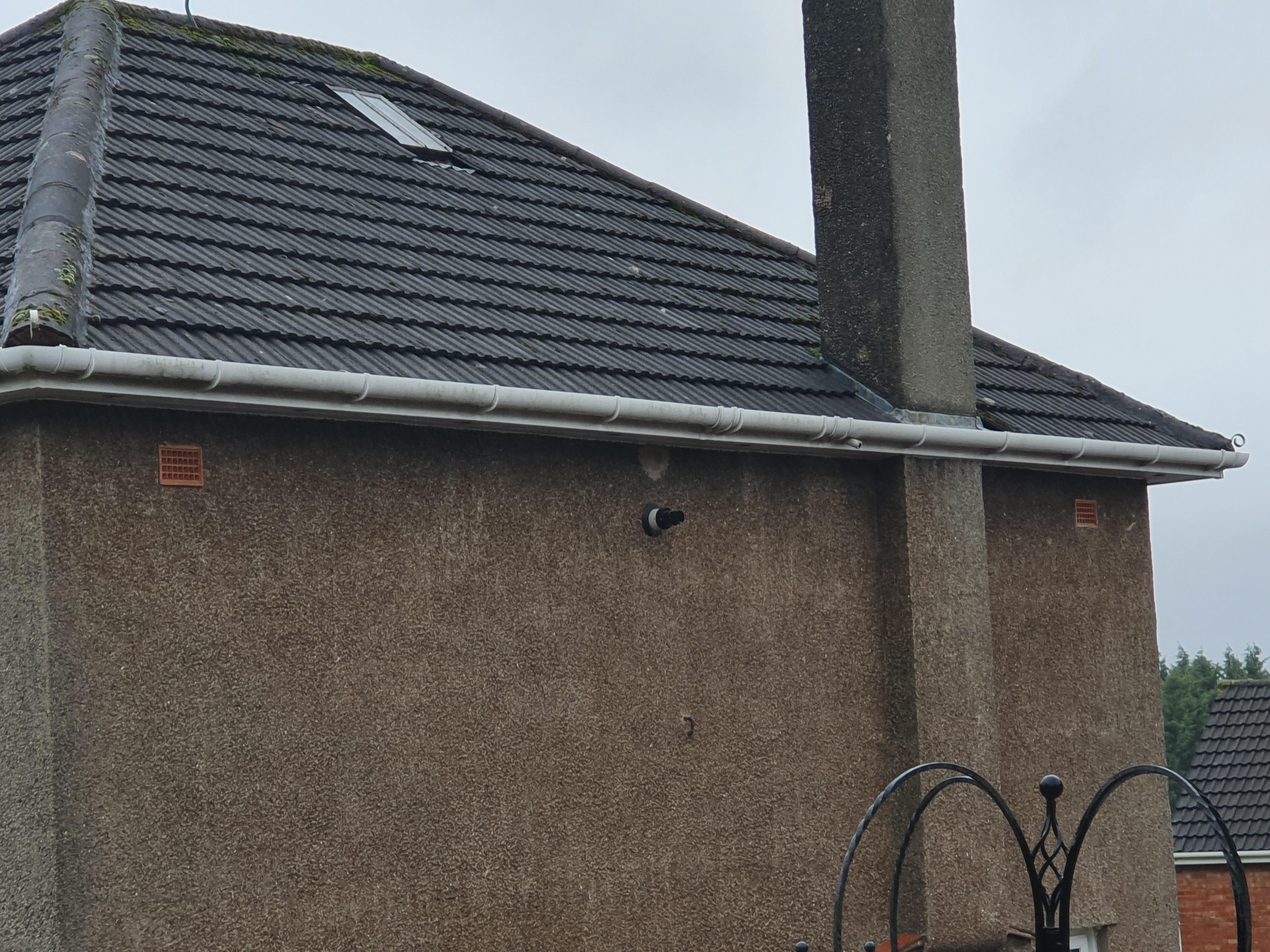

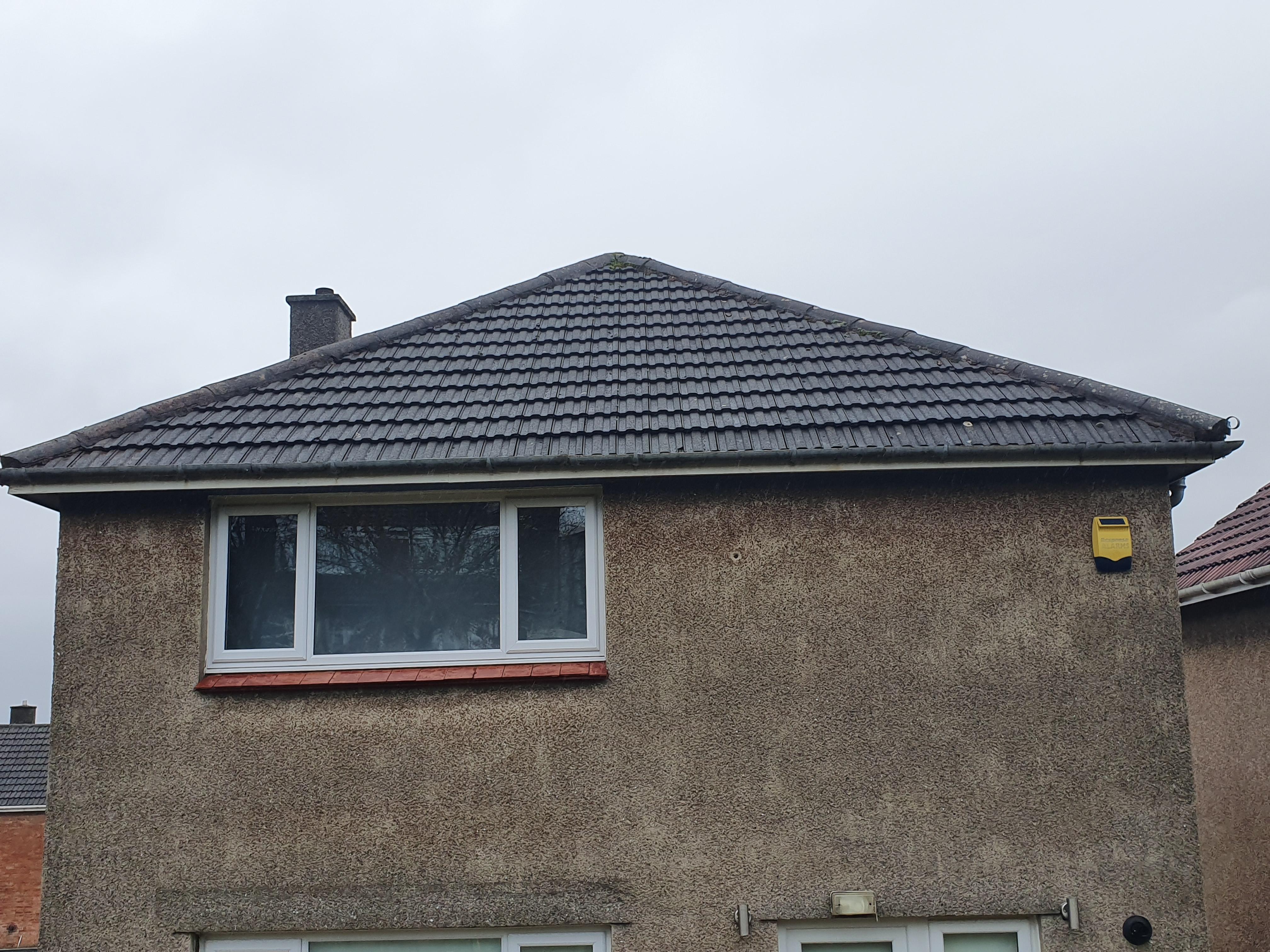

  1. Just to update this in the slim chance anyone has the same issue in the future. I finally worked out the issue. The builder who built my house initially George Wimpey who built similar estates nationwide generally at that time tiled using ludlow majors. My house which is an unusual style that wimpey stopped making in the 60s they used ludlow plus. The tiles look identical other than size! Theres nearly 16 ludlow plus per m2 compared with 10 ludlow majors. My neighbours house which is a different house style despite being built at the same time has ludlow majors. So my roof is around 75m2. Least the roofing costs will be more reasonable.

  4. My roof doesn't have osb sheeting, its like old style silver foiled gyproc. Its starting to blow in and I think it would break up quite easily. I think around here they use osb3 and tyvec. I had sent the 2 pics in my initial post to my local tile shop, they told me 1096 tiles but having counted them myself I can see they were a little short or perhaps they were using the offcuts at the ridges for the other side. Anyway for battons they had said I need the following: 3 roll membrane breathable 240 lin mt 38 x 19 counter 380 lin mt tile batt A roofer had told me I only had 76m2 of tiles but I guess he's way off. The reason the m2 is important to me is a company quite near me are advertising a reroof on a detached house of upto 80m2 for £4480 inc skips and scaffold. I was trying to see if id be better using them or using a couple of roofers I know with me supplying the materials.

  6. Ok so there is 1300 tiles, 48 third round ridges and 6 seg ridges. Seems a lot for a 3 bed house. Not sure how many m2 that is but thought it was normally 10 per m2.

  11. Hi all Looking for some help working out how many m2 of tiles I need for my roof. It's a rectangular shaped hip roof and I have attached a picture of both the side view and the rear face. The front face is a mirror image of the back and both sides mirror each other. The length of the roof including the soffit is 9250mm and the width inc soffit is 7160mm. The ridge length internally at the peak is 2100mm and height internally is 2150mm. I have tried to work out the square meters but have came up with different advice on how to measure on different sites, would rather a roofer gave me a ball park quantity idea. Also I think the existing tiles are Ludlow majors could anyone confirm that? Thanks
