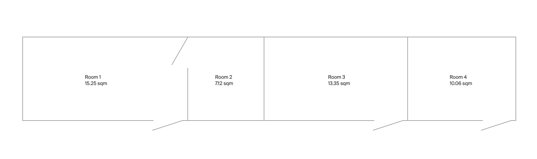

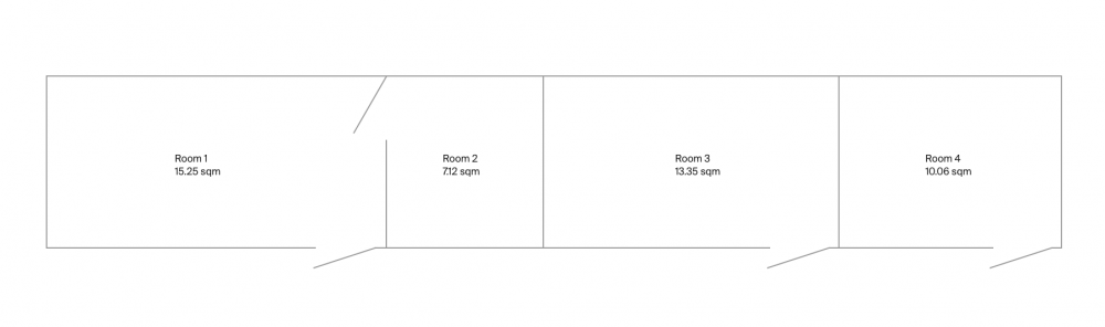

We are renovating some old outbuildings to be used for workshop / home-office spaces. It's a primitive (120+ years old) single storey, long and slim brick building separated into 4 rooms (see plan attached), and it's just been re-roofed. We'll be insulating and replacing old doors and windows and it needs to be up to standard in terms of comfort and heating as we'll be working from these spaces over winter (and potentially using them as ancillary living accommodation in future). I wasn't sure which of the sub-forums to post this in, as I don't know what the best option is in terms of heating (this is the question...) We have: • Electricity supply to the building • No gas • No boiler in the building • Large ongoing supply of firewood from the woodland on site. They are small rooms (approx 2.5 to 3m ceiling height), and given firewood is available, we wondered if a wood burner can be channelled to heat up all rooms – maybe via a back boiler? The floors in Rooms 3 and 4 are both stone flagged (cold earth beneath) so will be insulating under there whichever route we take. Room 2 is concreted (presumably over stone flags / earth) and Room 1 is flagged on I-beams with a cellar beneath. Other thoughts included UFH for Rooms 3 and 4. But I've a feeling there will be someone on here with a better insight and more experience of heating a space like this. We have some constraints (no boiler, no gas) but being a small space, with a well insulated roof and (eventually) walls / decent spec doors and windows, hoping there are a few options available... As ever, many thanks in advance for any thoughts. And apologies if this should have been posted elsewhere (couldn't find a more general heating forum)

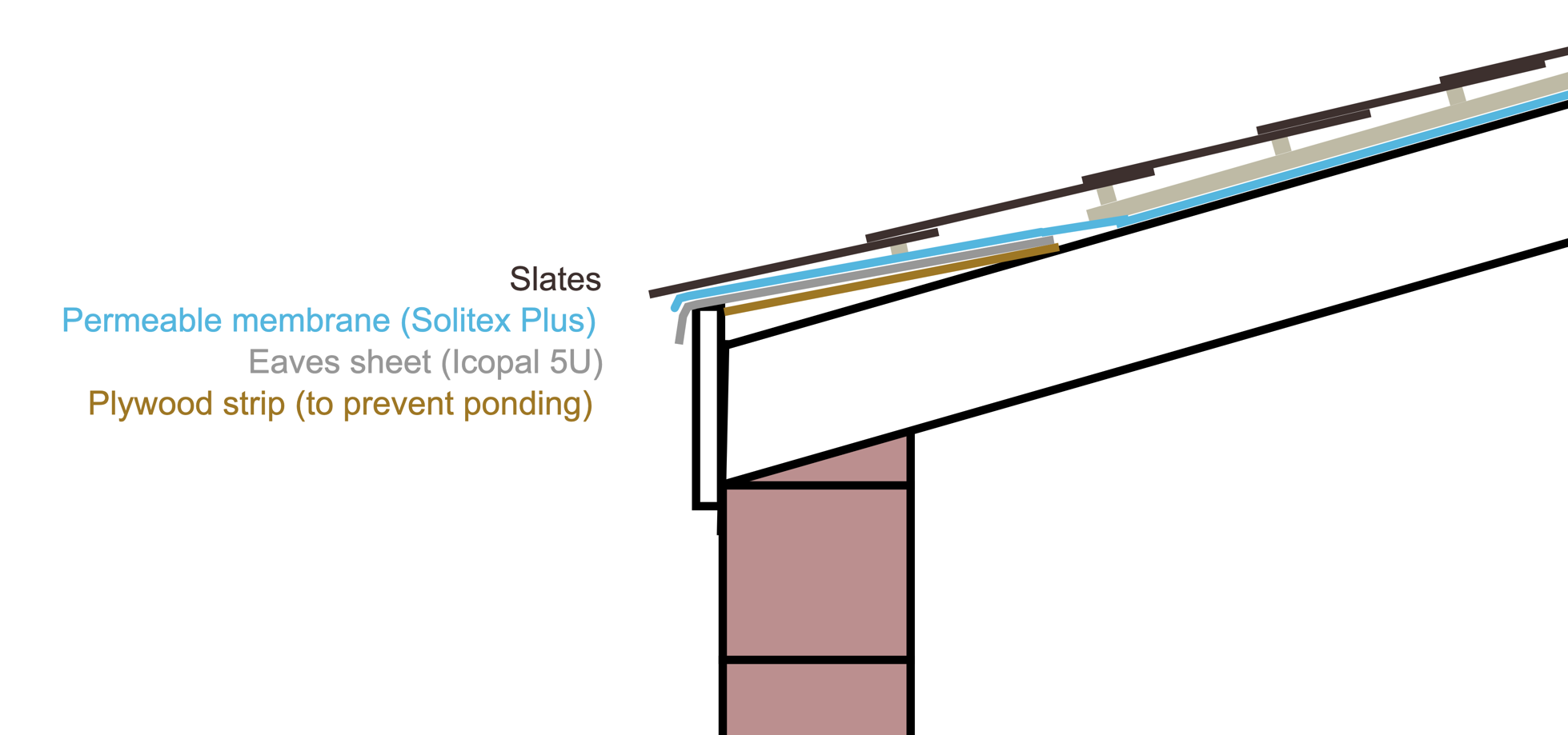

We are re-roofing an old out building. The building is 16m long, sloping downhill, and roughly 5m wide. So the roof is approx 2m from eaves to ridge both sides, with a fairly shallow pitch (16 degrees). We are re-using the old welsh slates and will be insulating between the rafters eventually. We asked the roofer to counter batten in order to get continuous airflow and so insulation could fill up beneath the membrane, but now the bottom row of slates are in place, I can see that continuous airflow doesn't have an inlet at the eaves, where the fascia board is kicked up (and the batten the last slate rests on isn't countered, either) Cross-section attached here – not 100% accurate but hopefully illustrates our situation. Is a ventilation inlet at the eaves absolutely crucial here? (e.g. https://fascias.com/over-fascia-vent-ov10-1m-x-10mm) Some searching online suggests not, since we're using permeable felt, and air will get in-between the slates enough to ventilate. (I will ask the roofer on Monday, he's very experienced and came recommended, and can only imagine he's of this school of thought too) New to this, and slightly concerned it's too late to rectify this now much of the work's been done, so any suggestions / thoughts much appreciated. Many thanks!
