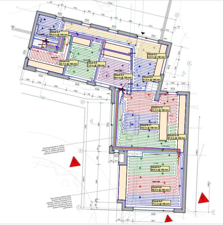

UFH - Supply and Return pipes...
Mulberry View replied to Mulberry View's topic in Underfloor Heating

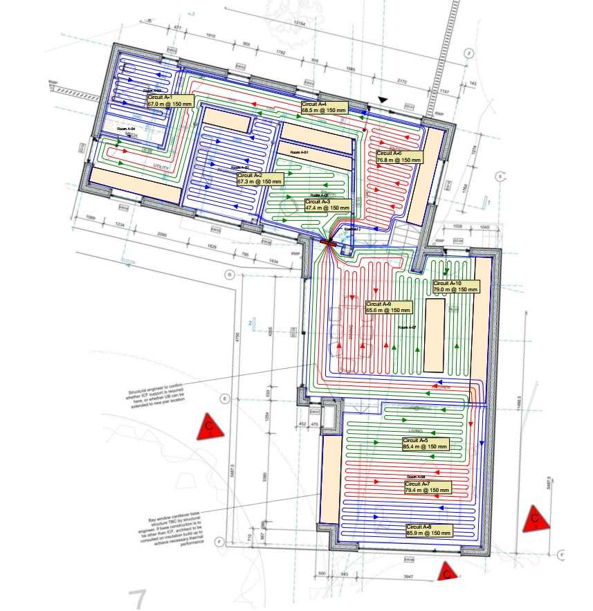

This is them sketched by me on an earlier layout plan. Ignore the pipe layout and manifold positions on that plan, this was an overlay to show my proposed position of the M1 manifold and the omission of the M2 manifold in the middle, along with routing of the supply/returns. Where the omitted manifold is shown there, the supply/returns need to turn up out of the lower floor, ascend by 600mm then turn back into the Kitchen floor. The 600mm vertical section will need to be contained in a battened out wall. -
The insulation thing intrigued me too. I asked AI, which told me that PIR is great at stopping heat from travelling downwards, but isn't so good at preventing it travelling sideways through the PIR boards and that the sleeving on the MLCP pipes somehow performs differently! Who knows. Not me that's for sure. I do know that I have to be able to create 90° bends halfway along the pipes, to transition as needed without fittings. -
So, back to the original point, Supply and Return pipes to/from the manifolds. What type of pipe is best to use here? I'm installing 25mm (26mm?) that will be within the PIR, with 150mm PIR under it. There is about 30m of linear length to reach both manifolds, so I'll need 60m of pipe in total, which I understand needs to be insulated despite it being installed into PIR? Is it just 25mm Pre-insulated MLCP? As for the design, the designer was certain that 300mm spacing would meet the heating requirements, but I've had him do 200m spacing to be on the safe side (150mm in the Bathroom). I don't really ever want to do this again and certainly don't want to have to use plug-in heaters if it gets chilly! There are 2 manifolds as this simplified the routing. The M3 manifold is at the lowest ground floor level, the M1 manifold is 1m higher in terms of ground floor FFL. The bundle of pipes running along the hallway to the WC and Utility will be in conduit as they are just transit pipes and the heat they emit is not required before the rooms. This design saves 400m of pipe compared to the earlier designs. The ASHP will be against the wall in the top-right of this drawing, so the manifold connections are the hardest part here really. -
I've just received the first draft of a more thought-out UFH layout. The designer has gone for 300mm pipe centres. It looks (worryingly) simple! I've raised concern about heat striping, I don't really want to risk that. He has gone for 3 manifolds, one on each of the 3 ground floor levels. 2no 2-port manifolds and 1no 6-port. I've proposed and idea for 2 manifolds and have fed that back. He has suggested that 20mm MLCP for each manifold is sufficient, something I've probed on because it seems very small. I'll share the design once I have it, but I am minded to want closer pipe spacing as I'd prefer some headroom. Not least in case I can't hit my desired ACH. I'd rather have more pipe and have to control the flow temp than find it's just weak performing. -
