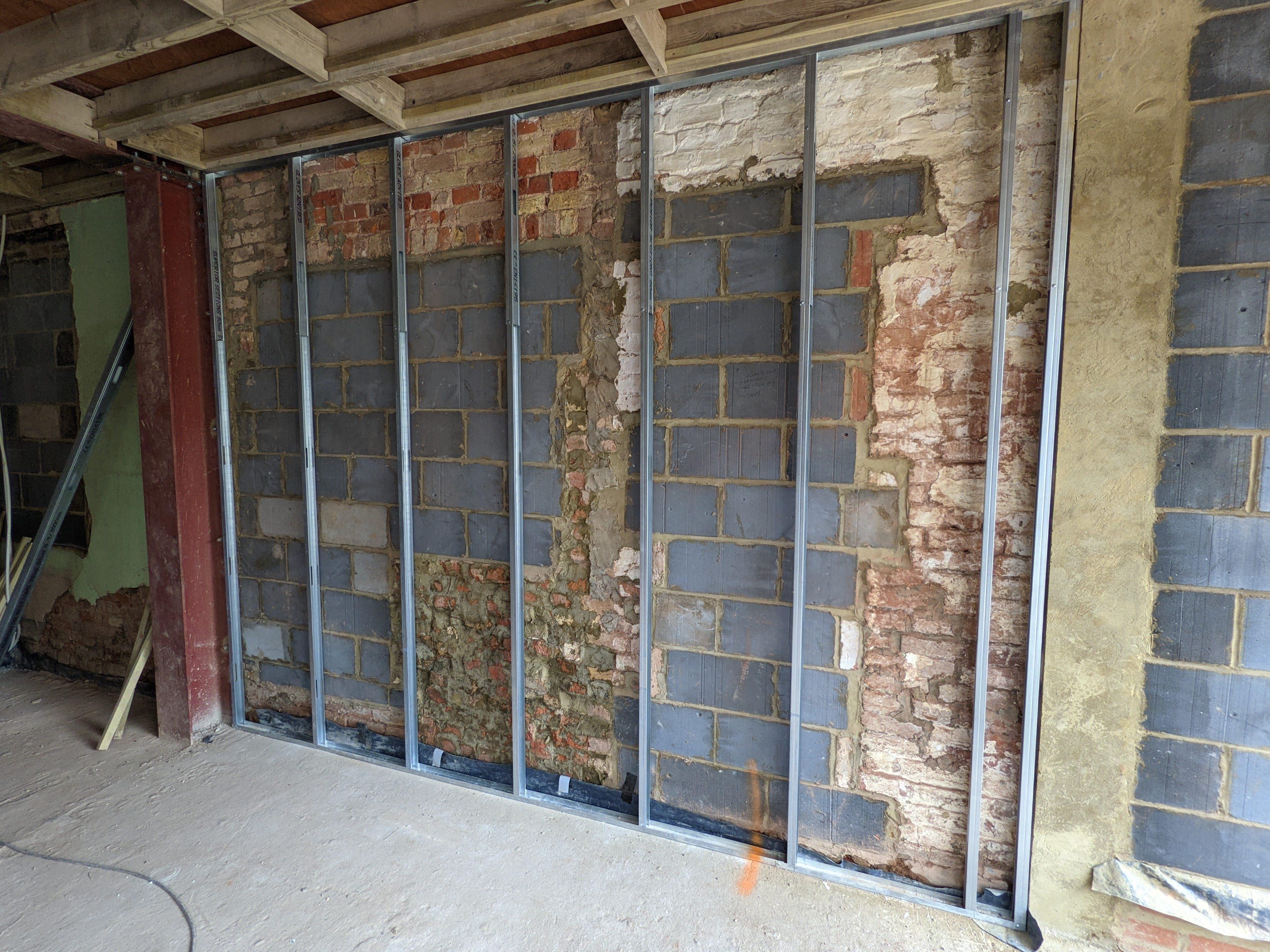

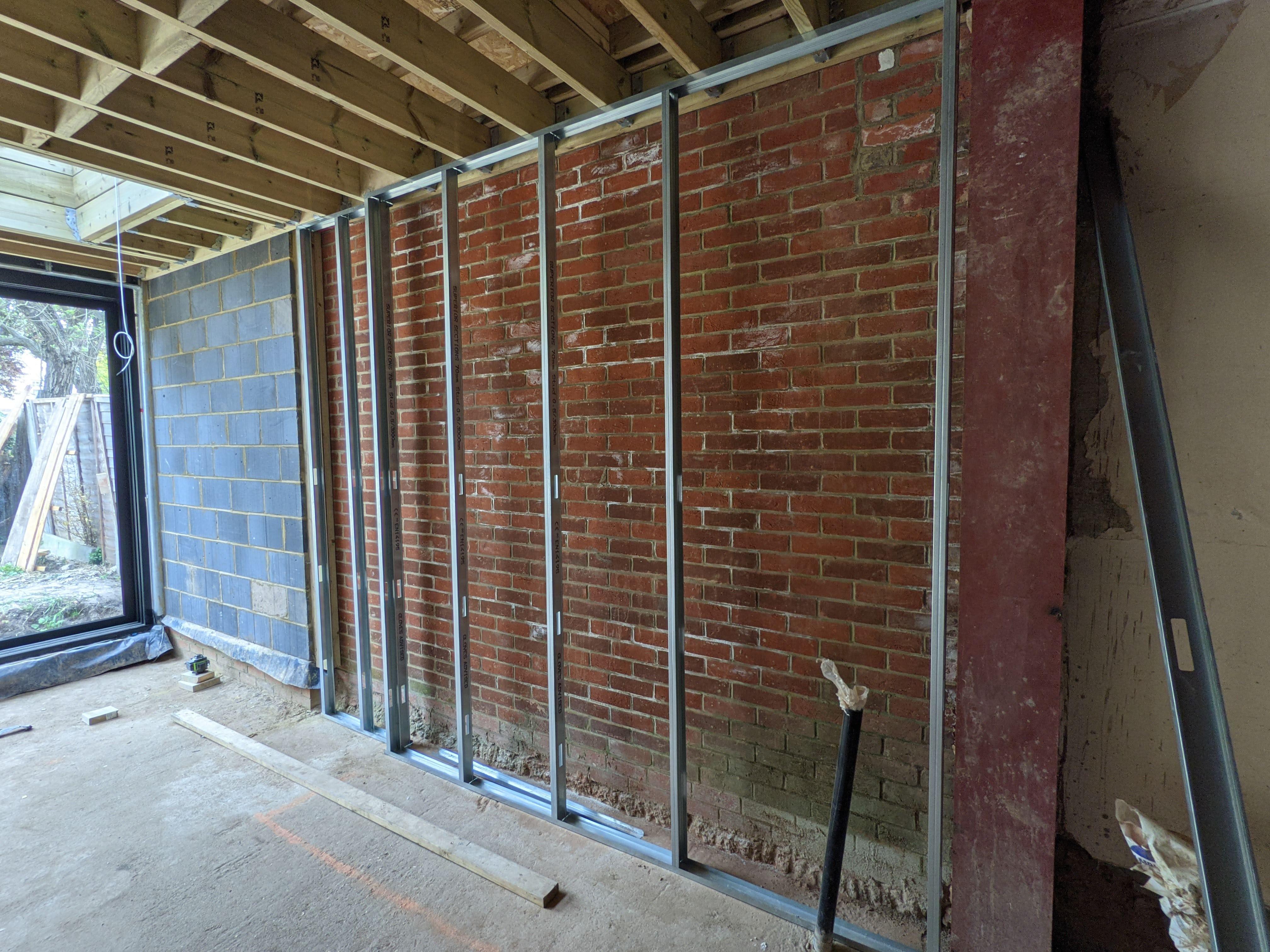

I've gone ahead and put up some metal C studs to bring the existing walls in line with the extension (new cavity walls). One side I've used 50mm C studs and the other 70mm as there was more room (both sizes at 600mm centres). The height of the studs are just under 3m, I had to splice extension on to the 50mm ones (with 600mm overlap) as I could only get my hands on 2.7m lengths of 50mm. The 50mm studs are close the existing wall at the bottom but are about 50mm out at the top because the existing wall has moved over time. The 70mm studs are about 200mm away from the wall, as they have been set to go flush with a steel beam rather than the cavity wall. I've been able to secure the top/bottom tracks to the concrete subfloor and the ceiling joists above. The end studs are quite tricky to secure to the existing building, but I've secured them to the tracks using suitable fixing. The 70mm side will be boarded with 12mm ply and then plasterboard (as it will be holding kitchen units), the 50mm side will have some 12mm ply where the TV will be hung, but the rest plasterboard and then a layer of plasterboard over all of that (so that the ply is covered). I've seen a post where @nod has suggested supporting studs by fixing pieces of track to the wall and to the C stud. I wanted to confirm if that was the best option in this case, and what centres to put these supports for the 50mm & 70mm studs please?

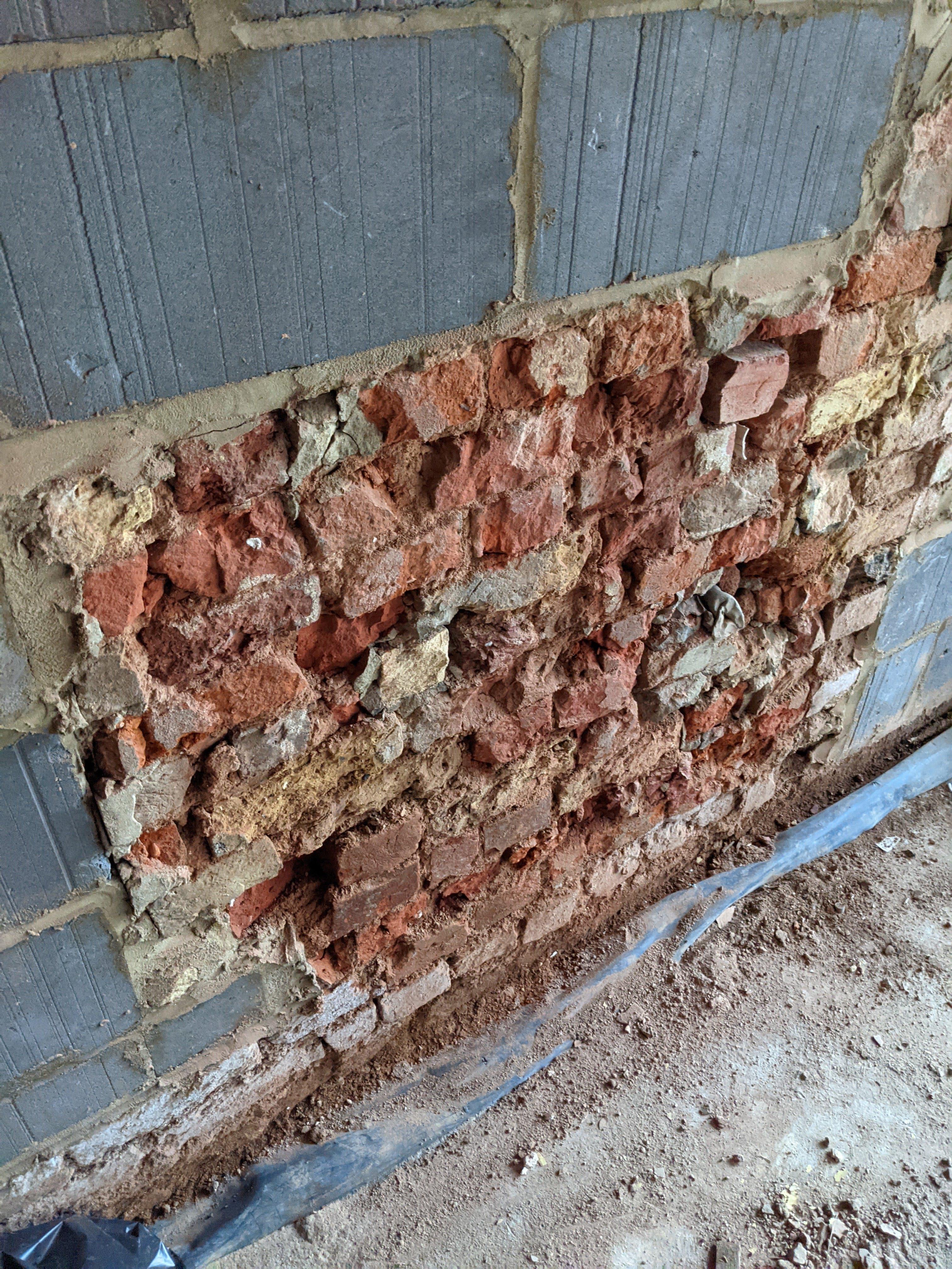

Removing old plaster from this solid brick wall with an SDS has left it looking a little worse for wear. We're going to build a stud wall/battens in-front of this wall to bring it flush with the new extension cavity wall - I was wonder if it's worth mixing up some mortar or similar to give the bricks a bit more strength.. some are wobbly. Thoughts?

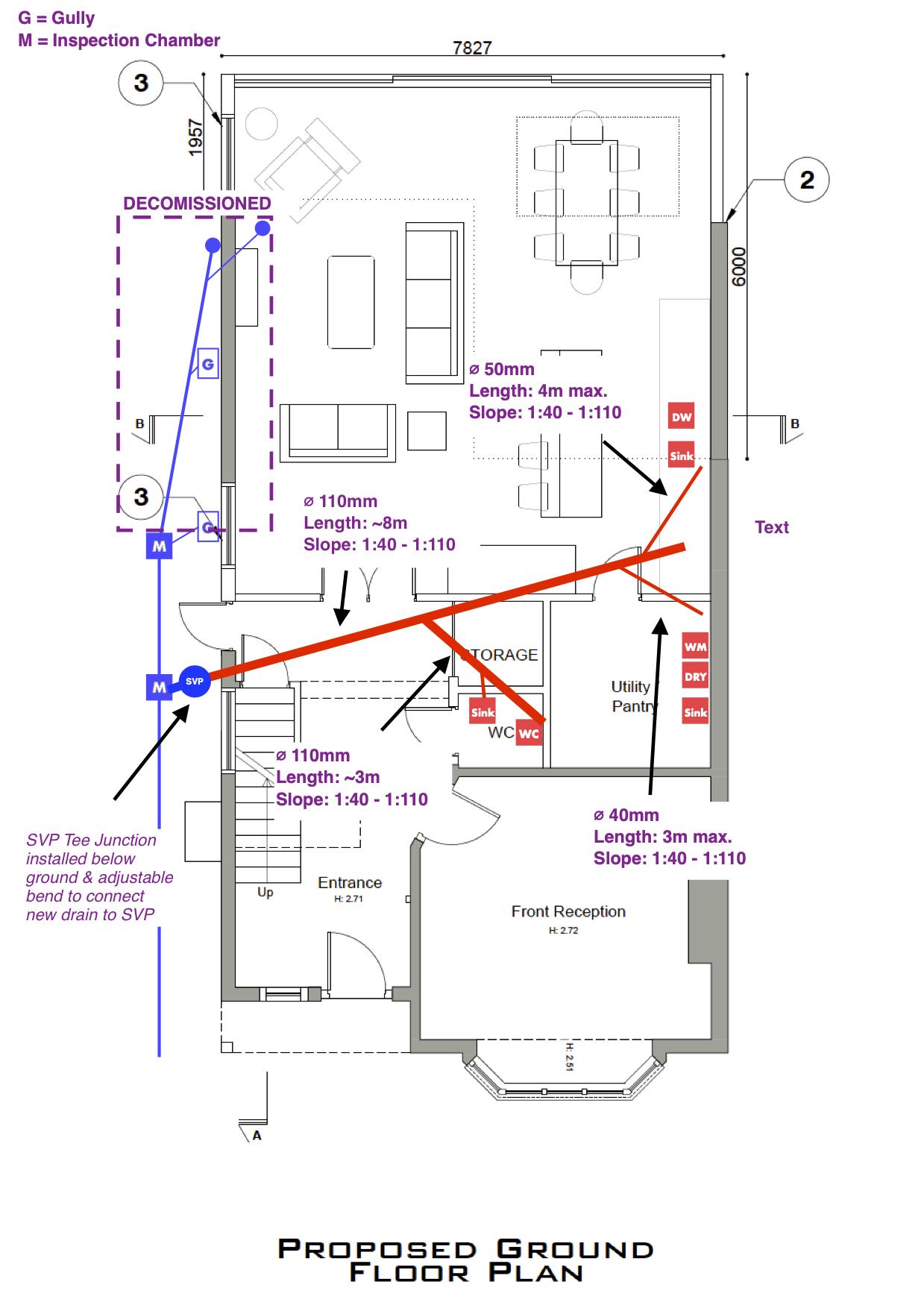

Hi folks, We're moving the downstairs toilet, kitchen and utility to the opposite side of the house. This is up against the party wall side of the house and further away from the existing drain. Looking for a sanity check before I engage the BCO on the matter, I've taken a look at the Part H document and tried to make sense of it. See attached my proposed drainage plan - I would really value some input before I put it in front of the BCO. Regards,

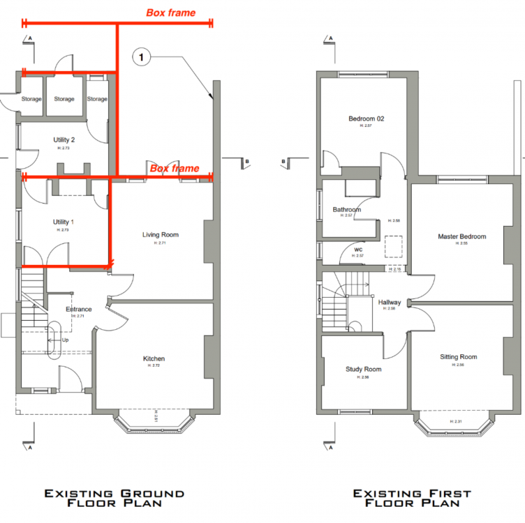

FYI - I spoke to the SE and he has advised that he can design a 'splice' such that the long span can be split into 3/4 and 1/4 if needed. -

Thanks all for your feedback, I'll explore introducing a pillar and see how we get on. Cheers. -

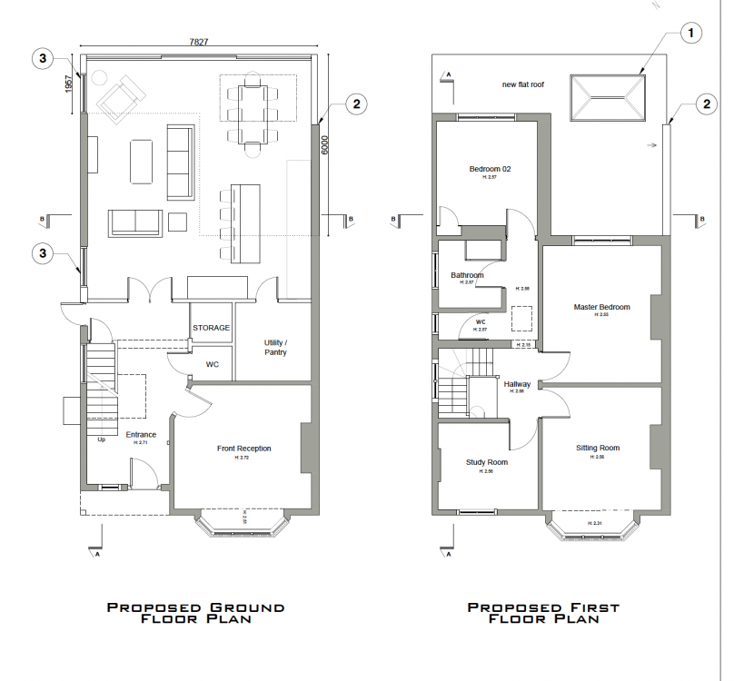

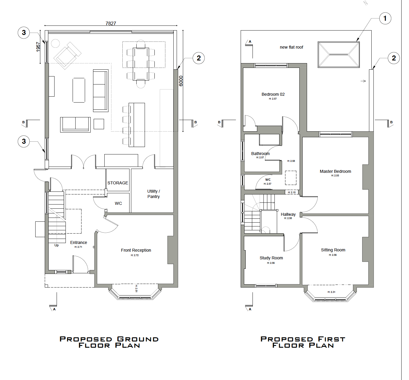

Hi @bassanclan - I've added the proposed floor plan to the bottom of the post. Thanks. -
I've approached a structural engineer with a view to hiring him to produce the structural calcs and designs for an open-plan rear single storey extension. I have attached a sketch which illustrates the proposed steel works. Before progressing I'm keen to get some feedback on the feasibility of installation, specifically the beam that spans the width of the property. Most of the installers I've spoken to want calcs and designs before engaging in conversation. My question is around the feasibility of opening up the wall marked in blue (see link to animation below) to allow for the beam to be located into place. The house is a 2 storey solid-brick 1910 semi. All examples of temporary works that utilise needle beams appear to be spaced ~1m apart which would seem problematic to manoeuvre the beam in place. Their are neighbouring properties either side of the site. Does anyone see a feasible way to do this or do I need to work to alter the design? Thanks, HT Link to beam installation animation: https://gfycat.com/lastdarlingicelandgull
