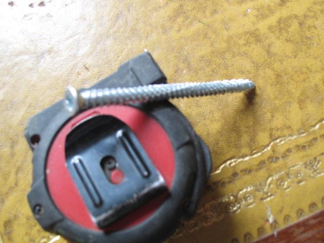

Thanks. I thought the construction adjective was implying not a wood screw. TIMco Wafer Head Index Screws 6.7mm x 75mm or ??
I had looked at Evo-Stik Exterior Resin W Wood which is a one-part resin glue but the datasheet says Modified polyvinyl acetate emulsion (pvac). Someone like to recommend one? Should it be a two-part one? Cascamite?
Thanks. I was going to use PVA woodglue - is that resin based? Do you have a link to 'construction screws' ?
