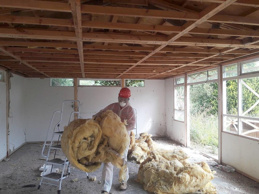

  6. Hi everybody. The charity I work for (and on whose land I live) has done a lot of self-build in the past (e.g. 5 bedroom chalet-style house done as self build training project in 1996, 'solar' building c. 2010 that included cob, rammed earth and straw bale). Now I'm steering (with 4 others) a project to build a multi-purpose studio with kitchen, toilets, store and lobby. We did demolition (of previous 'classroom' type building) and site prep ourselves. Photo shows me removing old ceiling insulation and a million dead flies! But we are working with contractors from here on in. We aim for a building that will be carbon neutral in operation over the course of a year. We are in a brilliant location for PV on the south coast (and already have PV arrays producing more than 10,000kW a year) but this building will also be on grid so we can export what we don't use and draw energy on dark winter days. My current puzzle that brings me back to Buildhub (which I've often read with interest) is about options for heating. Specifically confused about innovative low voltage electric UFH which might suit our particular conditions well. Which sub-forum do you recommend for posting a query on this please? Thanks, Tony.
