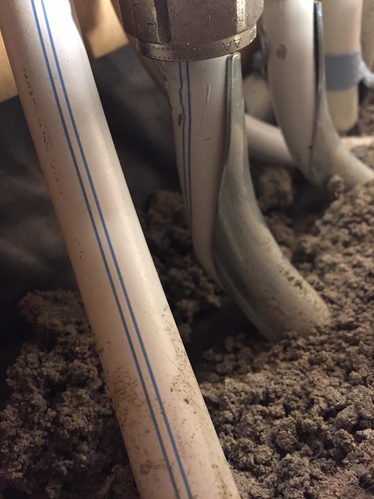

Thanks JS for your opinion too - I have learnt from experience that sometimes things are best left but it's a difficult to fight the instinct to 'fix' it. Just to check, I am assuming the flow is ok because the flow rate is at 3l/min which is the same as the other three on the manifold. Thank you
Thanks for replying, yes very weird as the locking nut isn't gripping the pipe so it's not twisting when I loosen/tighten it. My plan was to leave it if possible as these pipes do seem pretty resilient, but always nice to have a second opinion - thank you
Hi I have recently had some UFH installed and am having some teething problems. After a bit of fettling the system is running air and leak free but I noticed that one of the pipes coming out of the screed into the manifold is kinked; on the first pipe with the metal guide, you can see the blue lines are twisted. I have tried relaxing the nut on the manifold but the pipe doesn't untwist and when I run the system there does not appear to be any detriment to flow. I did a search and came across an old thread, which brought me a little comfort and I think mine is similar. https://forum.buildhub.org.uk/topic/2521-pipe-kink-should-i-worry/ However, better safe than sorry I hoped someone might be kind enough to take a look at advise if I need to get this sorted, somehow! Thank you in advance!
