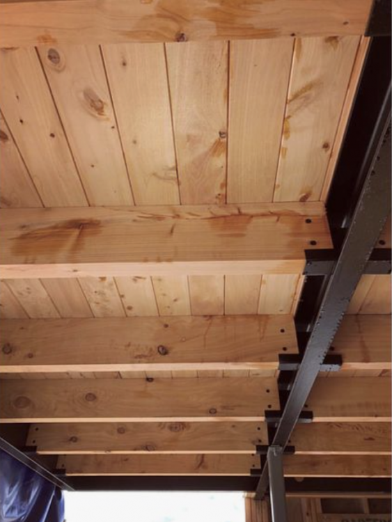

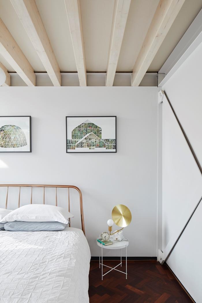

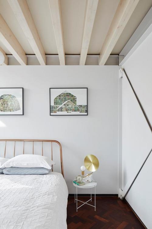

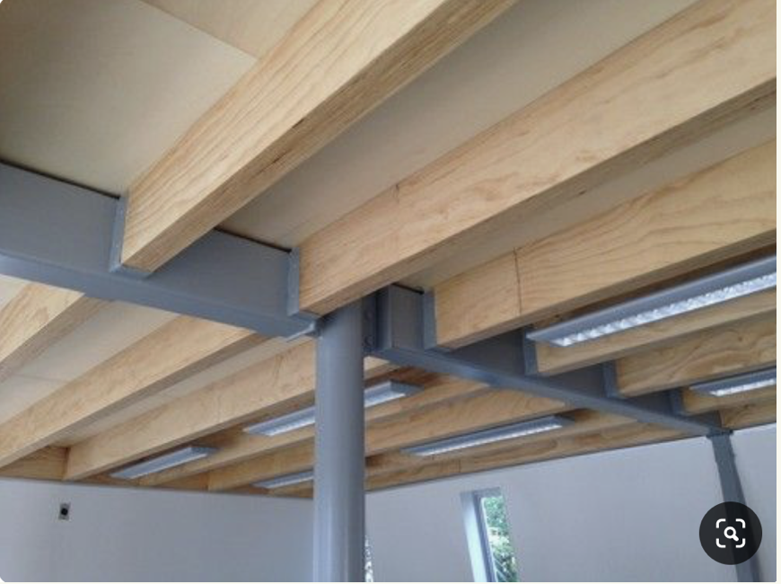

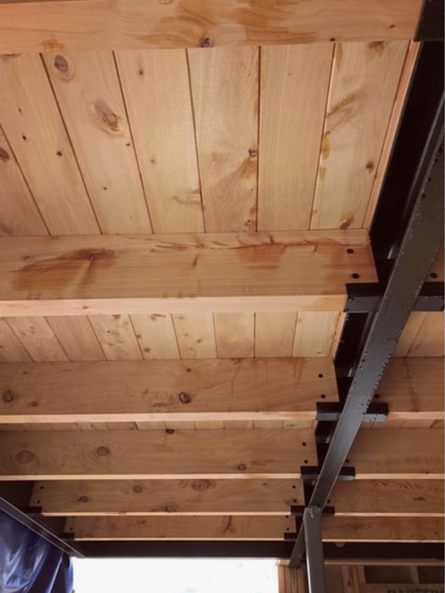

  1. Hi All My first post - so a bit of a rookie! I am designing a flat roof back and side extension to my Victorian Terrace and I want to expose the wooden joists of the flat roof into the exposed steel beam (like in attached pictures) I am trying to work out how these are fixed into the beam which is a UC 254x254 - obvi the traditional approach would be pack with timber + hangers but as it will all be exposed Id like a more aesthetic solution. As far as I can tell, I need a 'nice' looking hanger to fit inside of the beam that can be painted with intumescent paint along with the beam and am looking for recommendations for these. Or, do steel companies design this into the beam as it looks like in some of the pictures? I did email one to ask but the answer was no. Any recommendations for these as well! Thank you in advance.
