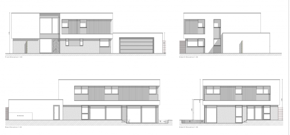

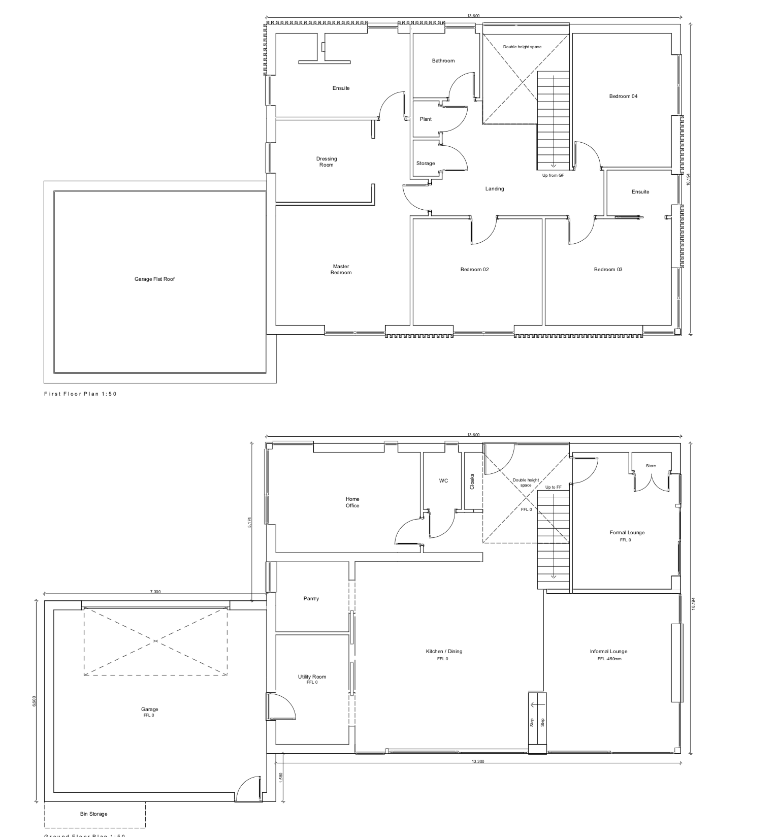

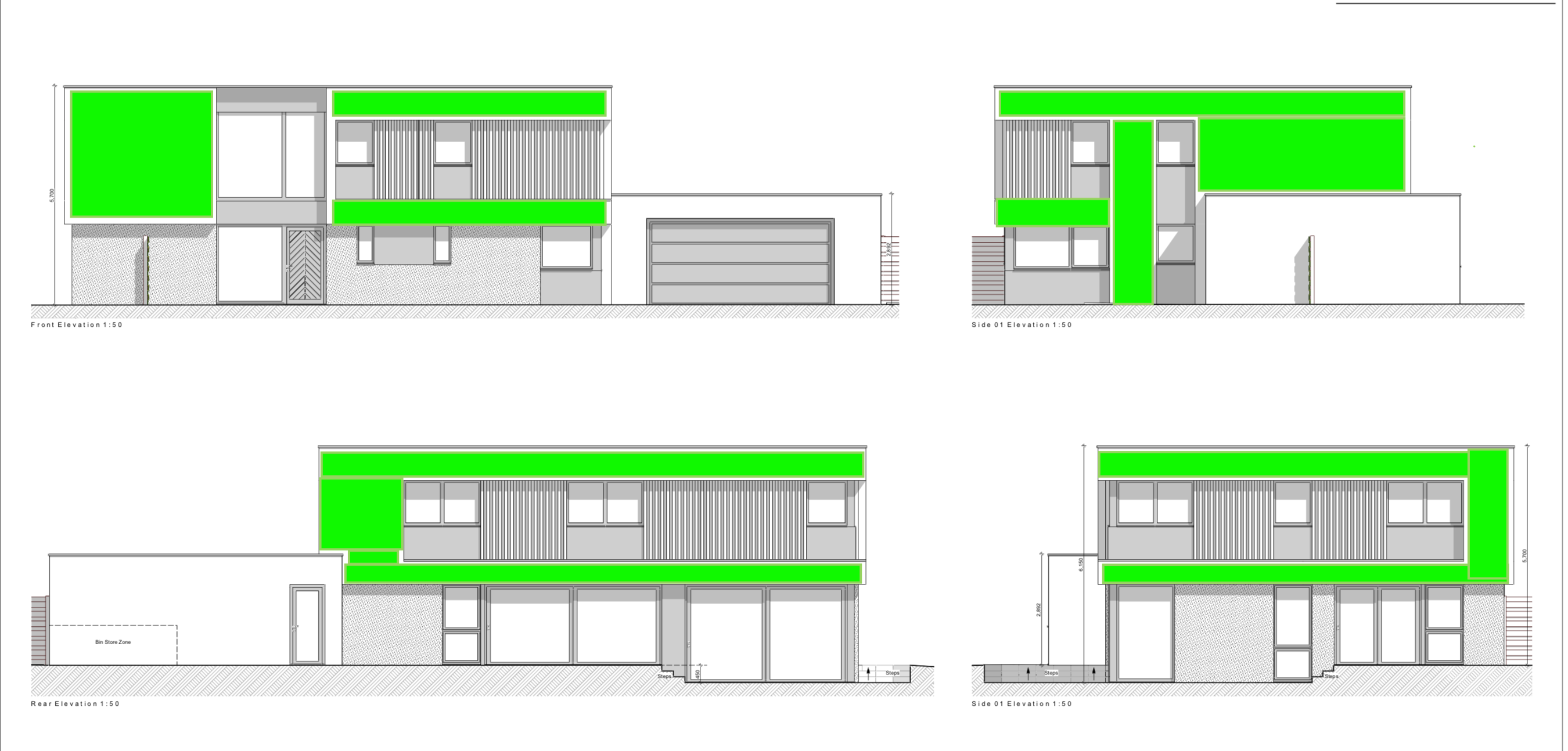

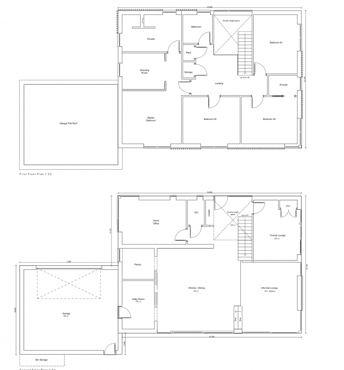

New Member (2/5)

  4. Hi @ProDave, we are thinking of either Sto, K-Rend, Weberend or SAS but not yet decided. We are still negotiating how best to build overhang rather than using either external wood fibre or cladding support brackets(rails). Just comparing different cost options and their implications onsite. Hopefully frame company can do it without any cold bridges to avoid unnecessary complicated issues on site. Render company says they wont do or guarantee any cladding brackets that support 200mm overhang
