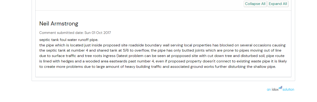

so i vaguely remembered a objection when we originally looked at the planning permission and here it is!! the pipework has previous!

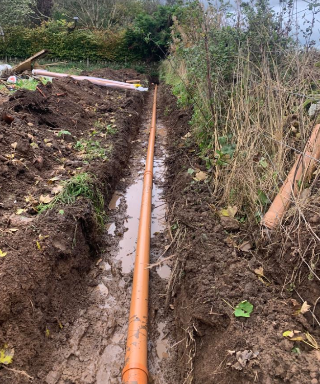

my builder changed it out himself without even consulting us, we were told we had to replace and concrete the driveway in anyway so he just done the lot and put in a inspection chamber. it cant be us who have damaged it if its brand new pipework and our part isnt blocked, its further down, well wait for the neighbors response anyway.
the blockacge is out of the shot of that photo we reckon, its not a new pipe further up
pea gravel and all that is down i think this is a proper drainage company that put it in
it did cross my mind haha but i would rather get it sorted for everybodys sake mate, once its sorted, my builder reckons its a blockage further up there line and suggests getting it unblocked and a camera survey done to pinpoint the issues and have it all in writiing but i dont see why i should be paying for it lol

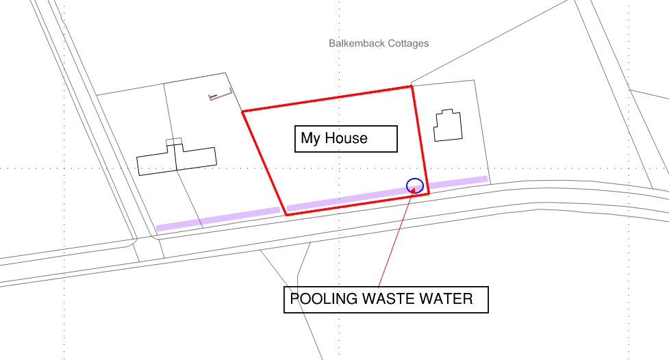

The red is my house boundaries the purple is the pipework it runs from the left passed my garden to the right and away somewhere unsure were its going, the pooling water is occurring at the bottom right of my garden, im thinking the line is blocked further to the right and backfilling into my property, my builder replaced the whole section of line within my garden but further down in the other neighboring gardens its old clay type pipework. see photo 2 of the replacement pipe in my section of land only months ago.

Thats pretty accurate, a b c etc i think house a c d and so on use the line im house B and i have my own things for sewage treatment i was specifically told i couldnt connect.
