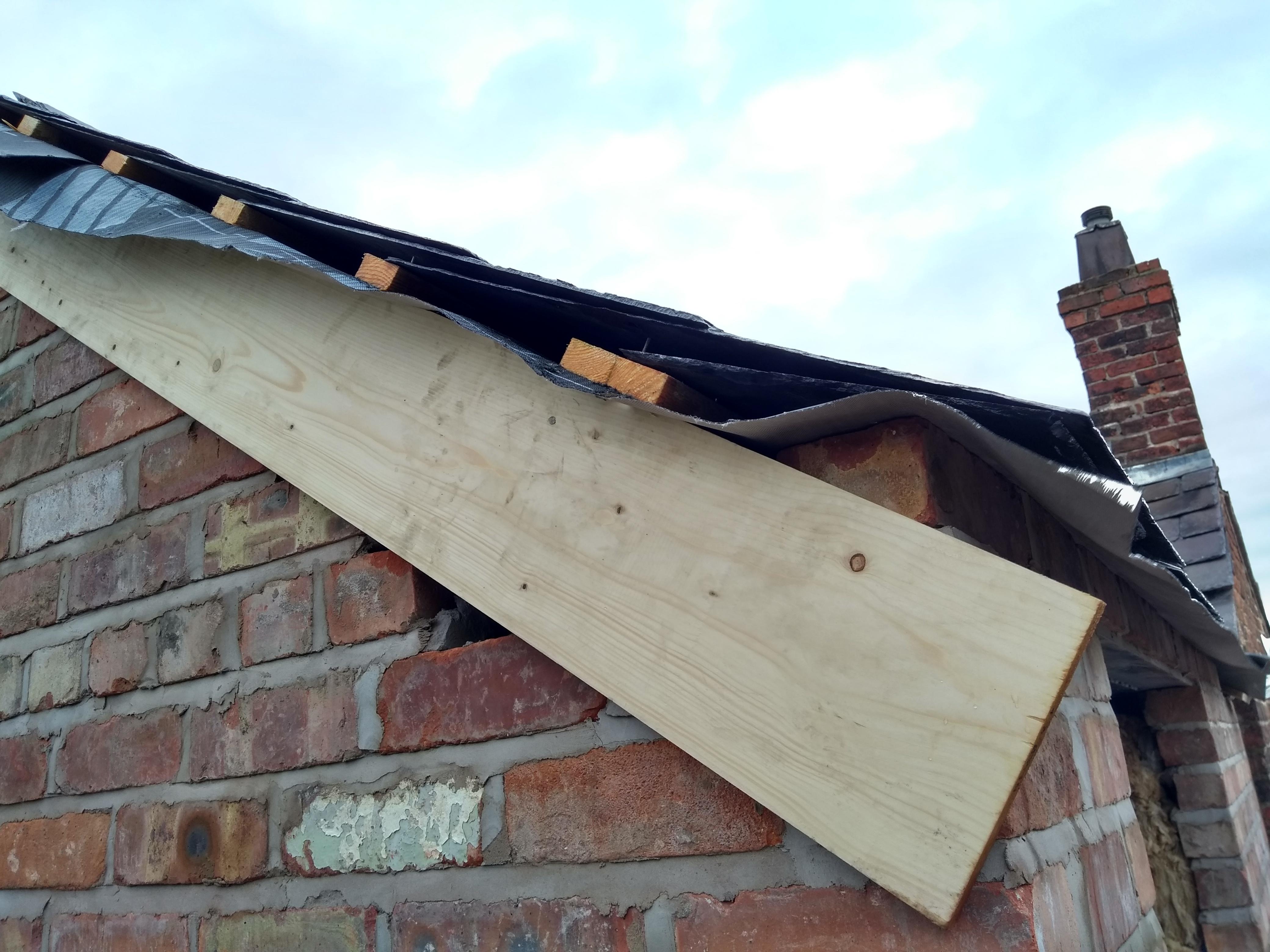

New Member (2/5)

  1. Many thanks to you all. I will discuss with the builders tomorrow. Mark
  2. My concern is not just the bell .. there is a lift on at least the first 5 rows. Mark
  3. @Simplysimon Yes that is my main concern ... and it just doesn't look right! Mark
  4. Hi @CPD I didn't lay them .. builders/contract roofers. Yes I had concerns about the nails too but it was all done by the time I got home at the end of the day. It's not on sarking just the membrane under the lathes. I assume it's the correct stuff!? Gutters on metal hangers into the brick ... but there's not much roon?! My gut feel is it's dubious too ... hence why I am asking for comments. Many thanks Mark
  5. OK many thanks @PeterW So it's ok to have lift on the courses above as well, with the slates only being supported at the top and bottom edges, but not in the middle? Mark
