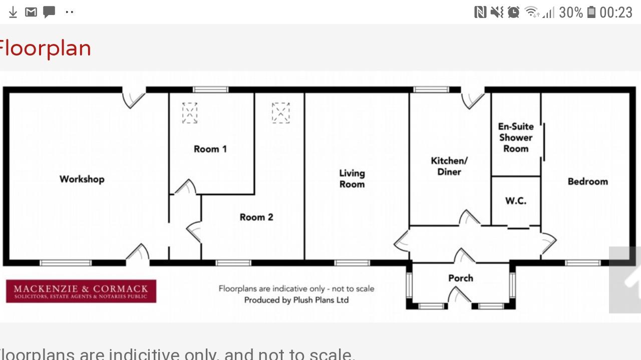

  5. And this is the floor plan of the property. The blocked up door between the 2 is located at the front corner between "room 2" and the "living room" . Rooms 1 and 2 will be getting merged. The hallway at the entrance will be removed to lengthen the kitchen. I'll need a hallway leading to the door of the outbuilding (through the "living room"), then the living room will be partitioned to create a small office space & 2nd bedroom. Hope that's clear!

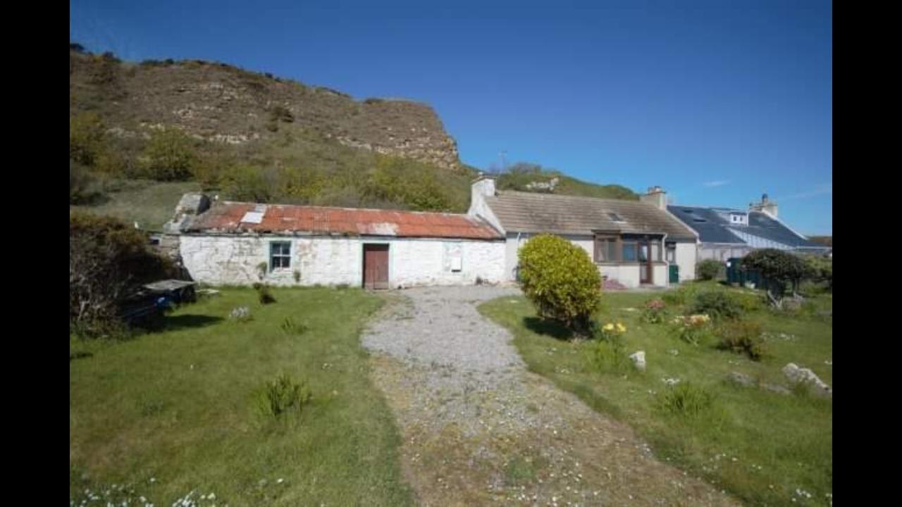

  6. Cheers guys, thought I might have landed in the right place! Ok, this one is the cottage and outbuilding. The bit that was joined onto the house stretches from the gable to just to the right of the door, where there is an internal old stone wall. I don't want to demolish this building at all. When I were a lad there were a few old cottages in the village like this but they've all been gentrified these days, I'd like to keep something of the old character of the village. I'm calling it an outbuilding but it's really an old house in itself although no-one has a clue when it was last lived in!!
  7. Hi folks, I've just bought my first house. I wasn't looking to buy but basically got an offer i couldn't refuse! However the bank balance is low and the work needed is (relatively) high. I'm more than happy doing the labour myself but, as I'm not a builder, I could be doing with some advice on different aspects of it. Basically it's an old cottage with an outbuilding attached to it. At one time half of this outbuilding was attached directly to the house but the door has been blocked up. This part has an old corrugated iron roof which is well corroded and needs replaced. Im planning this as the living room and I'll need to take this part back to the (2ft thick) outer walls and start from scratch, well not quite from scratch as it has 4 stone walls round it! Its single story and a relatively low profile roof (around 1.4m profile) so my plan was to open it up to the rafters (I've got a source of relatively cheap hardwood which I'm hoping to incorporate as the rafters) I'm basically looking for things I'll need to look out for, as well as any other advice as maybe it's just not practical for me (trying to keep architects etc out of the costs ?) Would this sound like the right procedure going from the inside out? Rafters, sarking boards, purlings, insulation boards, insulation membrane, osb boards, membrane, vertical batons, horizontal batons, aluminium (?) sheeting. Any tips/ advice most welcome, and anybody flogging cheap building materials in the north of Scotland could make themselves a new friend as there's another couple of internal walls to be shifted around, kitchen to be redesigned and porch to be replaced, all while trying to live in it and hold down a job?. Cheers
