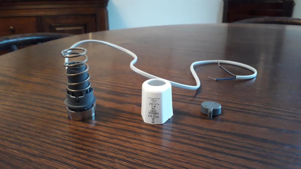

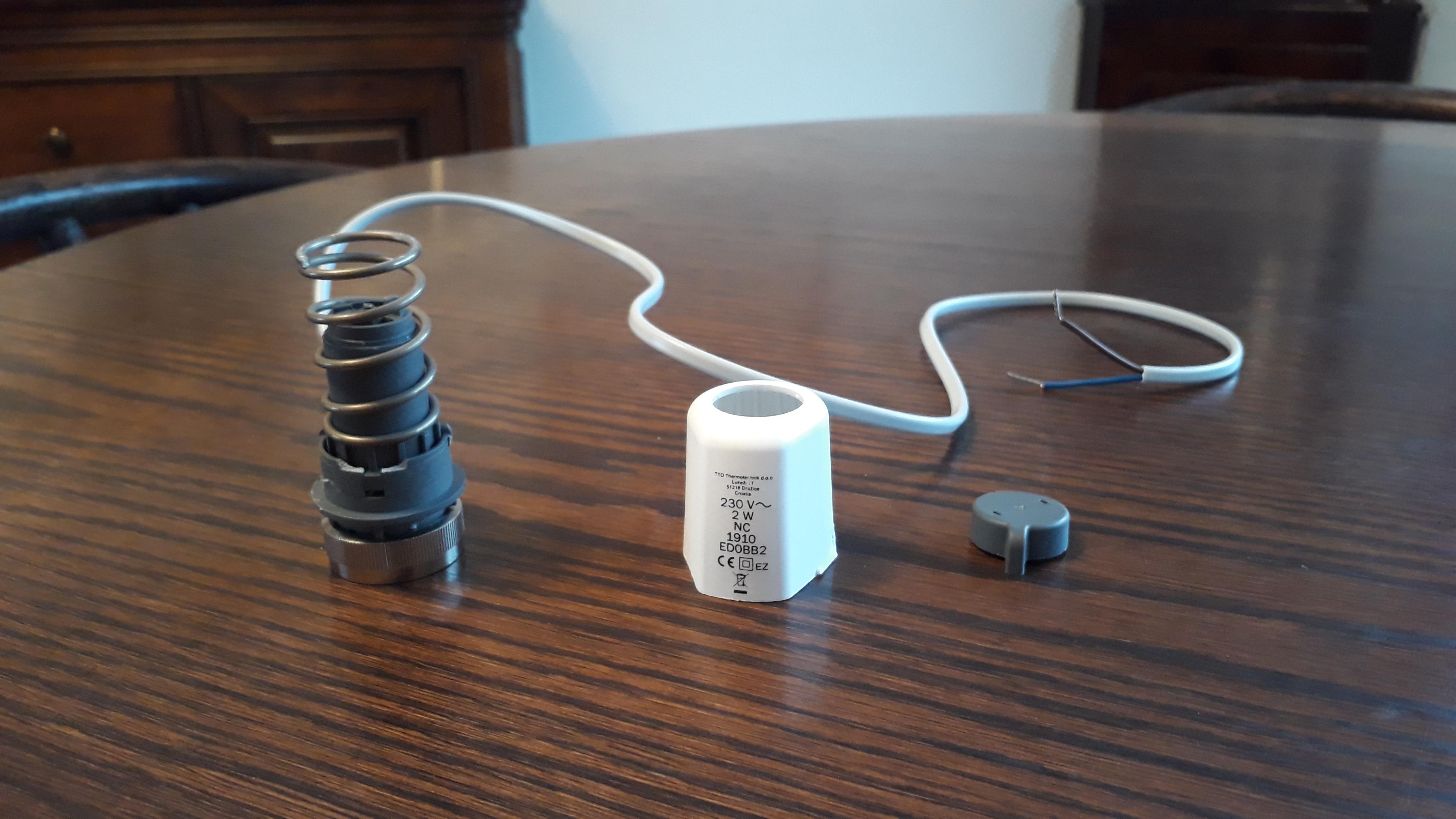

New Member

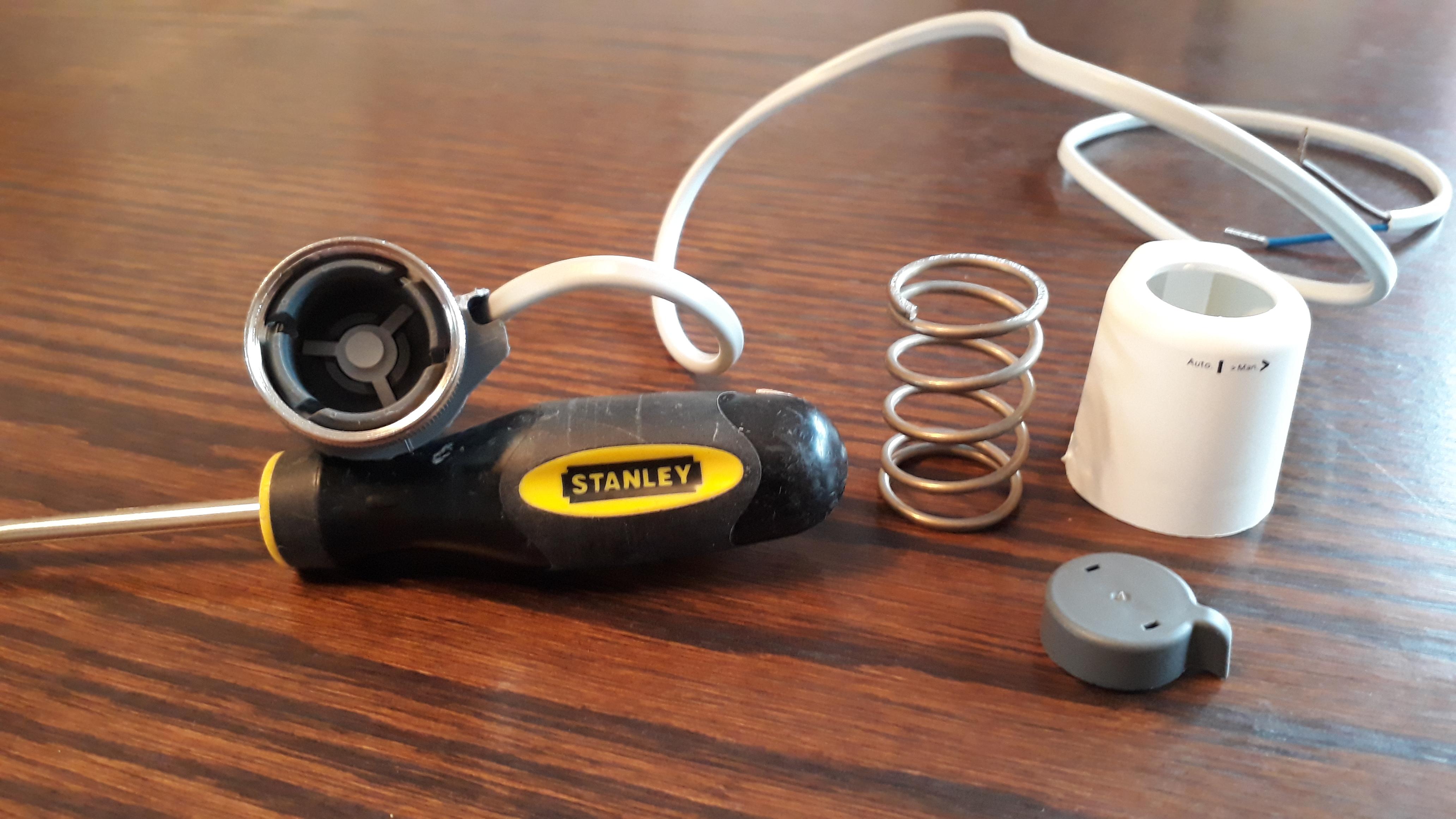

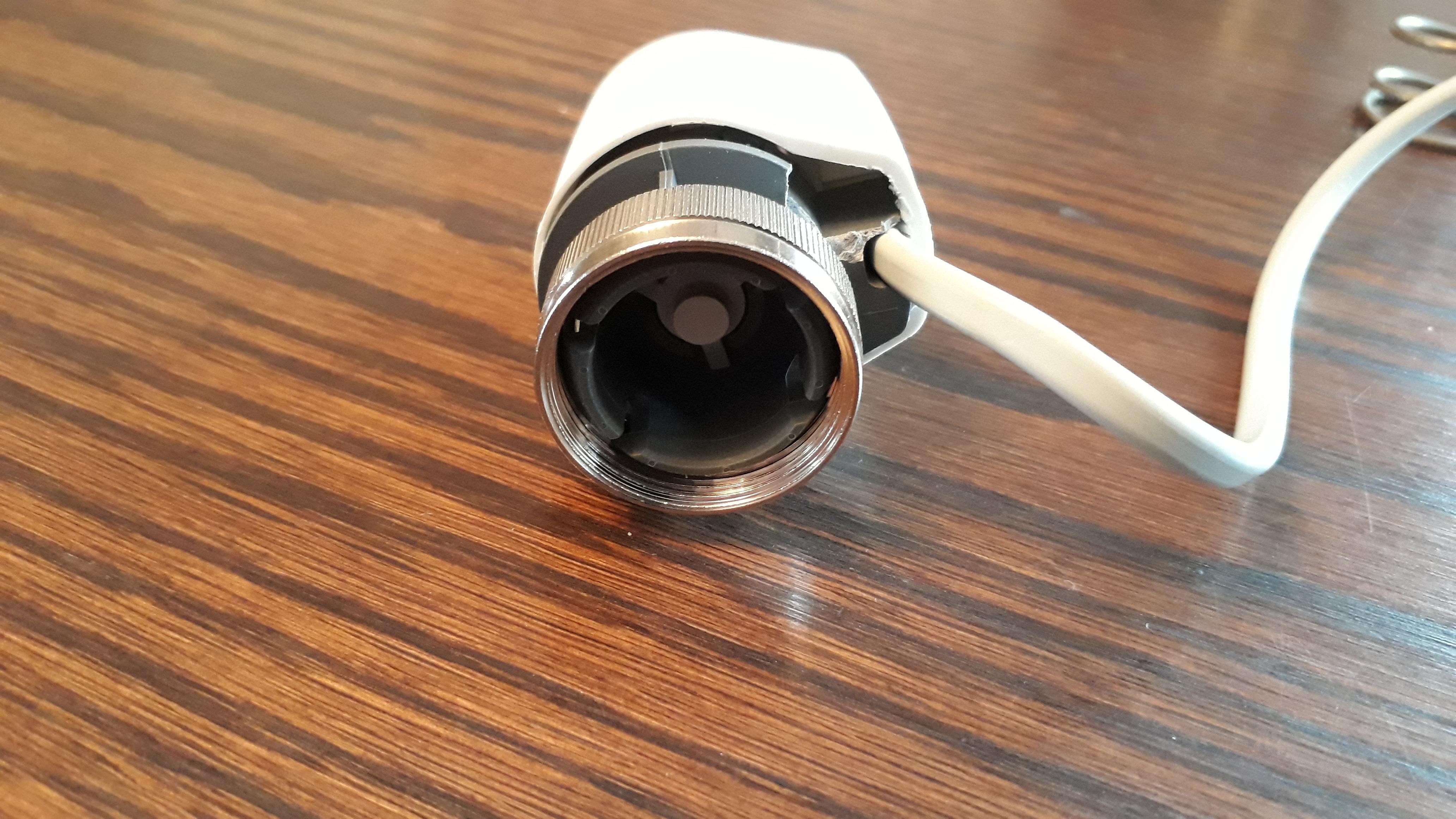

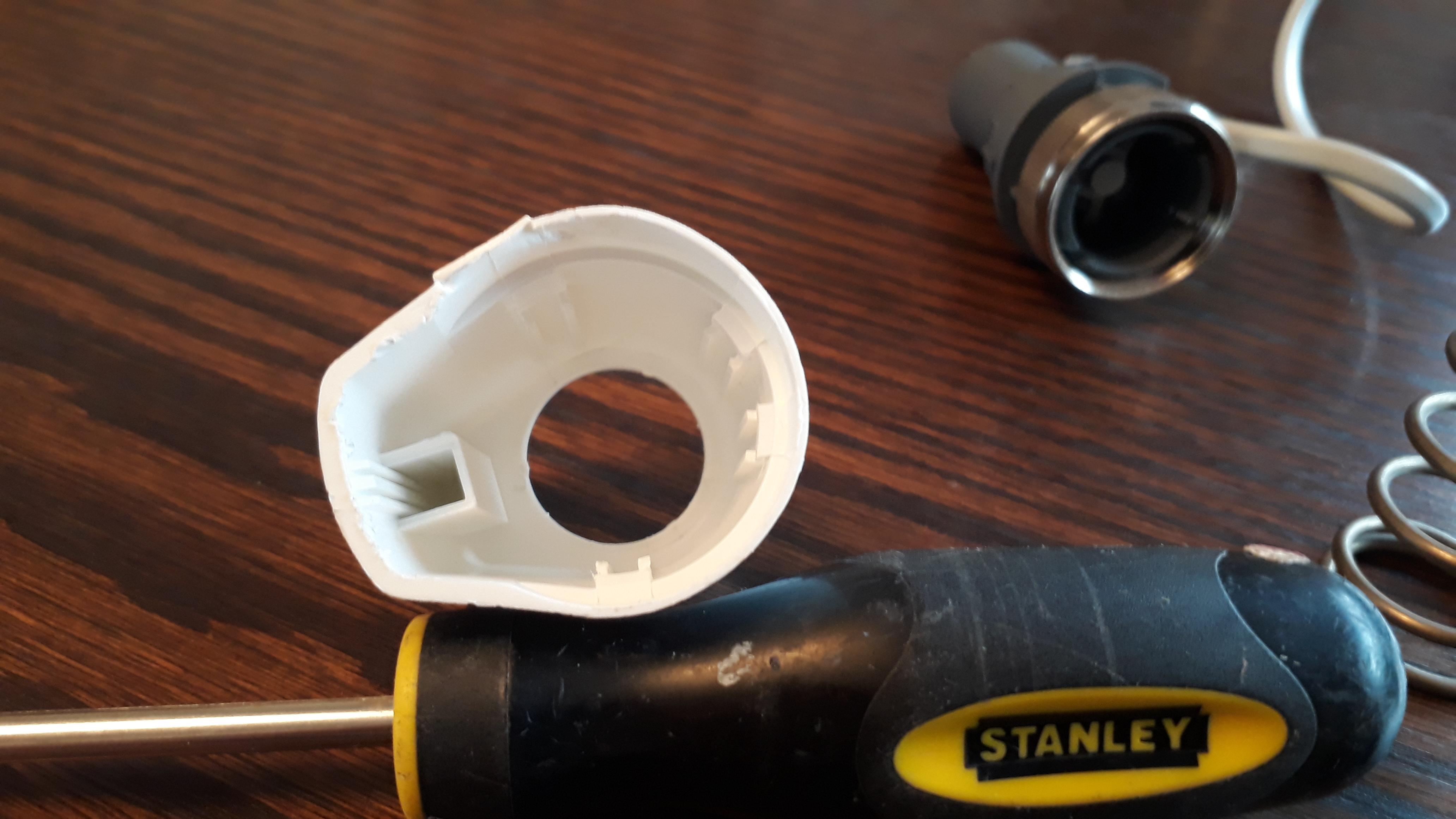

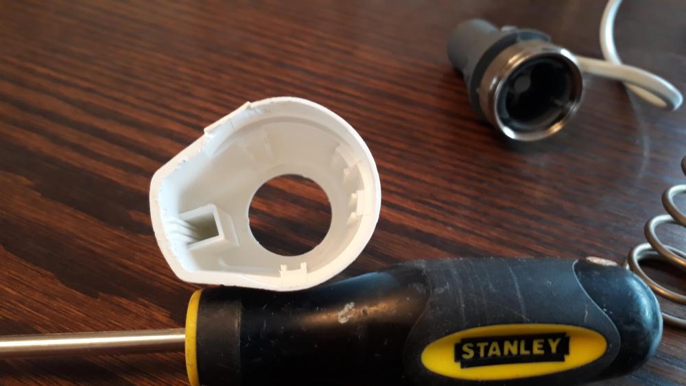

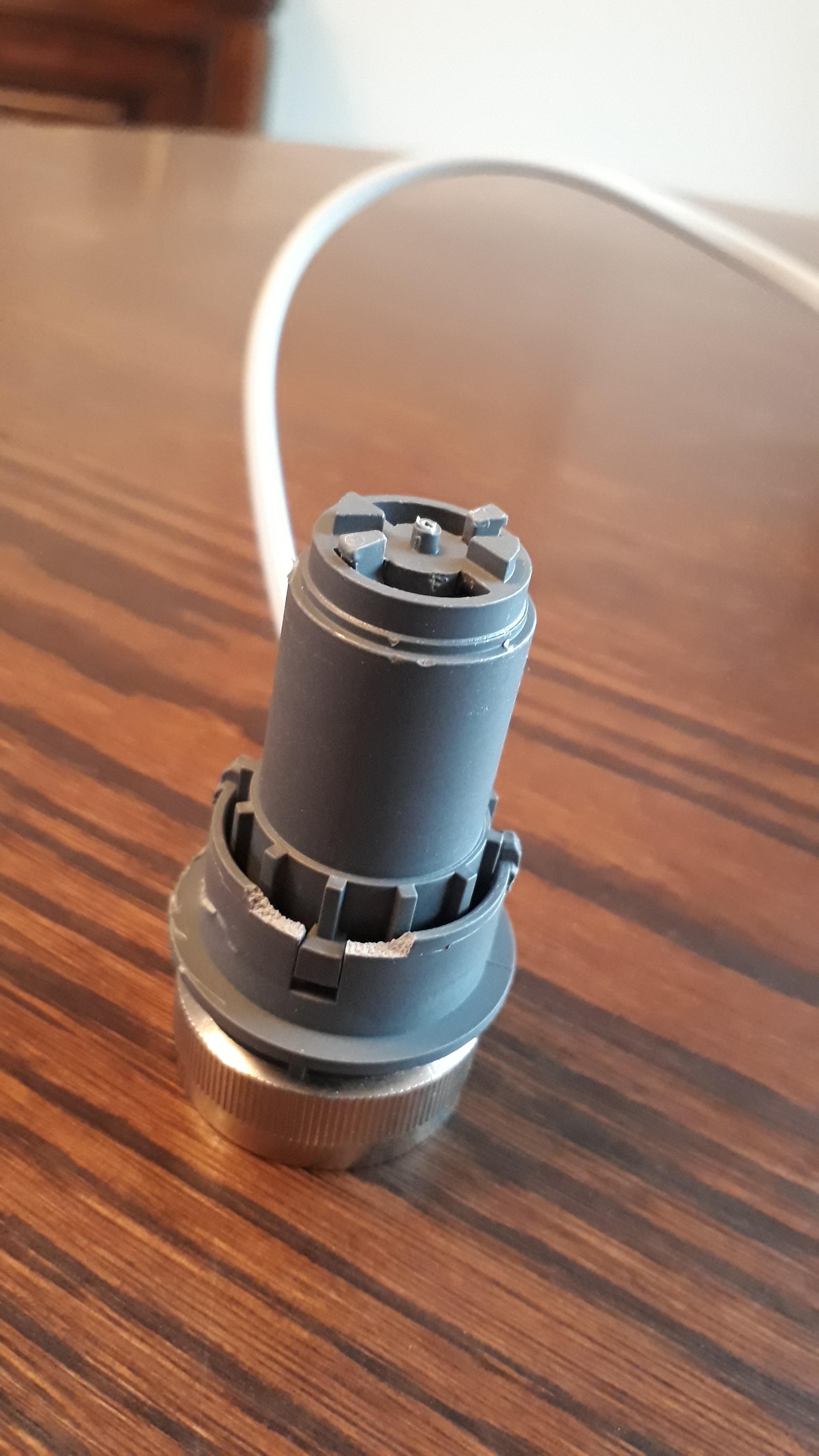

  2. The later photos show the damage caused by removing the white shell. I have no idea how they were successfully removed at my place given the 4 latching points inside the white shell. Note damage to the grey actautor too. My £18 test has failed. For now I'm following ProDave's line of living with it as it's working but will keep any eye on the forum should anyone be able to offer advice.

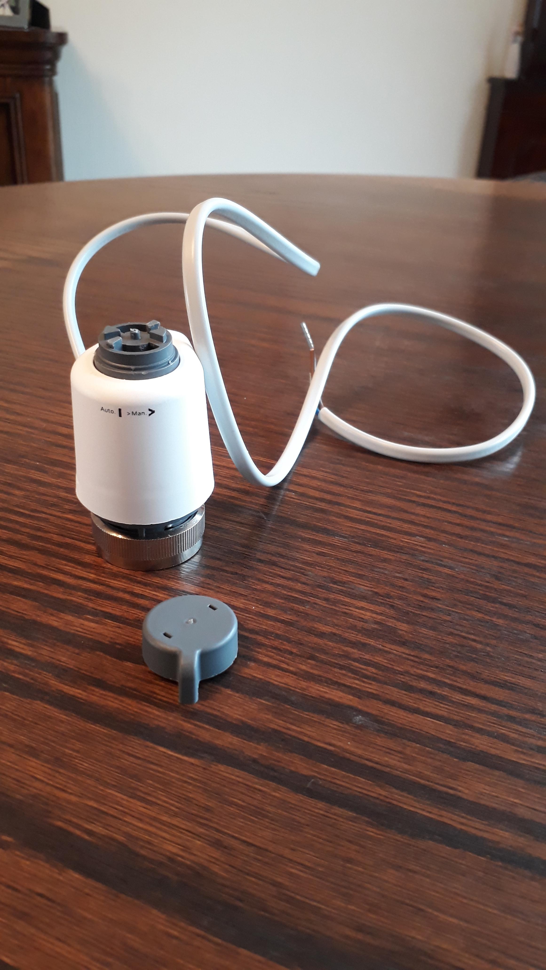

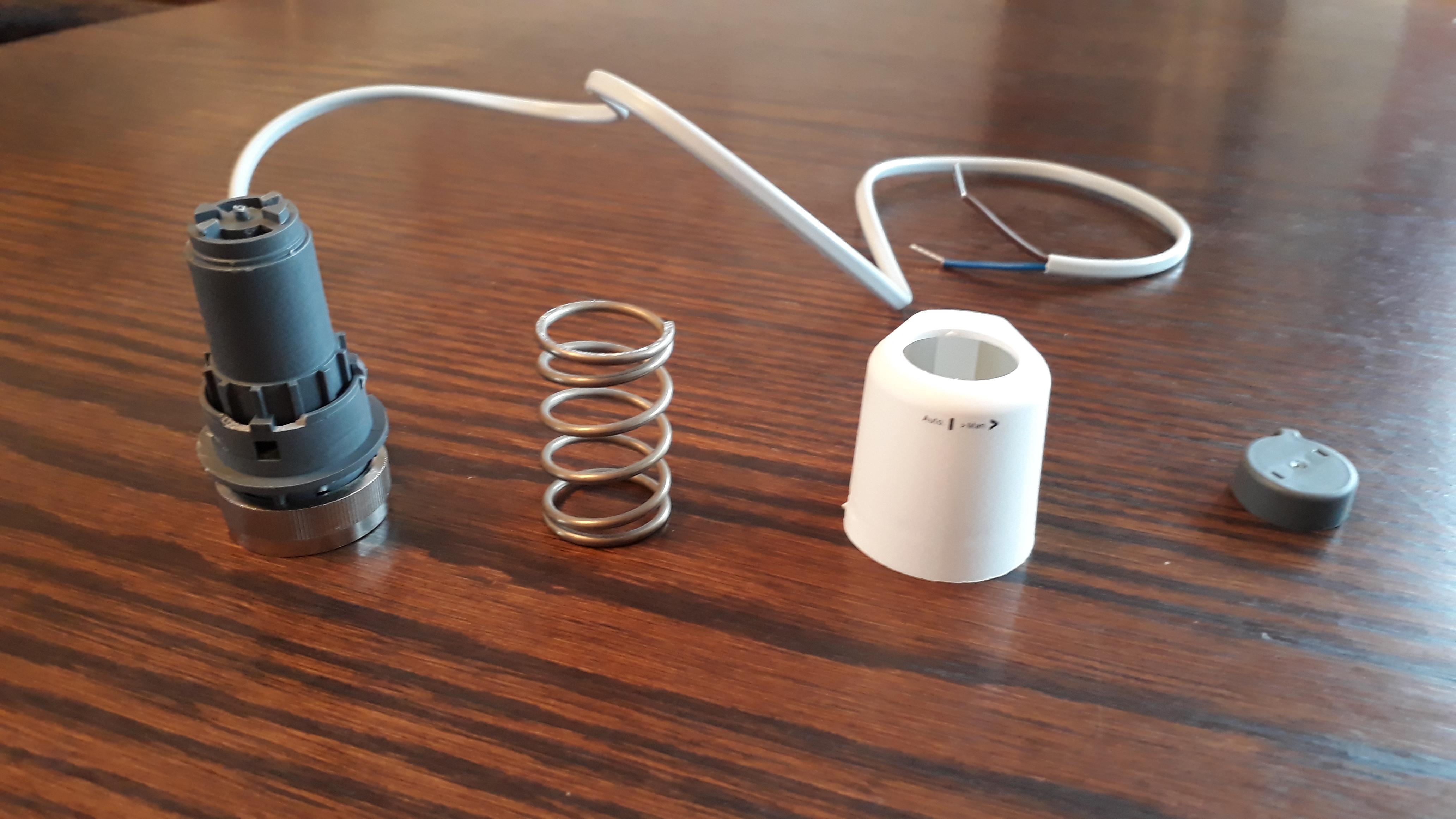

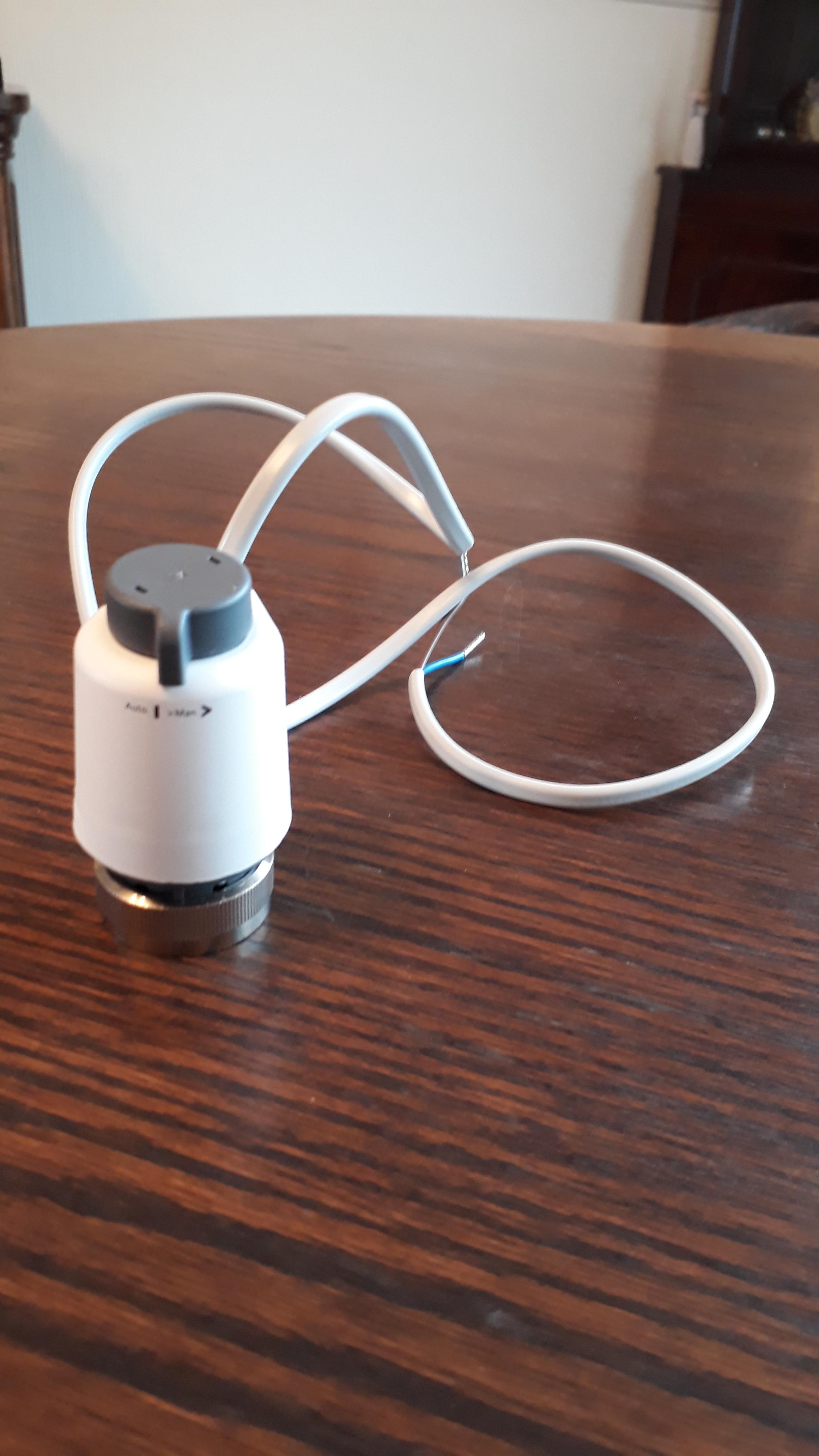

  3. Update.....The replacement actuator arrived early and I have had a good look at it. Removed the 1/4 turn auto manual selector from the top and tried to seperate the white shell from the unit. The shell is held in place by 4 internal clips which latch onto the actuator unit. Unfortunately even with care all I have succeeded in doing is wrecking the unit. It has confirmed that the springs I have are from 2 of my actuators but I have no idea how the springs were removed without writing off the units. I'll take on board ProDave's advice and live without the springs. Cheers Dave
