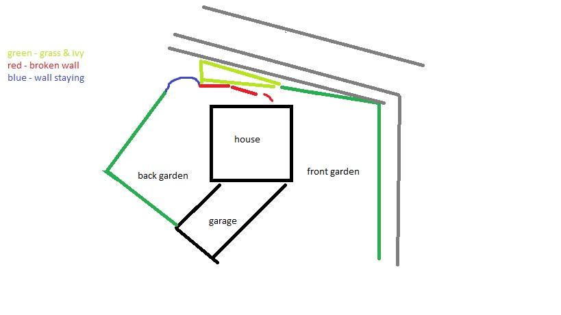

I was just following this https://www.planningportal.co.uk/info/200130/common_projects/20/fences_gates_and_garden_walls/2 The wall as it is has 3 piers per 4m section so 6 piers in total and those are 1 brick thick. The end part of the wall that has a gate attatched is fully 1 brick thick and curved and that has pivotted about 2 rows of bricks up. Wind and ivy = wall being swivelled! -

I'd expect a 1.5 brick thick wall to be more than that. I would much rather use fencing somehow incorporating the bottom few rows of bricks that are acually 1 brick thick. These ideas are all good providing the council keeps away lol -

It's beyond repointing. One section leans back where the wall has broken in the middle. The insanely thick ivy is holding it up. -

I think they have done without doing it officially as the deeds show that ground as not on either of our properties. We didn't even notice it during the purchase as we moved from a fair distance away. I know they would notice that though. I'm not bothered about gaining land just want to put a fence up with getting grief about it being a full size one. Would hate to draw attention then it be brought to light that neither of us actually own a large part of our front gardens lol. Plus the corner part of the wall would be staying so that kind of draws the line as to where it would go. I really appreciate everyones help here. Posted on some other forums that were not quite as welcoming! x -

That part is definitely not ours. We don't think it belongs to the council as they don't maintain it. It could be highways for sightlines but would have assumed they would have kept it cleared if that was the case. Or it could have originally belonged to the builders of the housing area and they are no longer in business. On the deeds that patch actually should extend over next doors front drive and all the way down the length of our front garden but next door have it as their garden and our hedge is butted up to the path as it has been for at least 10 years. (google earth again) To remove that wall and put in a fence would mean removing all the ivy leaving our new fence on show. -

None of those things affect us at all. The concern is that the council may see it as "highway adjacent" in which case 1m is all that we would be permitted to put up but that is simply not high enough with a dog that can jump it! -
Hi all! New here as trying to find the answer to this is proving hard work! I have recently bought a house on a corner plot. The wall to the side of the house is 1/2 brick thick and over 2m tall. It is original to the house and starting to see the end of its life. As to rebuild it to the height would require it to be 3x as thick it would cost a hell of a lot being 9m long so a fence would be more appropriate however behind the wall is a patch of grass that seems to be unused. It could be highways or council but no one maintains it - we have started cutting the grass there - it is thick with ivy over 10 years old (google earth) which has caused the wall to fail as roots have grown to above the top of the wall and are pulling it down. I assume that to pull the wall down and replace with a fence of similar height would need planning permission? The wall cannot be seen from the road as it is covered entirely with ivy. There are no sightline issues with the neighbours as the wall curves away from their property at the back of us. A 1m wall is not an option as I have a dog who could easily jump that and I cannot bring a new fence further in to my land as part of the old wall that separates me and our back neighbours is solid and therefore remaining, this is also 1 full brick thick instead of a half. Confused as to what options we have. Council will only talk to us if we pay an advice fee. Not sure if we are even classed as adjacent to the highway as the grass verge between our wall and path is 1.5-2.5m wide. Any info would be appreciated. Thank you!
