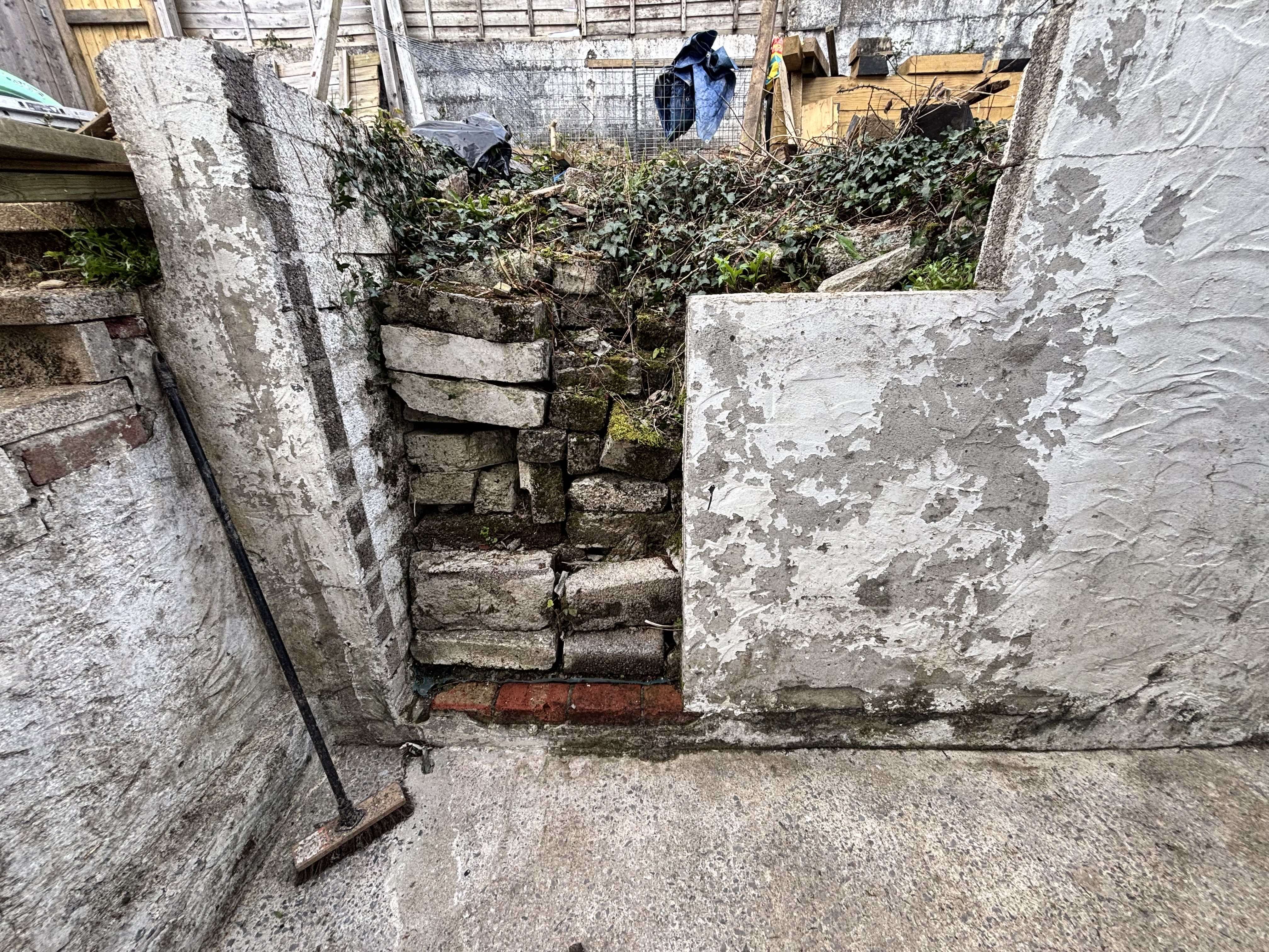

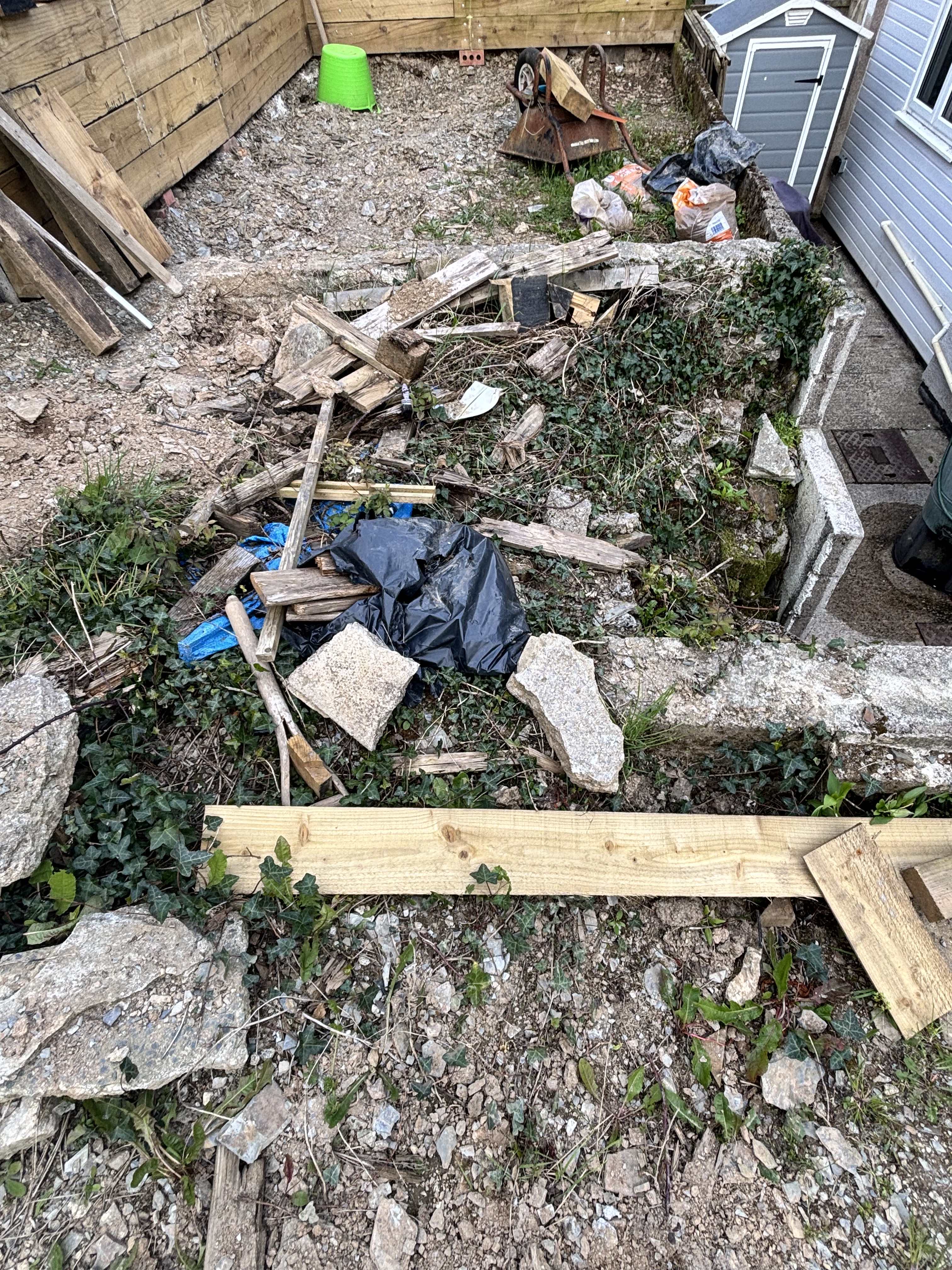

  1. Thank u for the reply - good thing is that crack block is only at the front and sides seem fine. I guess keep digging to find out the state of the back and replace if required
  2. Hey thanks for the reply- yes both sides are retaining the top tier of the garden - I could only post one picture earlier have included another from above good idea about a shed - just need one with a strong enough roof to walk to the other side of the garden
  3. Hello everyone After finally finishing the main house we are moving onto the back garden - we have been here ten years and the neighbours have said the garden has not been useable for a further 10. I’m curious what to do with this section. This used to be an avery with a walk on roof to use the garden on top. I would like it as a man cave or just a storage area. The story goes that the roof was worn so the whole thing was filled in - hopefully the birds were removed first Conveniently the neighbours were also working on their garden and had tons of blocks and soil to get rid of so moved it into what became my garden - seems to me they took advantage of the previous owner here After poking around, the side walls are solid but as yet to find out the back wall. The back wall is dug into a sloping field. If ok what roof system could I put here that would be safe to walk on - was thinking maybe deck on top of the roof suspended between the two opposite sides if the wall is damaged could a block wall tied into the sides work - drainage? My garage has a similar setup which I tanked and have had no issues. We are in no rush to this project as we have a front garden we can use but I don’t want to just block this up and go over it when there is a chance to use it. I understand it will cost a bit to remove all of the contents and if it’s a case of ‘get a pro in or u will die’ I will still like to see ur suggestions just so I can understand the reasoning behind it Thanks Measurements are: 2.5mx3m Height 160cm
