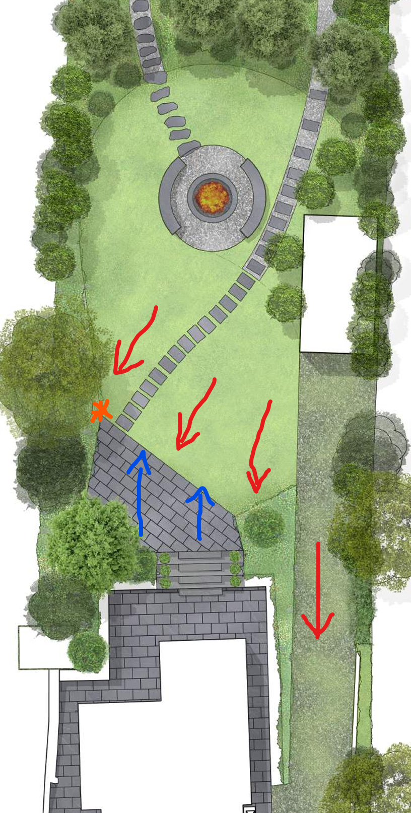

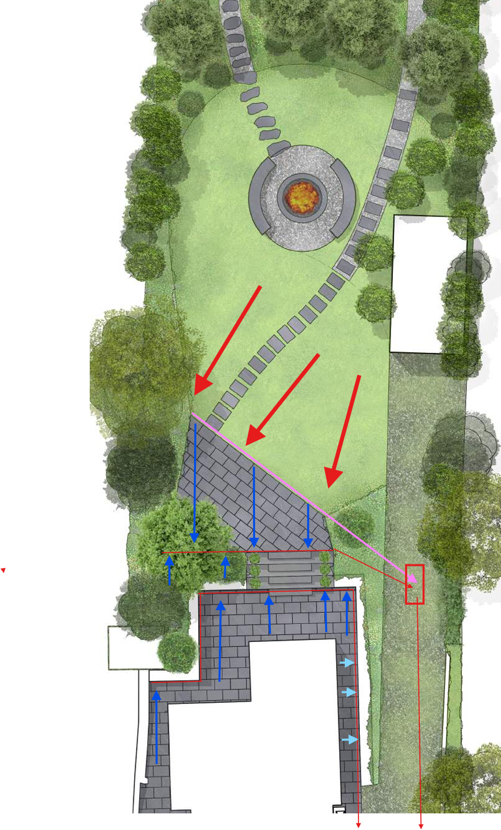

  13. is 1:80 fall adequate for next to the house? a bit of mixed info out there.
  14. Here is the alternative i've thought of. This red lines are channel drains. Pink line is a french land drain drain. Thick red lines fall of land. Blue lines are fall on the patio. Which would you do?
