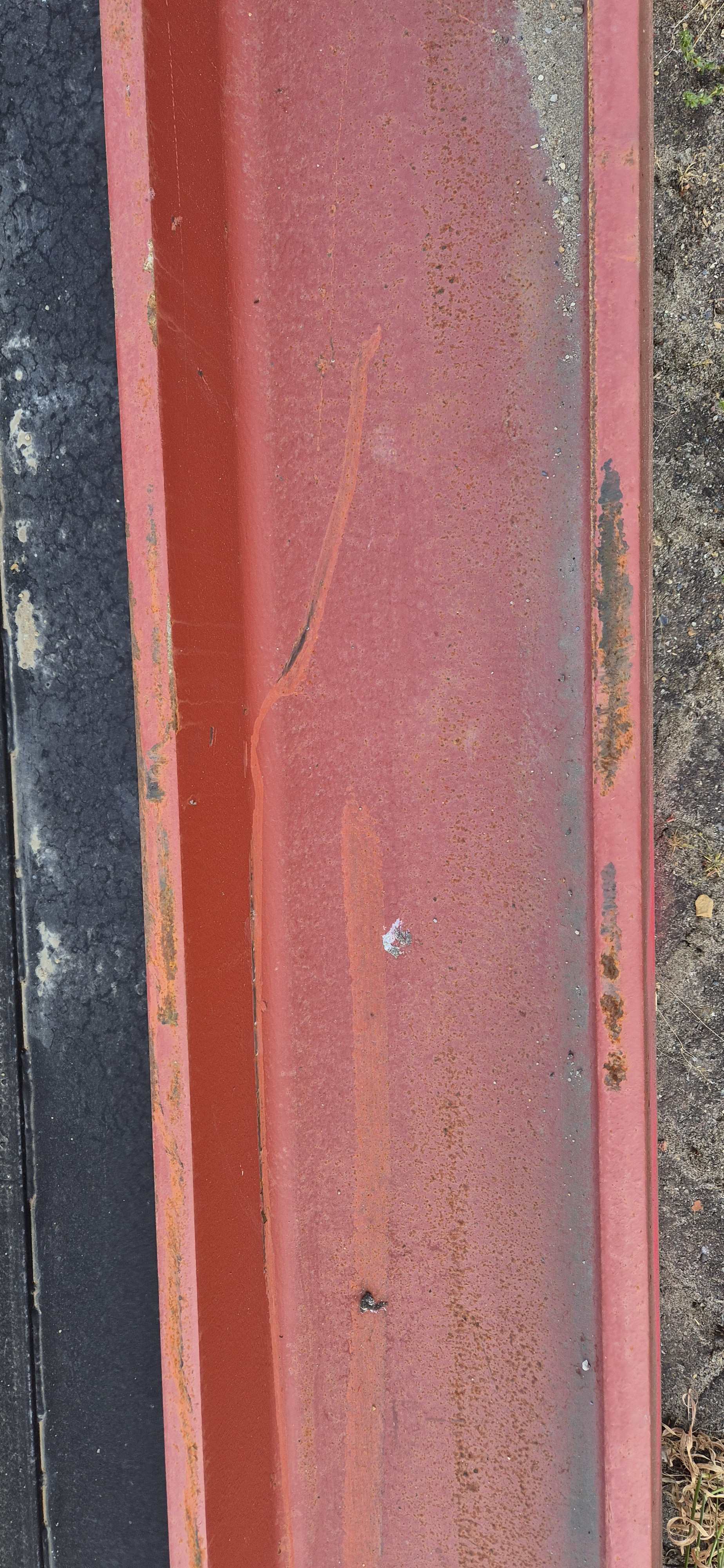

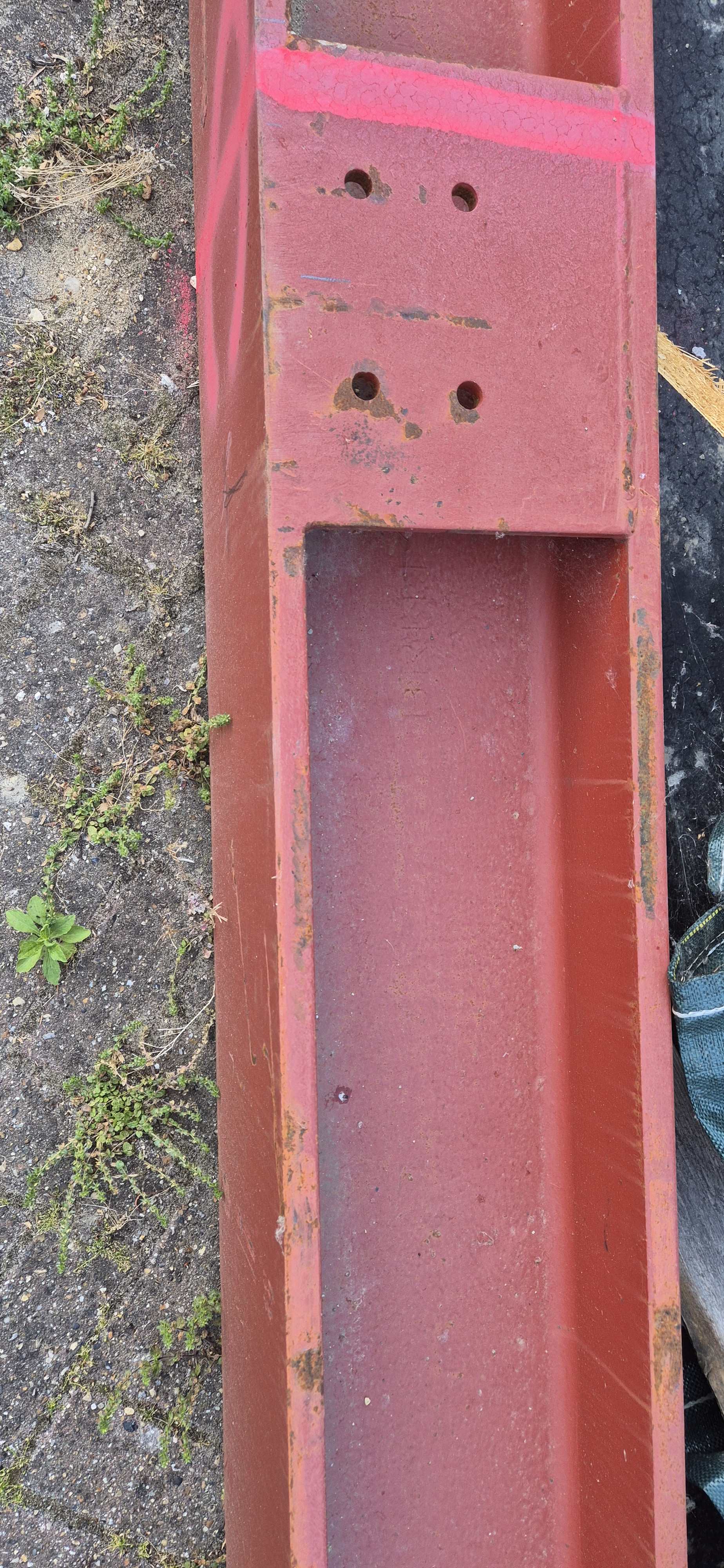

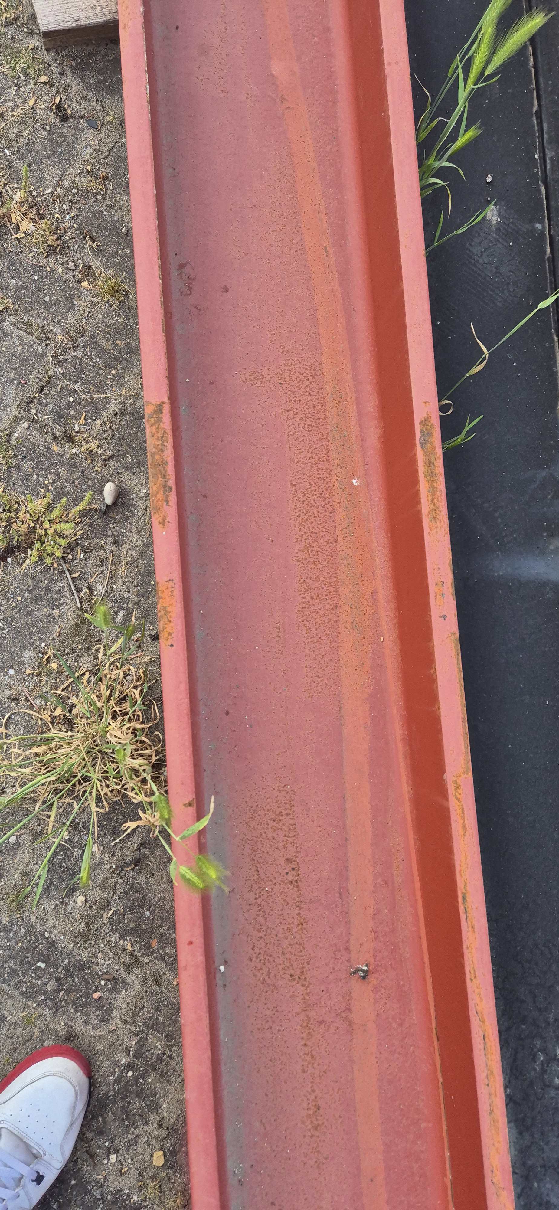

I had a rather large UC delivered a few months ago that is to be used as a beam to form a new opening at the back of my house for a single storey extension to be built off it. None of the surrounding brick/blockwork will be an externally exposed surface. There are some patches of rust on the beam, these were basically there from point of delivery and are mostly from where it has been supported etc from moving it around. Will I need to touch these up with some red oxide before it is covered or will it not make any difference?

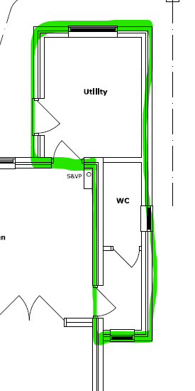

Hi, I currently have a single storey wrap around section to my house containing utility and toilet that is part of the original early 80's construction, as shown. It has a double pitched roof over the utility, becoming mono pitched over the WC area. Currently doing some renovation work and have all the ceilings down, this area has no insulation in the roof, which goes some way to explaining why it has always been freezing cold! What is the most practical way to insulate this roof from below, before I put new plasterboard up? I know I can just stuff some mineral wool up there, but how do I maintain ventilation? There were indicators of condensation (damp patches) on the back of the ceiling when I took it down, does that mean I already have poor ventilation and need to look at doing something to the roof construction? If I just stuff 300mm batts up there, I will have to avoid a large area around the edges to ensure I am not just contacting the felt under the tiles. Any advice or pointers greatly appreciated.

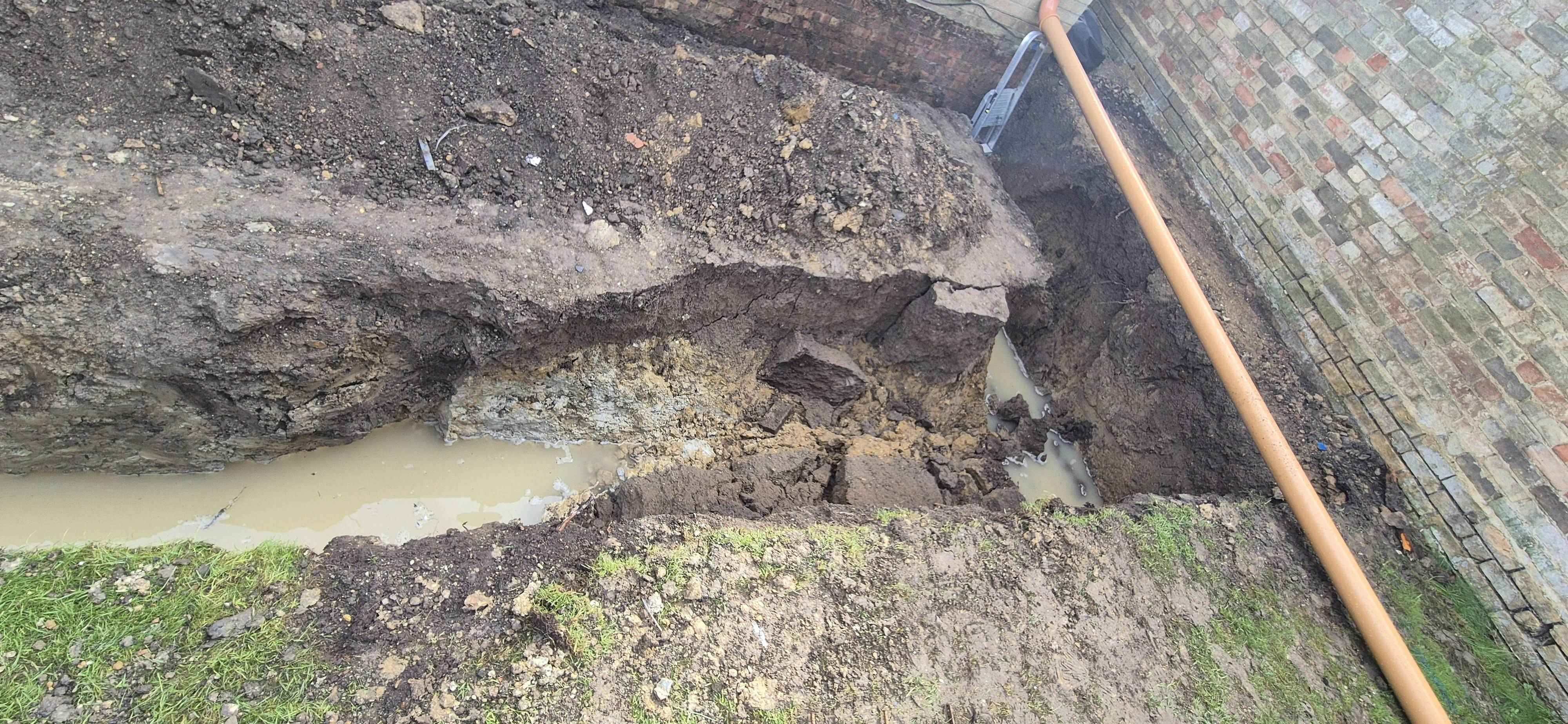

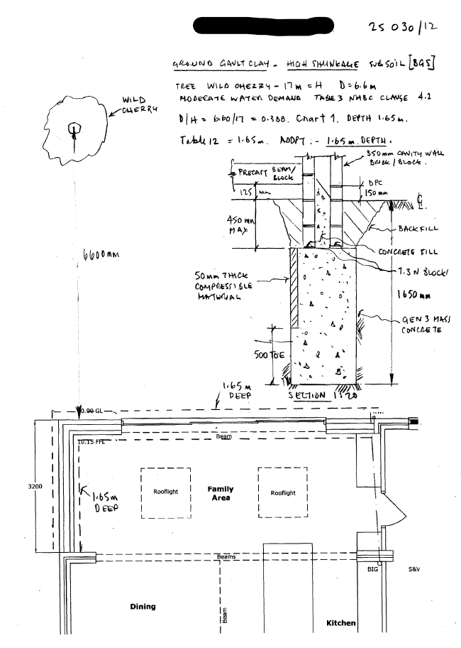

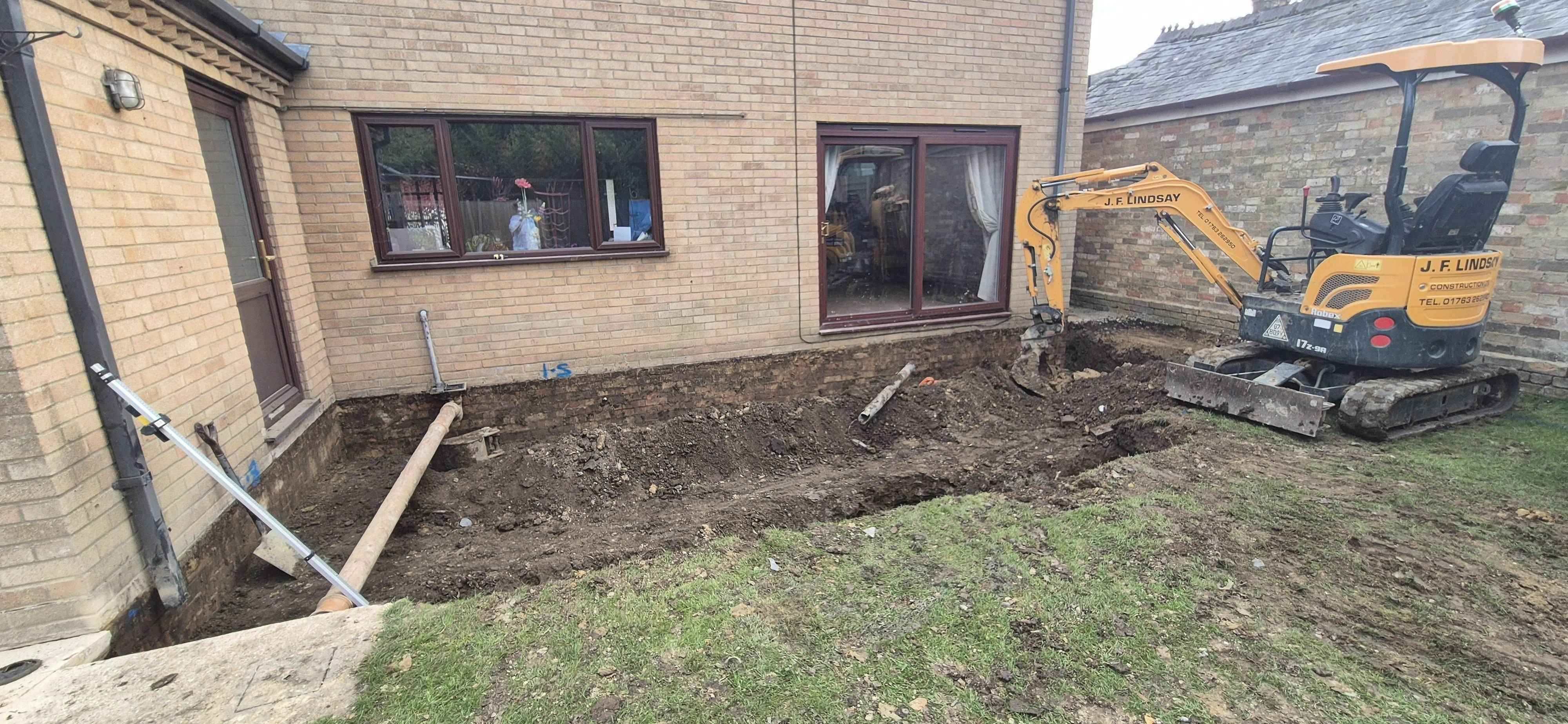

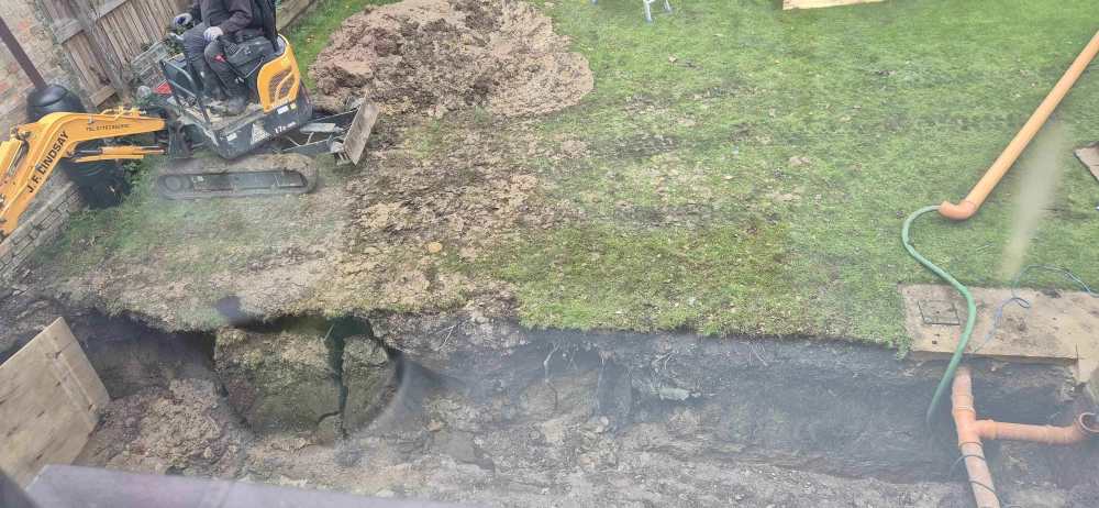

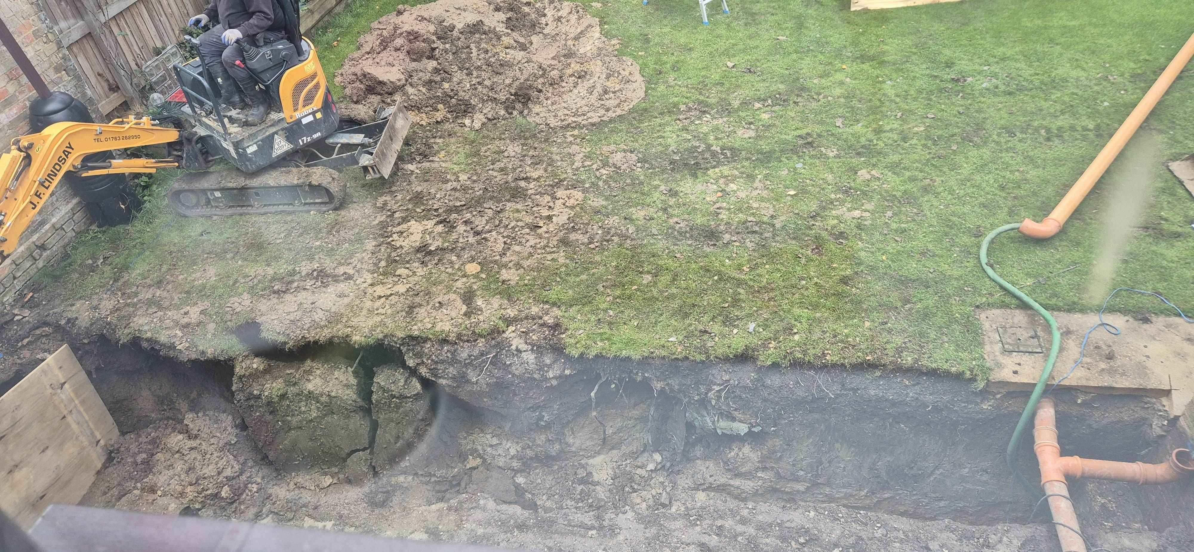

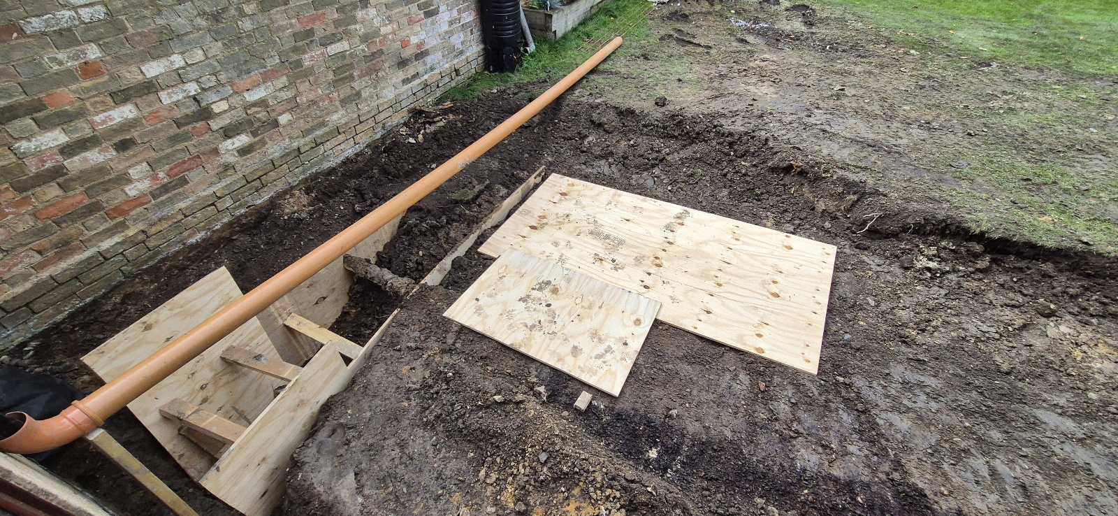

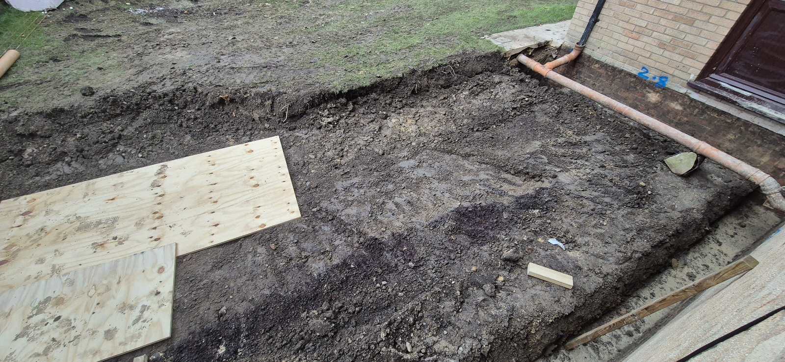

Hi All, I have been reading a lot of information on these forums, all incredibly helpful, but this is my first post. I am just starting the process of building a single storey rear extension (~7.5 x 3m) on my house. Ground type is gault clay and there is a cherry tree about 7m from the foundation location. SE drawings called for 1.65m deep foundation. We began excavation last week and had just finished it all at depth, including oversite, when one small corner within the oversite area collapsed. No biggie, plan was to dig it out and pump out any water ready for BCO inspection. Overnight, significantly more of the trench collapsed. the following day, when clearing the bottom of the trench, it was also noted that along the short side, which is close to a party wall, the ground was beginning to slip closer to the building. This was immediately shored up with ply and the decision was taken to begin backfilling the trenches before any further collapse happened, particularly ahead of the storm that rolled through yesterday. Half of the excavation was perfectly stable, and was going through the clay ground, the areas that were collapsing appeared to be a pit of soil! And no tree roots have been encountered making the whole process rather frustrating. I am at the point now where my SE has recommended we contact some piling companies and look at a piled foundation with a suspended floor. I have had one quote back so far, and they are coming in at over £10k for the piling, with much of the gorundwork to be undertaken by someone else, and then they quoted over 10K for a reinforced concrete slab on top of that, despite the recommendation for a suspended floor. Sorry for the saga, now for the questions! First of, anyone have any suggestions for ways that I could proceed with the original concrete fill foundation plan but mitigate against the collapsing ground conditions? Groundworks guys said that even with shoring or shuttering, they think the amount of wet ground and collapse that was happening before, it would be difficult to keep the trench sides stable and the bottom clear to full depth. Secondly, is the quote for piling I have received so far what I should be expecting or is it a bit OTT? It was for design and installation of 8 SFA piles and cage forming over them, no additional concrete included in that, only what was needed to form the piles themselves. They also stipulated things like I would need to arrange a 1 tonne excavator and operator to be present the whole time they are there and provide a 250mm hardcore compacted base for them to work from among other things. Lastly, if I am going down the route of piled foundations, what do i need to do about the fact that I have already had huge trenches dug and backfilled? This ground isn't exactly compacted and will continue to sink as it does so under it's own weight. Do I need to get in there with a whacker plate and start compacting and refilling the trenches as far as I can? Any help, advice or pointers much appreciated at this point as currently feeling a little lost!
