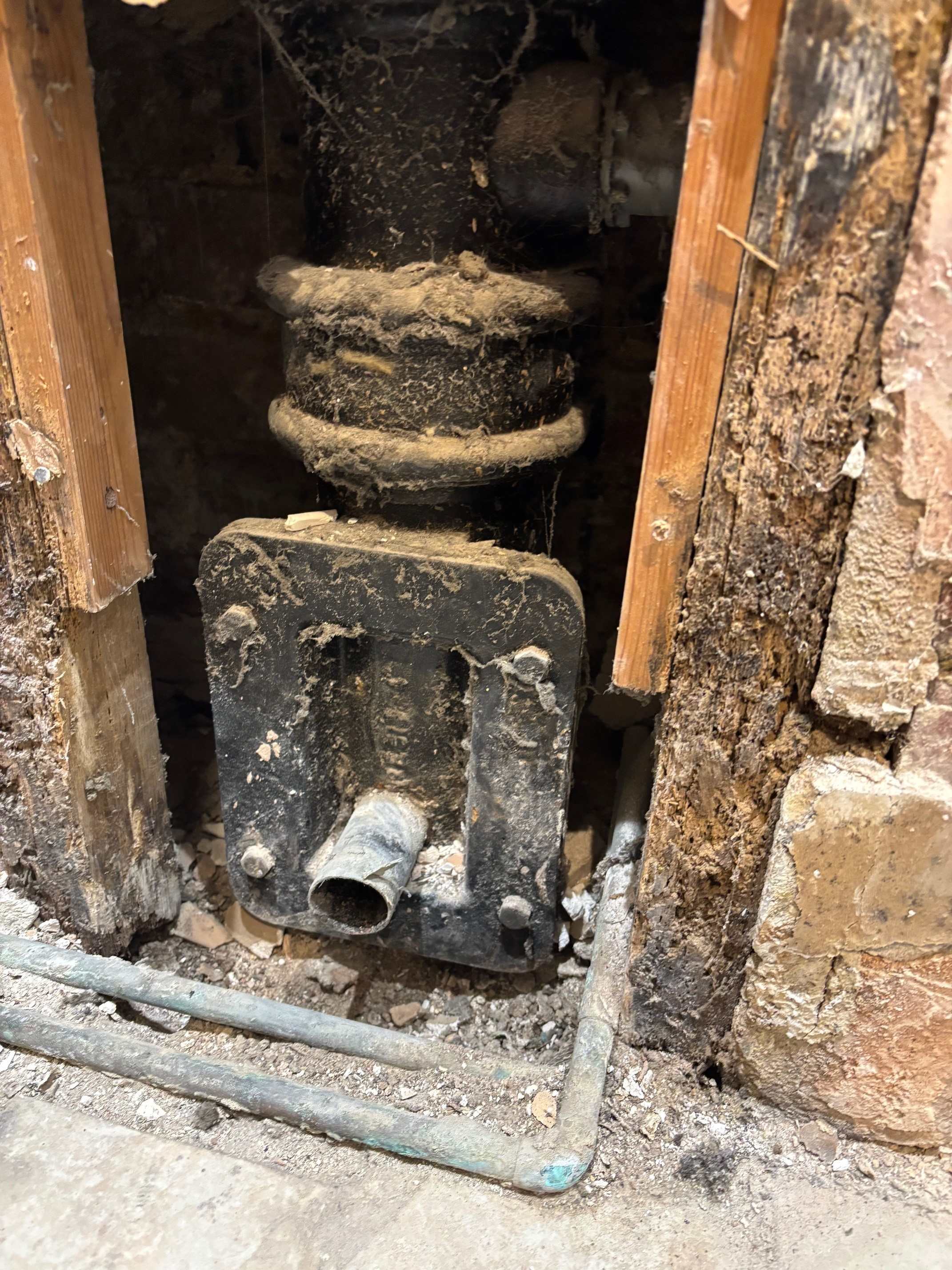

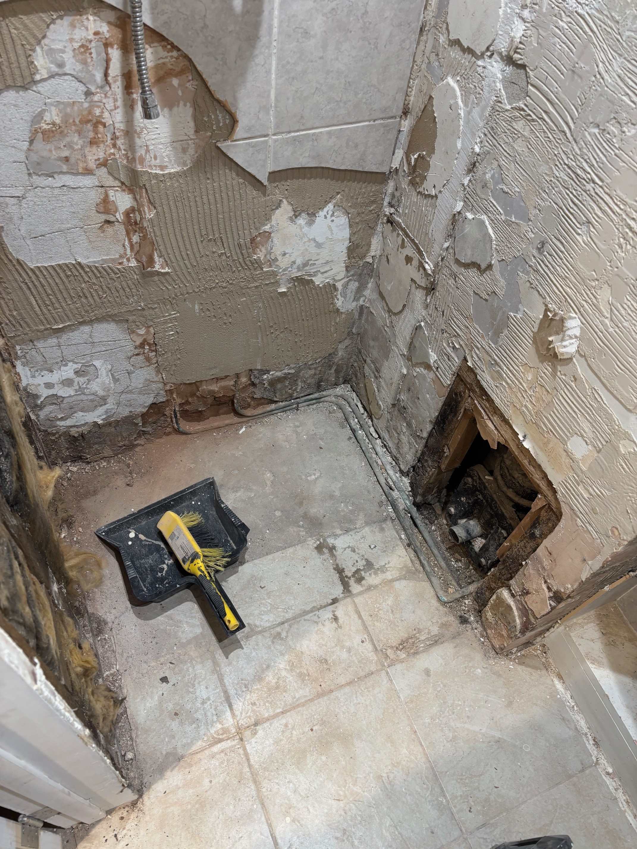

  1. Hi I'm hoping to convert an existing shower room into a cloakroom WC, to a flat within an old 1800's block. There is an existing cast iron SVP, within a riser, which has a bolted plate (access panel / rodding point?), with a 40mm copper connection on the plate which served the (now removed) shower tray, as per photos. Looking for any advice on easiest method to convert to a 100mm WC connection please. Would it be possible to bolt on a branch connection to the existing plate if this is is a fitting which may be stocked somewhere? It's Landlord services, so it's unlikely I would be permitted to cut into the stack to piece in a 110mm uPVC branch. Many thanks
