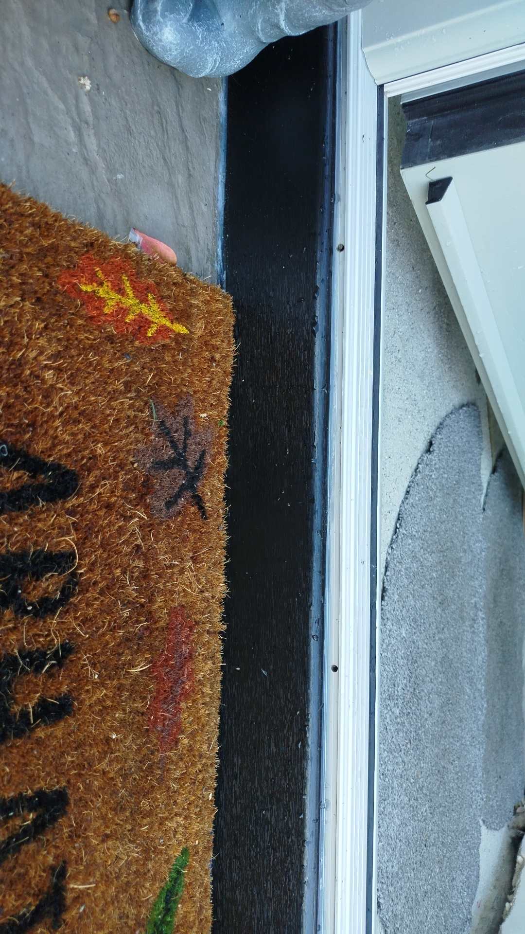

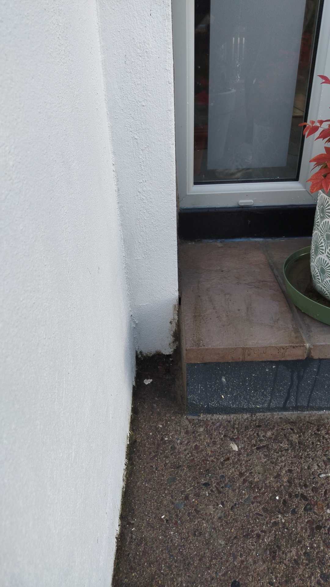

Yes I agree , I forgot to mention after they filled space outside with cement they also put a piece of MDF type cladding(black in colour) over the threshold and silicones this???

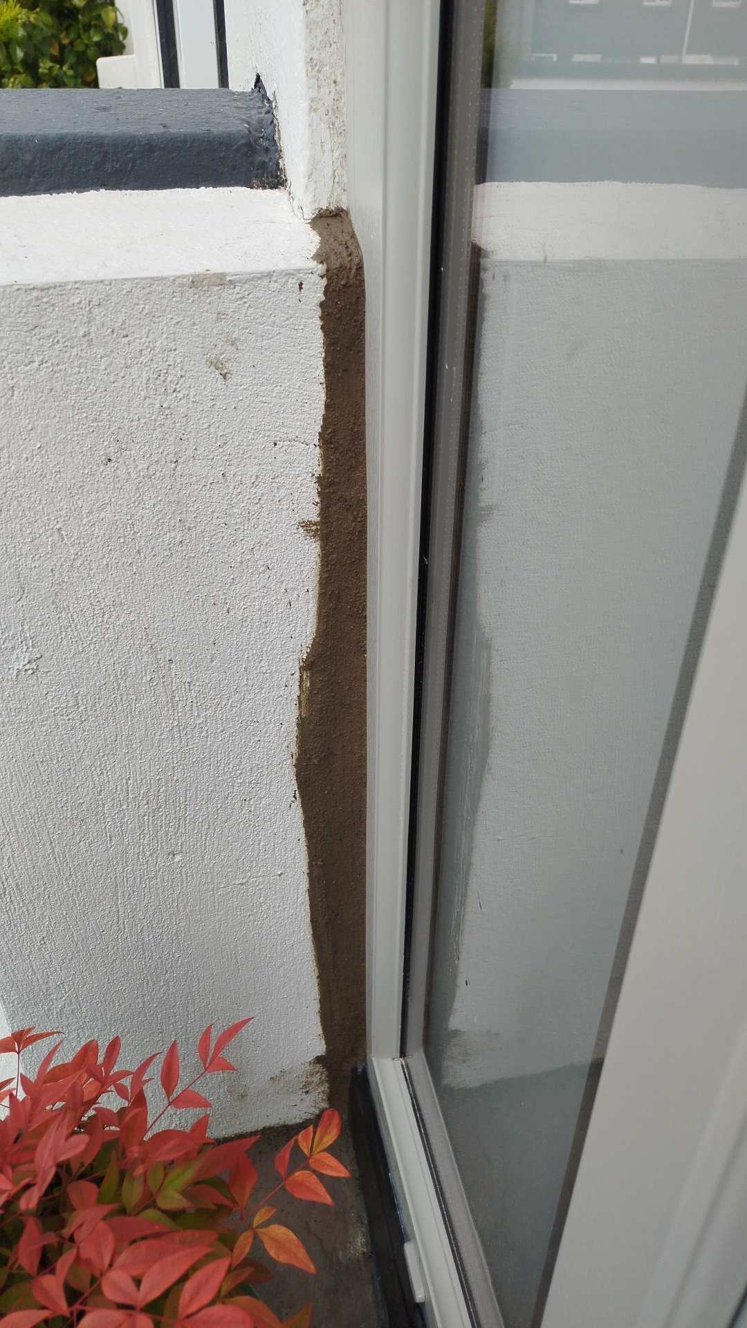

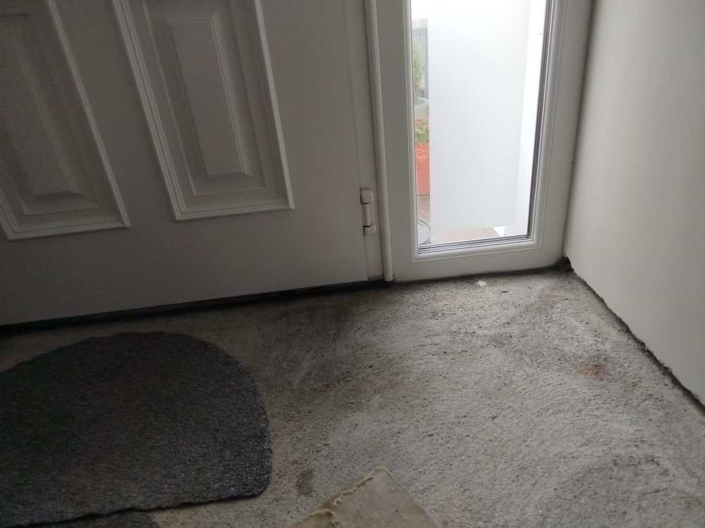

Hi Nick, I'm not sure if a damp course was put down under the concrete. The patch inside the wall was after the first rainfall however after the fitter removed and replaced dpc under the door threshold it rained quite soon after and the area was worse. It has only stopped after the wall area outside was filled with cement

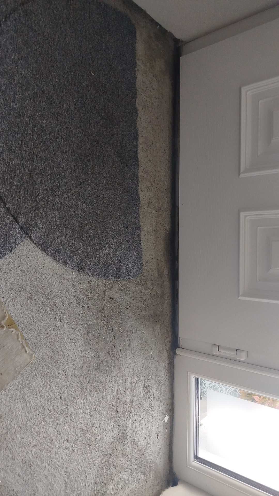

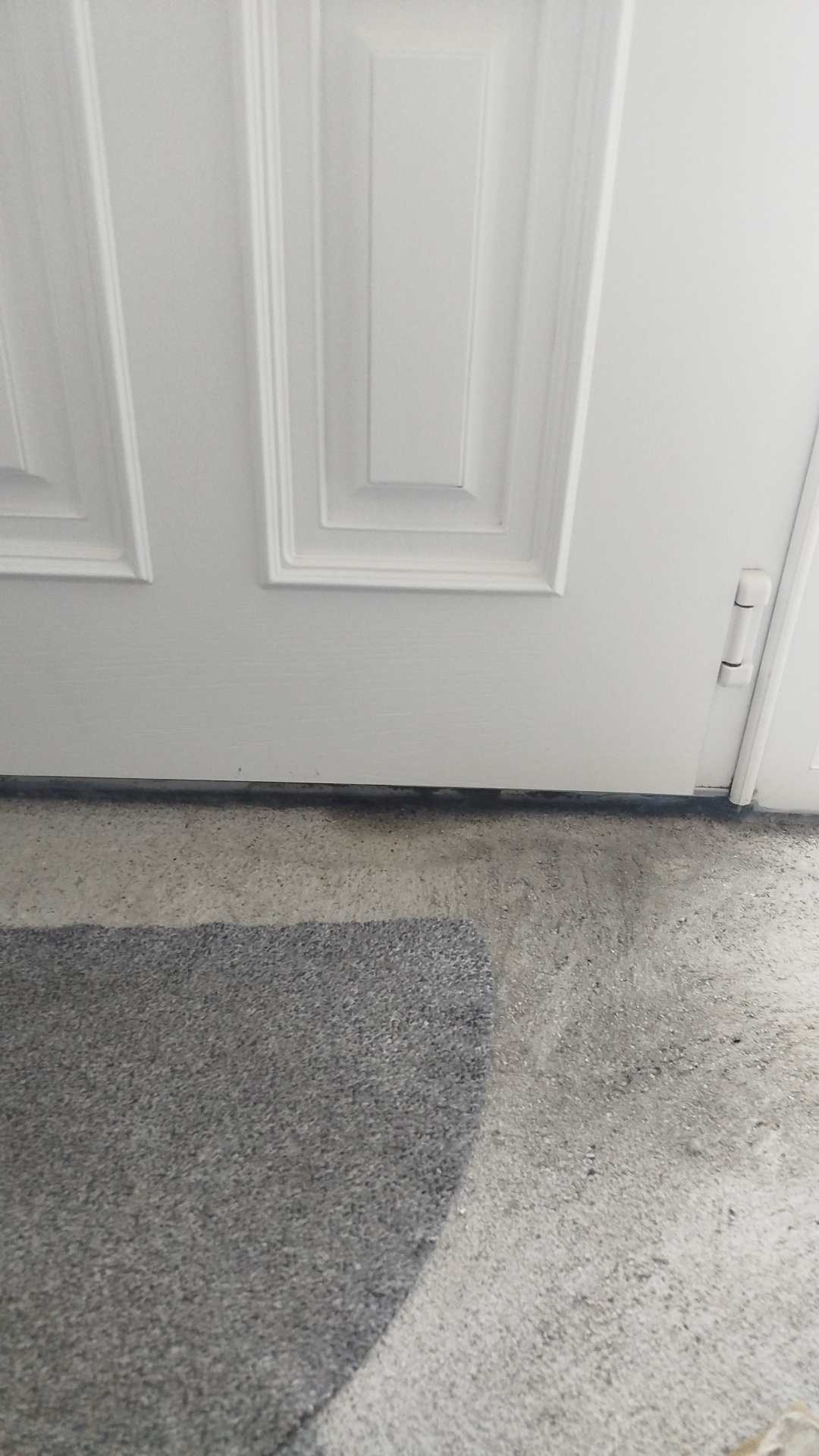

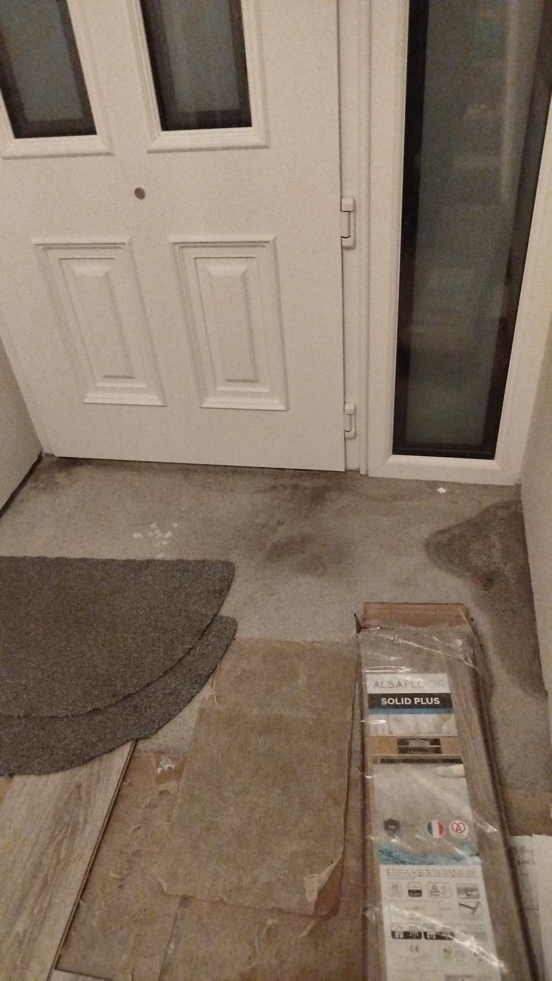

Hi Nick, I'm not sure if a damp course was put down under the concrete. The patch inside the wall was after the first rainfall however after the fitter removed and replaced dpc under the door threshold it rained quite soon after and the area was worse. It has only stopped after the wall area outside was filled with cement.i do think from day one the job was rushed and the fitter was not as you say competent to be filling, levelling and moving the door out. If it was just a straight forward changing the old door inside the porch it would be fine. I think I may need to get the company now to maybe get someone external that is qualified to actually find out what is happening. Currently we have only a small patch of damp and the other patches are just stains in the concrete. I'll attach a picture but it's hard to see.

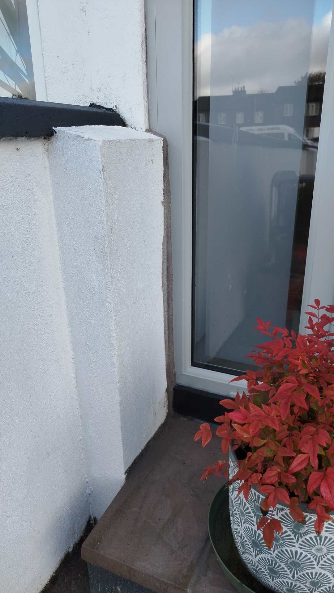

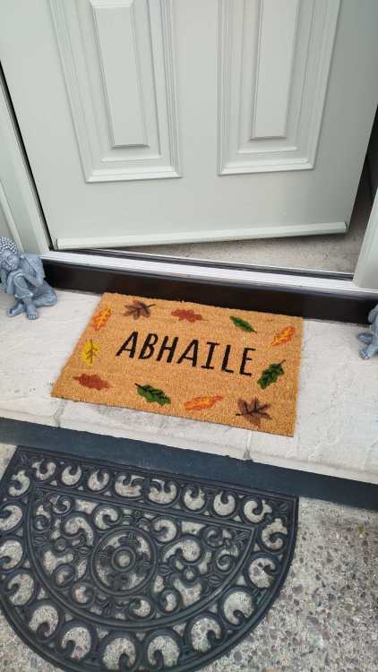

Hi Marvin, thanks for that, just poured the water over the door as you suggested and checked it afterwards. All seems to be ok with the seal. After the fitter sealed the outside left area with cement between door and outside wall support pillar this stopped the big patch of water that was coming in near the wall on the left hand side. I'm just thinking maybe there maybe a porous area or gap with the original walls that water is getting in somewhere still. It's very hard to exactly pinpoint it. I'm hoping that the small patch we have a the moment all we need to rectify. I'm hoping the other patches are not just temporarily sealed and I'm dreading after a few months when flooring is down that it reoccurs. Maybe I need to get door company to get another fitter or building company to check as I really feel they have no idea what elso to do,unless they replace the door which I know they do not want.

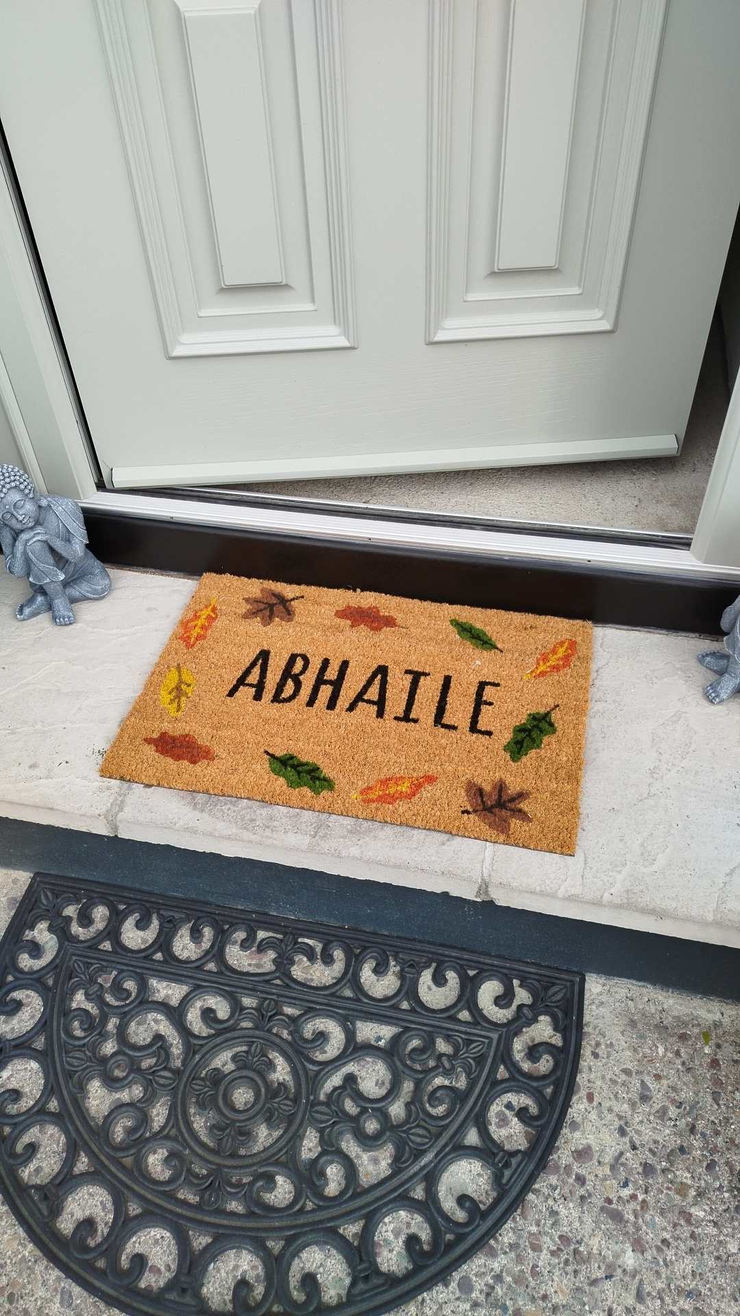

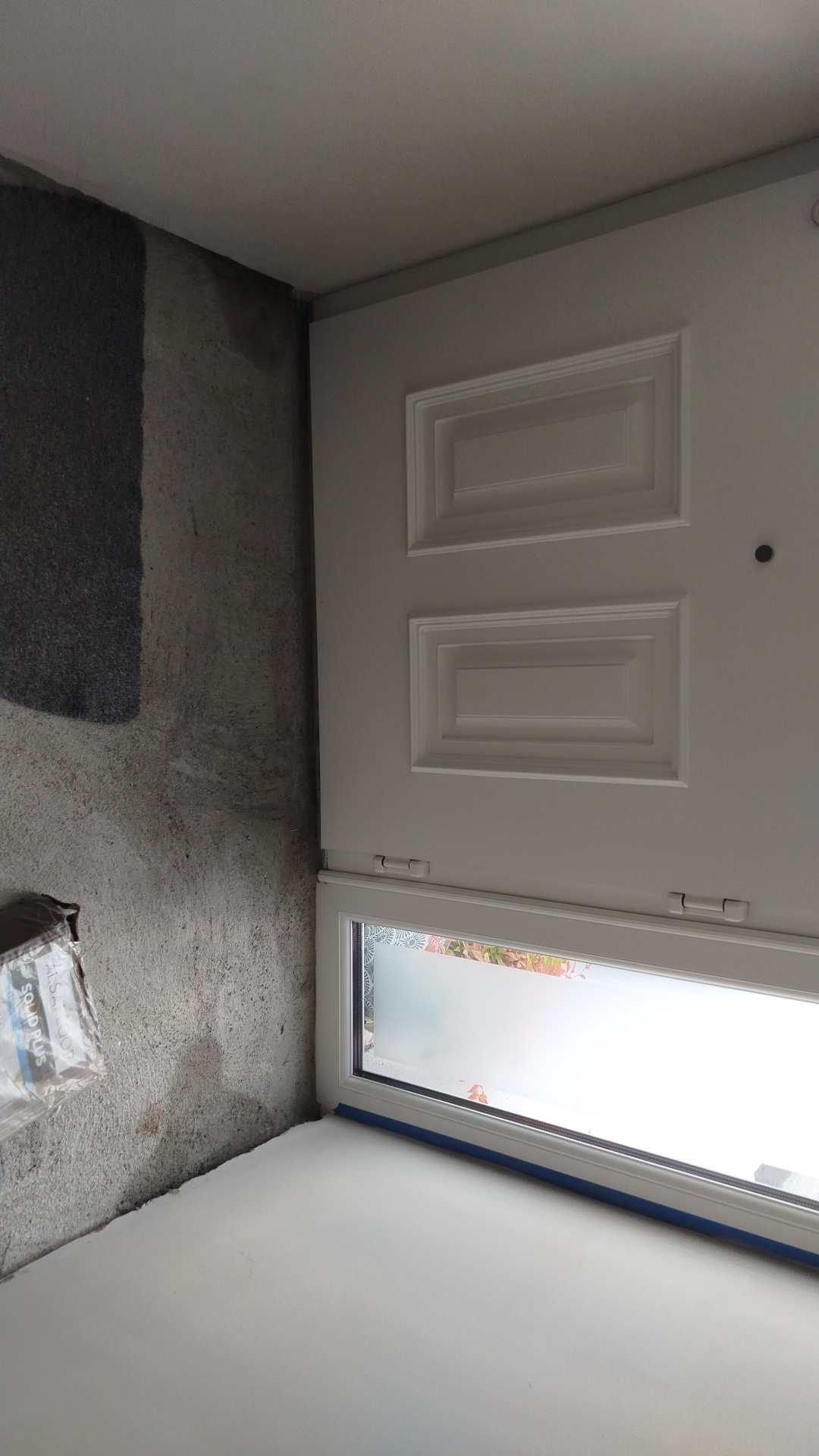

Hi I'm really at a loss of how to fix this issue and hoping someone could help.I had a new composite door fitted 1st of July. Our old door was in an open porch but new door we got was moved forward and concrete was filled behind the new door to bring flooring up to level with the existing hallway. First issue we had was the fitter poured the concrete too high and didn't level the concrete properly. Door was catching so we had to call fitter back out to rectify this by using a grinder and leveling the concrete correctly.Second issue was when it rained we noticed water seeping in through the threshold. We rang door company and they sent someone out to silicone around the door and check alignment, weather stripping ect. Still no joy and water continued to come in when it rained. Fitter called out and removed the threshold to put in new dpc incase the old one was damaged during the grinding of the concrete when re levelling. Threshold was reinstalled but still water getting in. Another call out was done by the fitter and this time he put composite MDF over the threshold and silicone inside and outside of door along the threshold. He also filled an external space on the left side of the door with cement. At this moment it rained heavy last night and this morning there is a small patch of water inside. It definitely has reduced but I'm 4 months trying to get this fixed and I feel like the fitter has run out of ideas of how to rectify it really. I have been unable to floor my hallway as I'm patiently waiting to get this resolved I have young kids so it's very frustrating. I have attached photos below. Last pic is the damp were still getting at the moment.
