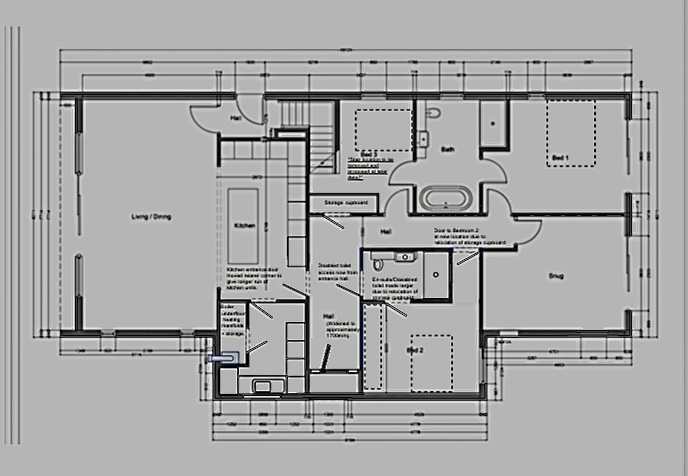

Thank you Gus, All good advice, I have spent 9 months researching this whilst waiting on planning and I have to tell my architect how the SIP’s/TF contractor shall do things, My friend who is doing all the civils is an experienced builder who has been dealing with building control for many years so I am confident that everything shall go smoothly, my plans are set in stone and only issue I have had was the Architect changing things to how he wanted, I designed the house at the start and told him if anything needed tweaked a little for the better to do it, unfortunately he completely changed door positions, started adding fitted wardrobes etc, in rooms that we planned to put our own furniture in, it taken six drafts to get things right and they ended up near enough to my original layout, I shall speak to my TF supplier to as about windows as they assure me they have never had any issues, TF company shall send foundation drawing details for my builder and I shall ensure all soil pipes are in a good location, I am waiting for two more quotes coming in then hopefully I can start progressing with sorting out prices for windows, MVHR, electrics, plumbing, etc kind regards, kevan
