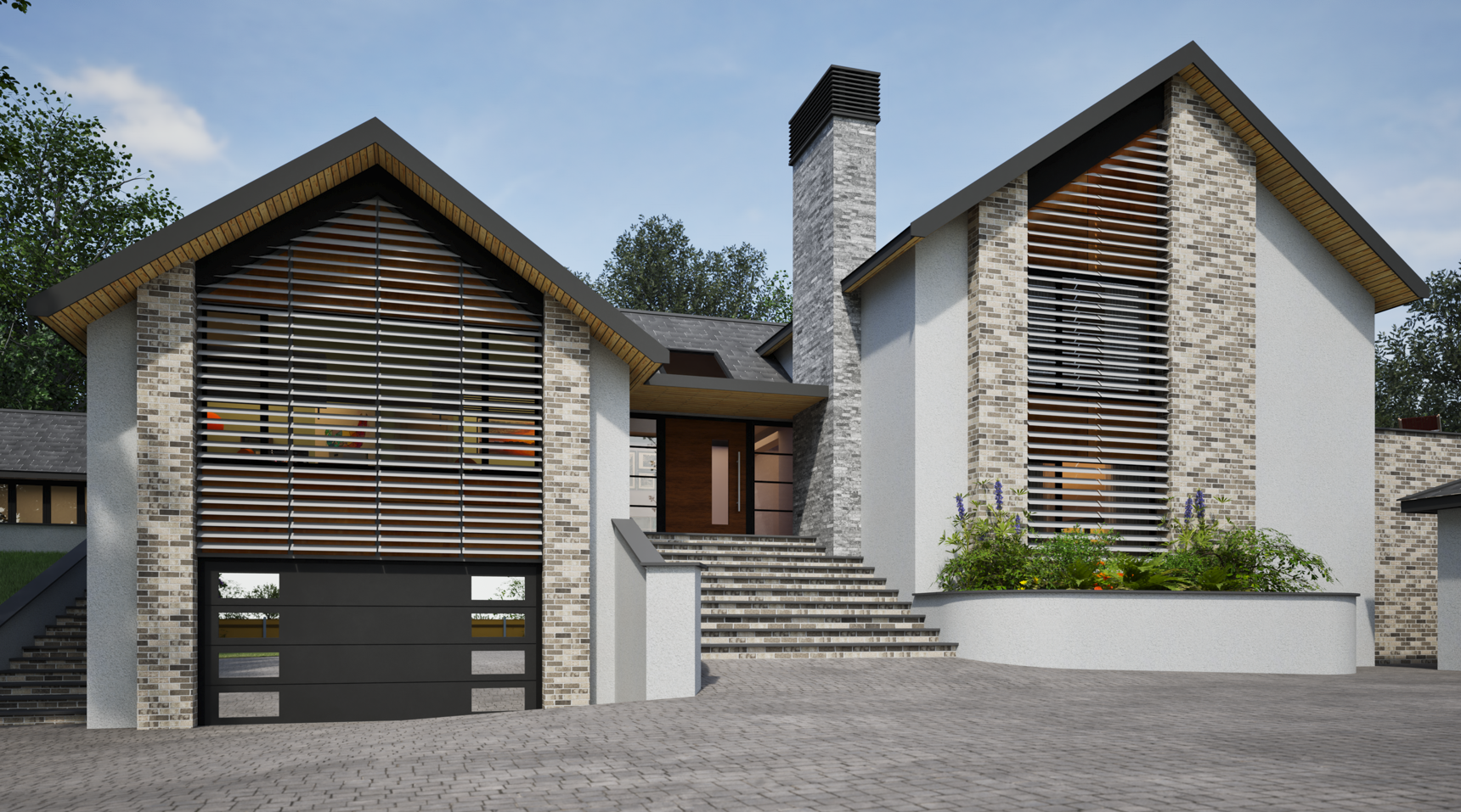

On our renovation project the exposed west elevation will incorporate adjustable external louvres to combat solar gain in an office (above garage), master bedroom and living area - as per this image. It would be great to hear others experiences and what features to consider and how they got on with sourcing and installation. I have started a discussion with Sunshield Unique Louvers- their website is a rich resource and their systems look great but I haven't found any client reviews online.
