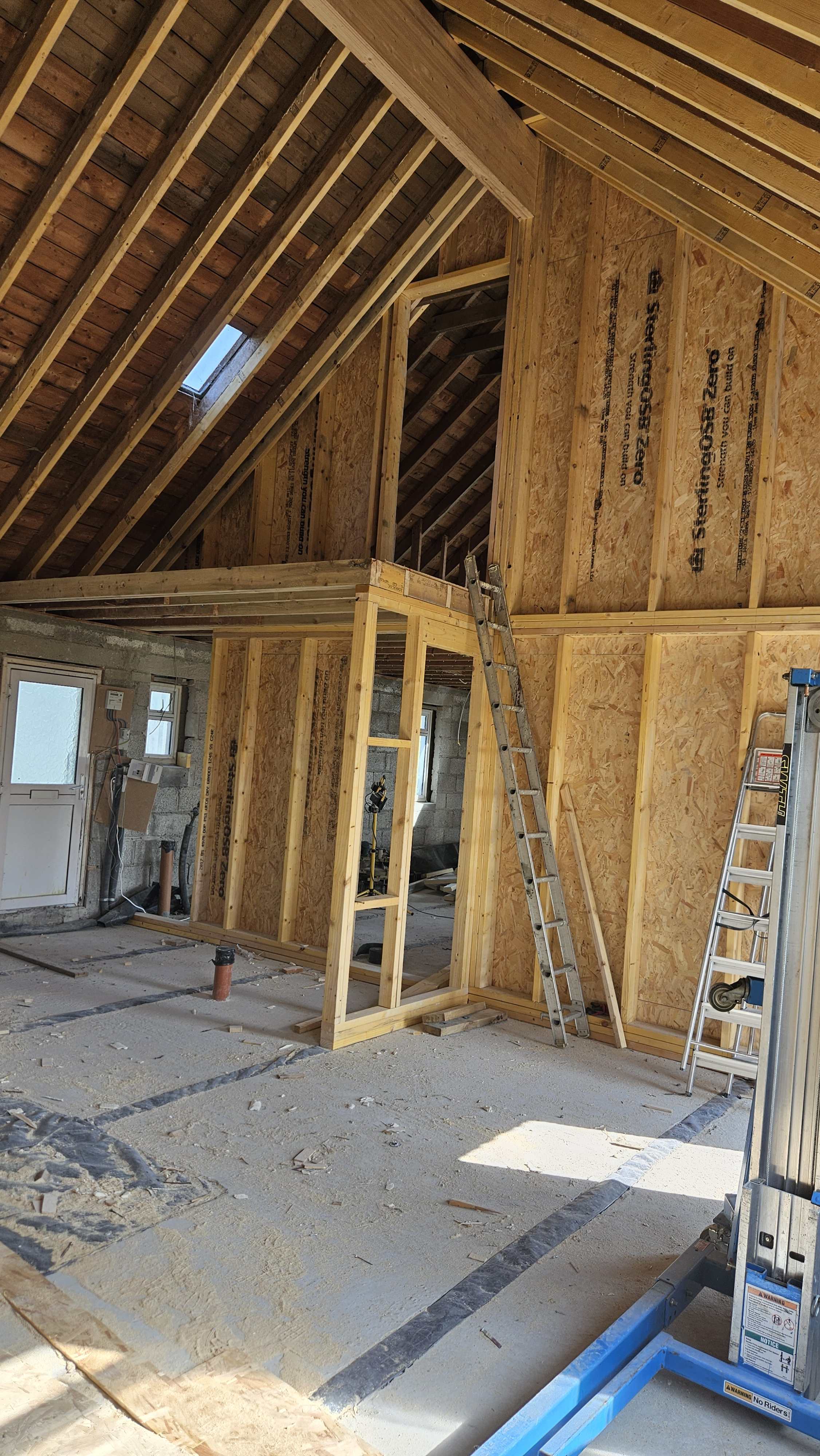

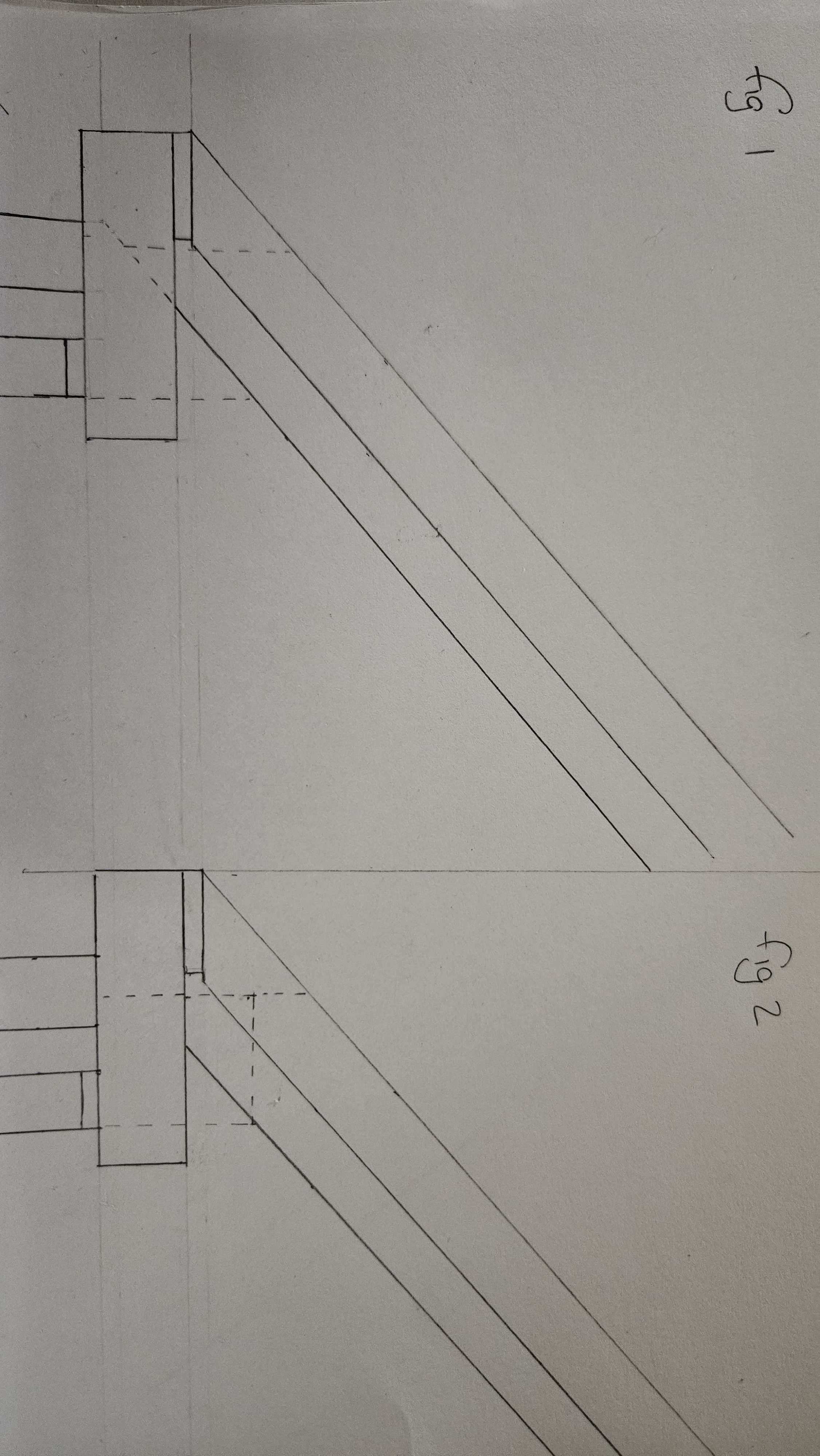

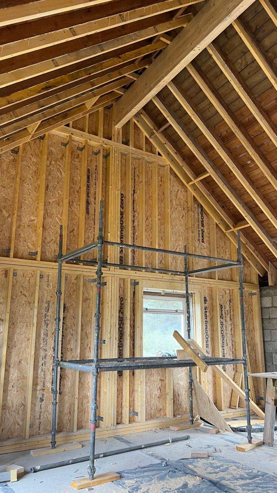

Just created a cathedral ceiling in a full house renovation project. Not easy, ceiling ties and rafters meet outside the walls of the house. Got around this by adding 4x2 glued and screwed to the original 5x2's, resting on a glulam beam. I have to double up some rafters with 9x2's, but even these don't meet the top of the walls. Thinking of either adding timber triangles at the bottom of the rafters as 'fig 1' or preferably add legs as per 'fig 2' on sketch. During the construction of the cathedral ceiling, timber triangles were glued/nailed between what remains of the ceiling ties and the rafters, before both sides were strengthened with ply gussets. Does anyone know if adding legs to the bottom of the new rafters (for velux) would be acceptable (to allow a connection from the wall head to the rafter)? Been looking for similar scenarios online but can't find any.

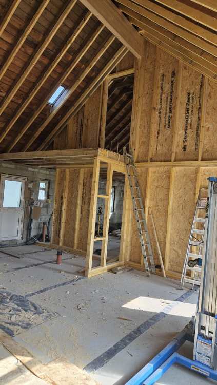

Hi, I'm also from the Highlands (Skye). Just converted a 70's house, turning half of it into a cathedral ceiling. The other half has a large 5m x 5m room/ensuite upstairs. The span of the house is 7.4m inside walls with a central load bearer running down the length, so approximately 3.7m each side of the load bearer. The first floor joists used back then were 6x2. Would you think the floor joists with a span of 3.7m either side of the (4x2) load bearer would support a 25mm biscuit mix without too much bother? Because the 6x2's kind of spoil the aesthetics when looking at the floor/ceiling from the open plan area, I also plan to brander the ceiling, also to make running services easier. Attached a couple of images of the cathedral ceiling which is 6m high. The open plan kitchen/lounge will be 7.4m x 6m. Many Thanks for any pointers

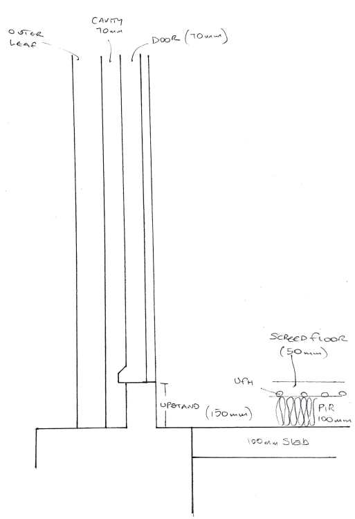

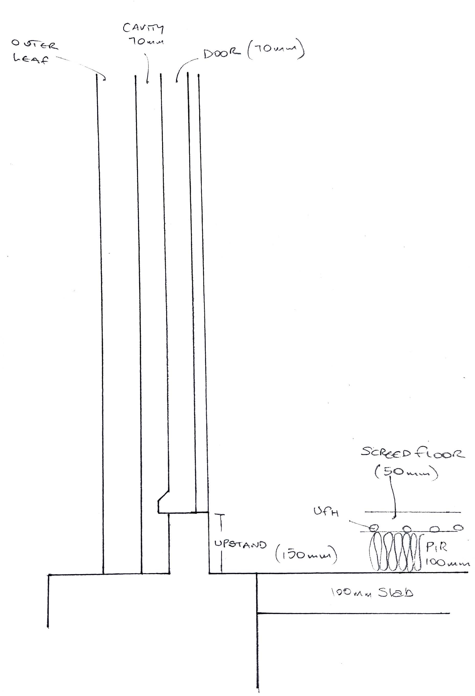

hi, looking for advice for replacing an external door threshold/upstand. Full strip out, floor void filled 75tn type 1, dpm, 100mm c30 with a252 mesh. Will be installing new windows and doors. As is usually the case in Scotland, doors and windows are check revealed. Some point in the 1990's Everest fitted new windows and doors, though the windows are in the check reveals, the doors were brought in line with the inner block leaf instead of the cavity and the cavity was closed on the outside of the building. I want to move the face of the door back out to where it should be - the outer face of the frame meeting the inner face of the external block leaf. the slab is already poured and I will be adding 100mm PIR, UFH and a floor screed. This can be from 50 - 70mm. I'm looking at a few products such as compacfoam, marmox and triotherm. I'd want something thermally efficient which can support the weight of a normal size composite or timber door, but sits on the step which already bridges the cavity. I would rather it didn't protrude so as to show on the inside of the house because I'm hoping to polish the concrete screed. So I'm looking for something that can be used as an upstand and threshold for the door, as shown on the diagram, I plan to cut away the upstand that is there now. Thanks for any tips
