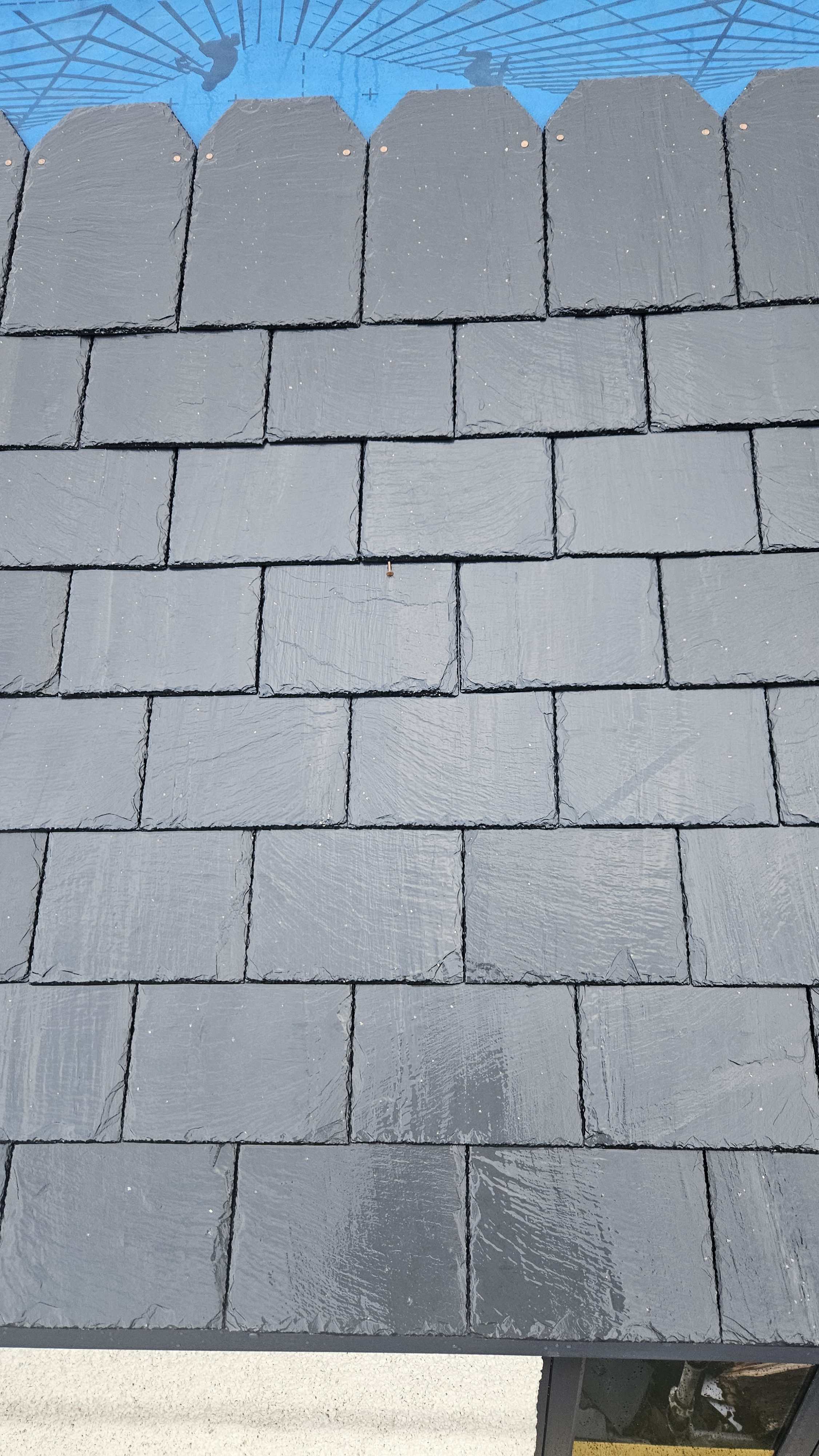

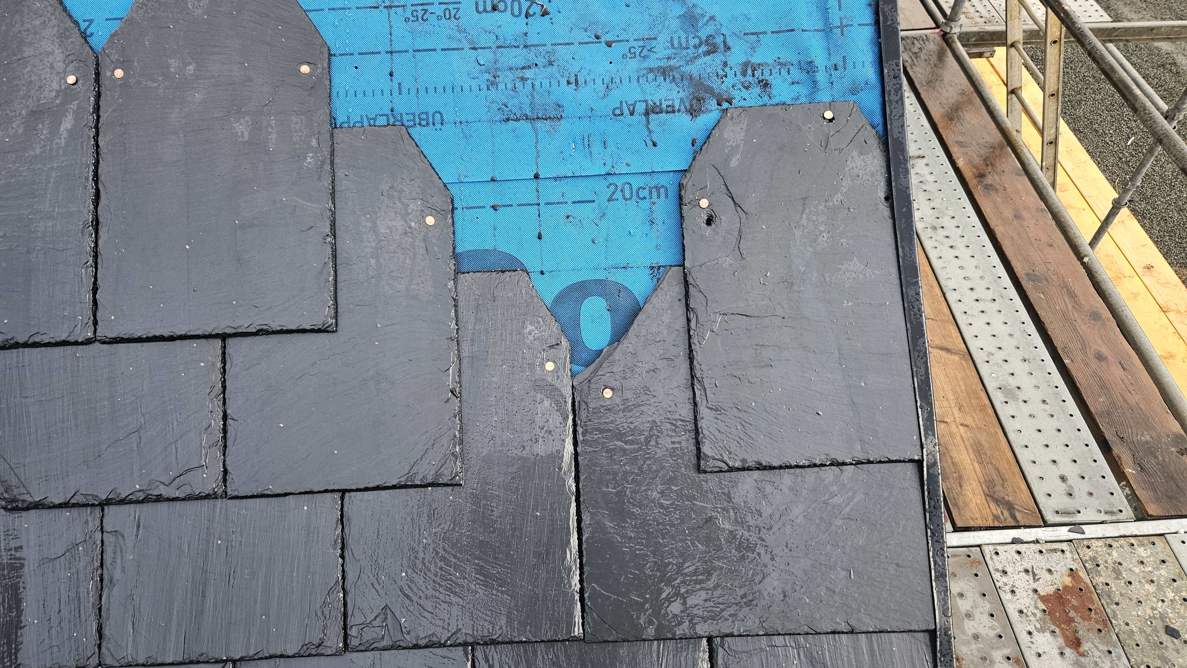

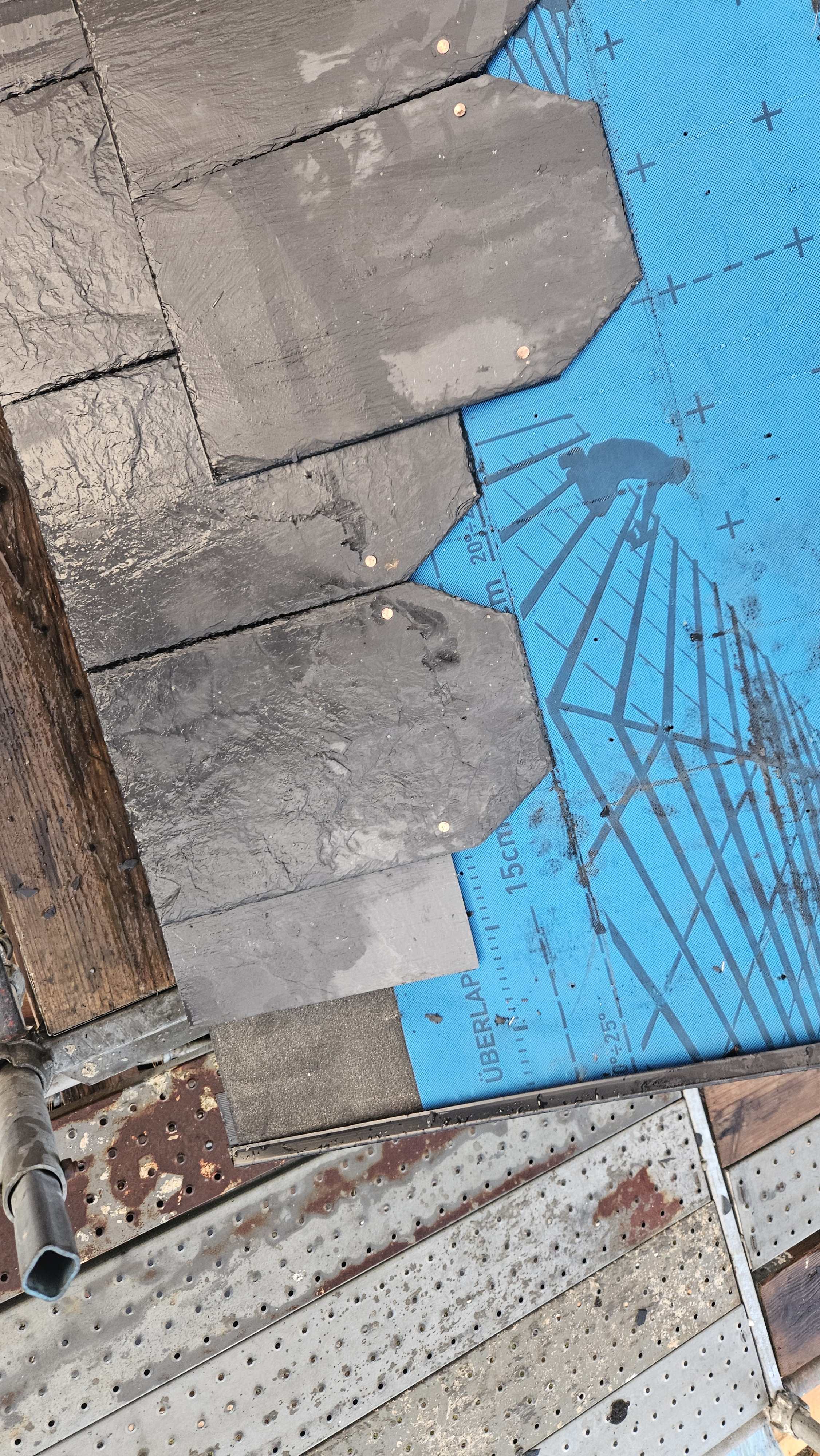

Hi Mr Punter, thank you for your reply. I did mention that there wasn't a great deal of information online regarding dry verge installation. I was hoping to get a perspective from a professional or experienced DIYer regarding how much dry verge overlap would be advisable, particularly in sometimes extremely wet and windy conditions, besides the obvious, that it just looks wrong to me. Hoping for an experienced person to say whether the preference would be a small gap between slates or trimming a slice of both end slates (or both) so the dry verge would butt right up to the barge board. Thank you.

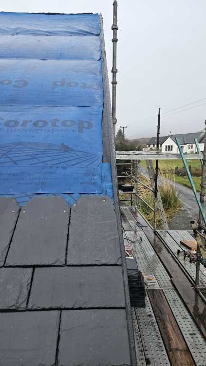

Hi all, Seasons Greetings. I have a question regarding Dry Verge (Scott Verge) on a slated roof. I received a rip snorter kick back injury so couldn't slate the roof myself, my fingers are still there but the nerve pain is ridiculous in the cold. Anyway, I employed a roofer to install membrane, Dry Verge and slate. The roof is 13400 wide x 5400 high (@ 250 wide slates, 53.6 slates - the roofer obviously didn't want to trim any and laid out 54 slates, 53 slates with a tiny gap between them would have been just about perfect imho). The slates are CUPA Heavy 3's @ 400x250. When the roofer installed the membrane and Dry Verge, he obviously just laid out the slates until they at least covered the roof and wherever the last slate landed, installed the Dry Verge. The slates were butted up tight to each other (I know in some places there should be a 2 - 3mm gap, not usual up here in the Highlands). I told the roofer that the gap between the Fascia and the inner edge of the Dry Verge was far too big, approximately 50mm too much at each end. I have another house opposite which has the same Dry Verge on a slated roof but fitted tightly to the Barge. The Dry Verge should run into the rain gutter, one of my concerns is that the way the roofer installed the Dry Verge, the rain gutter would protrude the gables excessively. There isn't a great deal of detail online regarding the placement of Dry Verge when installed with a slate roof. Personally, if it was me who was installing it, each end slate would have been trimmed by a couple of inches, or use 1 less slate per course and leave a small gap between each slate. The slater was wanting £11k for a couple of weeks (labour only), maybe it's my fault for expecting a more detailed finish. The membrane fitment in regards to the Dry Verge was terrible as well. The membrane should just 'lap' into the channel of the Dry Verge, but in fact it barely reached it. I mentioned to the roofer that I could actually see roof timbers between the membrane and the Dry verge. This caused the roofer to quit. In relation to the location of the Dry Verge (overhang), when I mentioned it to the roofer, he pointed out a line on the Verge, telling me he installed it correctly, according to that line. I thought he was just making excuses because the line he pointed to was a moulding which diverts any rainwater that gets through between any slates, into the Dry verge channel - similar to how lead can have a slight fold to divert water. He also told me that up here, we don't install membrane into the Channel because it 'wickes' water. I disagreed, membrane is designed to not wick water. The amount of slating that was done before the roofer quit was certainly nothing worth writing home about and to be honest, as peeved as I am that the roof isn't anywhere near finished, I feel that I've dodged a bullet, now that he's quit. Does anyone have the definitive answer, should the Dry Verge be fitted as near as possible to the Fascia, regardless of how many slates are used in a course? Should the slates have been trimmed by a couple of inches at each end or use 1 slate less per course and add a tiny gap between each slate? I live in the North West Highlands and exposure to sometimes severe weather extremes can add another dimension to overhangs that are excessive. The old roof was lightweight fibre cement slates and they had a slightly less overhang, although there was no dry verge fitted back then, the tiles would still sometimes get ripped off in a storm. Am I being too fussy or expecting too much? Any advice would be so appreciated. Thanks

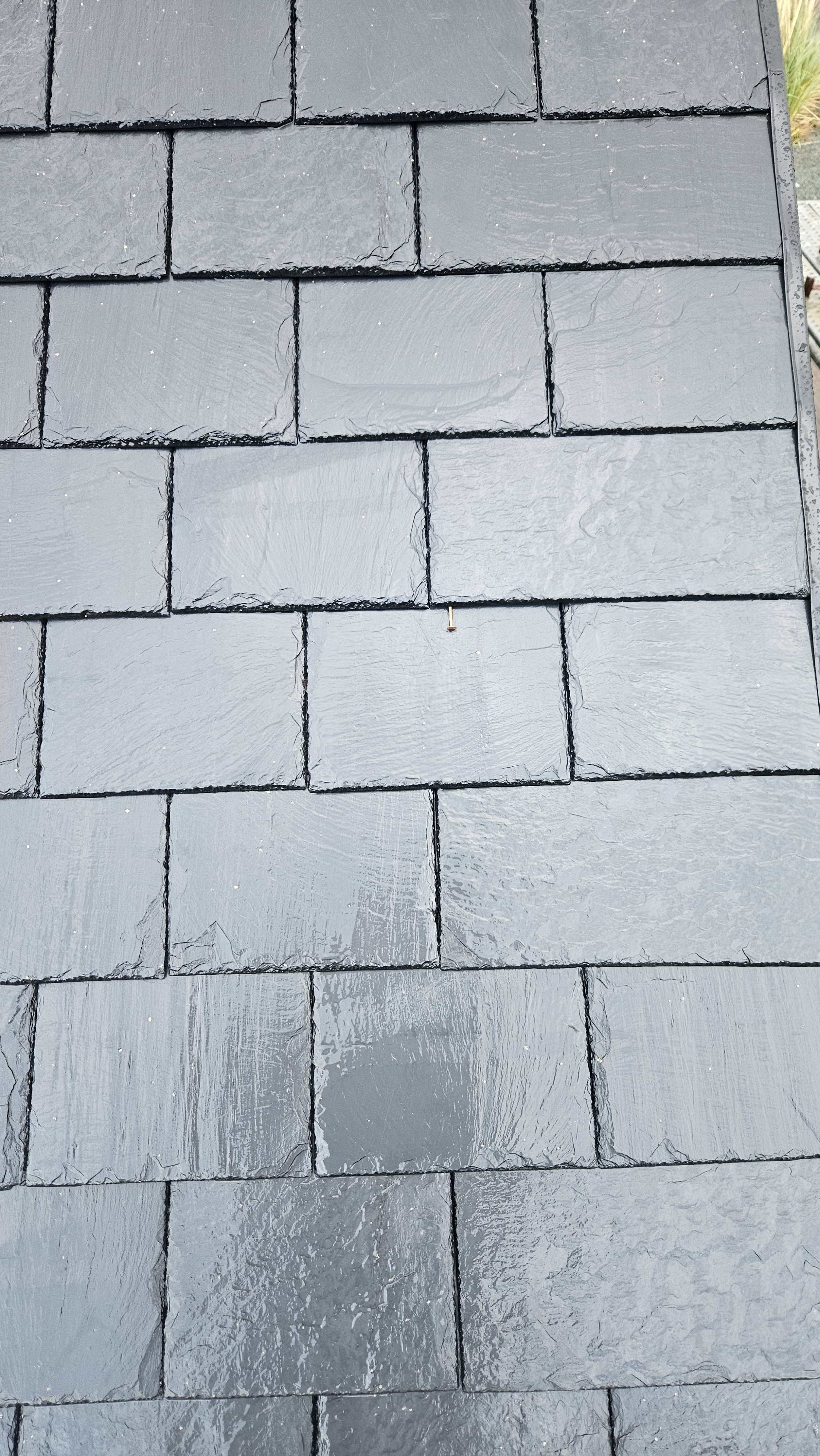

Okay, here goes. 1. I wasn't happy with the way the slates were installed ungraded. When the slates were fitted the (much) thicker slates were going on too high up the roof. Some of these slates were domed, quite a bit thicker in the middle than nearer the edges, more unsuitable for higher up the roof slope. They were just asking for trouble due to the gaps left when the next courses were laid. Example photo included. The first 4 or 5 courses looked great but the slates used here were more even. After that they looked terrible. 2. I was being charged the money for Roof Shield but a far less expensive membrane was being used. I didn't like the fitment at verge. 3. I did look for a resolution with emails to prove. The roofer sent me an email where he asked if we could meet, each of us bring a witness and see if we could sort this out going forward (paraphrasing). I replied, telling him that we need to sort this out, my extra losses due to the damaged windows, VELUX Flashings, extra costs for installing new membrane etc comes to £4,900.00. I offered, by email, to split all of this cost 50:50 with him (email is saved), so that neither of us is too much out of pocket. He would still receive about £9k for 3 weeks work. In the same email, I offered to grade the slates myself, for him. His responded to my email telling me that I had 'crossed my wires', that he would not be coming back to work for me, the meeting was for only putting the past behind us. -

I stripped the 400 odd slates off that the slater had installed because I was unhappy with the membrane and to be honest with you, with the slating in general. He said that he wasn't going to grade the slates, that they were good enough. I disagreed. While stripping the slates, I found some slates on the higher courses were way more than the 20% tolerance thicker than slates fitted below them. I know it's tricky getting to show this in a photo because the higher the slates are, the more of the riven edge you see, so it's hard to tell on this image but I just didn't like it. I said in a previous message that I expected the quality for £30k, forgot to mention, that figure doesn't include the several £thousand's for the scaffolding -

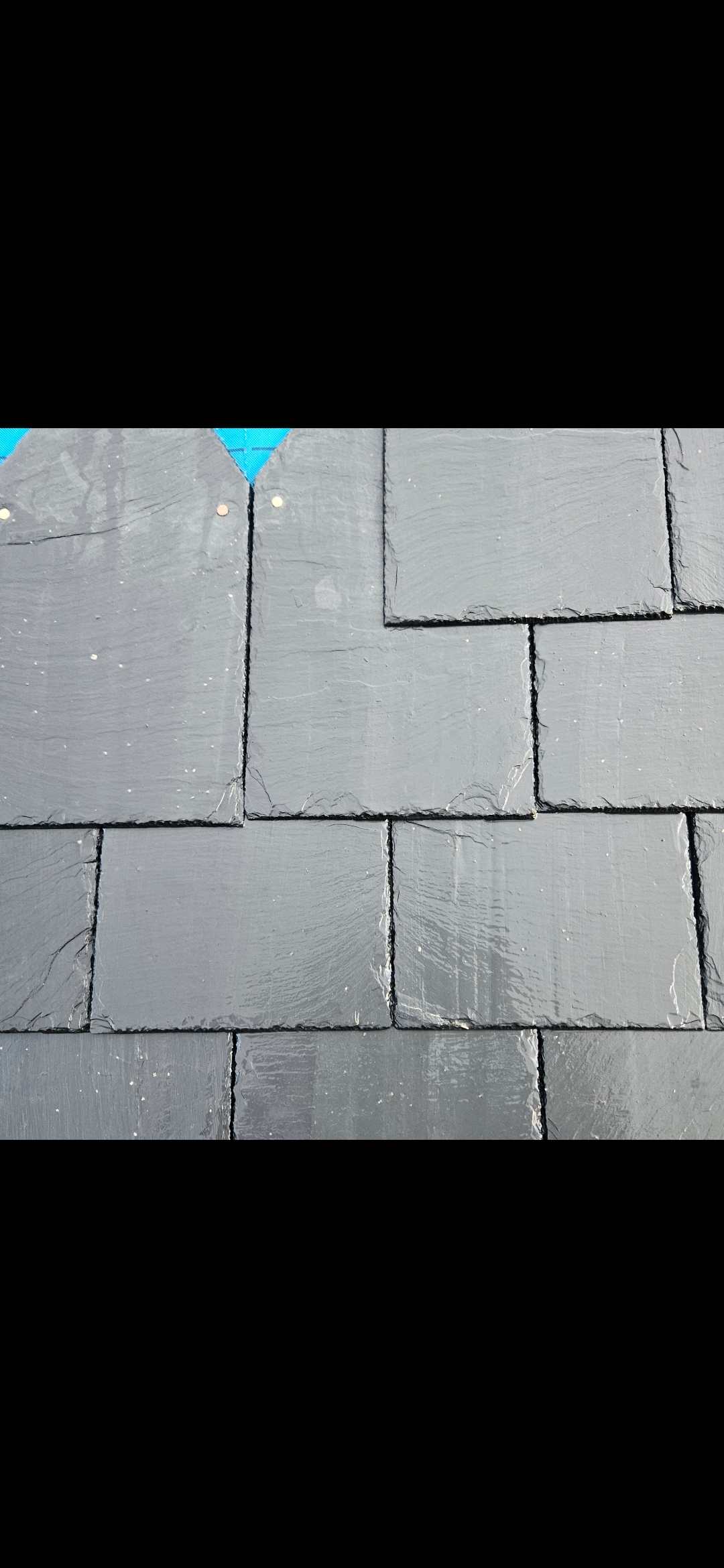

is that the image taken from the verge? If you look at the broken slate and half, the second course of slates above that should give the slate and half a double cover but the broken top left corner goes down so far that it wouldn't be that way, just take a line across from the highest slates. I might be being picky but it's my £30k that's re-roofing the house, I feel that I'm paying premium prices but not getting the product to match. On the image above, where you can see the eaves course, a slate (or half slate) is missing altogether where there was no nail puncture in the membrane or on the eaves felt, so it was never installed. Ironically that corner of the house is looking at the South Westerly direction and gets the prevailing wind. Further, this is CUPA Heavy 3's being installed, all the eaves slates were installed with 1 nail per slate, according to CUPA, 2 nail fixings per slate should be used. Even if they didn't recommend that, I live in the North West Highlands, it's strongly advisable to double nail all slate courses including eaves courses -

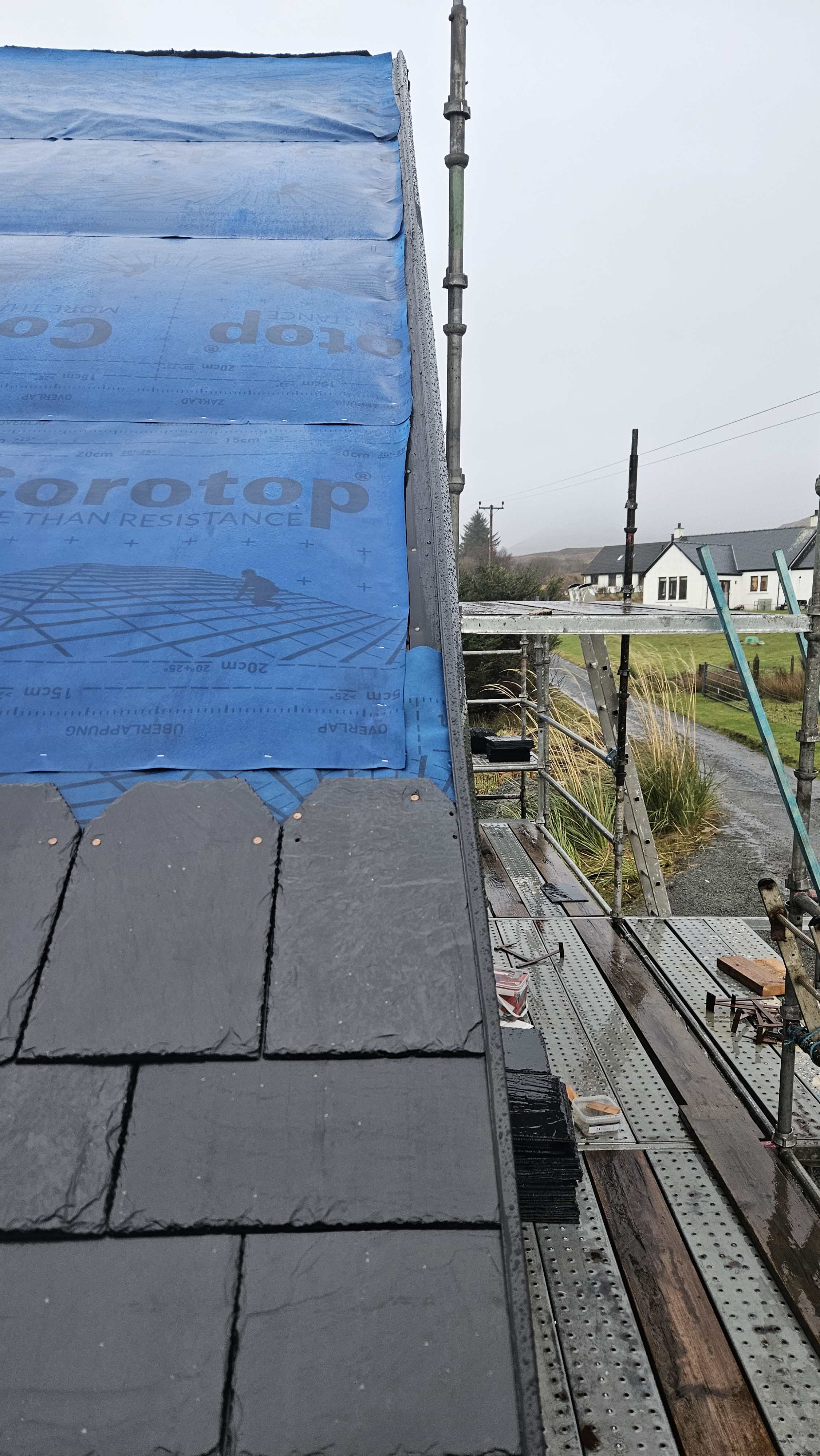

Yes. The contract for the roof stipulated Roof Shield. He installed Corotop which is about half the price of Roof Shield (IMHO there's a reason why there's such a price difference) but he was charging me the price of Roof Shield. So I had to remove over 400 slates to re felt the roof, then it was re-covered in what was supposed to be used. -

The contractor is definitely not coming back. His standard of workmanship is not up to scratch, he continually referred to the Roofing Membrane as 'Roof Shield' which I was initially happy with, so that's what I thought he was installing. I know Roof Shield is a premium product and it's all I would use in the west Coast of the Highlands. Problem was, when he said 'roof shield' he was meaning it as a generic term, (like people who call a vacuum cleaner a 'hoover'), and he installed 'Corotop' (poorly). He billed me £500.00 for the Membrane which is normally just over £50.00 a roll (less than 5 rolls) but priced it as the (much) more expensive Roof Shield, but he kept referring to it as 'Roof Shield'. It has now cost me another £1,000.00 to strip the 400 odd slates off the roof and install actual Roof Shield because it's got to stay like that until the middle of January 2026 when the correct Velux Flashings are available (another thing he totally screwed up, the order was in his name and he stored the boxes in such a way that they were destroyed by rainwater, but I had to pay for the materials before they were delivered by JEWSONS. By the time he realised that he ordered the wrong type of Flashings to be delivered, the cartons they were in were destroyed at a cost of nearly £1,000.00 and were un-returnable. -

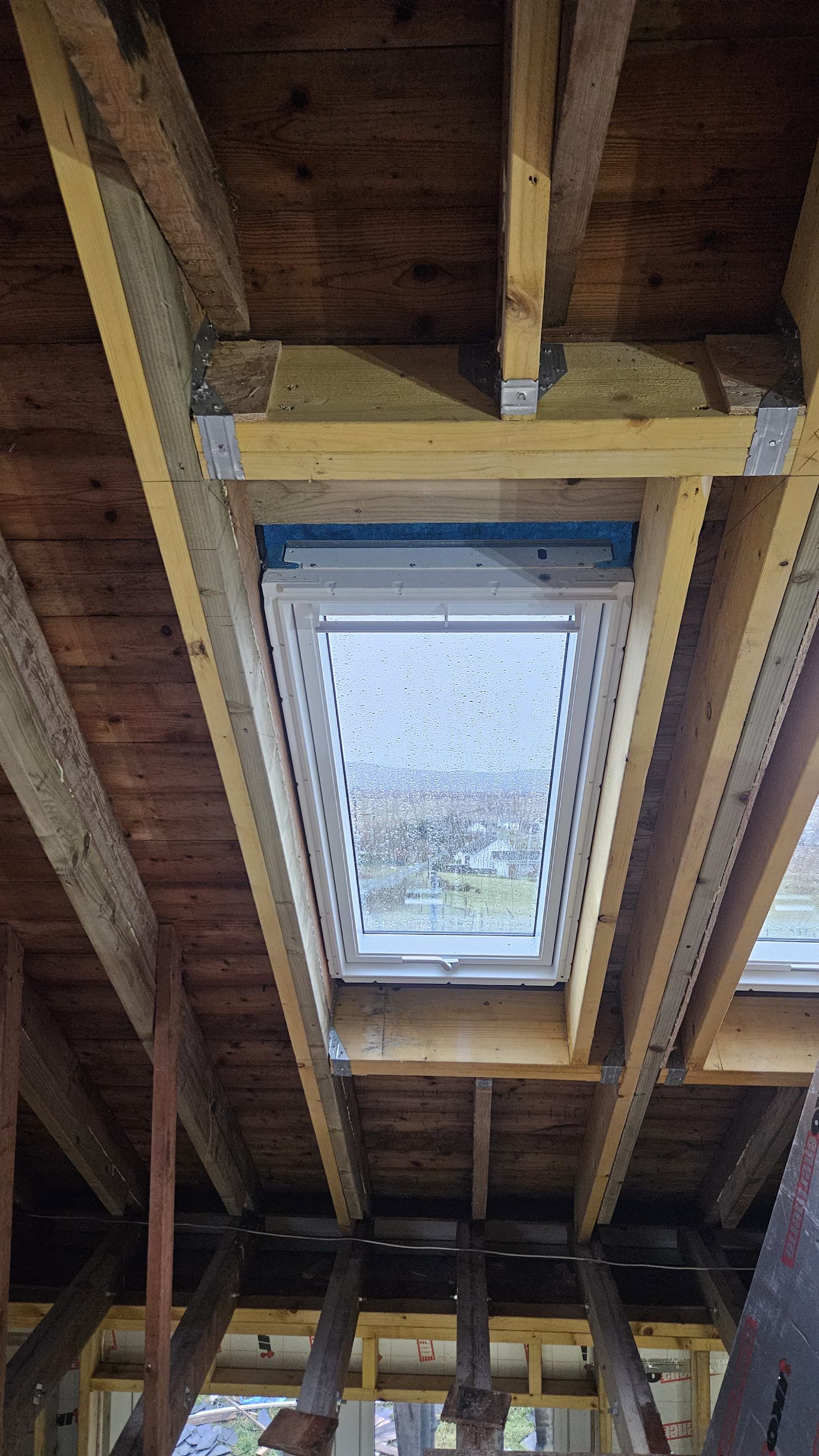

Now, the sarking usually has a 3 to 5mm gap on most boards but they are so full of water that they have expanded a bit. I know the images look a wee bit glossy like well treated timber, but that's not the case - they are very wet. Gently pushing your thumb into the timber sends quite a bit of water down your sleeve The rafter framing/trimming for Velux was carried out myself under instruction, the roofer quoted all opening sizes to me as I never had the windows on site. I only realised afterwards that the openings didn't allow for the insulated collars. This is evidenced by dimension details forwarded to me by the roofer. I opted for level top and plumb lower reveals.
