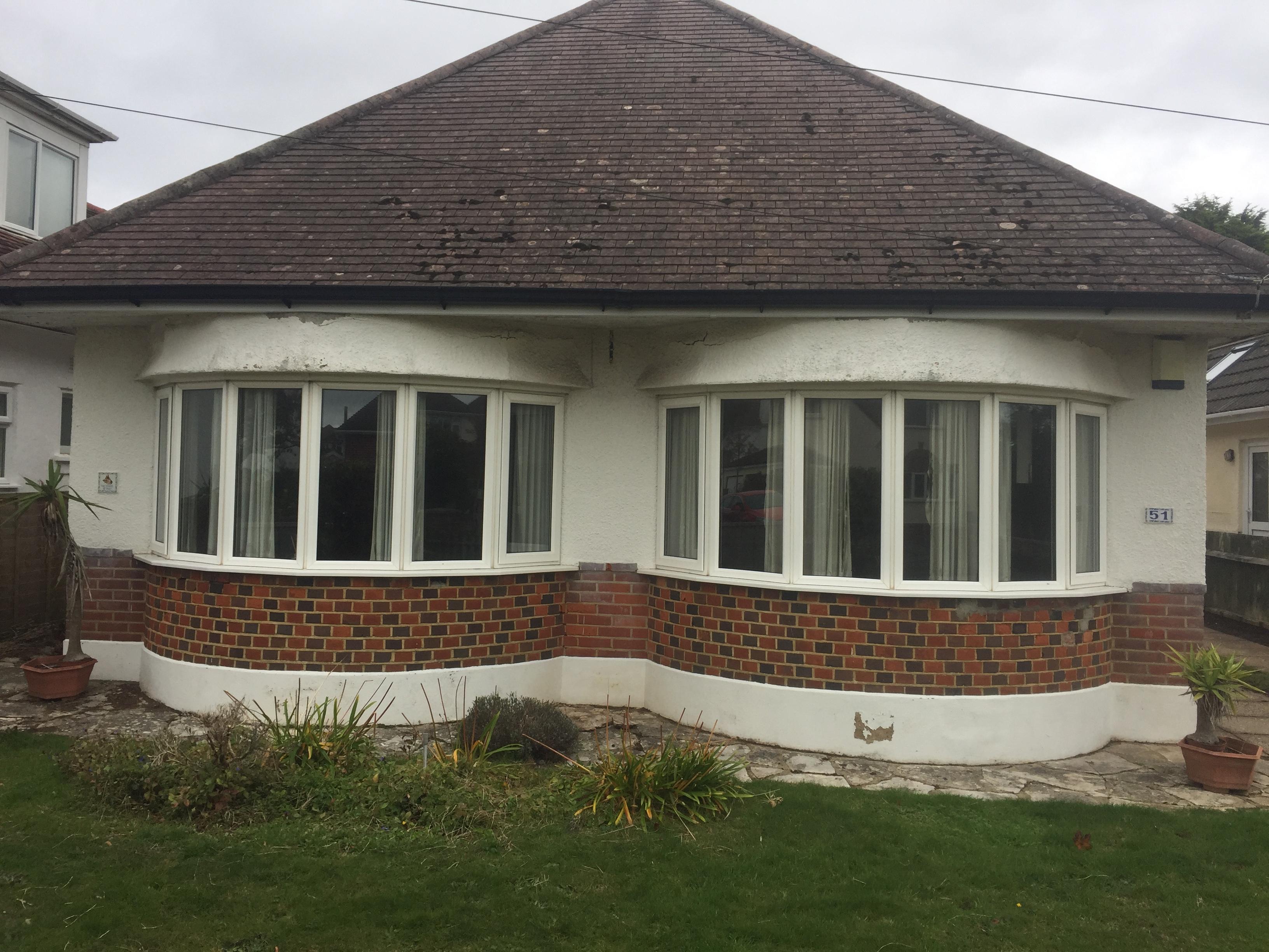

New Member (2/5)

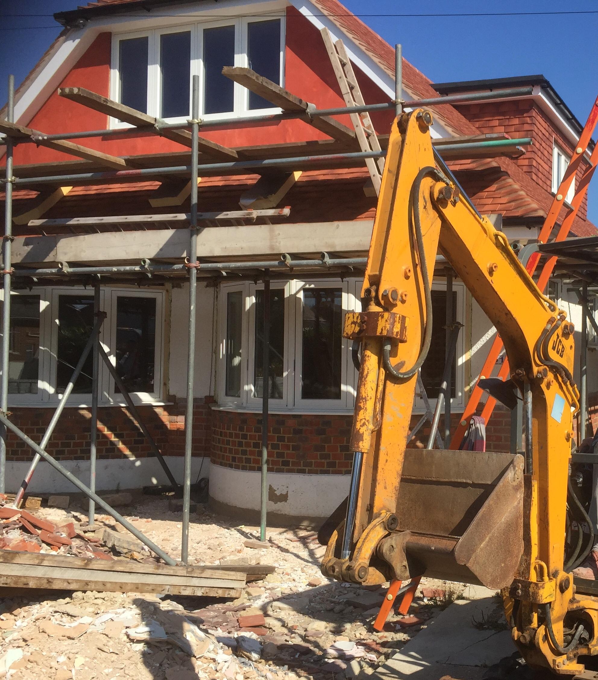

  1. So windows went in a while back. Will try and take better pictures now scaffolding is gone. I really like the windows, but think Norrsken installation and survey team let them down in comparison to the rest of the company. Bay windows came the wrong size so the heading all had to come out, once they were fitted realised they was 2 inches spare either side. A lot of extra work for my builder to rebuild the wall above in line with the new windows. And I lost 4 inches of window. in addition out of the 5 windows left in the house they managed to move the lintels on 2 and the bay wall on another, apparently down to having lime mortar rather than cement. Seriously unimpressed with the window removal, thankfully I am rerendering anyway. but 6 months on I am happy with the windows

  3. Just in way of an update for anyone searching forum. Have finally ordered my windows, I went with Norrsken after many false starts with other companies, they have been brilliant and have managed to chamfer the frames for the bay to reduce the outside profile. Decided to dispense with bay poles as the original windows were crittal with wooden posts, if it was good enough then...
  4. Thanks everyone for replies. I am hoping I am going to get sorted, I got a call back from a fitter in Poole today, https://www.timbercompositewindows.co.uk/. Really helpful and said bay poles would just have to be non standard. The first person who listened to what I want to achieve and given me options. He’s going to come over with samples and talk through the pros and cons. Big sigh of relief. I might also look at the rehau windows depending on how much it’s all going to cost Thanks again everyone.
