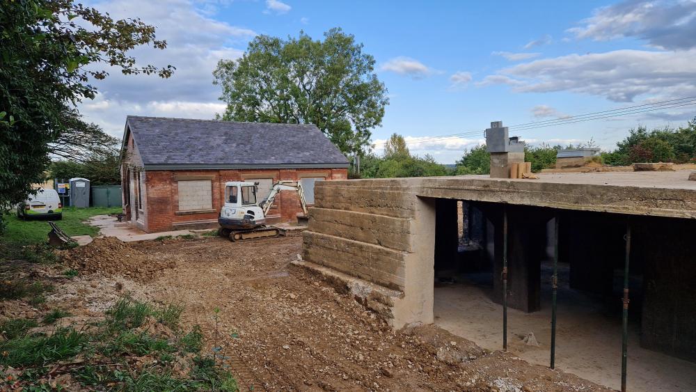

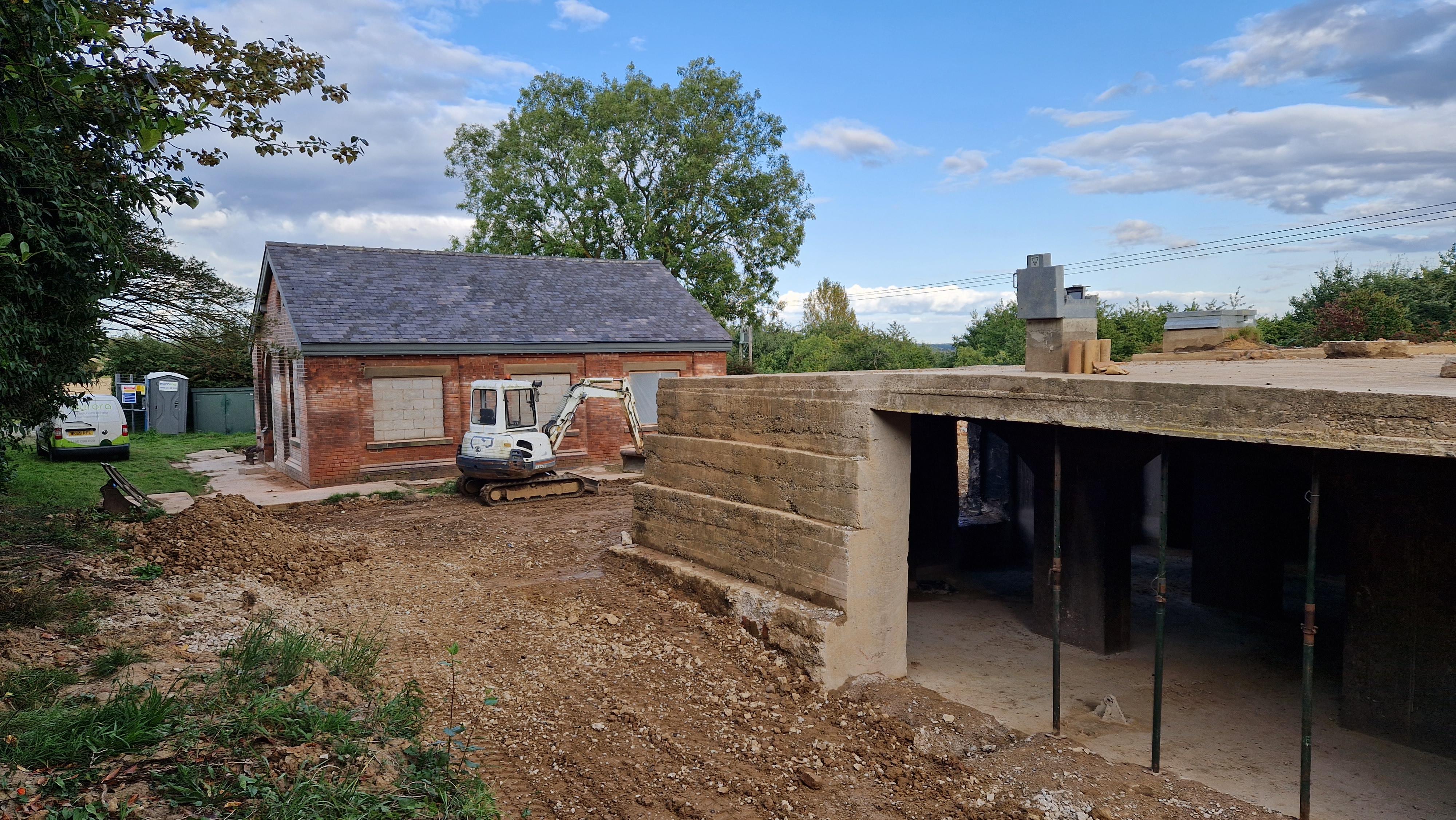

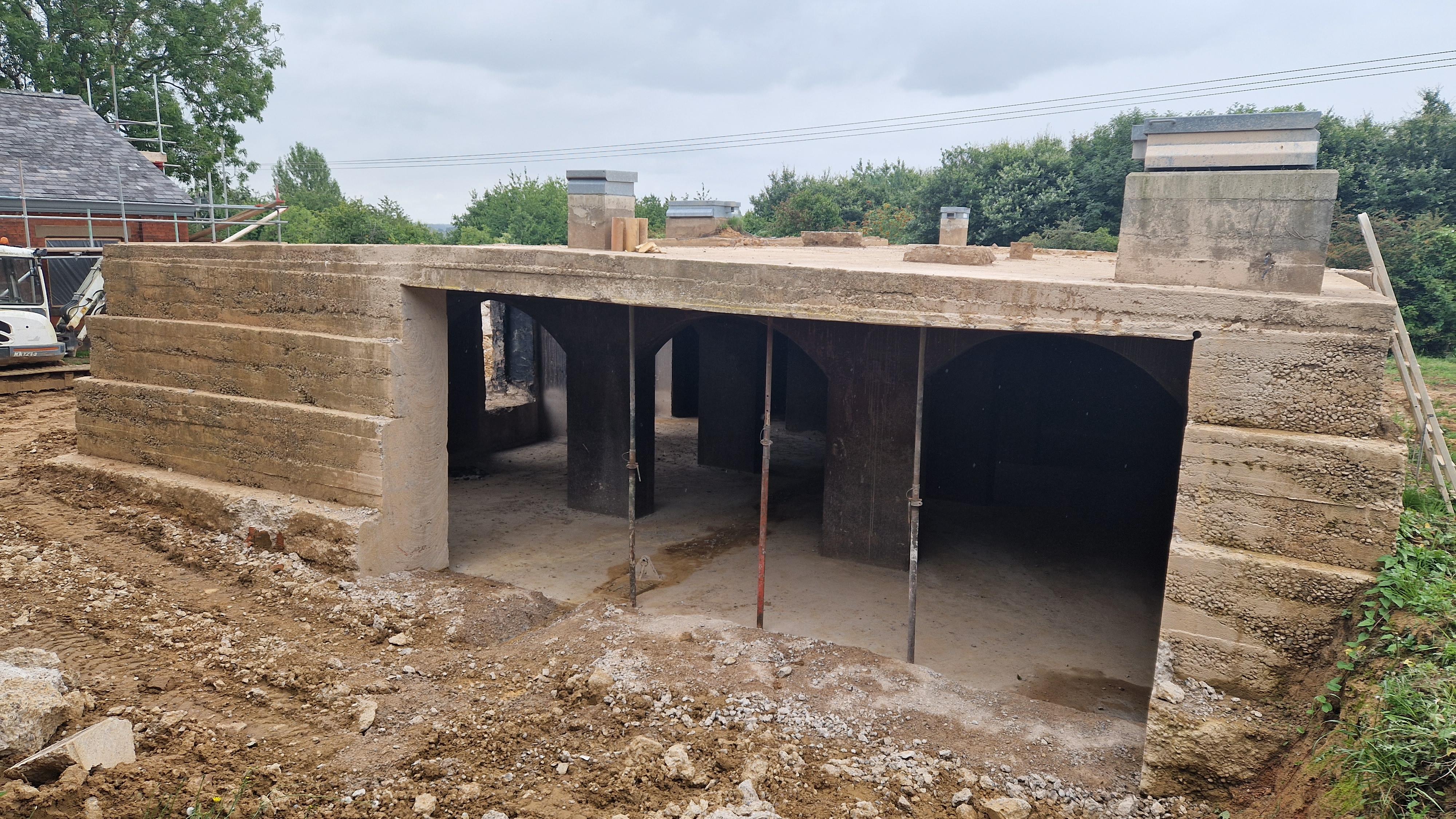

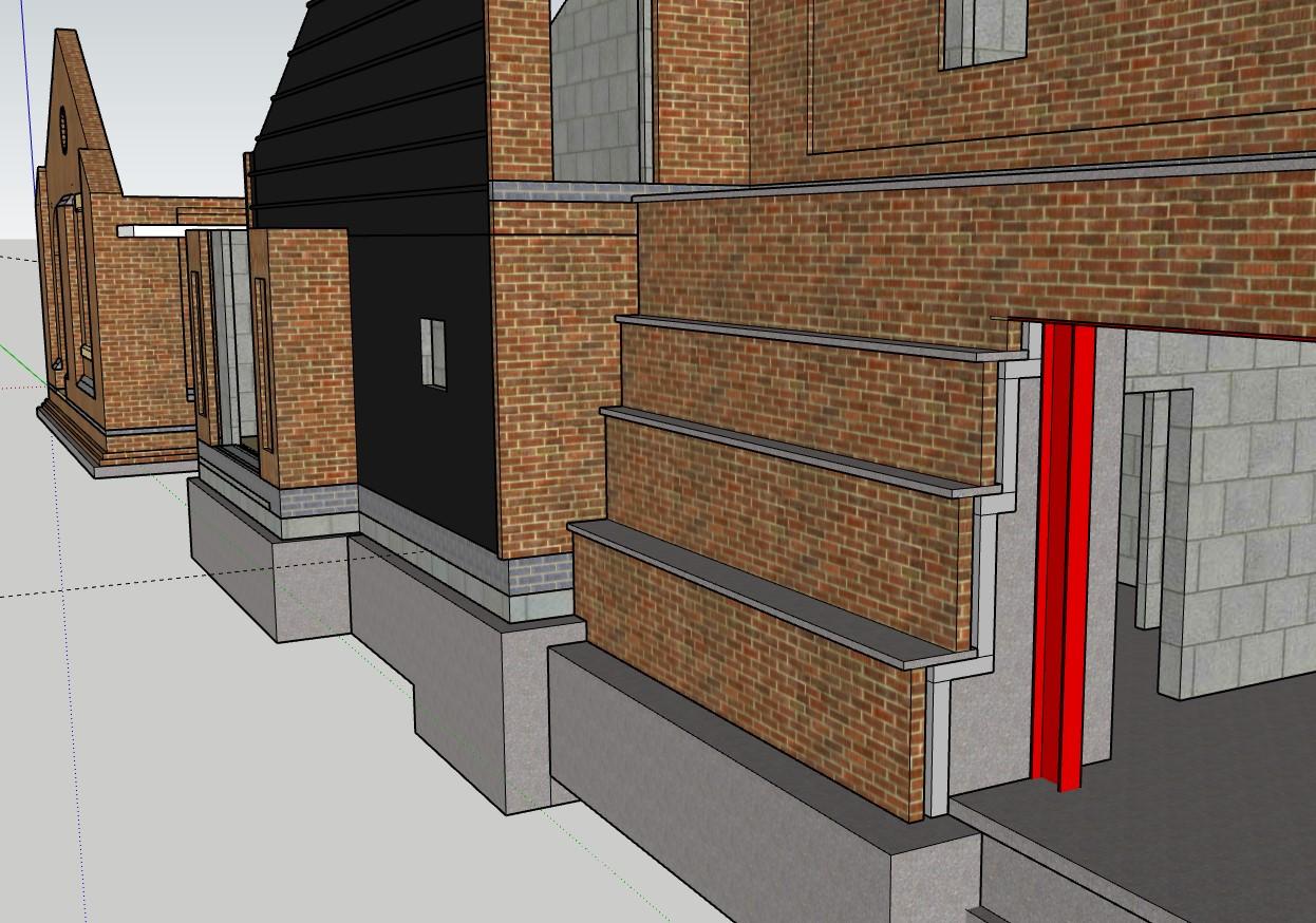

  2. Wow, so many replies and opinions. I'll see if I can answer some of your various comments here, but I think I need to take advantage of the ability to start a blog in here. So with regard to the structure. As you can see from the various pictures of the tank, you'll have noticed a brick pumphouse in the background. Planners wanted us to build one structure, so we worked with our architect on a proposal to build one house, linking the pumphouse with the tank, with a new section in between that would also enable a new structure to be built on top of the tank, with a good half of the roof area being used for a roof terrace. The tank space will be a 3rd garage, with the removal of one of the existing arches to form a larger garage space, supported by steelwork. The remaining space will be habitable, but mainly a cinema and games room, after all, there aren't any windows. The floor in the tank slopes down to the overflow at the lowest point, which exits the tank to form a natural drain, so we're planning to take advantage of that. We'll then level the floor and insulate above. We can't insulate under the arches, but I've been told by another architect we met that 'cold bridging' will only penetrate so far up the concrete pillars. If this is the case, insulating on the outside would make better sense, as the concrete tank would then be within the envelope of the structure so the heat would be retained in the concrete... does that make sense? We cut the various openings last summer when it wasn't so wet. It took the contractors three weeks to complete and cost just over £14k, so to me, it was a real bargain, and they did an amazing job. We stockpiled the rubble, and together with the foot or so of concrete we excavated from the pumphouse floor, worked with a local farmer who owned a portable crusher driver off a PTO on his tractor and crushed the lot. We ended up with about 200t of great hardcore. The planner wouldn't let us use render because the house next to us has been pebble-dashed all over with what looks like porridge, so they weren't keen to see any more. However, I'm sure we could persuade them if we really wanted it. We want to retain the stepped exterior, but make it more presentable. A Ziggurat, I love that... and I've learnt something new. We've had a friend call it Mini-Pitchu, but that's much much better!! I'm off to explore how to create a Blog so I can keep you all up to date on the progress. Many thanks for all your comments. Dave C

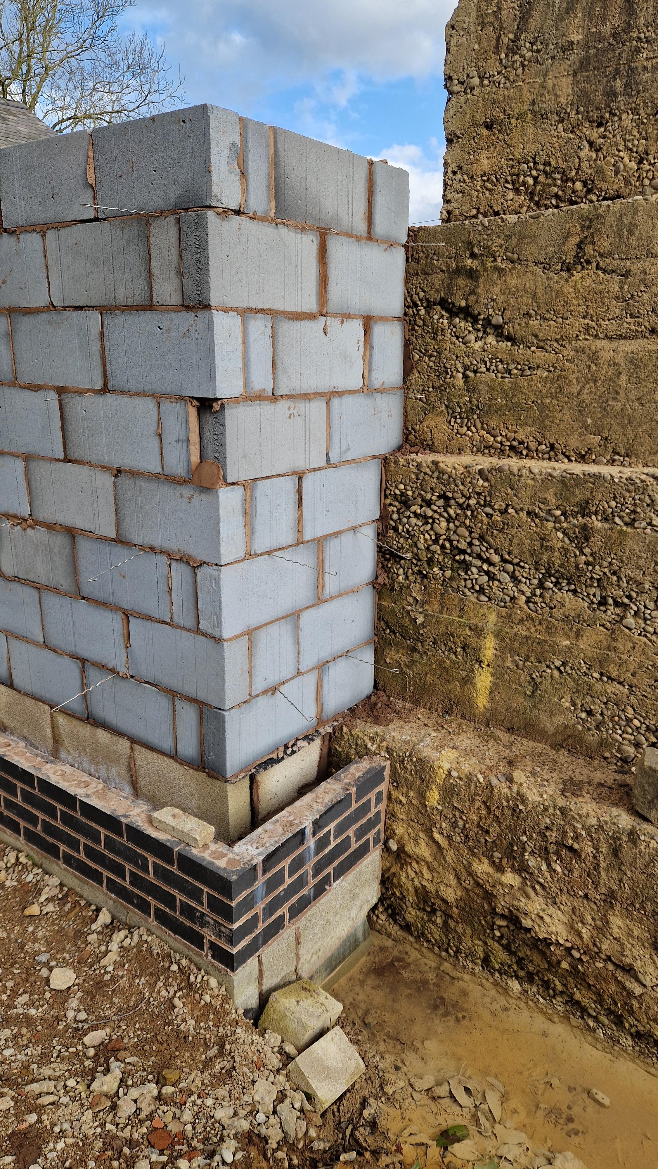

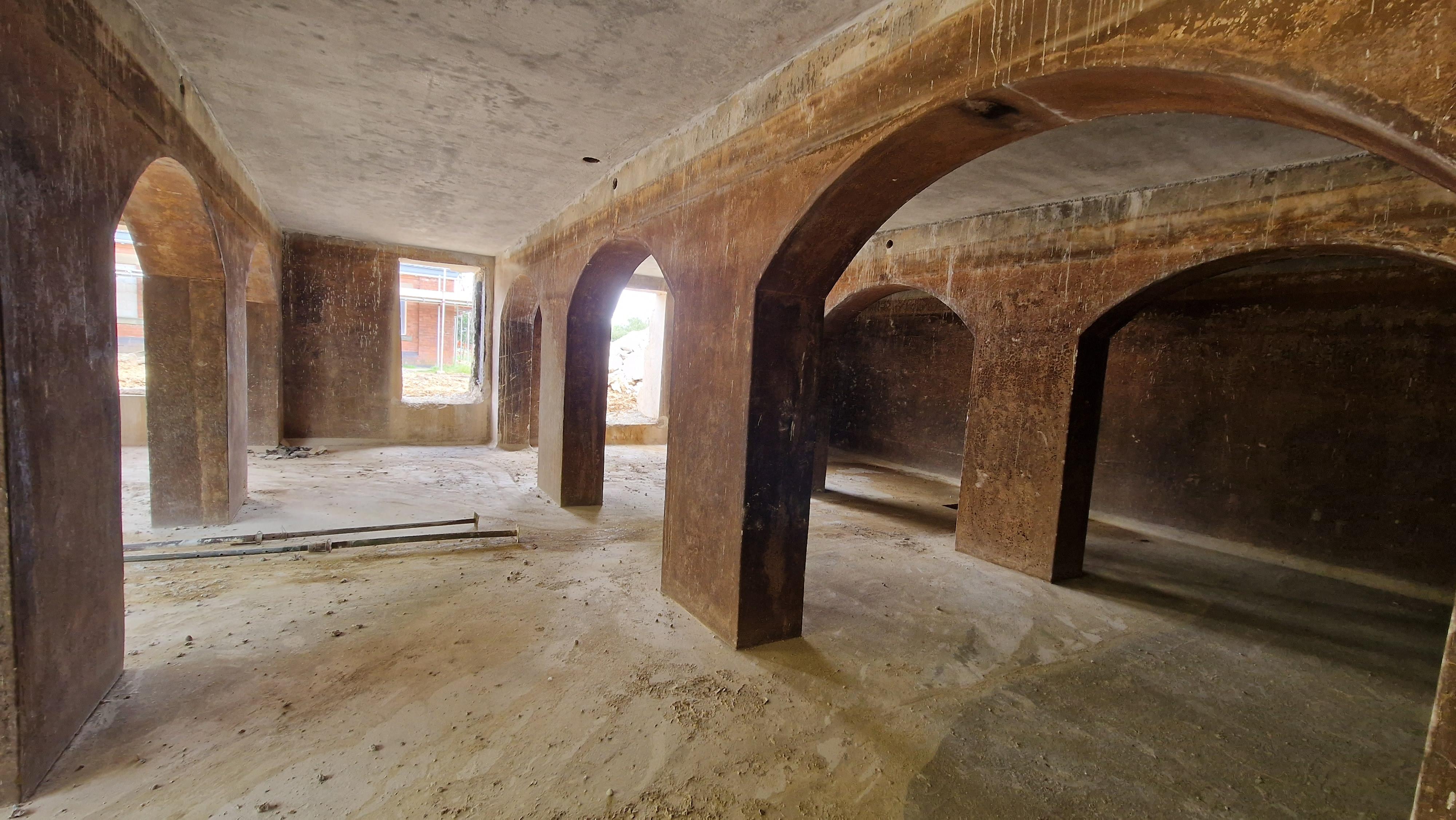

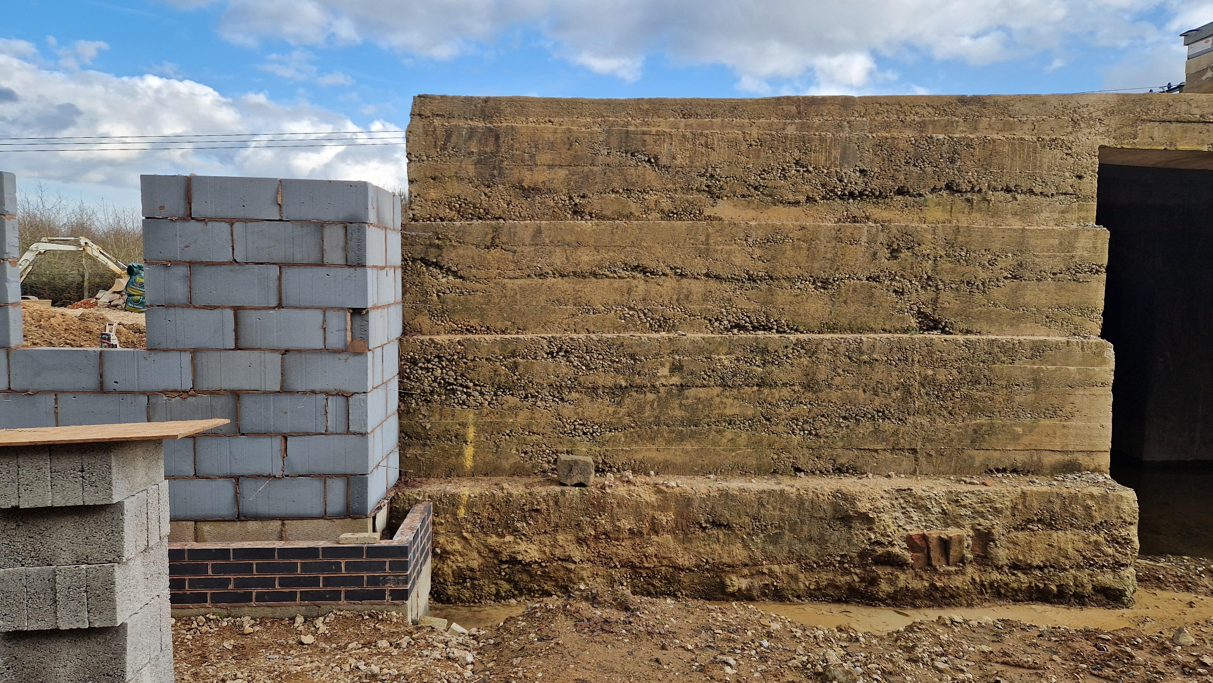

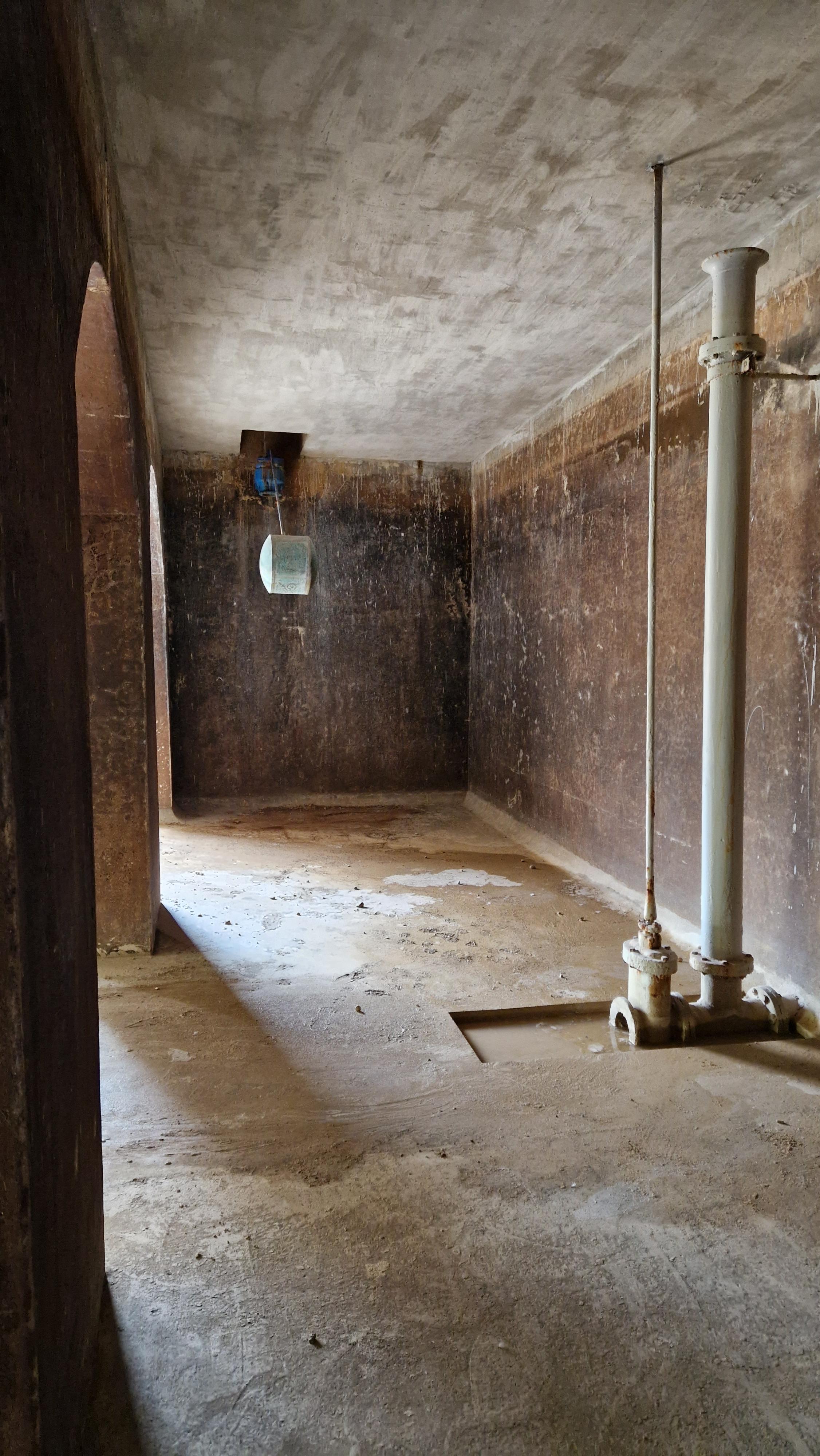

  3. Many thanks to all for the comments so far. The planners wouldn't allow the existing structures, the original 1930s pumphouse and the tank to be demolished, not that we really wanted to, we love the challenge of working with what we have. Also, the arches in the tank are quite amazing... at least to us. Creating an internal structure is an option, but we didn't ideally want to lose any internal space. As large as it is, once the walls come in it could feel a bit tight. Also, the three rows of arches cross the internal structure. If we create an internal timer frame on the outside walls, wouldn't there be a cold bridging issue where the arches meet the walls, as we wouldn't be able to insulate around them very easily? I guess if we did create a timber frame, tank and insulate on the inside, we could then simply face the outer walls. I understand for a structural warranty, there's a requirement for two forms of tanking. The honeycomb structure with a drain at the bottom on the inside, behind the timber frame or plasterboard, but I guess we'll also need to tank the outside where the outer wall is below ground? I've attached some additional photos of the inside. Really appreciate your feedback. Dave C

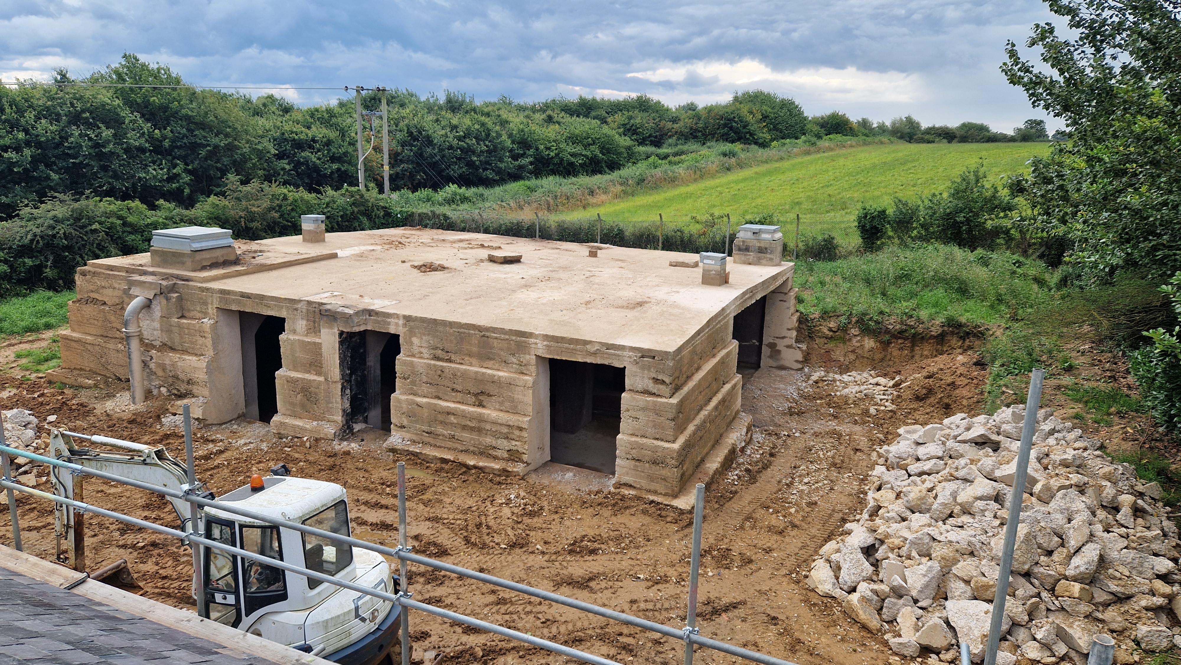

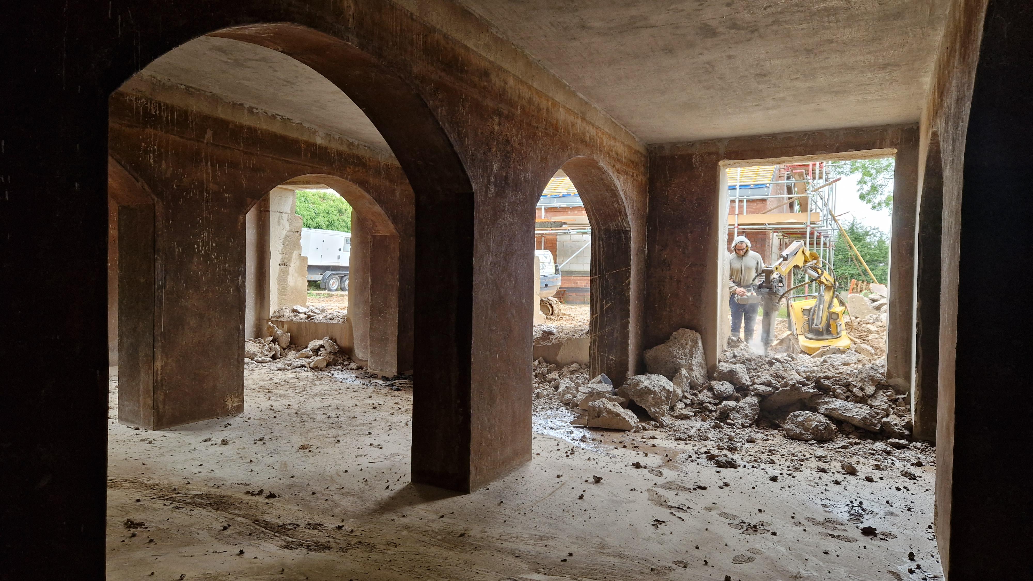

  4. Hi, I'm hoping someone will have some bright ideas on how we can insulate a former Severn Trent Concrete Water Balancing Tank, which we intend to integrate into a new residential dwelling. As photos speak a thousand words, I've attached some images to show our project and the tank. In addition to tanking, we need to insulate the concrete tank, which will be partially used for garaging and habitable space. The structure is mass-poured concrete that is stepped, with a thickness of 600mm at the top and 1.2m at the base. The surface is irregular and not straight as it's rough poured concrete, with no rebar. We're thinking of using exterior wall insulation (EWI), which is fixed back to the concrete, and then forming an outer structure to form skin and protect it. Planning won't allow us to use render, which I'm okay with, but as most EWI installations, like those attached to old council houses, are rendered, this poses a problem. We ideally want to form a new brick face for the tank, but because it's stepped out, if we choose to create a skin straight up from the base and include a 150mm cavity (100mm EWI and 50mm air gap), the distance between the back of the brick face and the existing concrete would be 760mm, far too wide to be safe. If we stepped the new brickwork in to follow the existing steps (as shown in the attached Sketchup drawing) how could we support the weight of the brickwork whilst retaining an air gap between the new brickwork and EWI, or without flattening the EWI if there was no air gap? We've seen quite a few water tank conversions, but all of them appear to have straight walls. An alternative would be a timber frame and cladding, but I'd be concerned about how this would withstand the test of time. I'd be interested to hear any suggestions anyone may wish to offer. Kind regards Dave C
