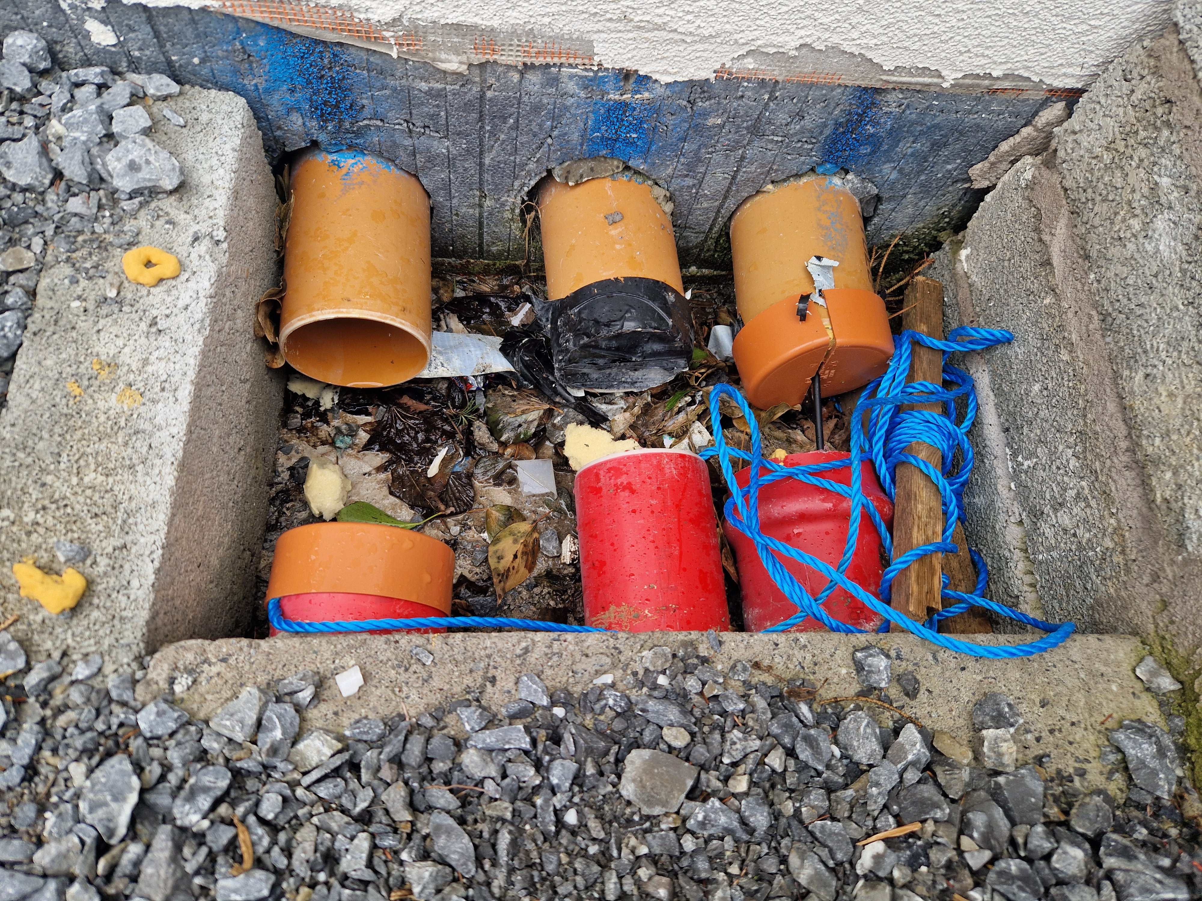

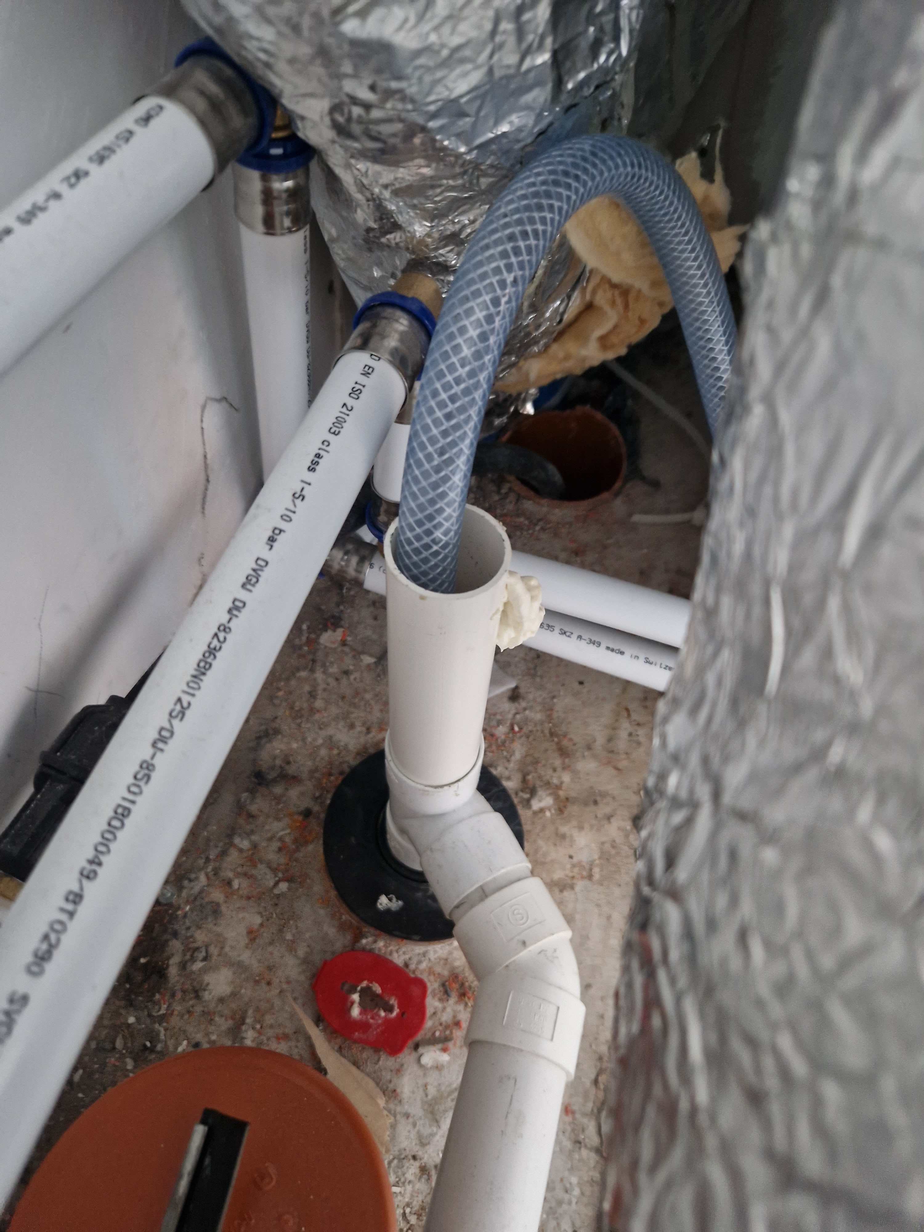

I agree Nick and this is what we were happy to do. However, when I saw water at the base of the unit, I contacted the agent for the unit who designed and commissioned the system. I didn't know where the water was coming from initially. They said one of their plumbers would be passing and would call in. He identified air tightness measures had blocked the pipe outside which caused the water. We were told to contact a plumber to re route the condensate pipe to the sink outlet and put a trap on it. We then got a bill from them for 180 as they said its not a unit related issue. We didn't expect this bill given that we're going to be paying a plumber to reroute the pipe anyway. It's a bit frustrating as I feel they should have checked this on commissioning or at design stage. The plumber who installed is one of their contractors and was involved from planning stage. Anyway, as you said, easier to just get on with it at this stage. I'm learning more and more everyday, unfortunately some of the info is being learned too late 😪 -

As Conor said, it does appear that these are service pipes and a service gulley and are in fact nothing to do with waste water. Not sure why the condensate pipe was run into these and especially when run with no trap etc. -

I think you're on the money Conor, not sure why the installer did this. There's a sink outlet on the other side of the machine connected to the waste water system that should probably have been used.... -

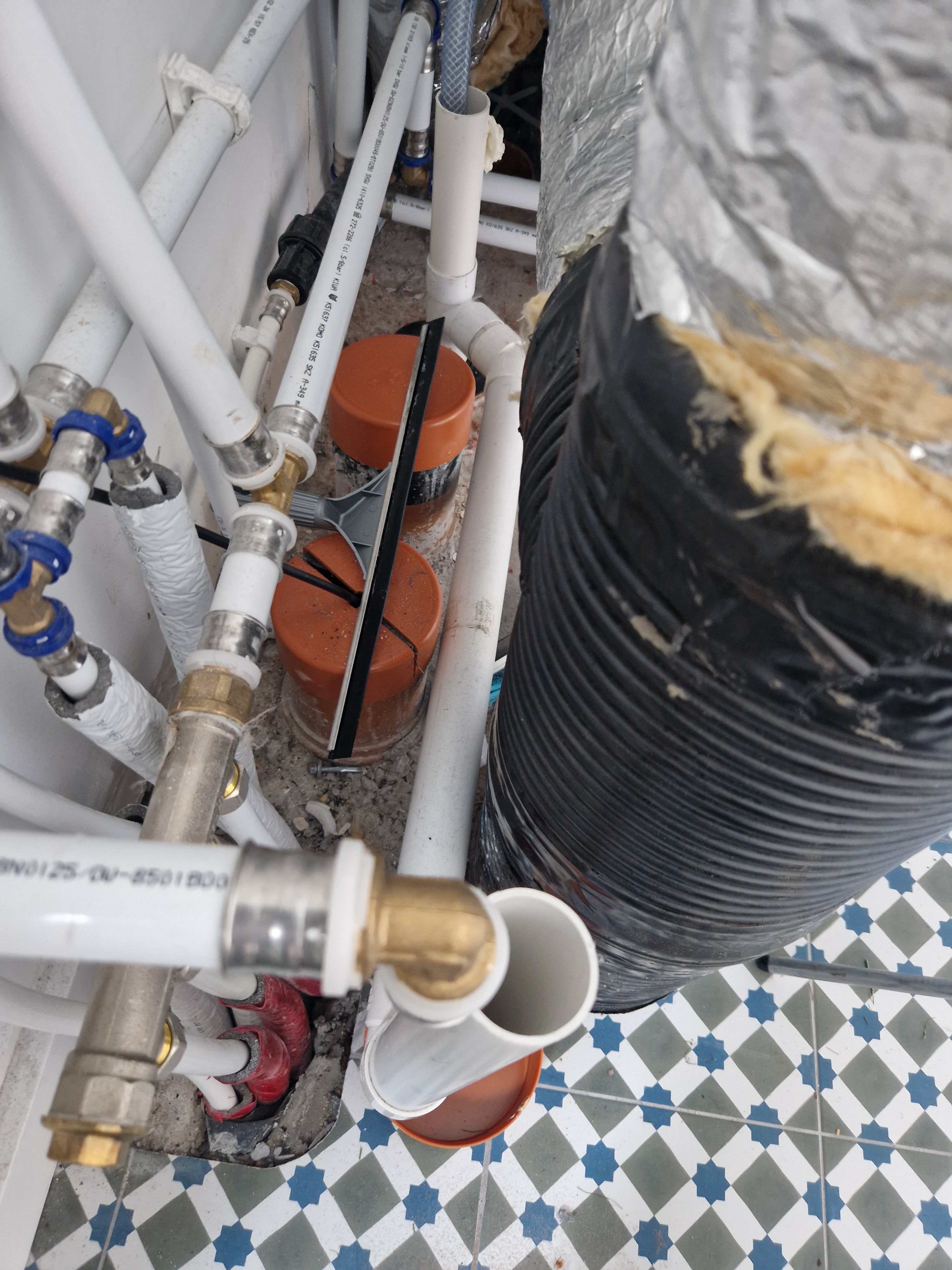

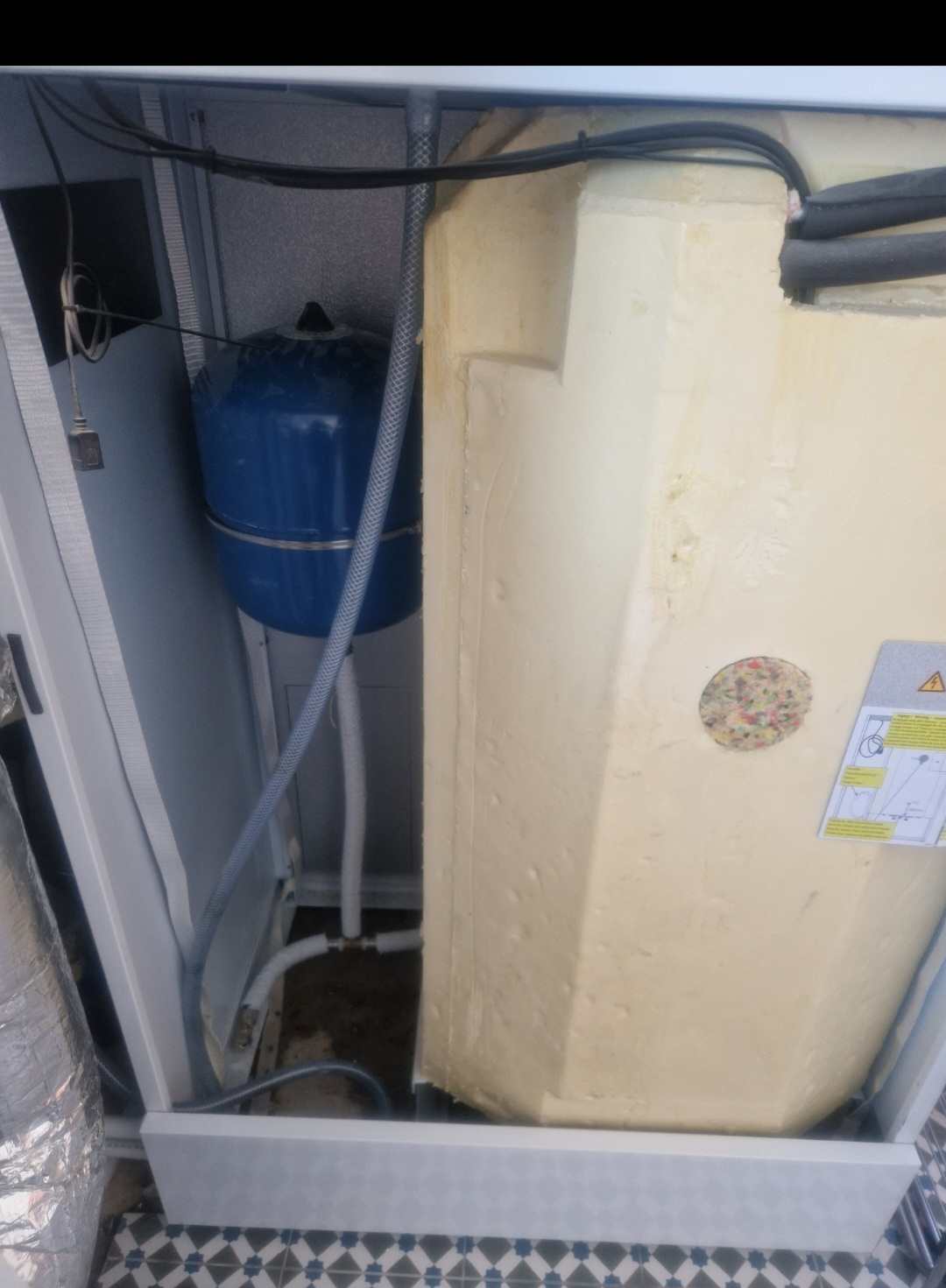

This is the inside of the unit where you can see the piping which i presume has an overflow tray in the upper section. It's an MVHR with integrated 2kw heat pump and 180l hot water cylinder. One of the pipes is where the WiFi comes in - ones on the right, one is where power for a shed and electric gate will come in red ones left and middle. Middle brown is currently blanked. That's why I'm confused with condensate drain as none of the red are waste pipes to connect condensate to 🤔 -

Fiona Brick posted a topic in Mechanical Ventilation with Heat Recovery (MVHR)
Hi All - advices appreciated. We're new to all this and still gaining an understanding of our unit and it's installation which we had done professionally. I'm going to post a pic of our condensate drain pipe internally - pipe sitting loosely into 1.5 " white pipe which feeds into a brown 4" pipe. This 4 " pipe runs internally to externally and was set in concrete and insulation at foundation stages. It does not seem to link up to anything or have a soak pit etc. outside. It's the one furthest on the left in the pic. There also do not appear to be any traps internally. Is this normal? I'm concerned re rodents/ice formation/cold air ingress. -
