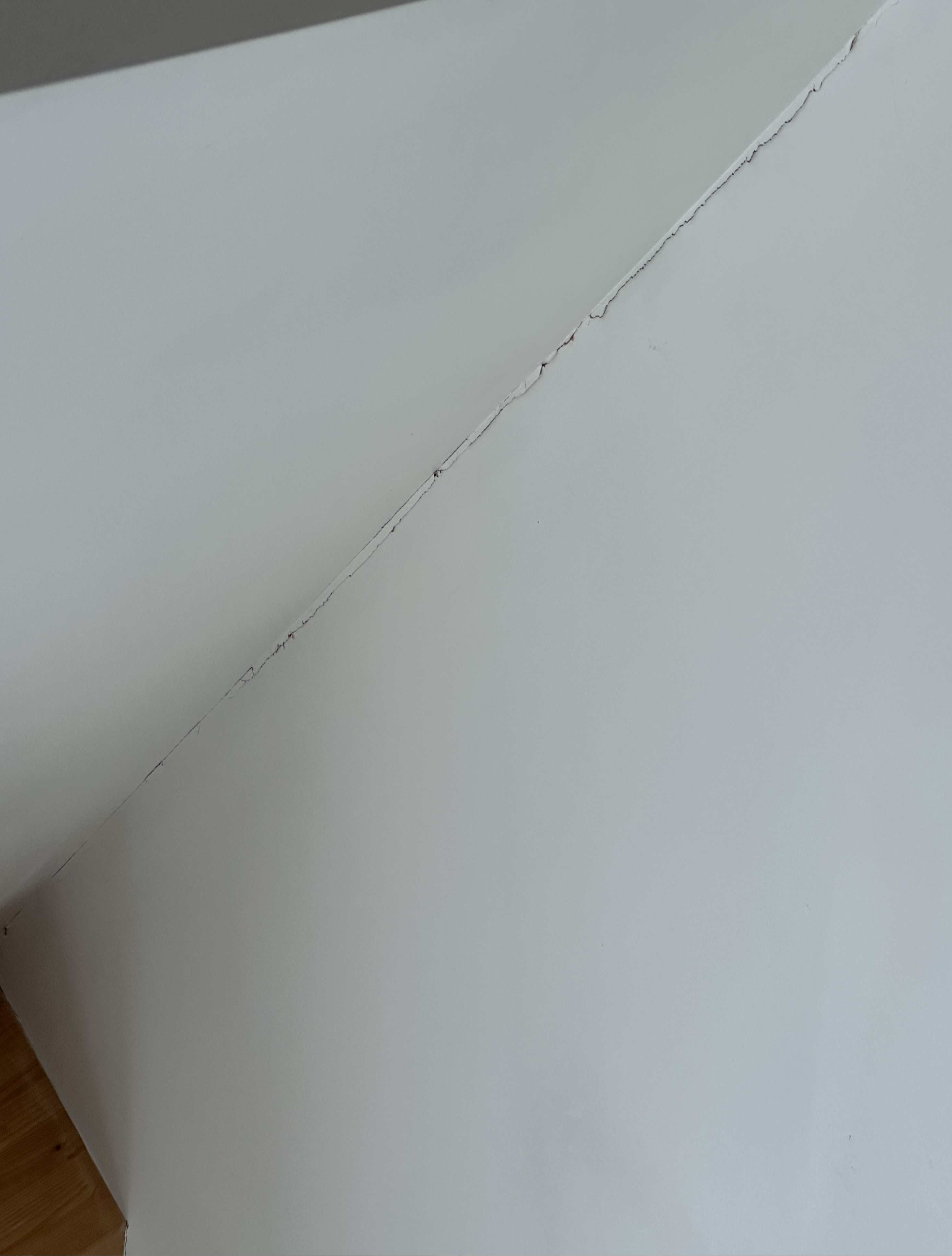

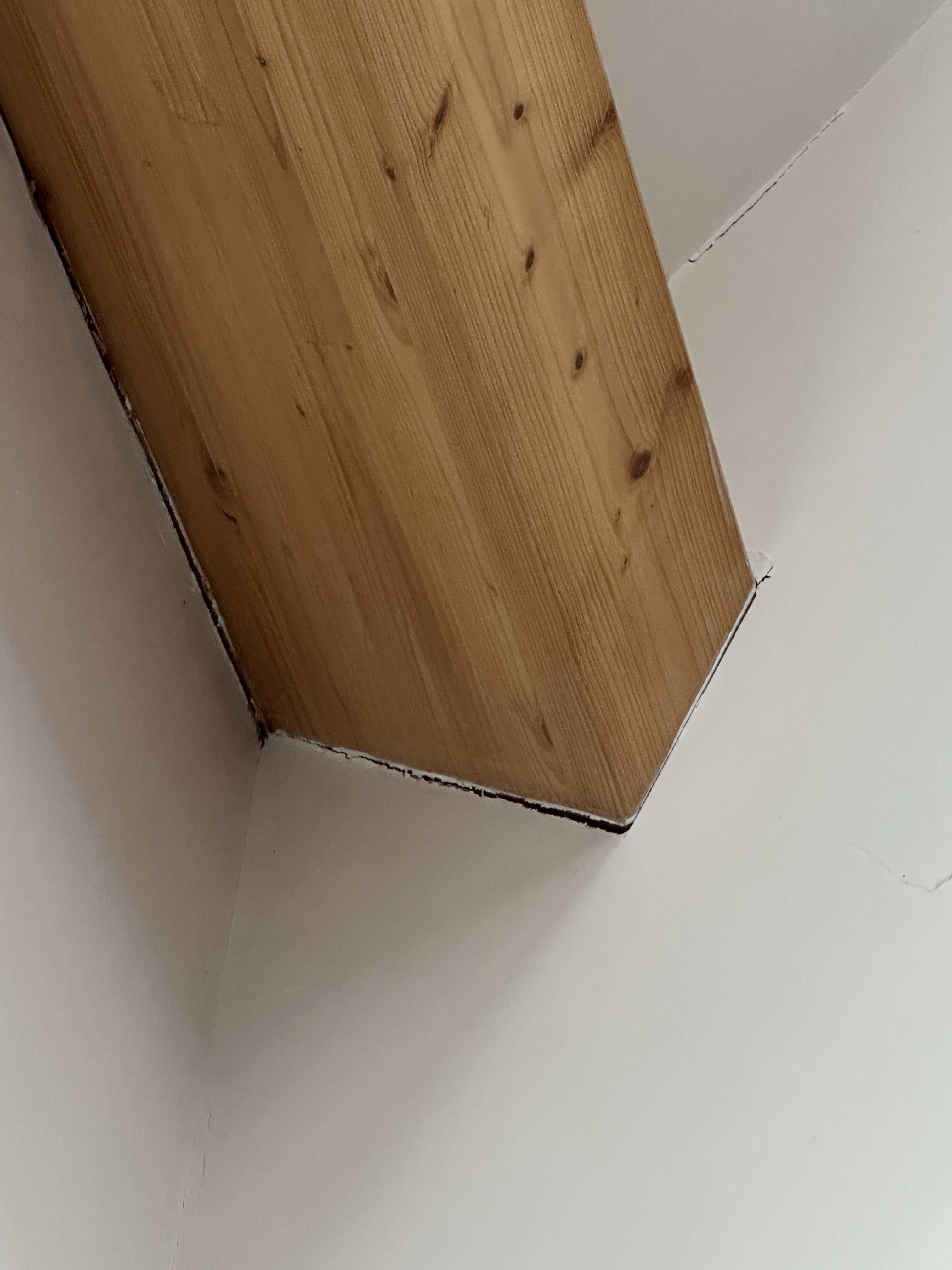

OK, many thanks, I'll see what I can find. It was more the corners where I was concerned, a lot of the crack repair advice seems to relate to simple hairline cracks in flat surfaces rather than inter-face joints like this that looked like they need a more significant solution that would stand the test of time and remain airtight. Thanks again -
Retrospectively sealing cracks at 10+ year old plasterboard joins
GP41 replied to GP41's topic in Ventilation
The ones in the pictures have never been touched, other than possibly some decorators caulk for first time pained. When you say "pull out all the dross and do it properly, either skim or do dry line properly, with tape and the correct fillers." do you mean take it all down? We do have the added challenge of trying to find a solution that cleanly abuts the glulam leaving its wooden appearance untouched. -

On many of them it'll be first time. On some of those that are more accessible I've used decorators caulk or silirub. I expect I could remove that though if necessary. -
GP41 posted a topic in Ventilation
We are embarking on some "airtightening" work alongside installation of ASHP and MVHR - more background here. One of the things that I'm struggling with, is how best to deal with cracks in our relatively recent extension. Much of it was dot and dabbed and we have numerous cracks, either on the flat face of ceilings and walls, or at wall/ceiling - and sometimes plaster/glulam - junctions. I'm loathed to start pulling perfectly good plasterboard off walls, it just doesn't feel like the most sustainable thing to do. So how can I fill, and make airtight, those cracks? I have visions of taking the skim coat back, applying airtightness tape and reskimming - is that ridiculous? Would I be better with a caulk of some sort, and if so, how flexible and long lasting would that be? Here are some pictures of the sort of thing we are dealing with... From an airtightness perspective, I actually think our 12 year old extension is in a worse state than the original, wet plastered, 65 year old house. And in some cases, looking back at pictures I took during the build (I know, if I'd only known then what I know now...) I might be forced to remove sections of plasterboard to carry out remedial work behind plasterboard, in which case I have the opportunity to do a more substantial job. Any suggestions much appreciated? -
