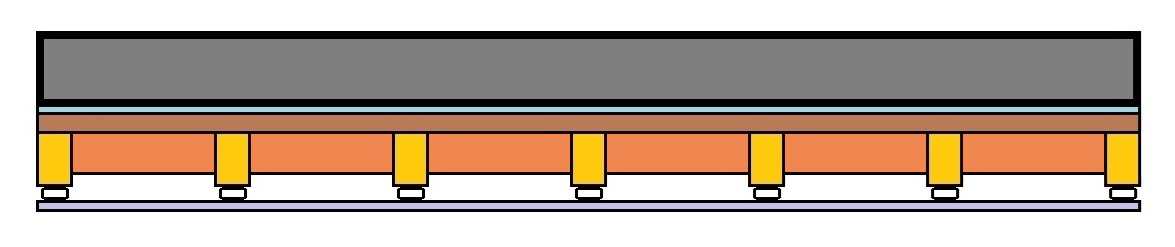

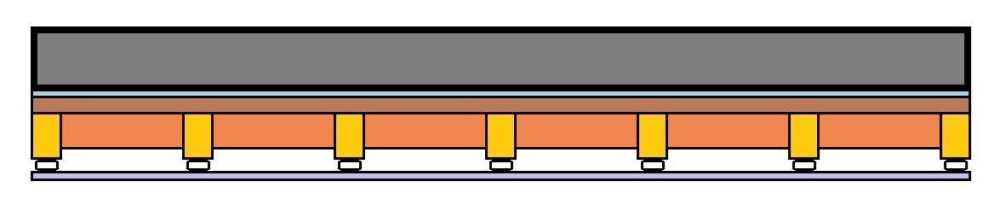

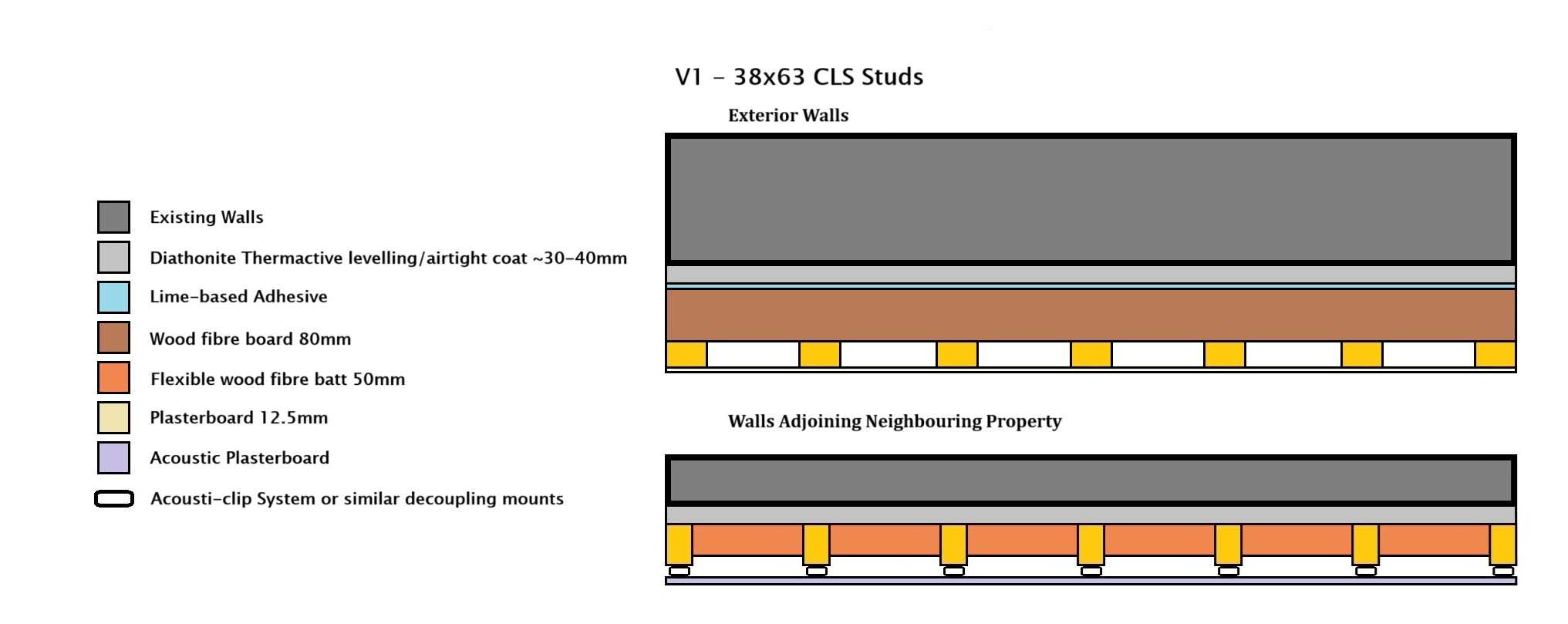

  3. Having finally found some more detailed reference material, I've amended my buildup again(turns out Diathonite Thermactive has a final density of 250kg/m3 +/- 15%, which is basically double rigid wood fibre, so pushing that from a ~30mm parge/levelling coat to a ~40mm base layer will do both the extra mass and thermal decoupling adequately).

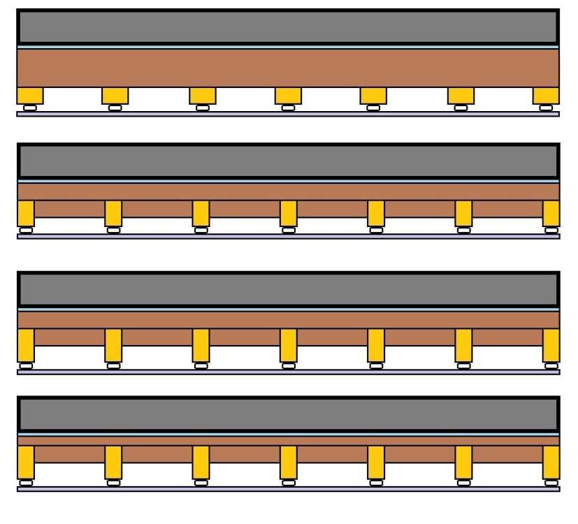

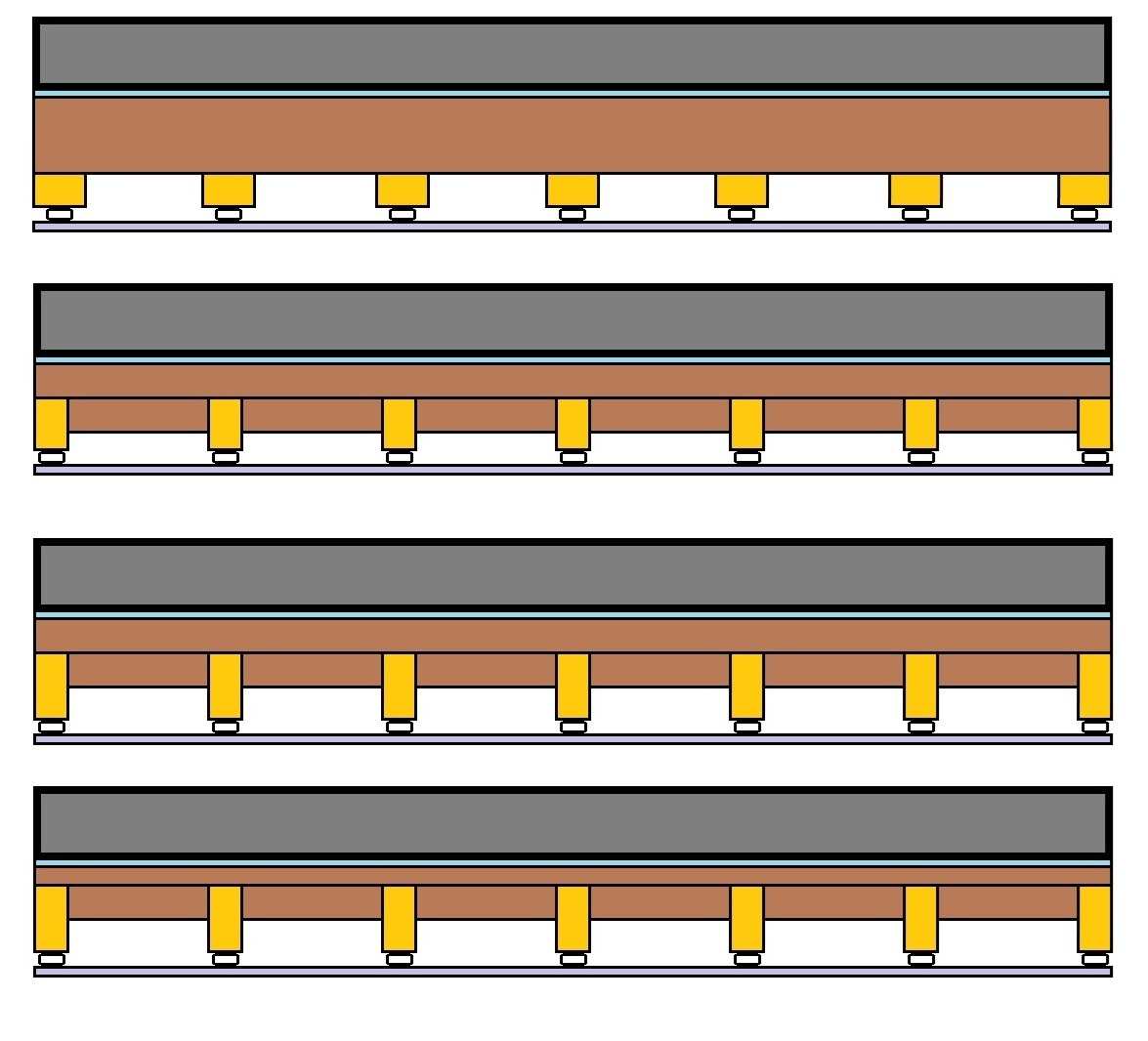

  4. I'd considered using flexible batts, but the wall will be getting coated with some kind of lime-based material anyway as that will form my airtight layer(using enerPHit principles, just not fussed about getting the certification), I also have to be careful about managing dew point and avoiding unintended cavities. How about the pictured; lime parge/adhesive > 20mm rigid wood fibre(thermal break) > stud wall w/ 50mm flexible wood fibre between > clip & rail system > acoustic plasterboard. When it comes to the floors, whichever solution I go with will be carried through the floor as much as possible to achieve continuity of insulation and airtightness, and I was intending to use a sound dampening subfloor for any suspended timber flooring. There's also the benefit that the run of the joists is front-to-back while the neighbouring property is to one side.
  5. The physical decoupling occurs in the decoupling system I mentioned, one of the polymer mount & channel type systems for fixing your plasterboard to, the insulation layers are for thermal performance and mass(rigid wood fiber has a similar or better kg/m3 than the best acoustic-rated rockwool and I'm using it on my exterior wall interior facings for insulation anyway). I'll be stripping all exterior and adjoining walls to the masonry to add vapour open airtightness, insulation and, for the adjoining walls, soundproofing. Here's a shitty MSpaint of what I've been discussing with the architect. Top to bottom on the buildup is existing wall, lime adhesive, wood fibre, stud wall, decoupling system, acoustic plasterboard. The variations are just different thicknesses of wood fibre(top to bottom 80mm, 40+40 between studs, same, and 20+40 between studs) and sizes & layouts of CLS(top two 38x63, bottom two 38x98), which I end up with will depend on space constraints of the final designs and what the structural engineer wants. Second one down seems the best compromise of depth, mass, & thermal performance to me. Oh and for clarity I say excessive because the existing wall is two rows of brick in a circa 1900 stone building, so you already have to pretty much be *trying* to be loud to annoy each other, I just figure that since I'm pulling everything down for airtightness & insulation work anyway I might as well see how I can tweak it to maximise acoustic performance too.
