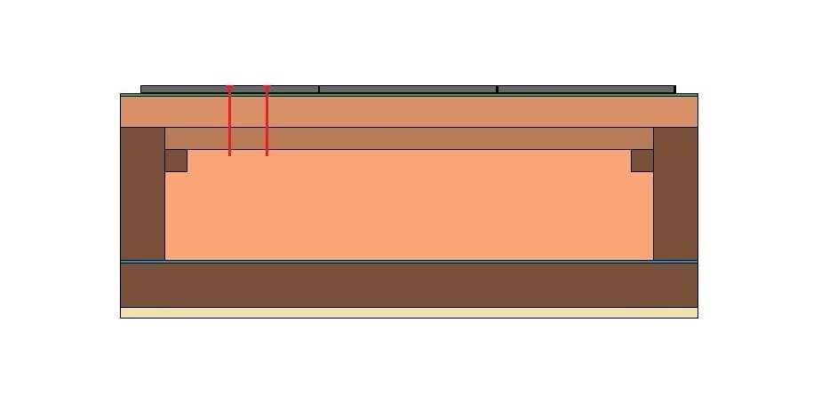

  7. Honestly starting to think you're right. I went back and ran the rough calcs for just deepening the joists to 200 or 250mm and using ecologicalbuildingsystem's retro-ecofloor technique and it's coming back somewhere between 0.13 and 0.15 which is in the same range as the thermally broken approach and would be easy as widdlin' up a wall by comparison - grab some joist stock, tack them on underneath with the nailgun on an angle, a few screws up from below, then it's all vanilla. I don't anticipate there being any missed bits, I'll actually have pretty good access to everywhere I'll need to do comprehensive airtightness and I'll be handling that aspect of the project personally to ensure no bodging, but tbh that aeroseal thing looks nas-tee to me. "Non-toxic water based" but requires full-face breather with VOC cartridge during application hmm yuh-huh. Looks to be an aerosolised acrylic caulk, no info on longevity testing, no info on whether it is or how long it stays flexible to deal with wood movement etc, can't see vapour permeabilty numbers in any of the docs on their site. Seems like it would be a useful tool in the context of the volume housebuilding sector to save them time and effort, if they were building near-passive homes(and assuming engineered timber rather than sopping wet CLS that will look like a plate of spaghetti by the time the house dries out), but in a back-to-masonry deep retrofit I don't see the value really.

  14. Pretty close to deciding I CBA with slabs and UFH and just insulating the existing perfectly good suspended timber floor as flooring has to come up for other work anyway. Easy option would be membrane slung between joists filled with wood fibre, but that leaves the joists as cold bridges, so I'd prefer to use the approach of adding tongue & groove 35mm wood fibre sarking underneath the joists(which doubles as the vapour-open windproof layer) - trouble is my solum cavity isn't gigantic, about 270mm below the joists, and even with a right angle drill attachment etc I can see getting under there with the thermally broken fixings is going to be a pain in the bum. I'll do it if I have to like, but if there were a ready made easier solution I'd be interested to hear about it - some kind of heavy duty plastic L or T bracket that could be hung from the joists maybe? I could screw in diagonally from above but I'm not sure if that's going to be secure enough long-term.

  24. I'd considered using flexible batts, but the wall will be getting coated with some kind of lime-based material anyway as that will form my airtight layer(using enerPHit principles, just not fussed about getting the certification), I also have to be careful about managing dew point and avoiding unintended cavities. How about the pictured; lime parge/adhesive > 20mm rigid wood fibre(thermal break) > stud wall w/ 50mm flexible wood fibre between > clip & rail system > acoustic plasterboard. When it comes to the floors, whichever solution I go with will be carried through the floor as much as possible to achieve continuity of insulation and airtightness, and I was intending to use a sound dampening subfloor for any suspended timber flooring. There's also the benefit that the run of the joists is front-to-back while the neighbouring property is to one side.
