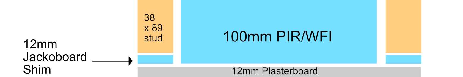

Been looking at ways to reduce bridging on studs and wondered if anyone has tried this. 89mmx38mm studs with 12mm Jackoboard (insulated tile backer board) shims over studs and 100mm insulation between. I'm figuring that Jackoboard's insulation will break the bridge (to an extent) and since it can take screws and hold tiles etc, it will be plenty strong enough for plasterboard. A 1200x600 board costs around £10 and can make 15 shims so its not too much of an add on cost. Image gives an idea of what I'm thinking.

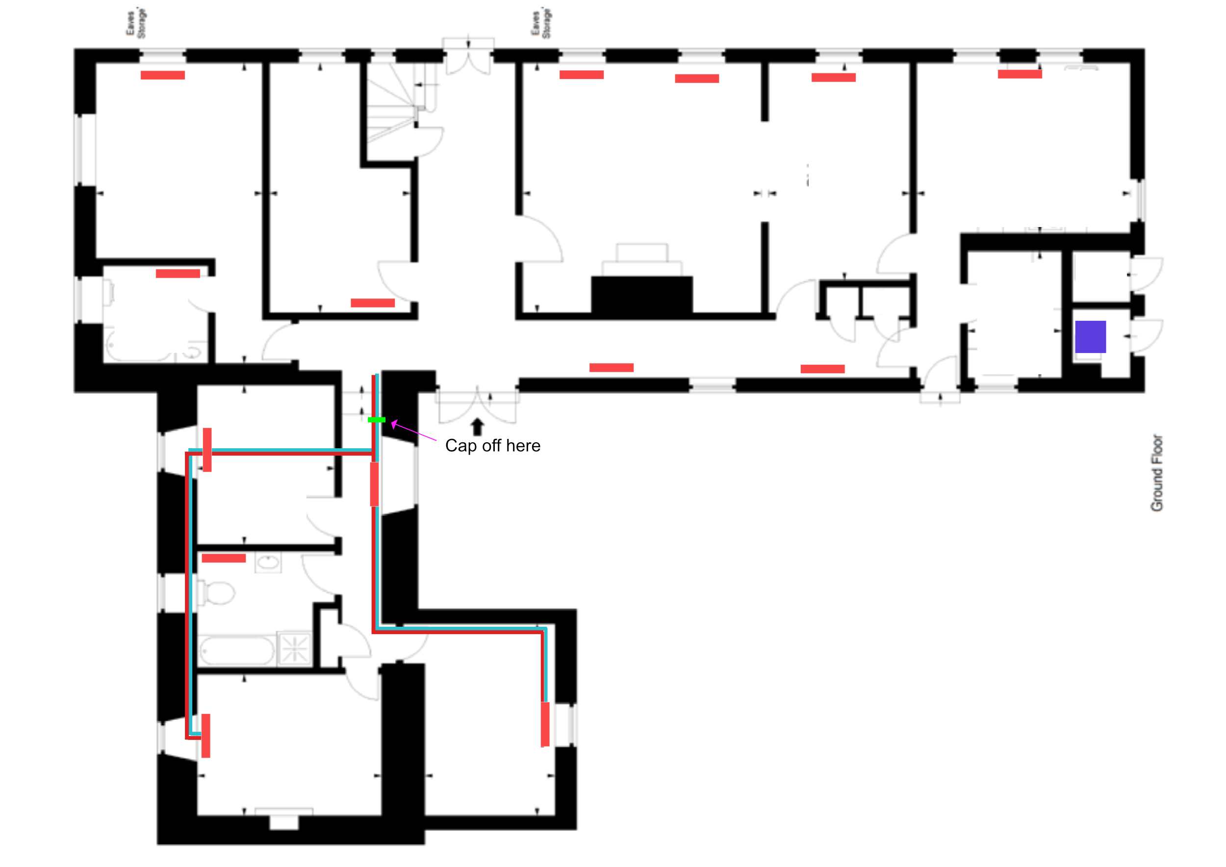

Howdy, I'm prepping for installing UFH and was wondering if it is ok to cap off a radiator circuit as per the diagram. The boiler is in purple and I'm presuming the pipes run along the length of the hall and tee off into the smaller extension part of the house. I've taken up as much boards as I can and this is the pipe layout as far as I can tell. Cheers for any help.
