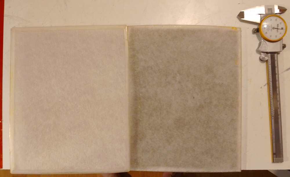

  11. I have now taken a picture of the HVR unit filters after a month of continous operation (winter air at around 0C outside, wood-burning houses nearby). The outgoing air is on the left, the incoming air is on the right. I'd say, at least 25% of the soot is from New Year's eve. I am thinking to get a roll of generic filter fabric and cut these to size, rather than paying for replacement filters (I would like to replace the incoming filter once a month).
  12. Thank you all for the comments. I have also looked at the Brinck system which has been mentioned on this forum, and it seems to have the exchanger cube mounted vertically, consistent with what I discovered with my unit (that having it horizontally restricts the condensation drain). I wonder how well this unit is insulated. Overall, it looks better engineered than the bare-bones unit I've got. https://www.brinkclimatesystems.nl/documenten/flair-450-600-technical-data-sheet-gb-617482.pdf

  15. ***My hunch would be mould is starting to grow considering the wet conditions you describe. Russdl, the "sooty" filter is on the opposite side from the drain, and is much dirtier than the outgoing filter (which is right next to the drain and does get wet). If the mold hypothesis held, it would have been the other way round. So I do not think this is mold. I live an area where people like to burn wood when it goes below 5C to "stay cosy" with their fireplaces, even though everyone has gas heating. I did not mean to say it's "black from soot" -- it's just a noticeable change of colour in to a slight biege. I am used to seeing this slight change of color on 3M P2 respirator before replacement: place the old filter next to the new one and you can see the difference.
