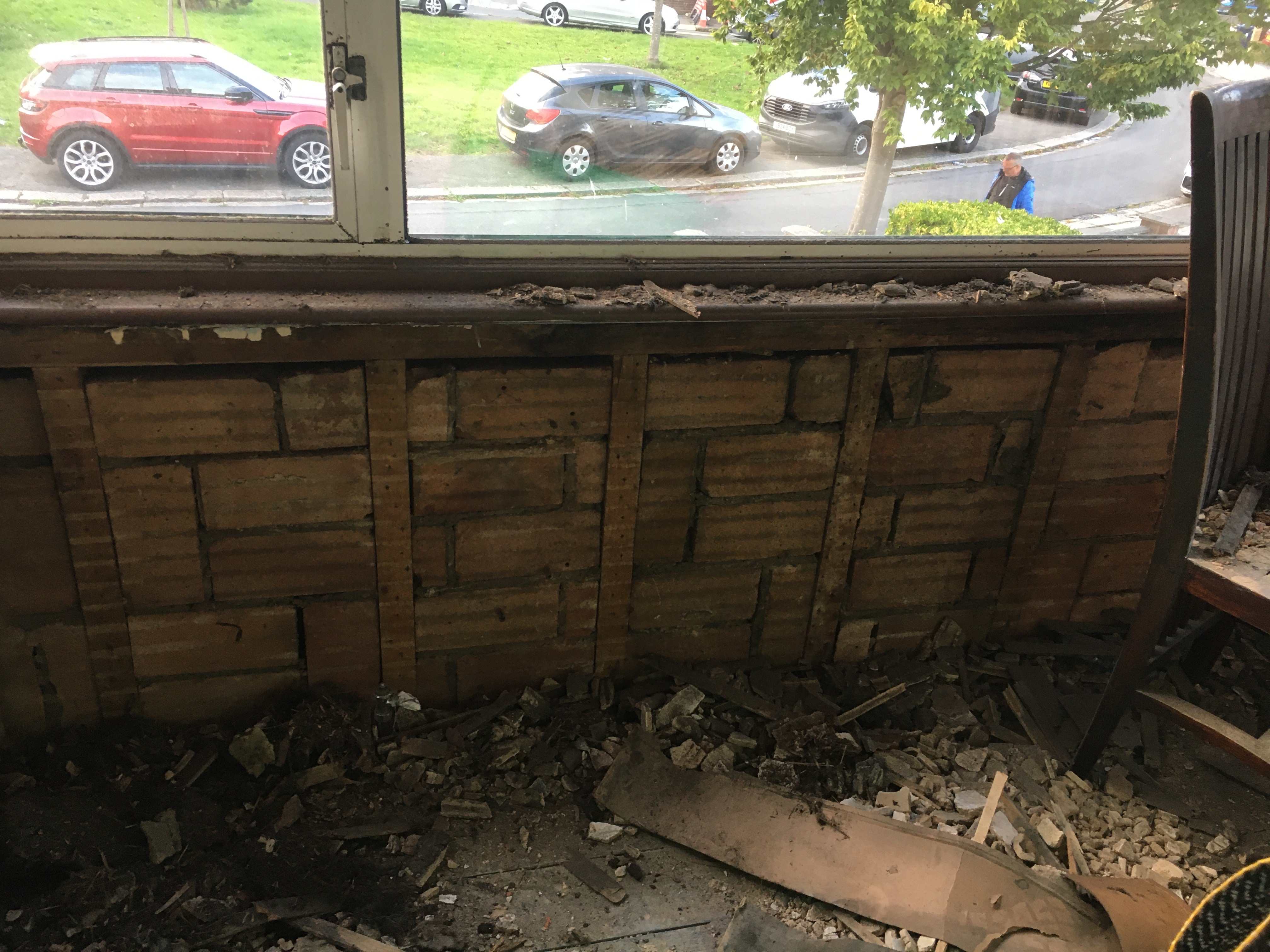

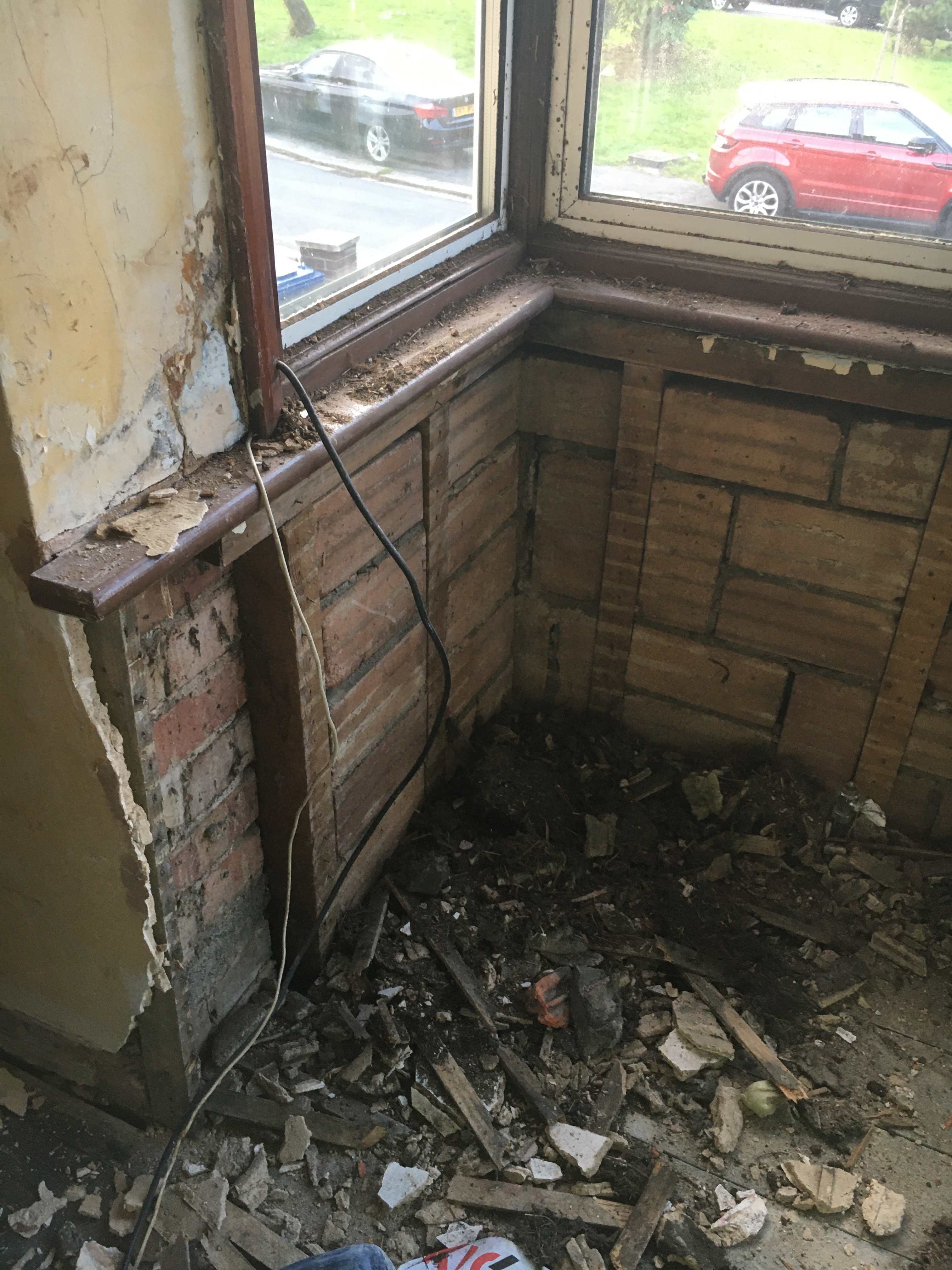

  17. Thank you Redbeard. If i could not remove the bricks i was going to add extra batons on the existing one to create an air gap and then use PIR Insulated plasterboard. This was going to be skimmed over with regular plaster. I have never heard of wood-fibre so thats something new. Do you think my original plan is ok or is the wood-fibre better.
  18. thanks redbeard, my gut feeling is that the the bricks are the render carrier but was not sure. I think i'll leave them as is. Thanks!
  19. Hi everyone. I am planning to insulate my bay window wall. I removed all the old plaster and am left with this. There are some bricks inbetween the upright wooden batons. I don't think they are used for any support. Is it ok to remove these bricks. The outside of the wall is a pebble dash render. Thanks in advance. Qamar qamar
