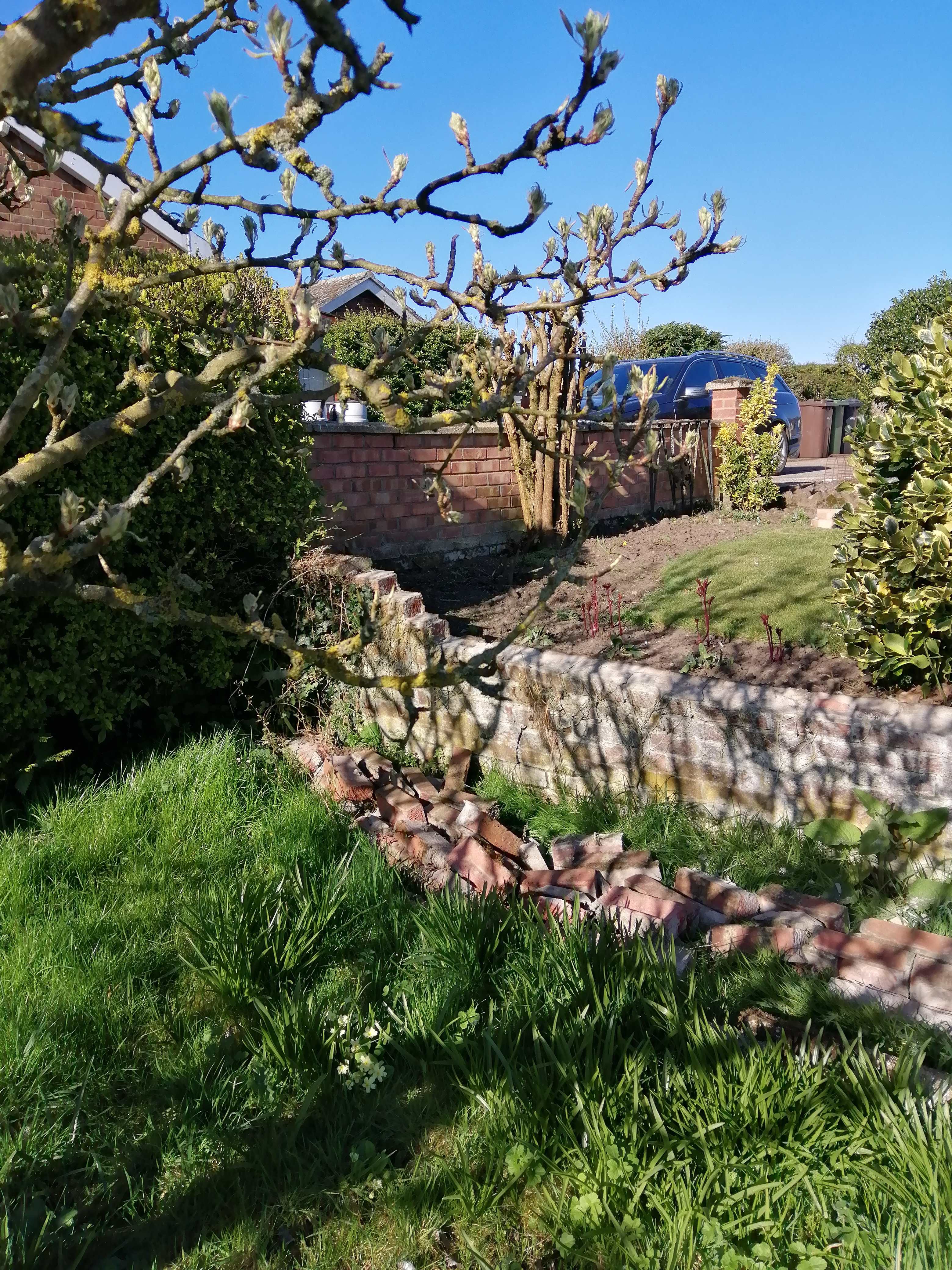

  5. The boundary wall between our bungalow and the listed building forms part of the curtilage of that listed building. Our bungalow is approx 6M away from the failing wall with a garden level approx 600mm higher than the garden of the listed building. The LB itself is approx 8M from the boundary wall and when standing in front of the centre of the failing part, sits at the 10 o'clock position with the nearest part being approx 15M away from that central point (I suppose a photo may be prefered, but cannot get it to load!). Whilst I cannot see that this is necessarily a planning issue, I can understand that the court of appeal decision requires a planning decision. It is the court of appeal that has dropped the matter into the lap of LPA, but it is my bank account that would appear to be the suffering one. Now that really ticks me off.
  6. It would seem that there are a number of people that have a question mark over the planning issue in this matter. I have to say that I am somewhat confused over it as well. The way the planners have spoken about it is that the wall is within the 'setting' of a listed building. It would seem that the court of appeal has (in 2018) issued a decision with regard to how a listed building is physically experienced and therefore it is this that 'setting' is considered. Just my luck, as is the fact that I now have 31 metres of open trench without being able to get a conc pour until Tuesday. I am now spraying a water mist over the sides of trench (clay) with all fingers crossed that I can keep them intact. The past week has not been without its trials .....
  7. Gabions - they had never entered my feeble mind. Like the idea, but the 'look' may be rather too modern for planning. No harm in trying though! Other than that, I have mused about concrete post sunk in concrete founds with concrete gravel boards with a face of 7.3nm conc blocks. It may seem a little fanciful to believe planning would agree to that type of facing, but half of that particular wall is actually conc block work. Had not been aware of that until now. Whatever I end up doing, I only want to do it once!
  8. Have been advised (by LPA) planning required. No listed building consent, we are just in the setting of a listed building. No party wall and no structural engineer. It is only me, and my (very) depleted bank account. Have had another look at wall and my original post was fanciful thinking. Need to be rather more pragmatic in the ideas area. Not too sure how helpful photo is
  9. The day before I started extension a retaining wall partly fell. It has lost 5 brick course plus capping from top, with the rest of the wall leaning over but seemingly not about to topple(I hope). I have a listed building as the neighbouring property and have, apparently, to apply for planning to replace the wall(?) I have thought that if I dig down behind existing wall, pour concrete foundation, build concrete block wall to reinforce existing I might then be able to to 'drag' back the leaning wall and secure to the reinforcement somehow. Is this thinking total fantasy?
