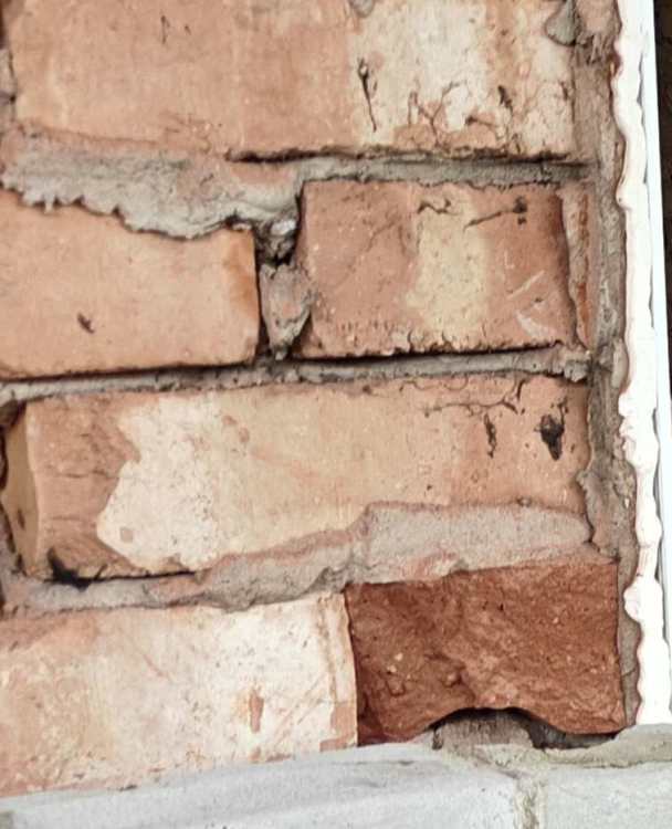

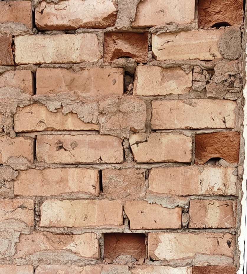

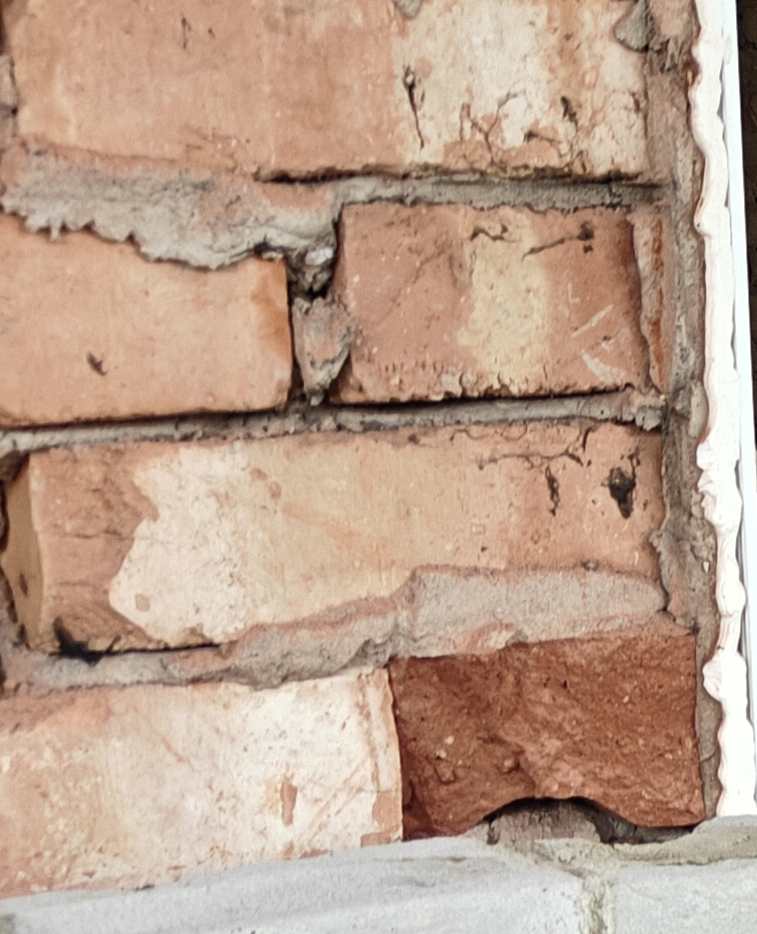

Sorry i was meant to say part grey brick and rest render where there is no grey brick. I've attached another photo that's all of the exposed element currently, I will try take a better one tomorrow. Now looking at it the small bricks look like they could have been used to bond the two walls together?
I need some advice on replacing the bricks on the lower half of an external wall on our 1920s home. The top half of the wall is currently rendered, and we eventually plan to re-render the entire house to match a new, lighter aesthetic. Our current focus is on removing the existing red bricks from the bottom half of an external wall and replacing them with light grey bricks. We've noticed a gap of approximately 10mm between the outer brickwork and the inner wall. There's no existing insulation in this gap, so we're planning to add insulating plasterboard to the interior. A significant concern is the apparent absence of wall ties connecting the outer and inner walls. Given these observations, what's the best approach to replacing the bricks? We're particularly interested in understanding if this is a straightforward "swap" of facing bricks, or if more extensive work is required due to the lack of wall ties. The chimney breast on the inner wall is coming out, so the inner wall on the bottom half may also be rebuilt with blocks. Also if there is no wall ties in the bottom half, we don't know about the top half. We are going to have the chimney breast removed from the top half, but may not need to rebuild that part of the wall, not sure at this stage. Our goal is to ensure the job is done correctly when we instruct a professional. Any guidance you can offer would be greatly appreciated.
