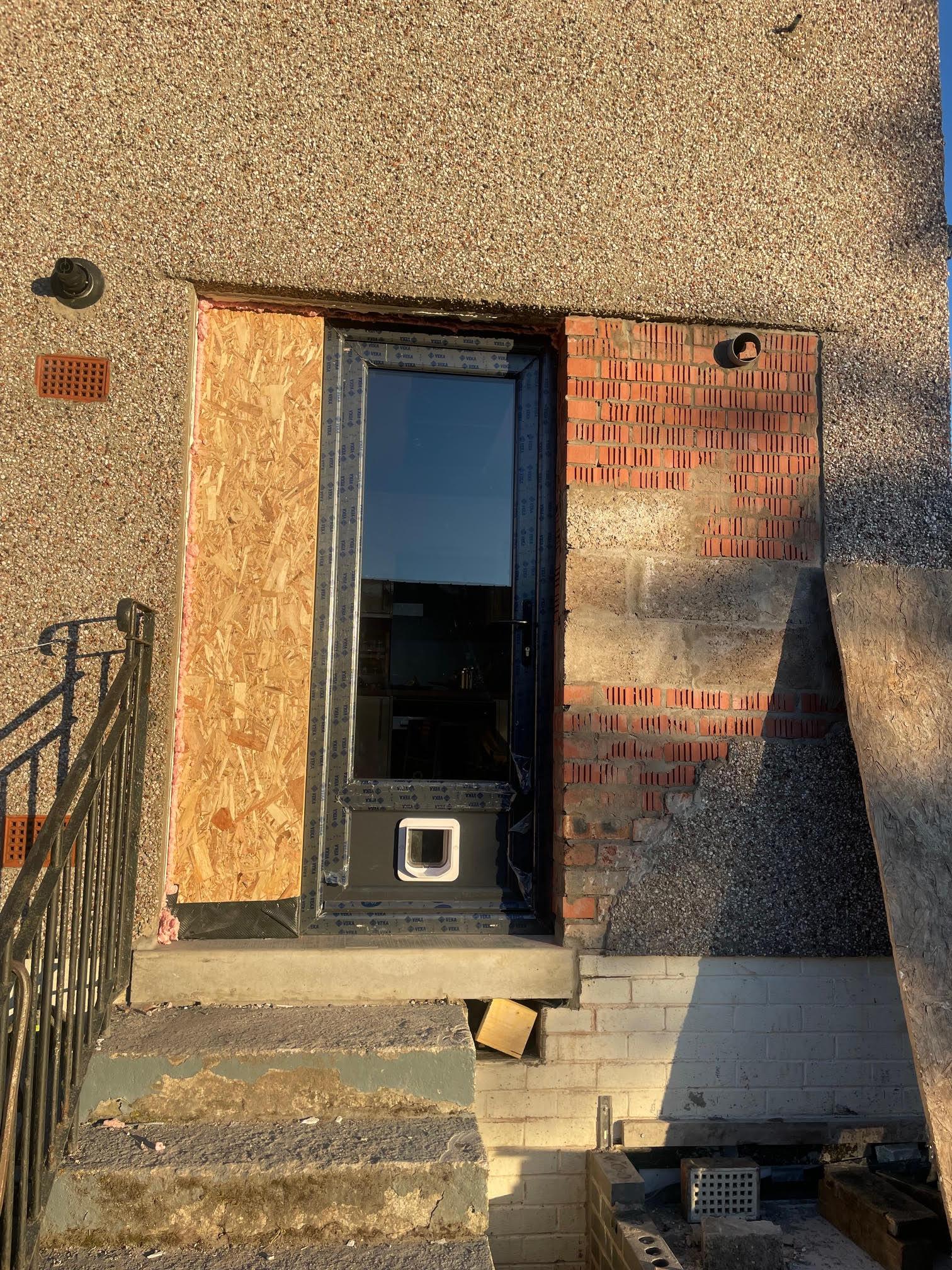

If you don't want to comply with the spacing between the window and doors as posted by @DevilDamo above you would need to introduce a wind post. You would need to get your structural engineer to spec that and include it as part of your building warrant application. Porches are typically classed as permitted developments so long as they don't exceed any of the required criteria. If you do have planning and want to change the window or door size then you (or your architect) may be able to submit that as a non-material variation assuming the changes aren't critical. Also need to consider lintel type and minimum bearing required. If you are going for separate lintels for the door and window minimim bearing of a robelsee type precast lintel is usually 150mm. So you would need 300mm between the window and door. You could get a larger capacity lintel and span the full distance between the window and door. Assuming you are rendering. Pretty sure Catnic style lintels for ifyou are using facing brick have a similar bearing requirement. -

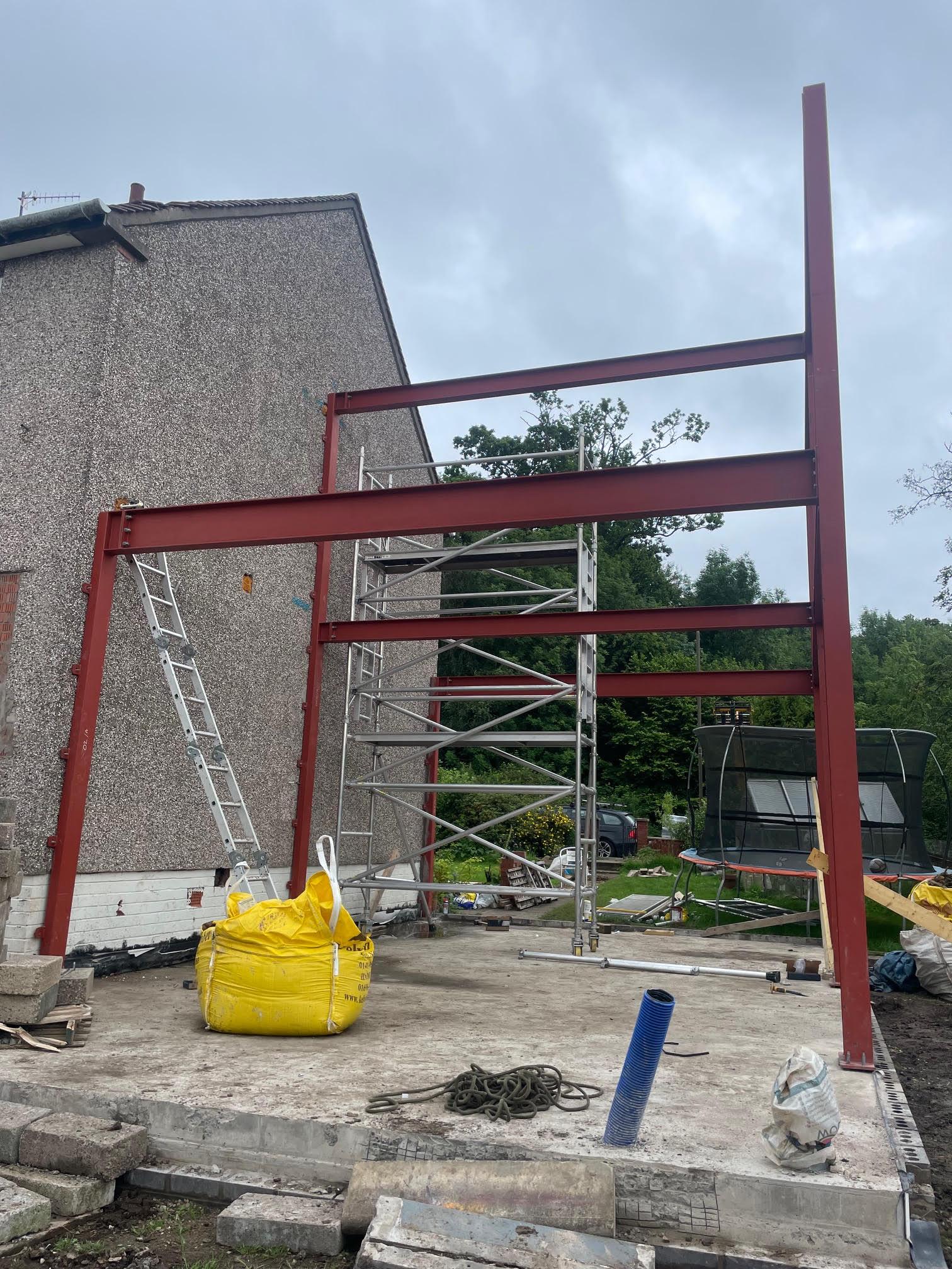

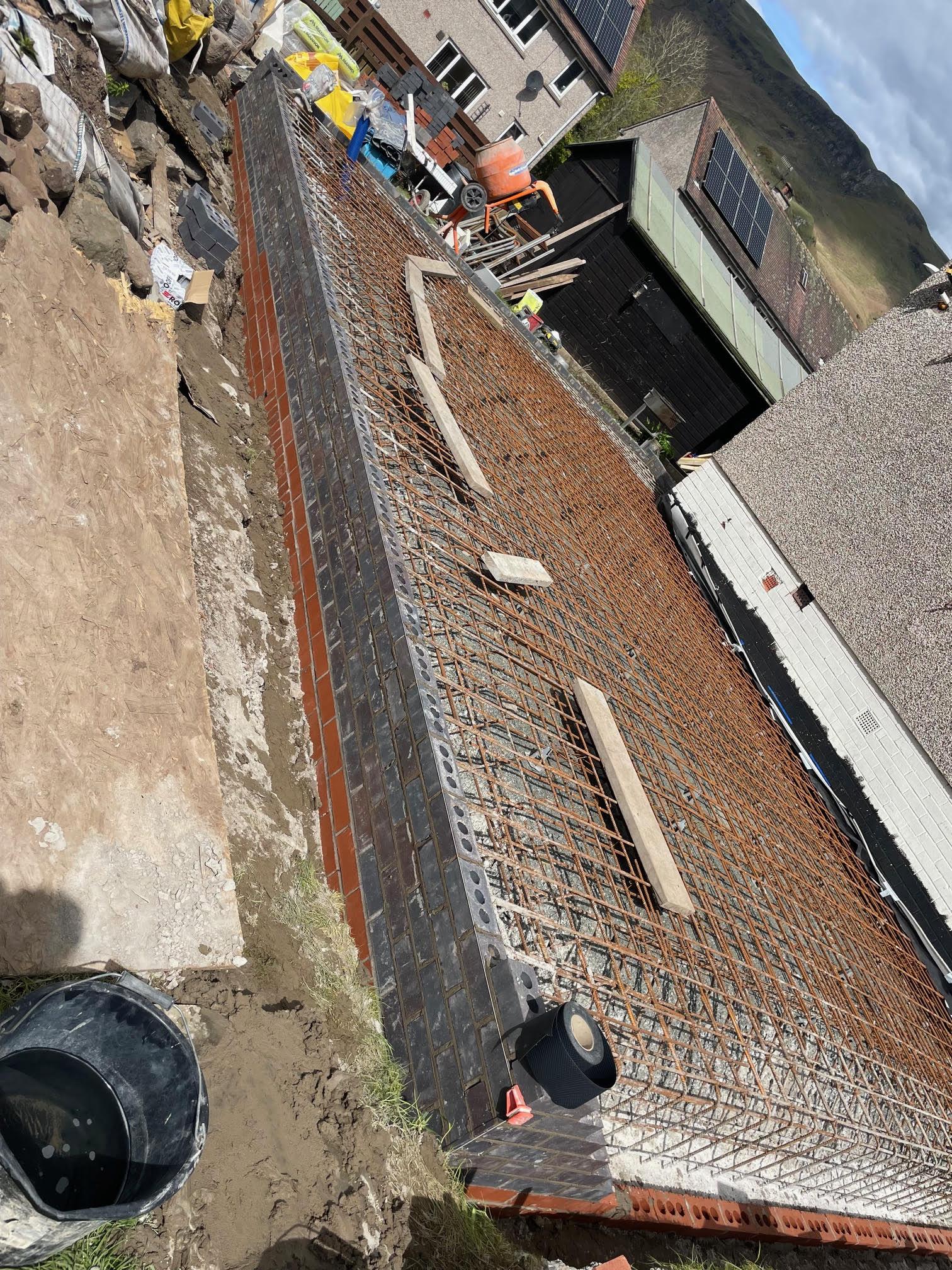

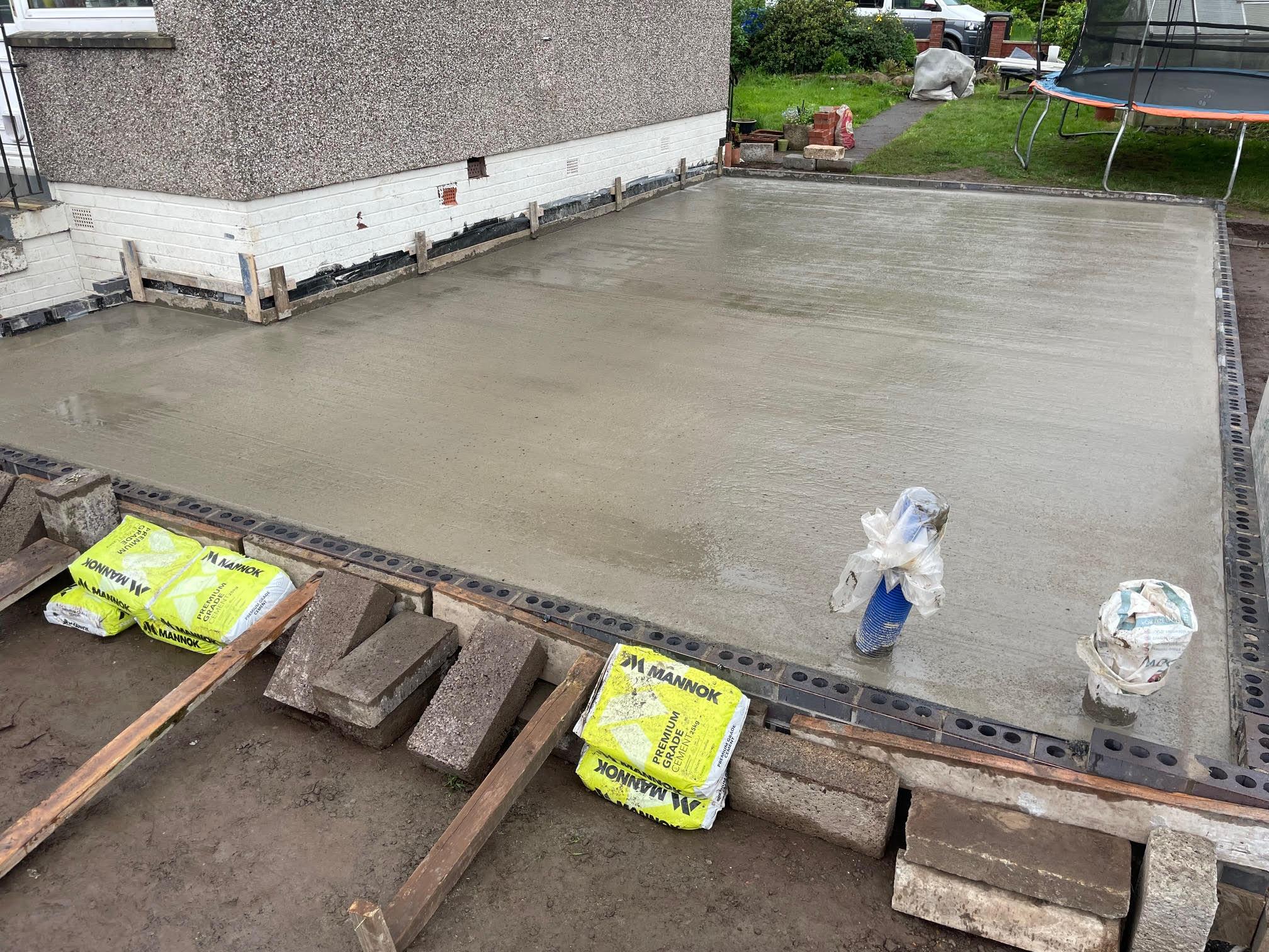

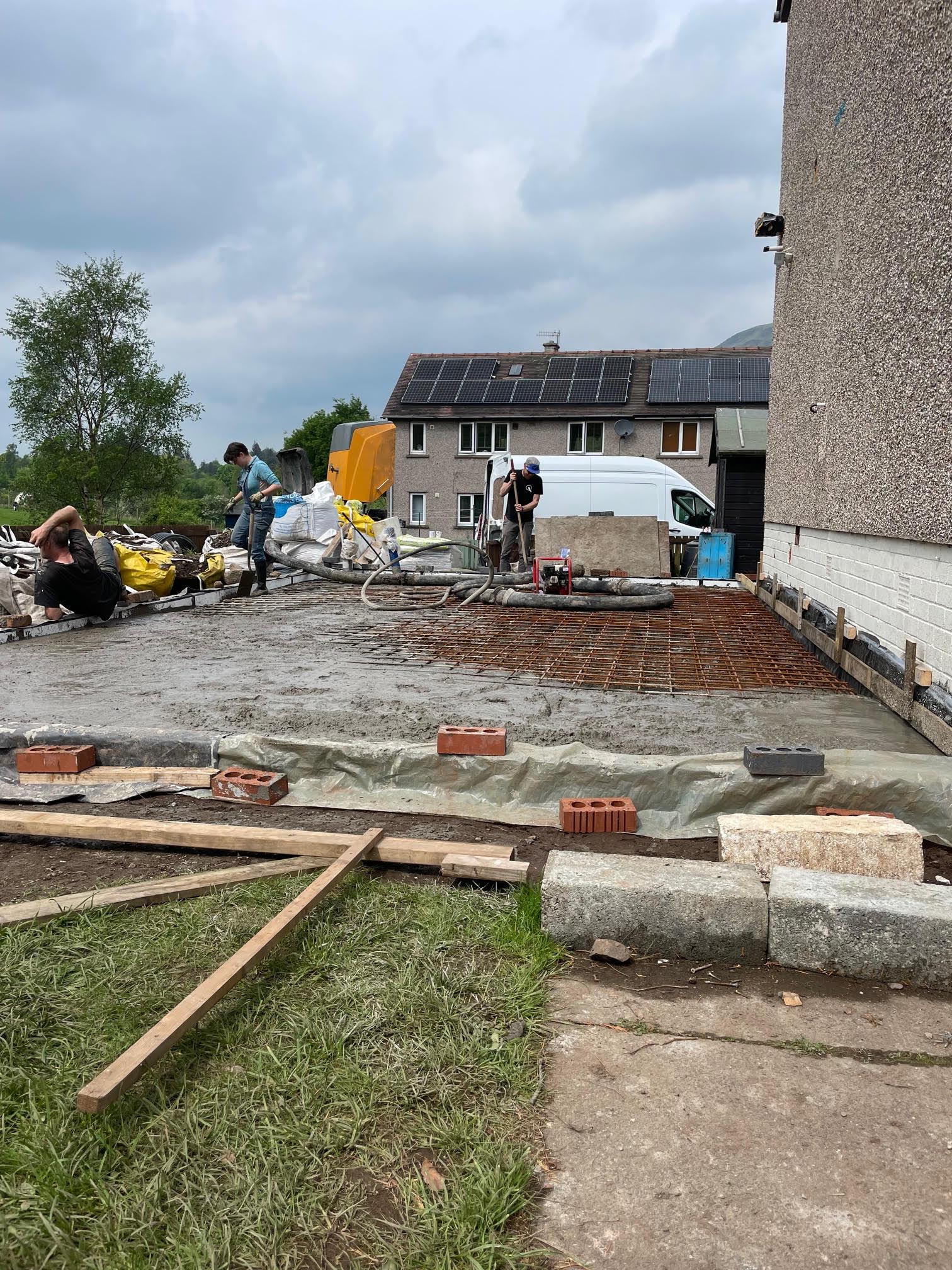

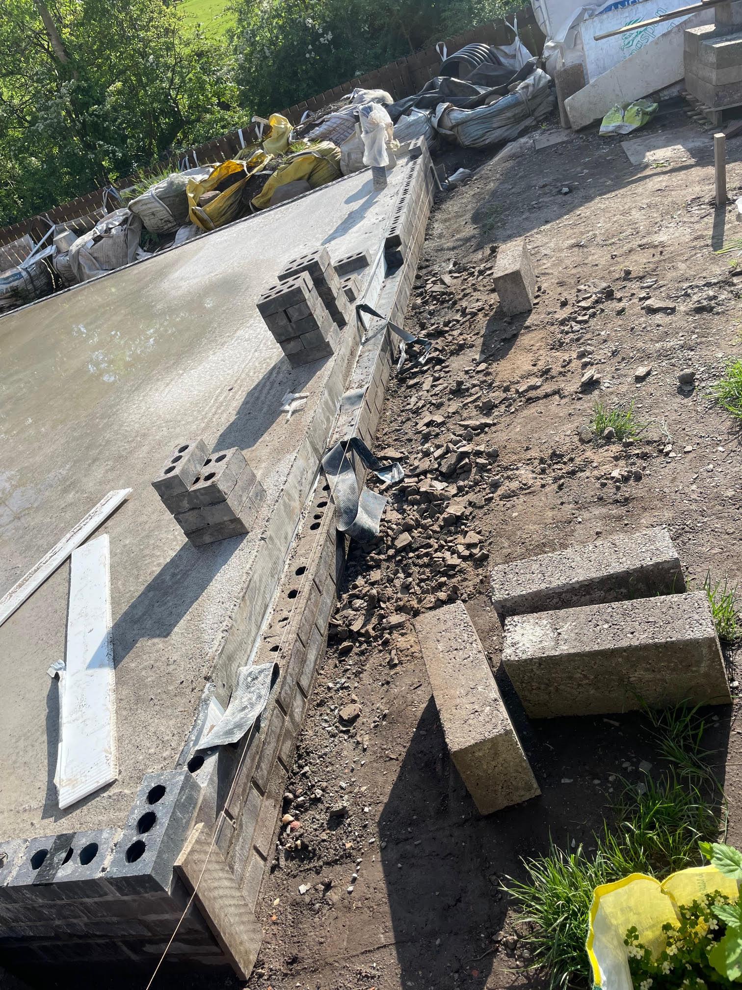

Hey all I have finished the raft slab, underbuild and steel frame. About to start the joinery which is where I suspect I will need to ask questions! I had to get a build over permit from Scottish Water so if anyone has any similar issues with drainage assets within build footprint I can offer some advise or info on how my appeal process went (also a civil and structural engineer which helped!). It took a year but I got approval in the end. Doing all the work myself with the help of family and friends. Some pictures of progress to date. Taken a year to get this far from first breaking ground. A lot of digging, some type 1 compaction, even more rebar tying and a couple of massive concrete pours later! Then 3 days of craziness and a fun using a 12m tellhandler to install the steel frame here I am.... awaiting delivery of timber. Suddenly it all seems real and definitely past the point of no return. The extension includes changes to the exitsing which I have been doing as I go. New stairs into loft and loft conversion. Removed some walls and moved the back door. There will be 3 slappings through the existing gable wall into the extension, one at each level. Can't say I am looking forward to doing those. Looking forward to being part of the community. Cheers Hannah
