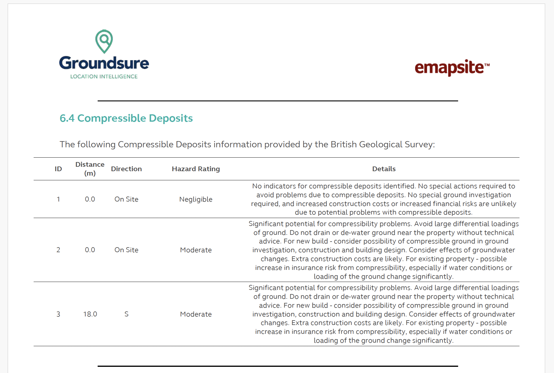

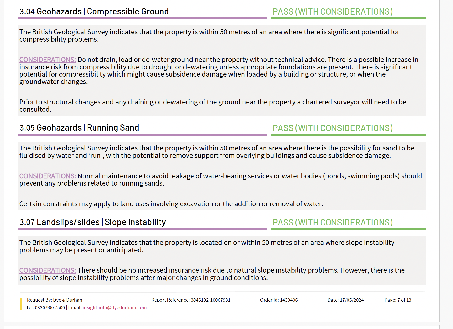

Hello, just giving a conclusion to this. We pulled out of the sale, not due to the lack of structural warranty in the end, but due to high flood risk (a brook and a culvert converging right next to the building which is at the low point of the land) and the geological report indicating medium risk of subsidence due to compressible deposits. Spoke to a surveyor who said their structural report on the existing build pre conversion wasn't worth the paper it was written on, the flood risk was a serious concern, and to run away. Spoke to a couple of friends who are geo-environmental engineers and they suggested questions to ask them about the build to check the foundations were suitable, but they didn't answer. Also knocked on the doors of the neighbours who said don't buy it, it's flooded several times and the bridge to access it needs rebuilding every couple of years these days due to surface water flowing down the hills. And they never did come up with the initial notice information for the building regs final certificate, so we have no idea what was actually certified. Thank you all for your help. I've learnt a lot! And spent a lot of wasted conveyancer fees, but such is life. They've relisted it as is, so it will be interesting to see how long it takes to sell. I guess they will be looking for a cash buyer who asks fewer questions and is less concerned about floods. -

Hello, we're looking to buy a bungalow that is a recent conversion from a stable block with a 30% extension (all single story). It has a myriad of problems, several of which have been resolved by better paperwork, but the geographical surveys are worrying me. As it's recently been converted, it's too soon to spot any cracks or subsidence issues. The original stables is about twenty years old, and the extension 3 years old, and everything has been reskimmed, outer bricks added, and a new roof, so it's very hard to spot problems. It's built next to a stream. The geographical survey results came back with the following cautions. I've asked for a structural engineers report for the building design and photos of the foundations etc, but I'm not sure what I should be looking for. The structural survey of the existing building for planning was sparse - it was just a surface inspection, no pits dug and no looking at the existing foundations, which predated the owner so there's no knowledge of its construction. Are these unusual/worrying reports, and what should we be looking for to see if they have built it correctly? Expansion joints between the older (20 year old) stables and the newer extension? What kind of foundations would you expect to put in for the extension in this type of ground? This house is giving me all sorts of heebee jeebees now but my boyfriend is still keen on it so I'm trying to be open minded until we have a definite reason to pull out. Thanks for your help!
