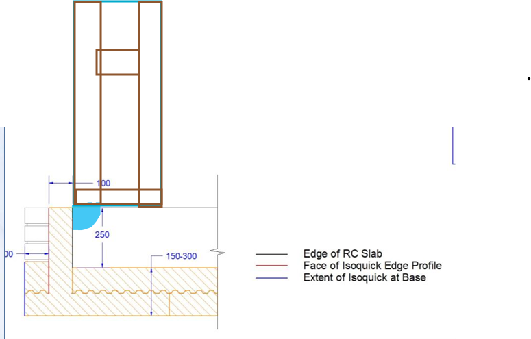

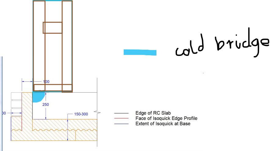

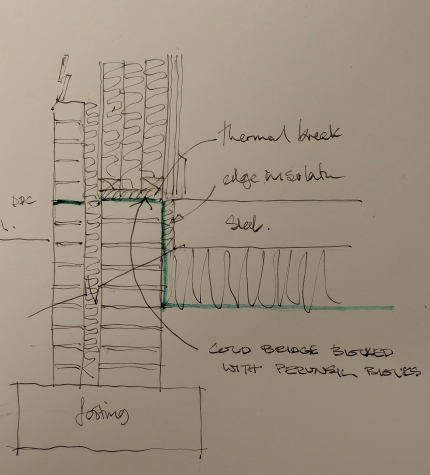

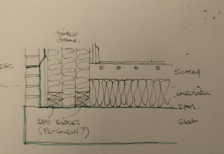

We are due to build a 130m2 near passiv house timber framed 1.5 storey house with a brick plinth in the early summer. We decided to go larsen truss timber frame I was hoping to have a highly insulated structural raft (u-value .10) with UFH in the raft but now my designer has been informed by the SE that the larsen truss will be structural both on the outside and and inside studs so will need to be fully supported, He had initially assumed that only the internal stud would be structural which would have allowed the non structural outside stud to cover the insulation between the brick plinth and the slab. This change produces a cold bridge as shown below in blue. He is now suggesting that we should go with strip or trench foundations and a slab as shown in the drawings below. I am concerned that there will be cold bridging and a u-value of.10 may not be achievable. Any thoughts on his suggestions and how they can be improved or how we can still use a insulated raft?

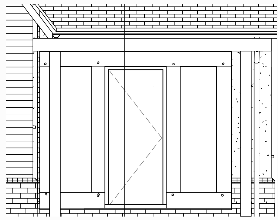

We have permission for a small 1.5 floor house. This is due to have some green oak framing internally (not structural) and an external oak framed door with a fixed triple glazed pane ether side. I want the house to be well insulated and airtight. I am therefore getting a bit twitchy about the green oak and am wondering whether I could use oak glulam instead as it would then be possible to glaze using aluclad softwood windows and door frames within the glulam frame to match the other windows. Yes i would lose some light but I would have less hassle in the longer term and better thermal efficiency. Any thoughts on the concept and who I should get to do the work? The frame is 2.7m long and 2.1m high. Has anyone done anything similar?
