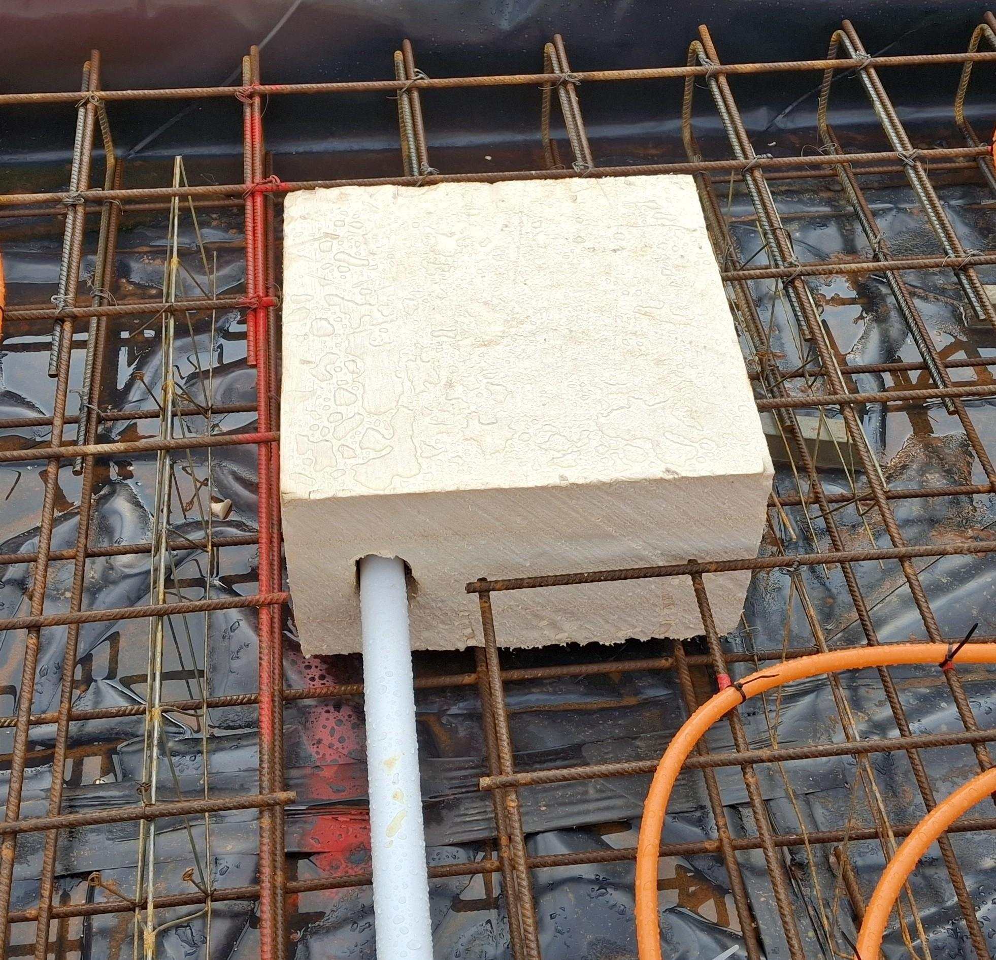

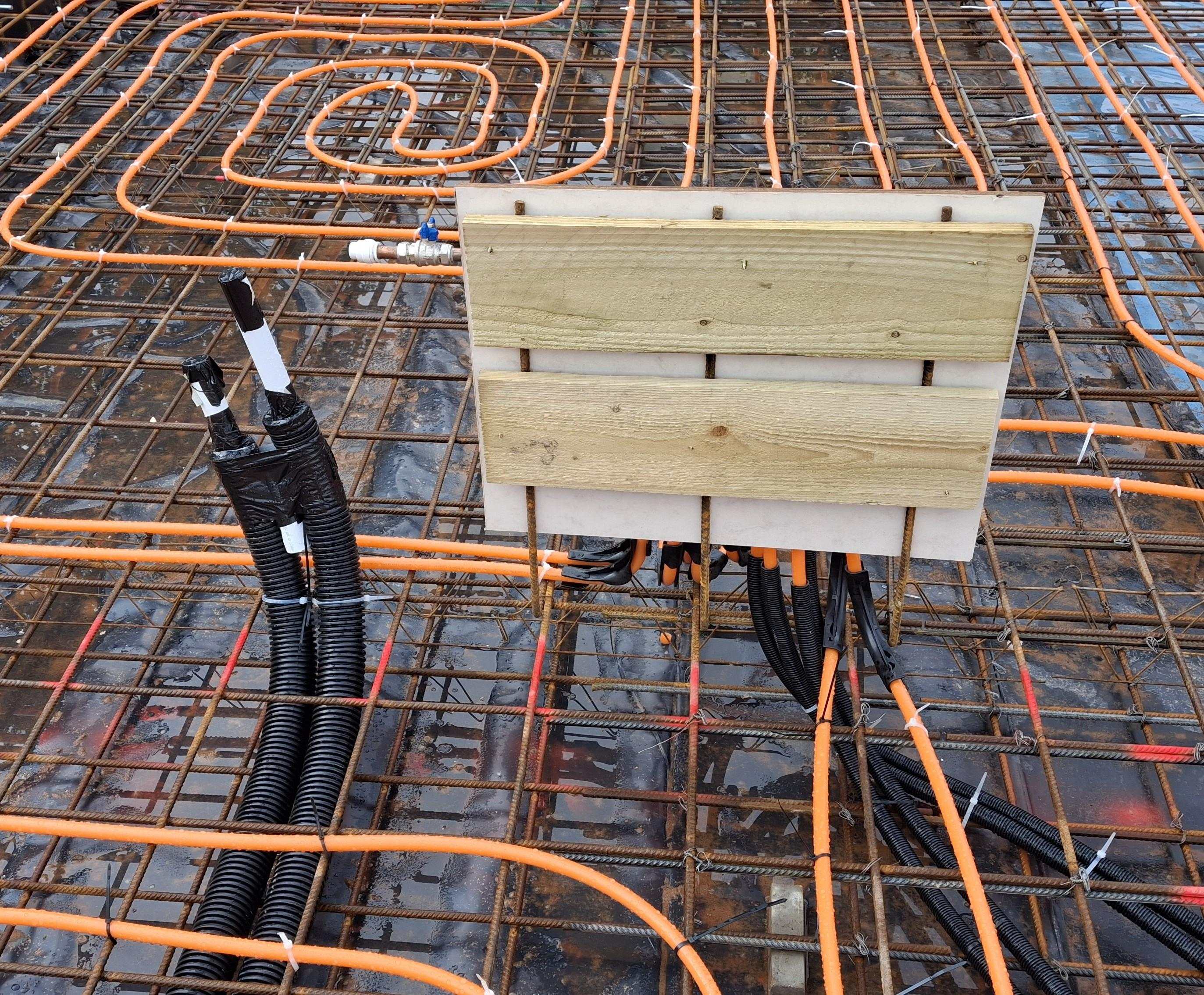

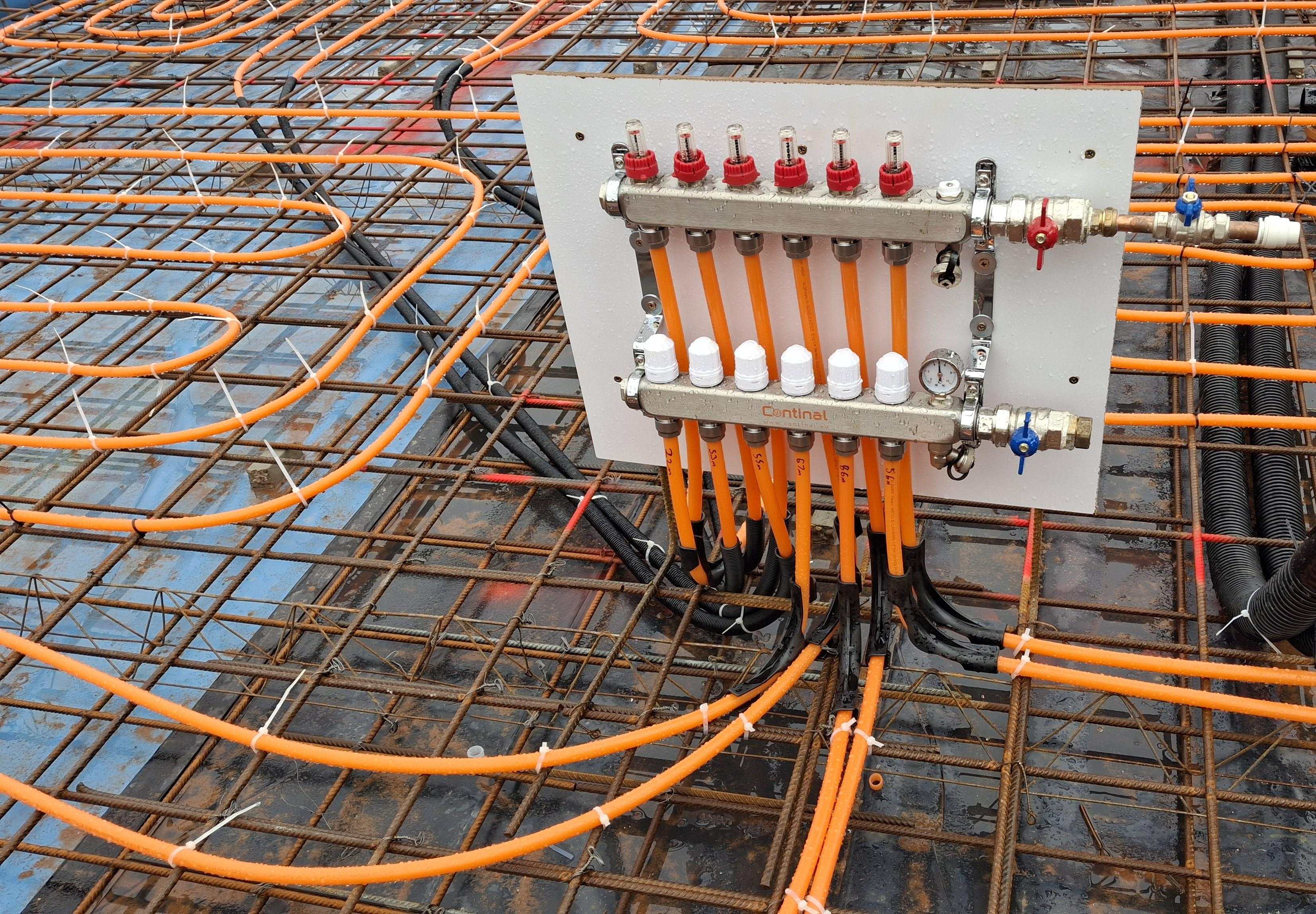

  5. We are due to pour our insulated reinforced raft next Friday. It is all ready except for 1) sealing and tying down a block of XPS attached to the waste pipe to give a void for the shower waste. - Do I need to cover in DPM?, - PU foam around the pipe to seal concrete out - Is tying down the XPS with wire OK. - Should I lift it up from the rebar mesh using concrete "mars bars" to help continuity of concrete and 2) How to protect the pipes under the manifold from over energetic power float operators! Possibly boxing out the area with plywood? Any suggestions on the above or the pour generally would be gratefully received.
  6. Thanks , I will ask the contractor. There will be no contraction joints in the raft- This is a highly insulated house so the UFH will run at a low but stable temperature .Once cured there should be little expansion and contraction

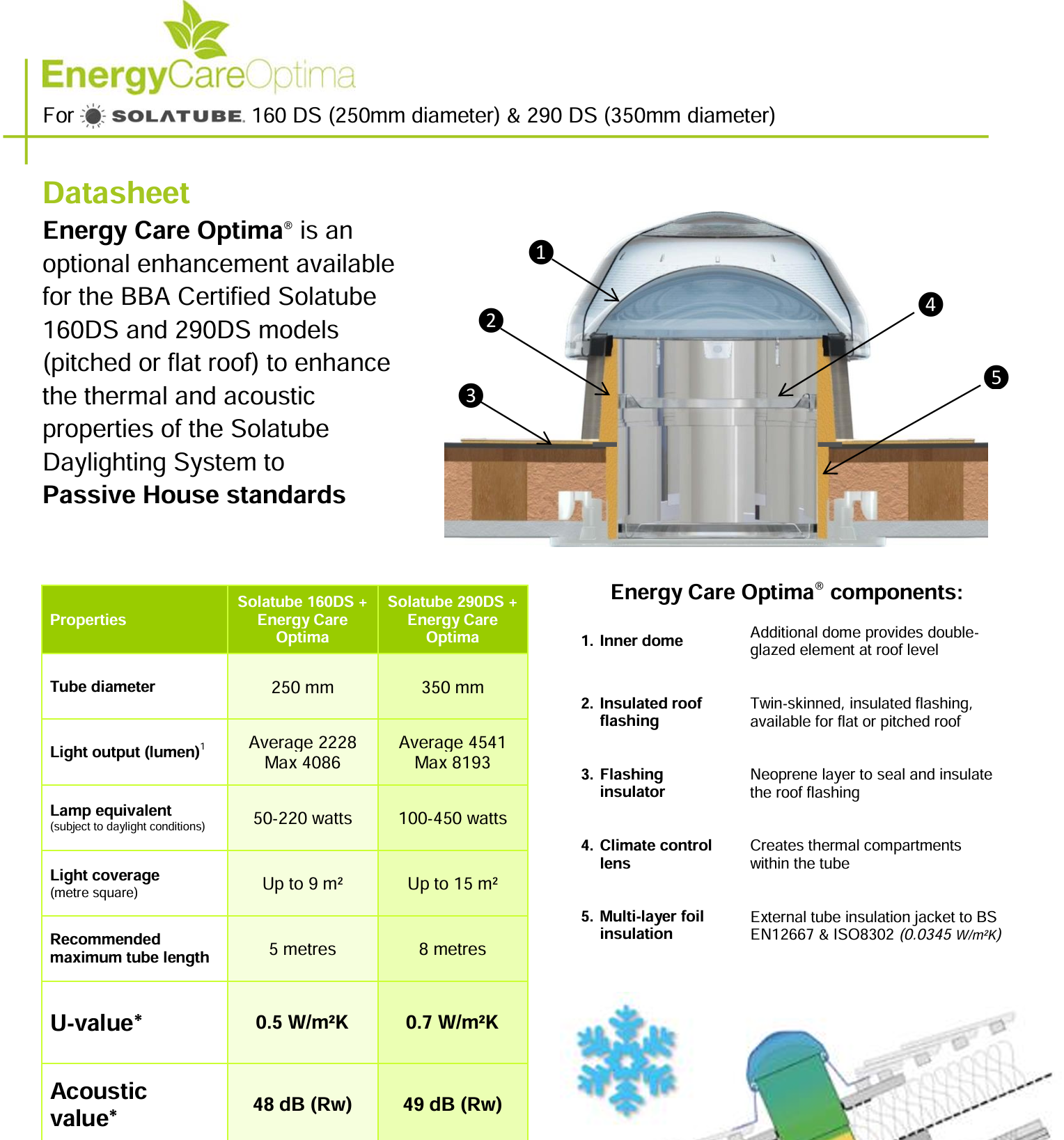

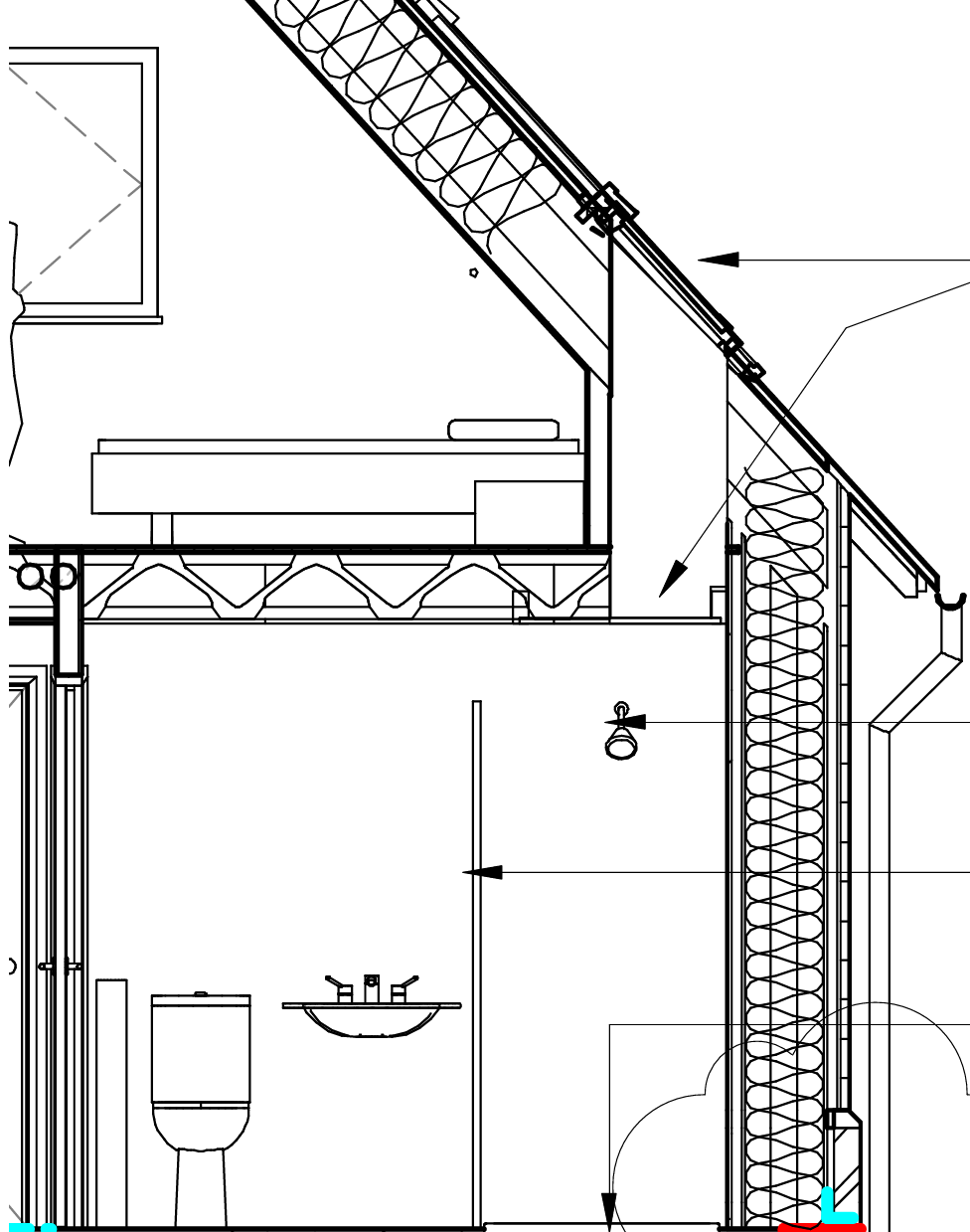

  12. In a word No! Although it s only a periscope of sorts , it needs to be a1rtight and thermally functional and aesthetically attractive both internally and out. Maybe worth the effort if i needed 5. Thanks for your help.
  13. Contacted Monodraught. They agreed that their Sunpipe is not designed to be airtight, Solatube however do have a passiv house standard version of their product that has 0.5w/m2k u-value and gaskets to ensure that airtightness. So I am probably going down this route.
  14. Many thanks I will contact them on Monday
  15. We are due to start building a highly insulated 1.5 storey detached annexe in July. The downstairs wet room of approx. 4m2 is due to be lit by a small Velux in the roof at the edge of an upstairs. bedroom. I now need to use this area in the bedroom behind a bulkhead for MVHR pipes. My wife wants to have natural light in the wet room so she is suggesting a sun pipe. For me this will only work if it is well insulated otherwise condensation, due to cold bridging, may be a problem. We will have a number of Velux's on the roof so I thought that perhaps a Velux sun tunnel may work. However, these have a basic u-value of 2.9w/m2/k, though they do an insulation kit which drops the u-value to 1.8w/m2/k but only for the 14" version which would be too large for the size of the room. Has anyone used a Velux sun tunnel in a bathroom environment? and if so was there a condensation issue? Or does anyone have any other suggestions?

  23. @nod What are the main causes of the damage? - contact with the Power float, scuff damage from boots etc. and how to best avoid if determined to have UFH pipes in the concrete slab ?
  24. Many thanks for your responses - Luckily the concrete will not be the finished floor. We will be tiling over it! Are you aware of any youtube videos that show this?
