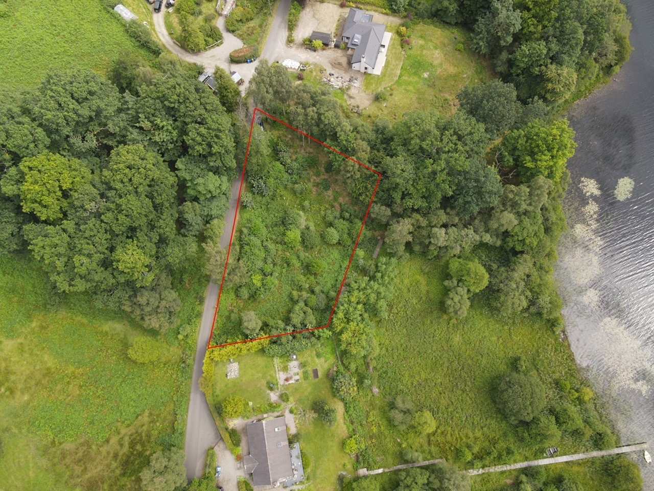

We are building in a National Park in Scotland (site plan allatched), and have approved plans to install a Klargester Biodosc system to treat our waste water before discharging to a water course on site. We were not involved at the point that the Klargester system was specified. From reading the forum, I've been convinced that the air bubbler systems make more sense than the Klargester mechanical agitation system, so thanks to everyone for the education so far. My next task is to select an alternative system and convince my architect & groundwork contractor (and SEPA?) to alter the intended plan. But before then, I have a question for the forum. This house will hopefully serve as out retirement home, but until then will only see occasional use. We live in Germany full time, and it is likely that the house will be unoccupied for up to three months at a time. Reading the different threads, there is a lot of discussion about cycling the pumps to best manage electricity consumption and treatment efficiency, but what happens if there is no new foul or grey water input for two three months? Does anyone have experience of an intermittently used system, or strategies for managing the unoccupied periods? Any advice on one system or supplier over another in this use case? Thanks in advance, Ross. Site Plan.pdf
Site Plan Site Plan.pdf
