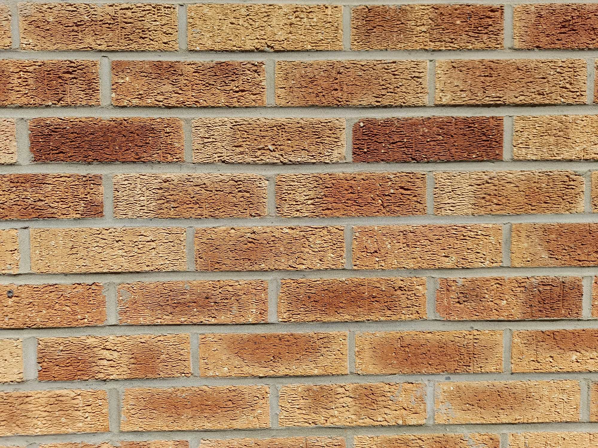

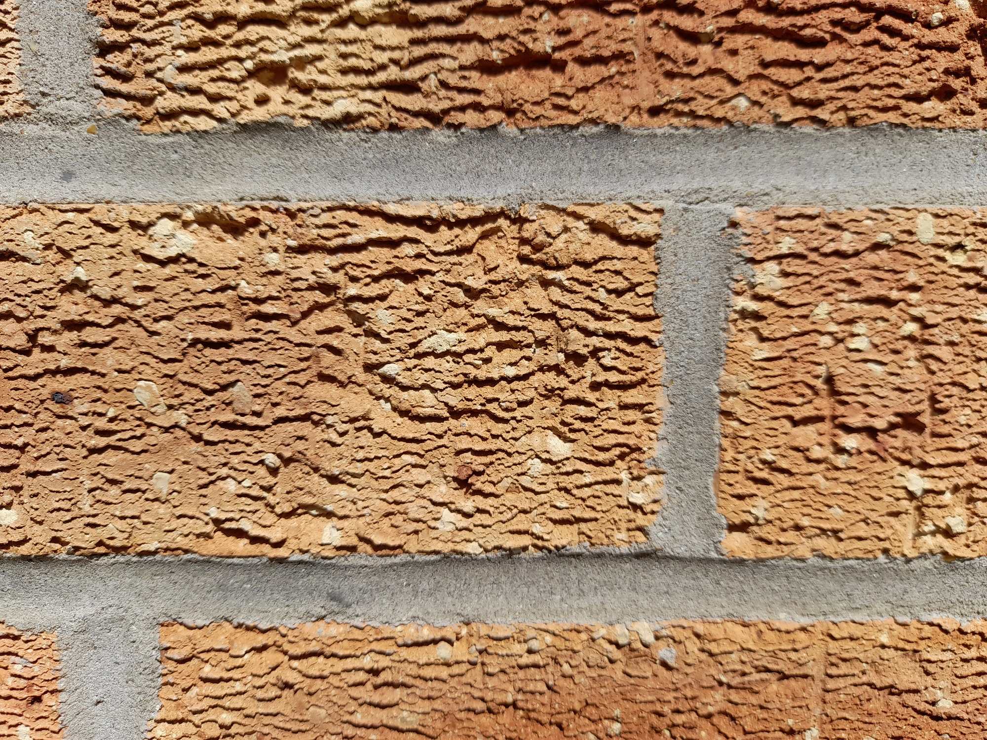

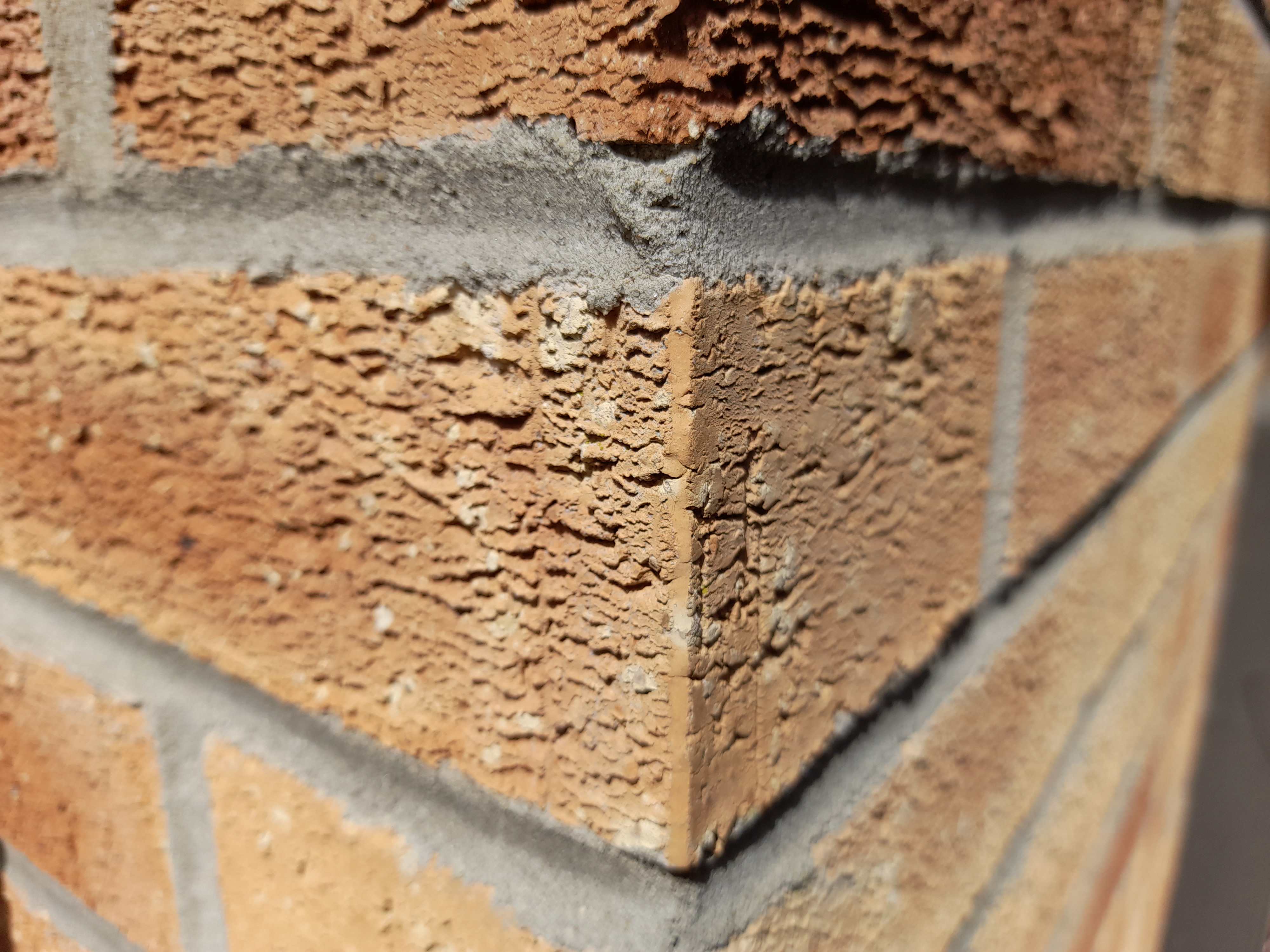

  1. Thank you Temp for the suggestion. Have tried planning with no luck. Forterra Old English have the right texture and edge bevel but too yellow.

  4. Hello I'm beginning to wonder if I will ever match these bricks. Closest I've come to them are Ibstock Anglian Multi Rustic. They are a pretty good colour and texture match but the corners are very rough. My existing bricks are more multi coloured but also have a small bevel on the corners. It makes the pointing much cleaner. Any suggestions would be greatly appreciated, even if just the manufacturer.
