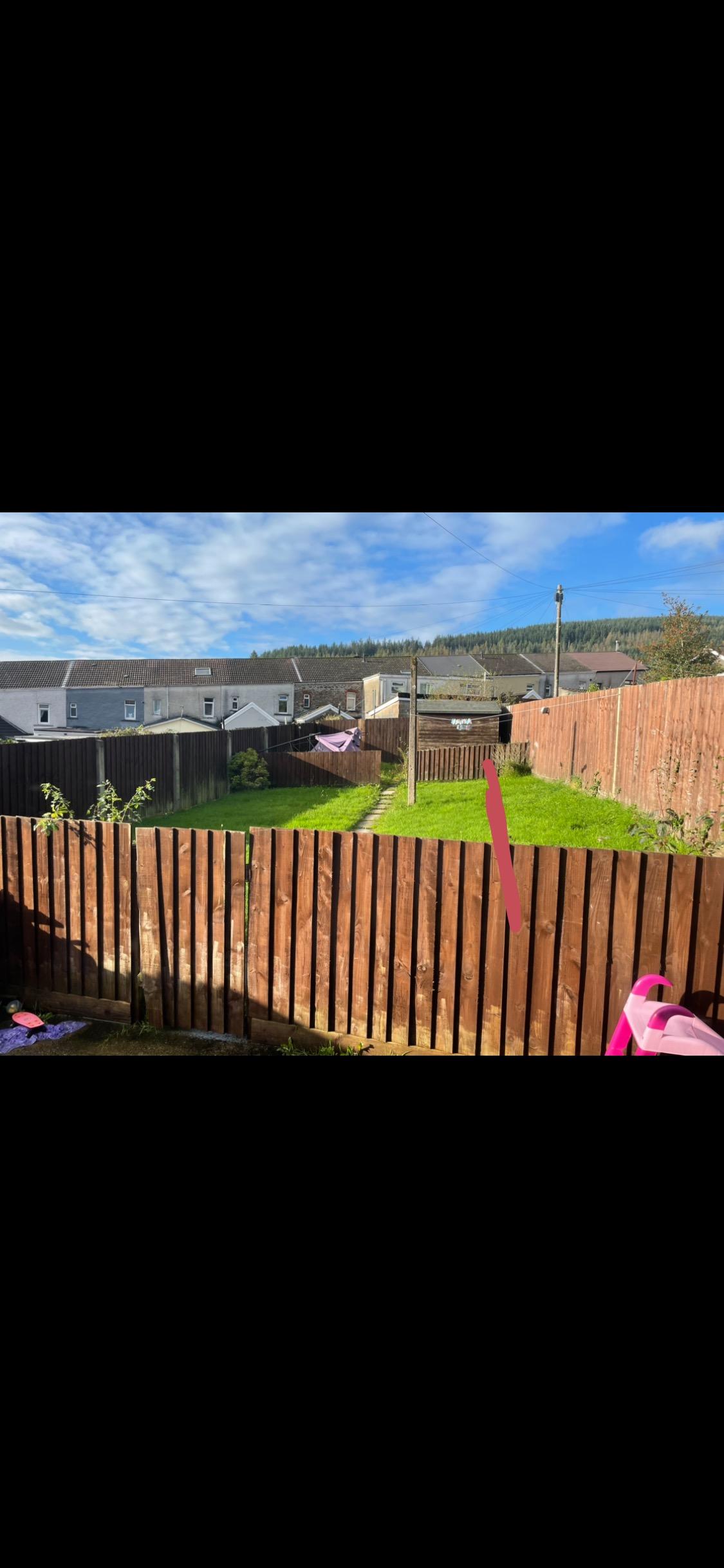

  7. Thanks again for your replies both. In response to your question of why Kelvin the answer is yes, to make it more usable. We have 2 young children so would love to flatten a large enough area to get some garden play sets, paddling pools, tables and chairs. It wouldn’t be as much of an issue if it was just me and my partner but would like the flat area for the children. I think flattening the majority and leaving the bank to the highest point sounds like my best bet at the moment. Access for a mini digger is ok so that will take a lot of the effort out of removing the soil.
  8. Hi Kelvin, thanks for the reply. Do you think what I have posted above is achievable? Digging down to the lowest point for about 75-80% of the area and then leaving the bank to the highest point? Many thanks.
  9. I had considered maybe just digging down to the lowest point on the left hand side of this line and then leaving a bank on the right hand side of the line. So the banks would start from the line and upto the highest point of the boundary. Would that negate the need for retaining walls? Thanks

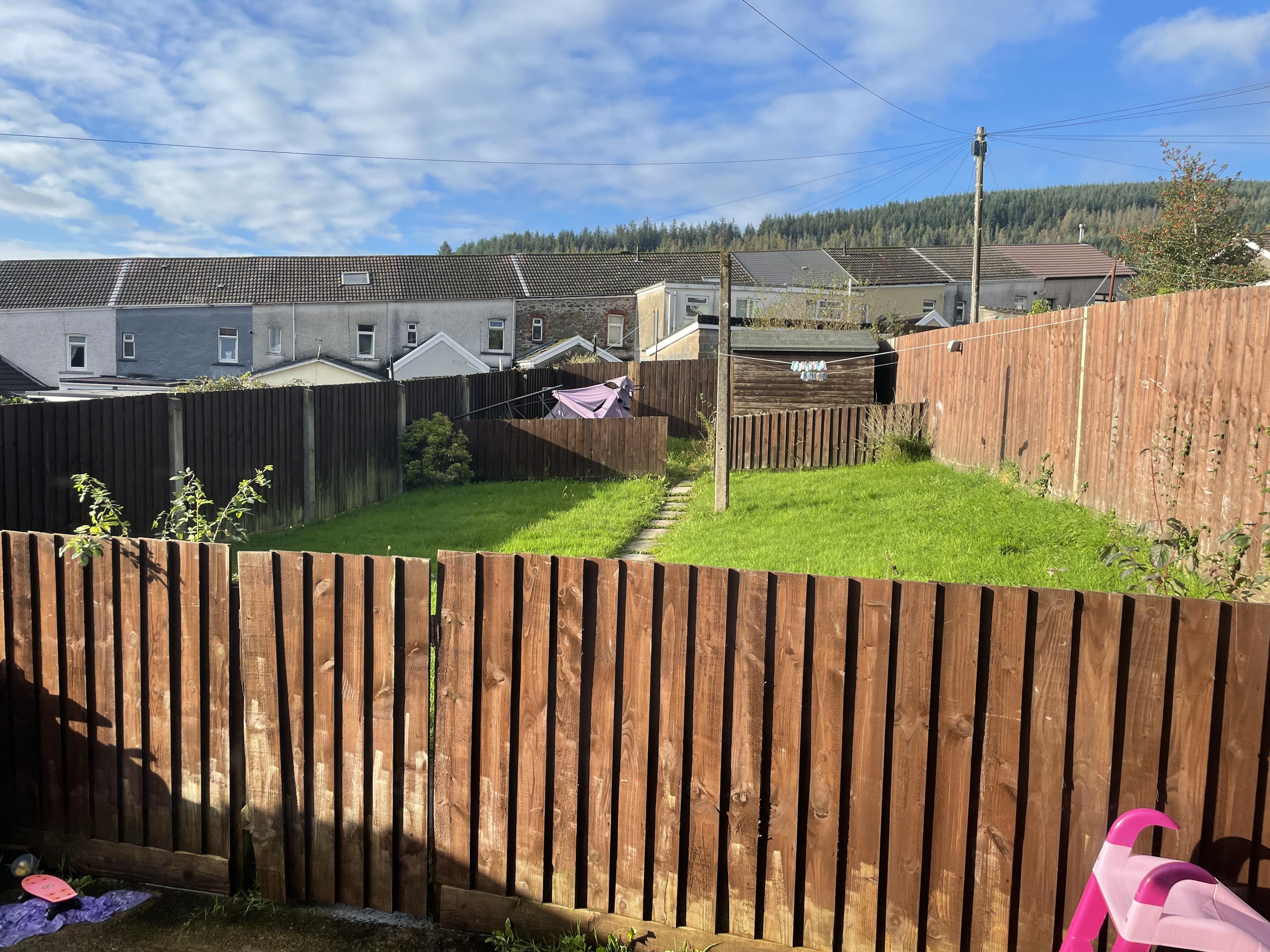

  10. Hi Joe, thanks for the reply. Ideally yes, I would like to retain all of the middle section that you see in the photo between the front and back fence as I would like this to be flat and same level. It is unusable at the moment for a table and chairs or any kids garden toys so would like a large flat area.
  11. Hi all, First post here so go easy ha. Looking to do some work in the garden before the summer comes in but not sure how to go about what I’m looking to achieve. You can see in the picture attached that our garden slopes from right to left with neighbours either side. There is a difference of 1170mm from the highest point on the right to the lowest point on the left. Rather than remove or add soil I would just take from the highest point and add to the lowest point. Would that then mean I would have to retain both sides? It might not be clear from the photo but the boundary fence curves towards the back and that leaves me stumped with regards to retaining. Would I somehow follow the curve of the fence or just build a straight retaining wall? Any help would be greatly appreciated.
