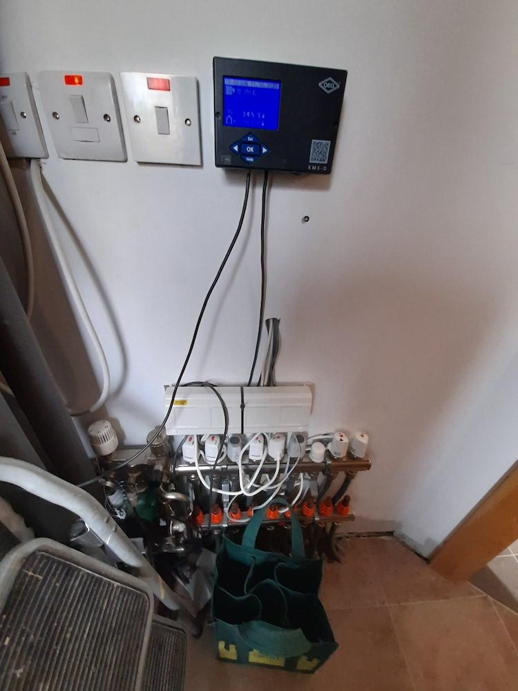

  6. Thanks for the reply. The controller is a German make, OEG. The room stat is Salus. It is connected by wire to the controller and the controller is then connected to the wiring centre and then onto the actuators on the manifold. I've attached a pic showing the controller and manifold. The wires coming out of the wall just above the wiring centre are from the controller, one for each heating zone. Sorry, I think I got that wrong. The wires coming out of the wall above the wiring centre (white box with cable tie holding it closed - catch is broken) I think are the wires from the different room stats. Does that make more sense?
  7. I'm not sure if this is the right forum for this, mods please move if required. We have a room stat in our bedroom. But the relay has a really loud click each time the stat turns on or off. It is wired to the UFH manifold wiring centre. What I wold like to know is if there is a silent or very quiet room stat that I can get to replace this noisy one. Thanks

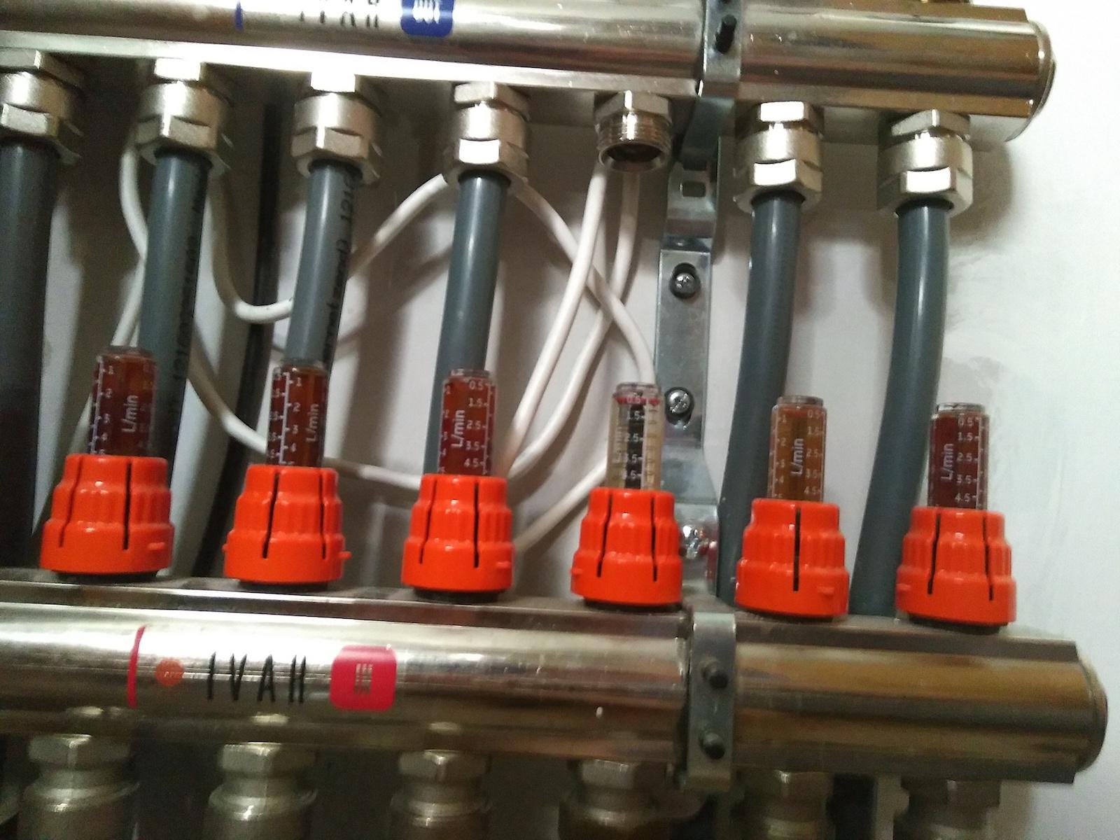

  13. Folks I took a good look at my four year old ufh manifold today because one of the accentuators was sticking. I discovered that the pin that opens and closes the valve had stuck and there was a bit of rust around it. I got it sorted with some WD40 and a bit of judicious tapping with a hammer and it seems to fully work again. I then noticed the gauges (?) that show the rate of flow and all that are in use had rusty coloured water in them. I attach a photo. Different circuits are different shades of brown. One gauge is still the original clear colour but this circuit is not connected (3rd from the right in the photo). The water is heated via an oil boiler. Should I be concerned and should I do something such as have the entire system flushed out and the fluid replaced? Thanks

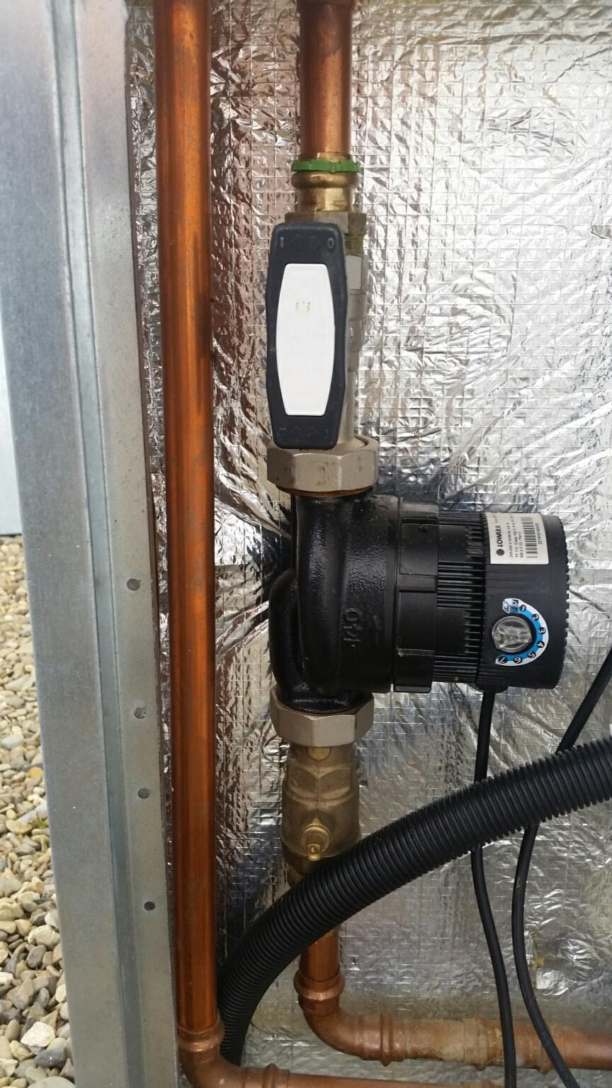

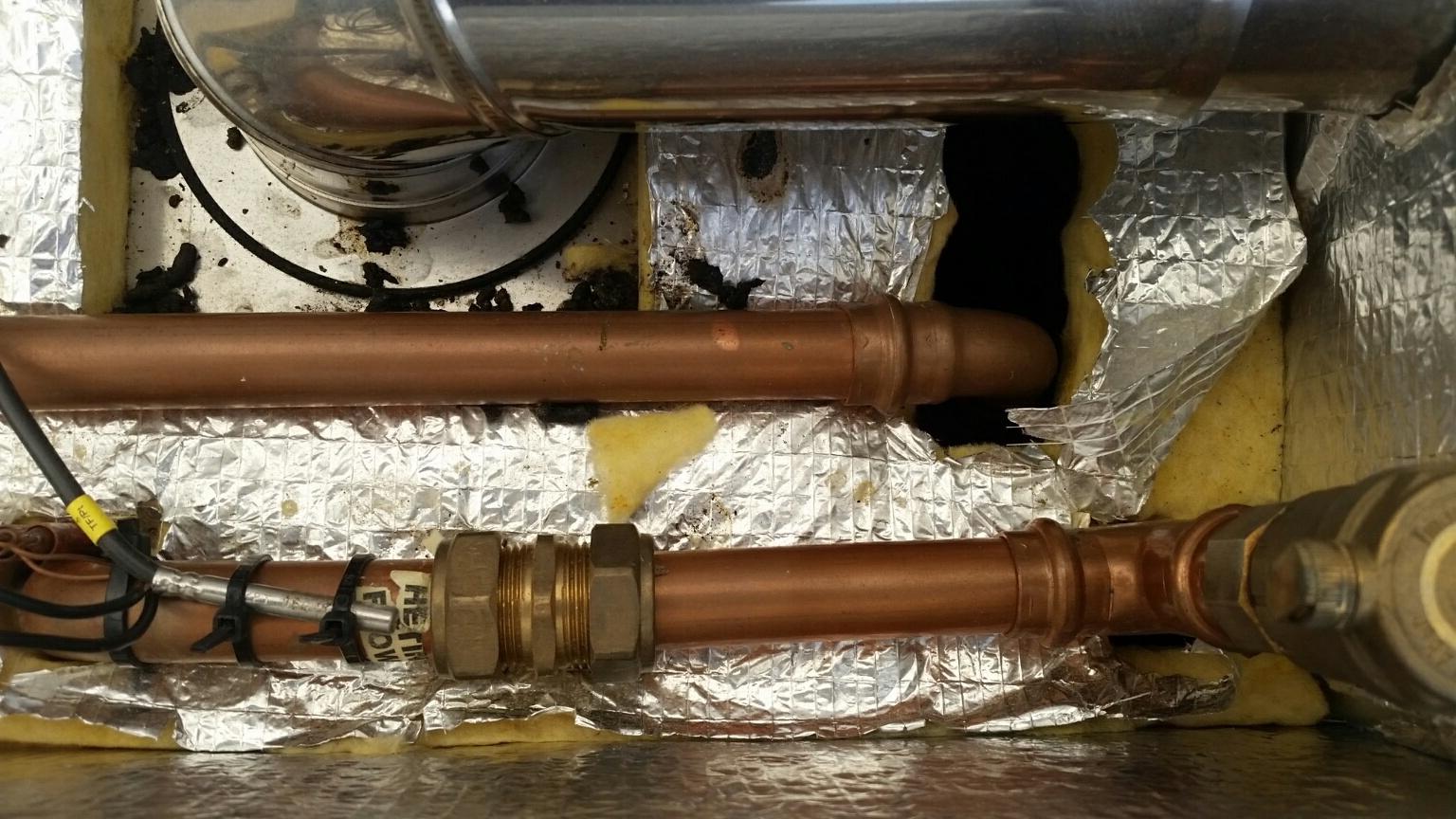

  15. PeterW Thanks for that explanation. Beginning to be clearer now. I can't see a gate valve on the flow but there does seem to be some sort of isolating val either side of the boiler pump. I'm attaching a couple of photos. First shows the pump and the two valves. The second shows the top of the boiler cabinet. The lower pipe is labelled "Heating Flow" and has the sensor from the control unit attached by the cable ties.

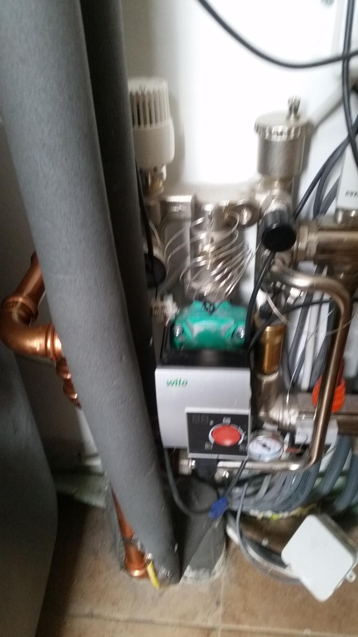

  20. Thanks for that. In answer to your questions, the TS has two sensors that measure the temp up high and further down. The is a stat valve on the manifold is that what you mean? There is also a pump on the ufh manifold. I've attached a photo of the set up. The two grey lagged pipes on the left are the flow and return from the boiler. You can just make out the spurs going to and from the manifold. The mixer valve is on the top left and the pump is the green device. The red dial controls the pump speed.
