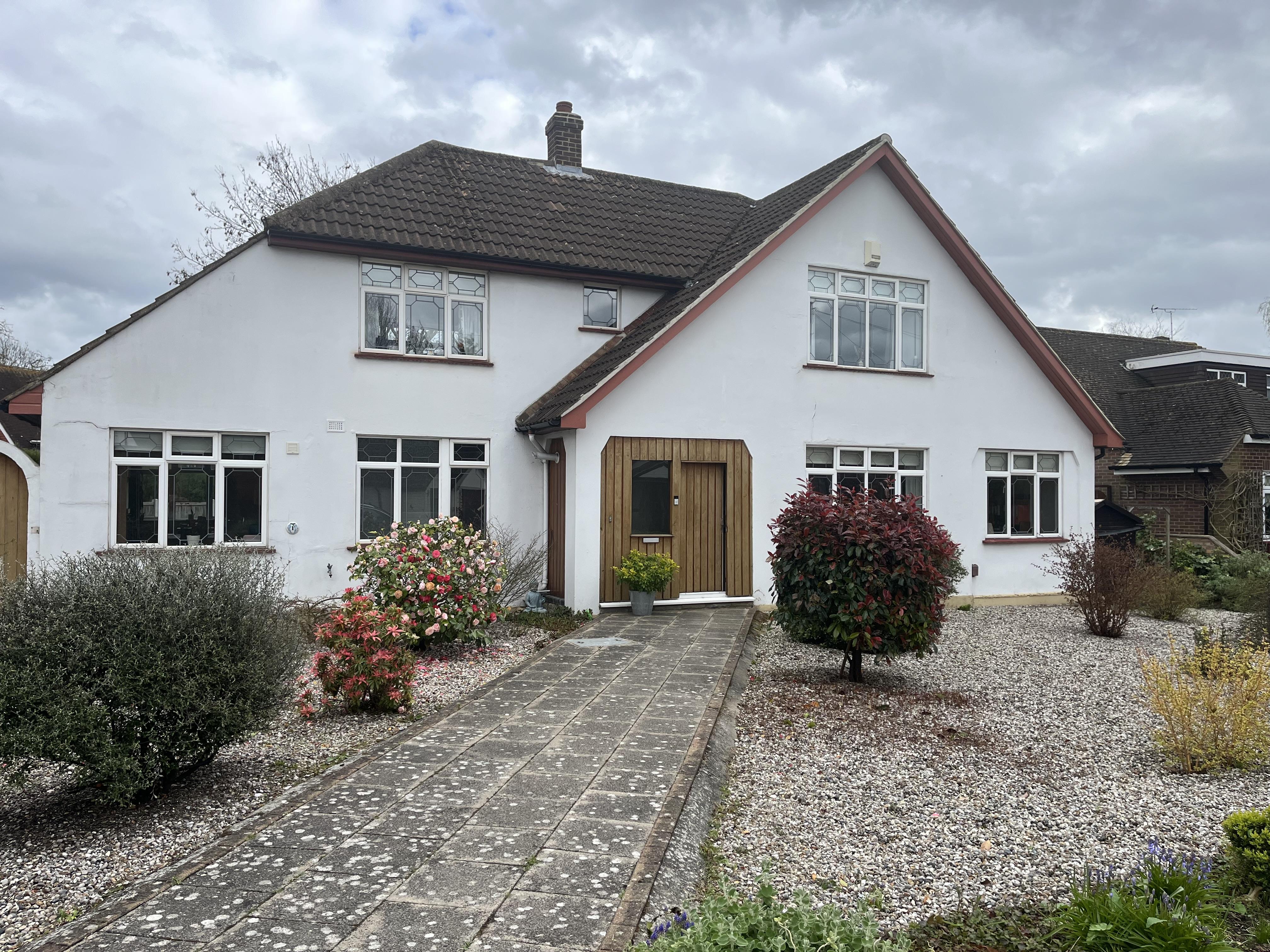

Front and back pretty much identical, the depth of property is 6m deep, going to have new front door but windows will stay.
Hi 1, Yes I can attach photos, no problem. 2, We are redoing all the interior, but some rooms don't have space to add internal insulation 3, Yes I will rewire the whole house and 90% of the plumbing 4, I can do that closer to start of main works. 5, I will have to get the exterior patched up and painted anyway by the end of the job. cracks filled and smartened and painted I will carry out but the outside insulation will be done by a contractor. I just wanted to know, as most insulation gains are gained from the first part of insulating and after that the gains decrease, wether once I had insulated the cavity, all be it if it's only 50mm would I really benefit from exterior insulation.
13.5" Wall, exterior walls including plaster on the inside and render on the outside, I assumed 2 walls of 4" wide bricks and 1.5" for the plaster and render and bobs your uncle, cavities are normally between 100mm to 150mm, on a 1950's built house there not always perfect so I was edging on the side of smaller to see the numbers. I haven't actually knocked one open yet so it may all change at that moment. Would you think I would benefit greatly from outside insulation after cavity wall insulation I don't think so. Want to try and be as green/environmentally friendly as my budget will allow really
