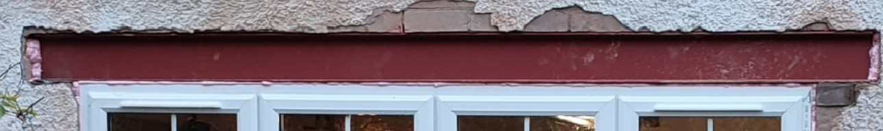

  2. @Nickfromwales I thought that it should have mortar all around and any need for the 2 rsj to be bolted?
  3. I was recently asked by a friend who had RSJ fitted into a new opening to put a window. The Builder/window fitter has filled up the end of RSJ i.e. either side with foam is this acceptable. This is on a outside wall which had 2 RSJ-one on each core of bricks inside and out.
