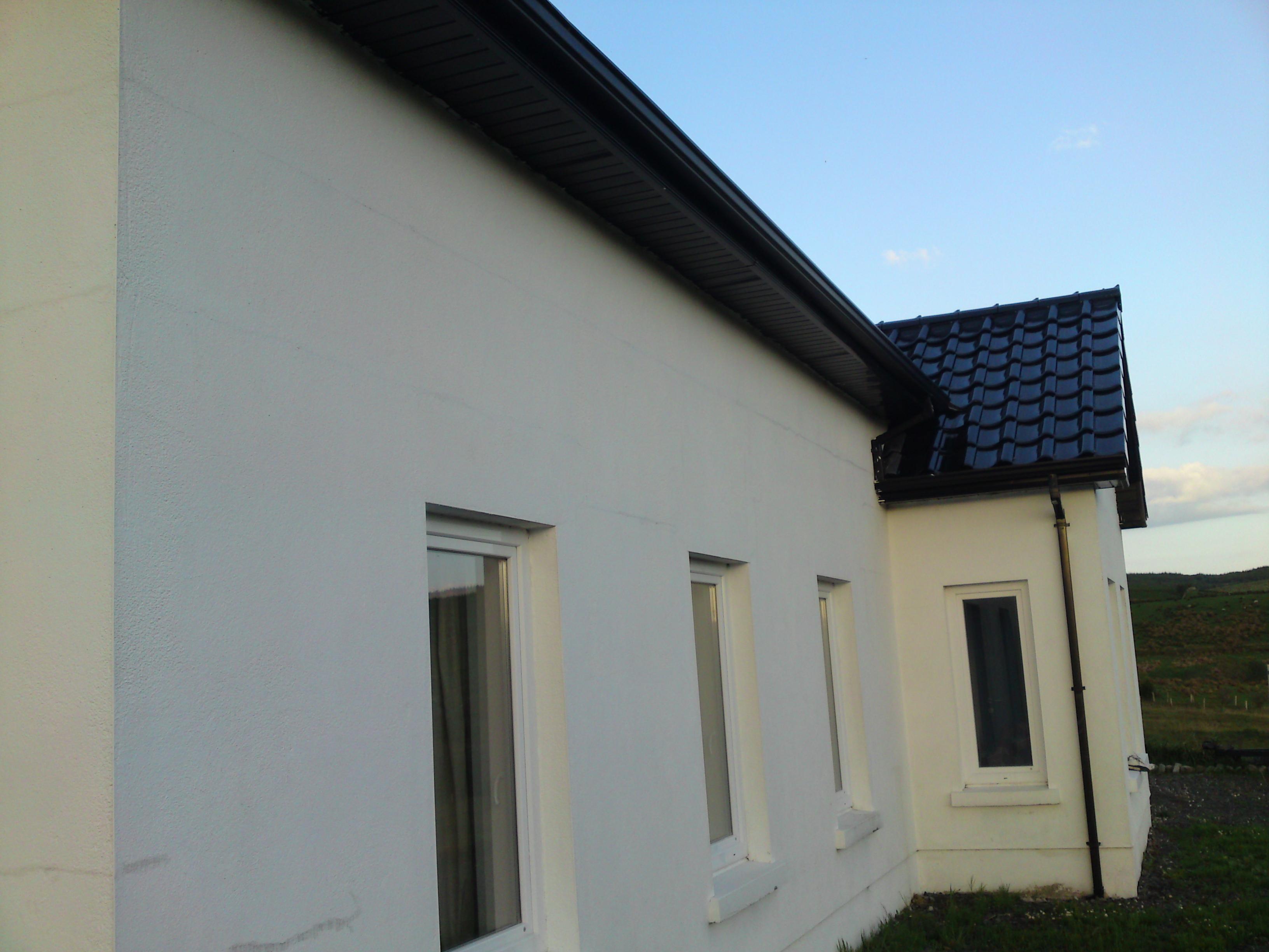

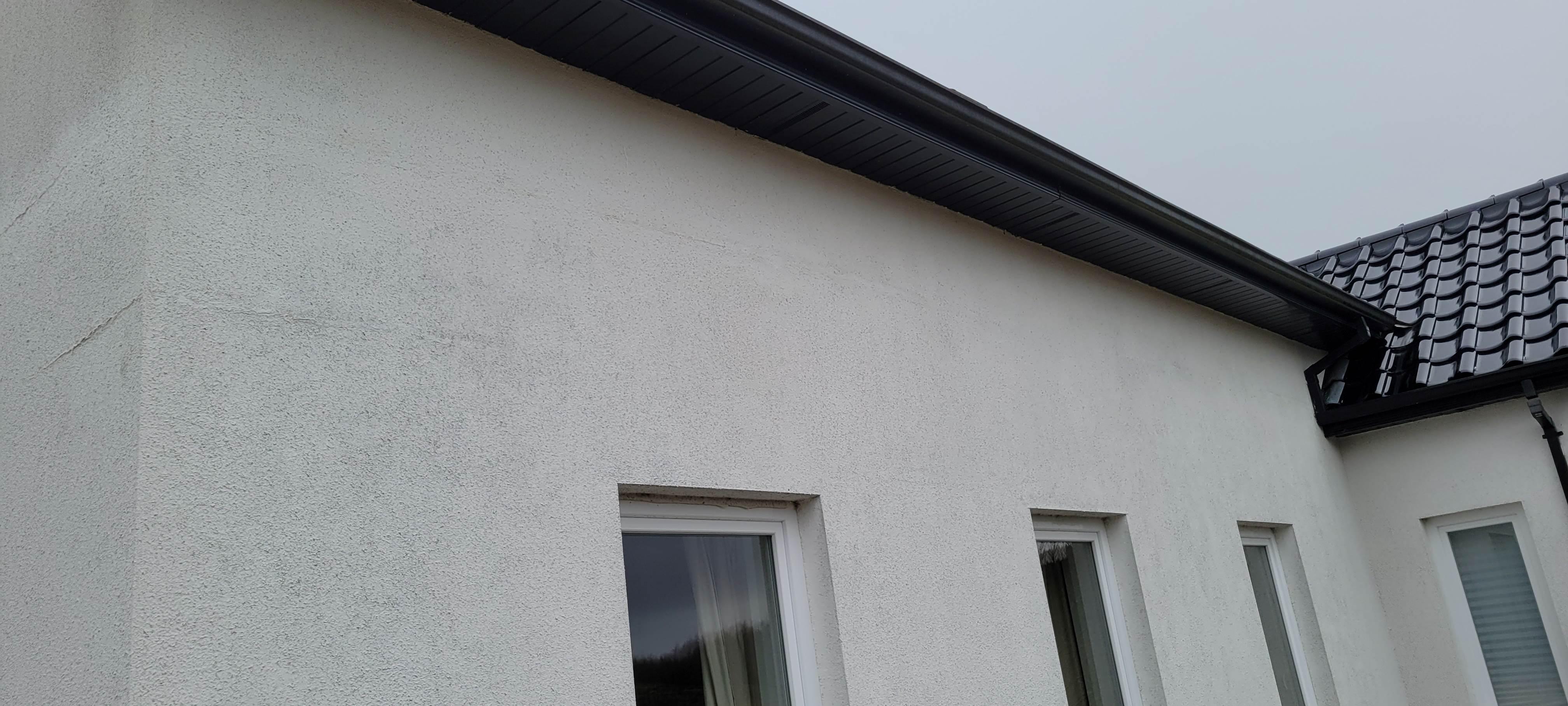

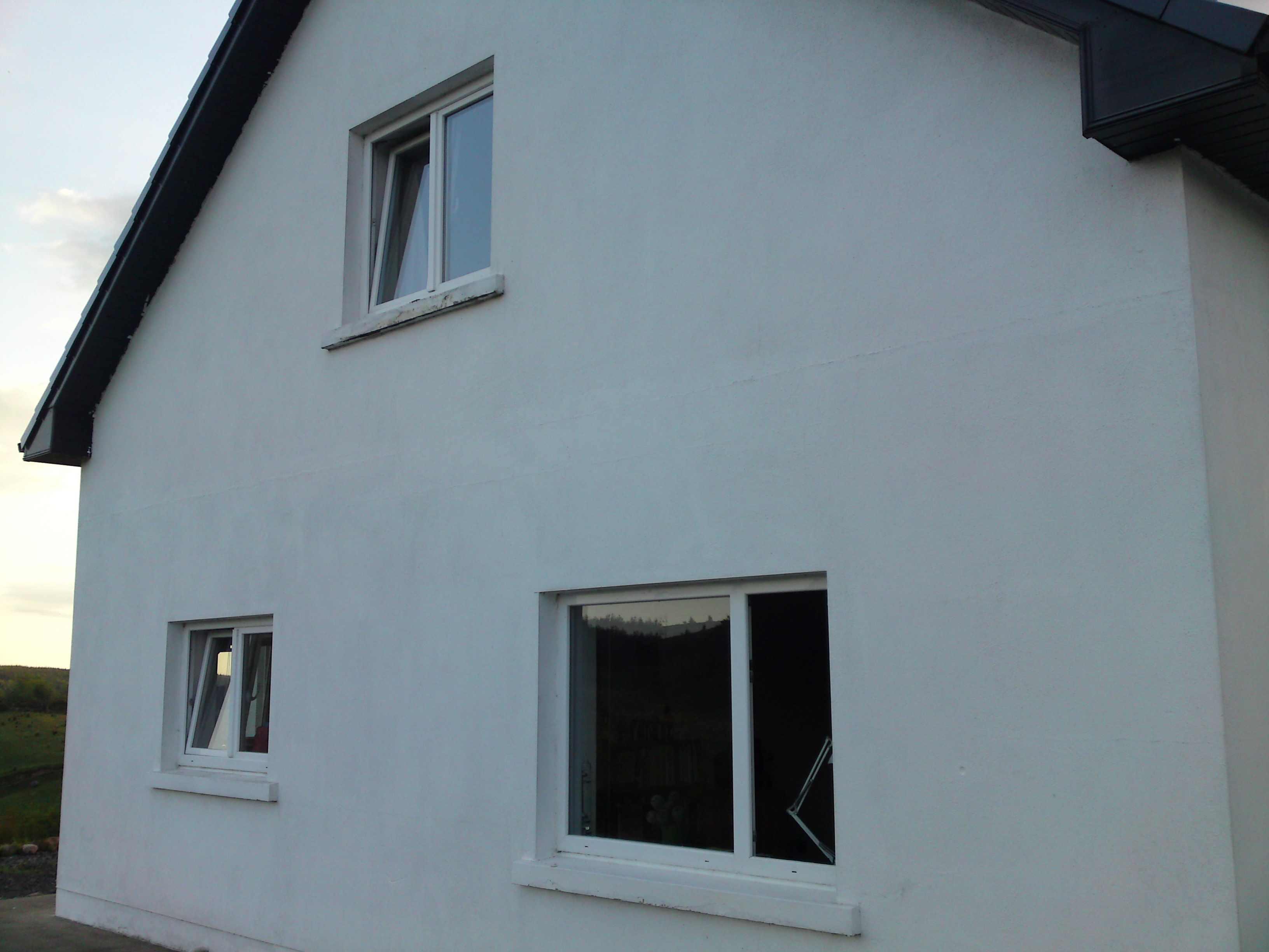

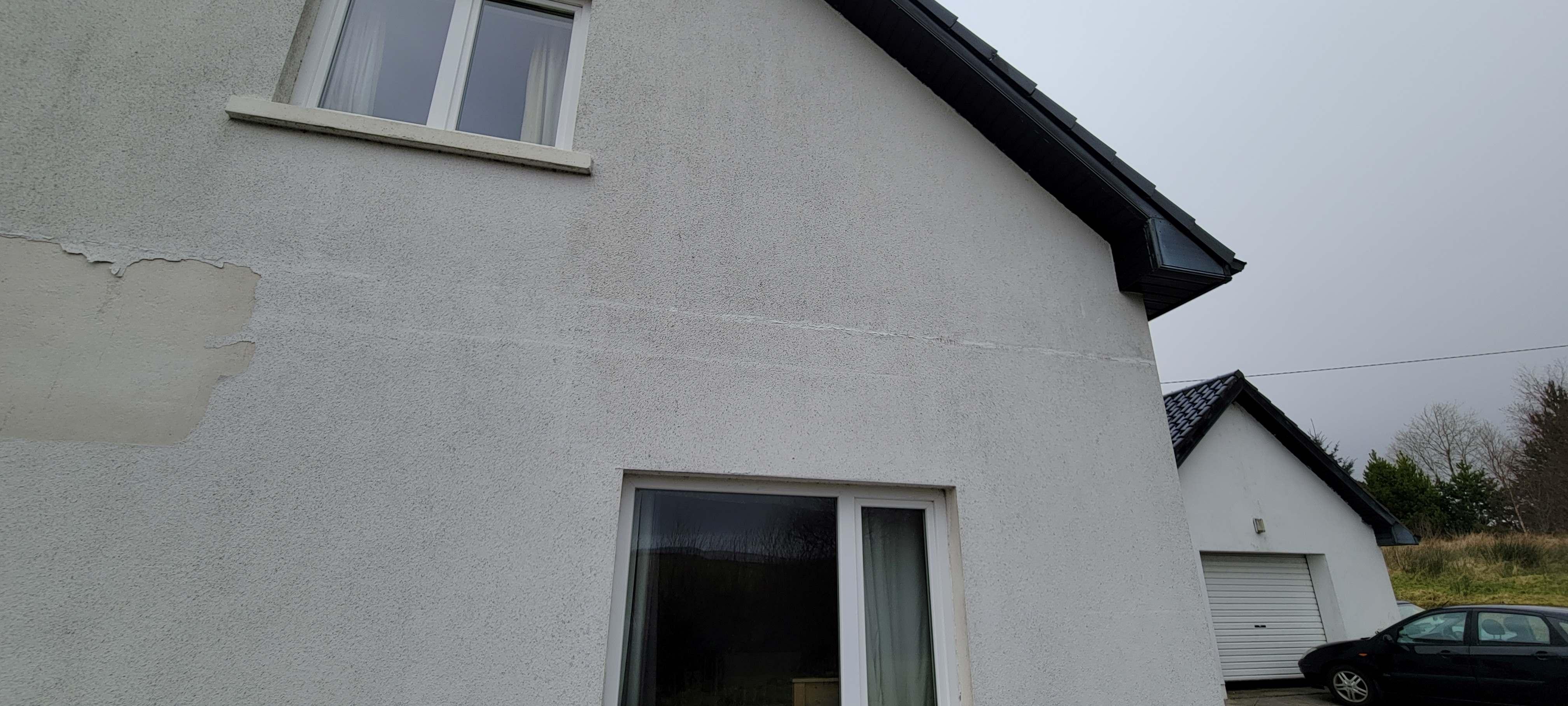

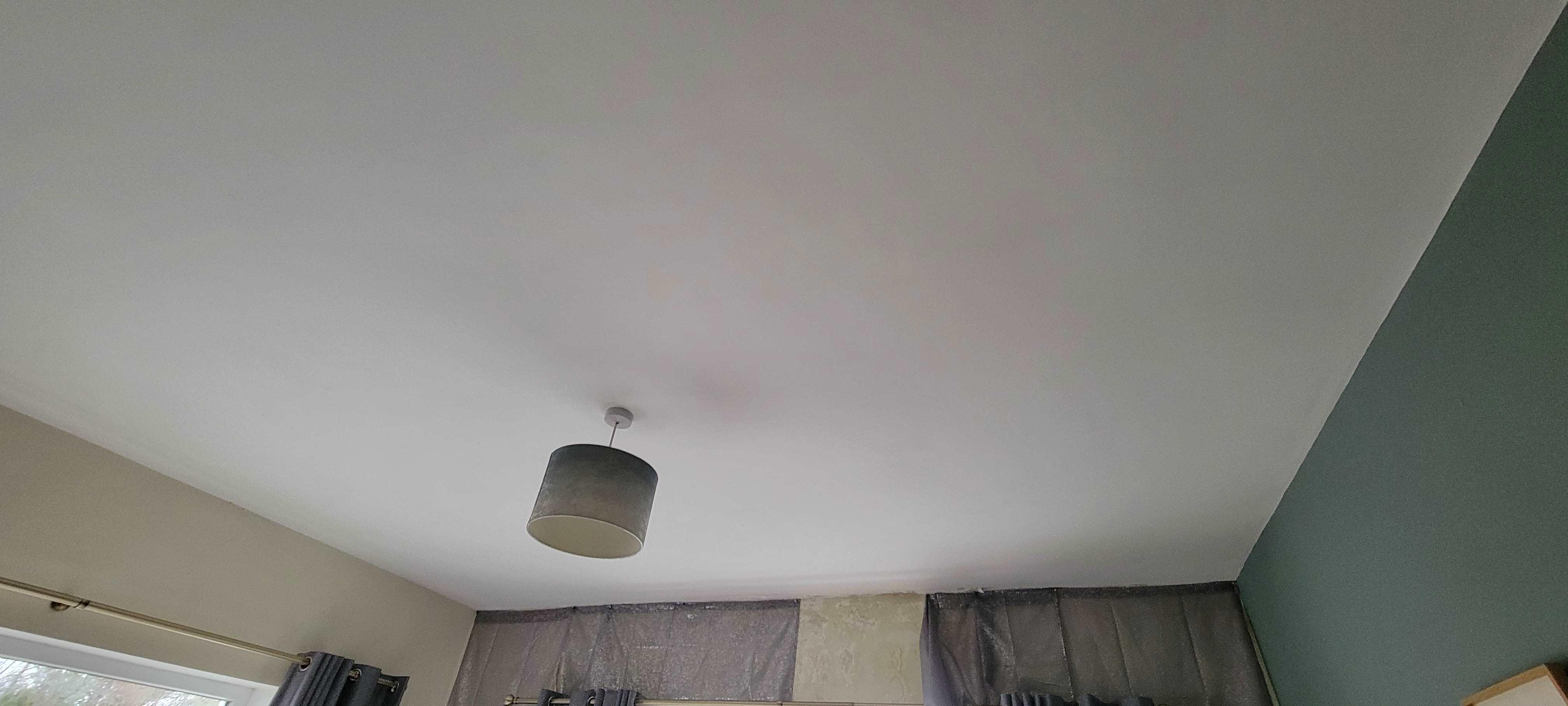

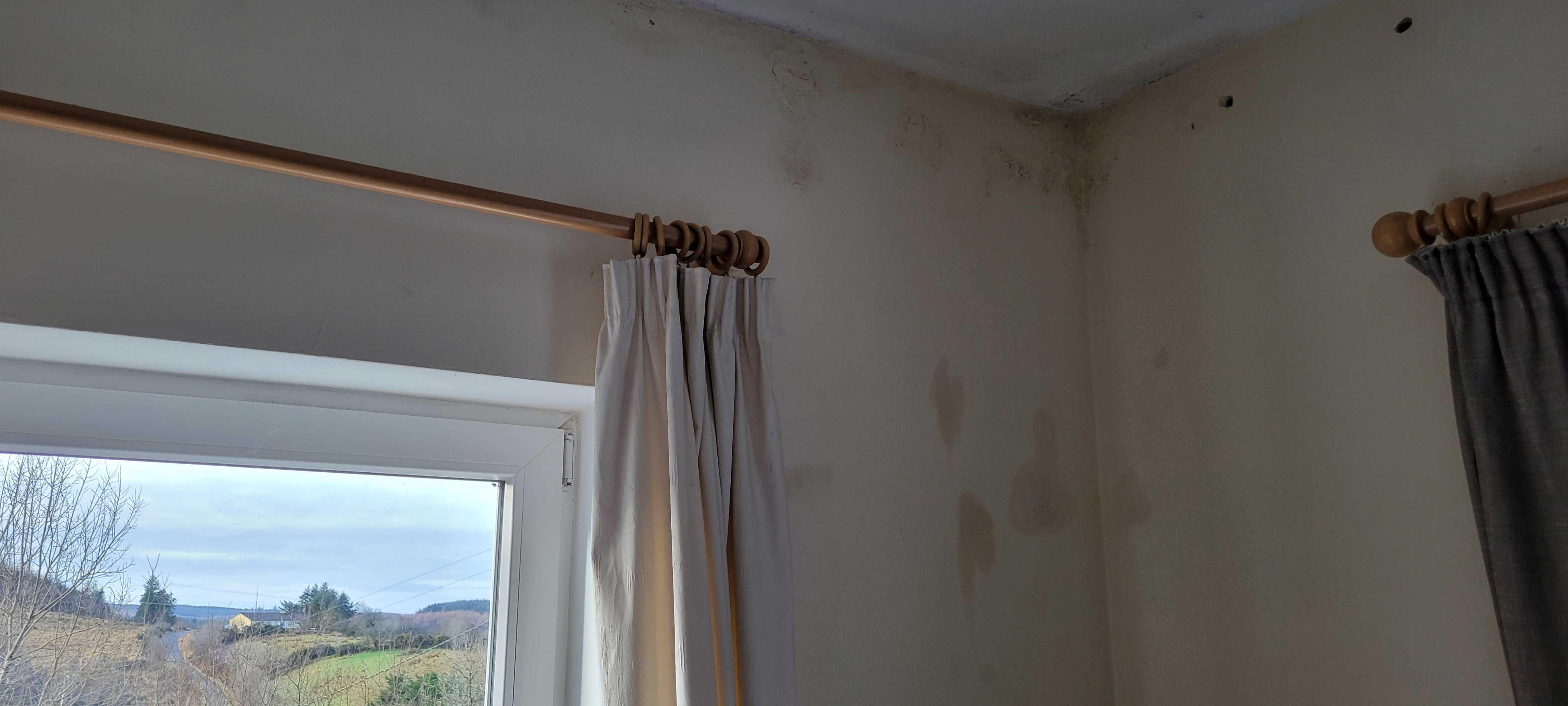

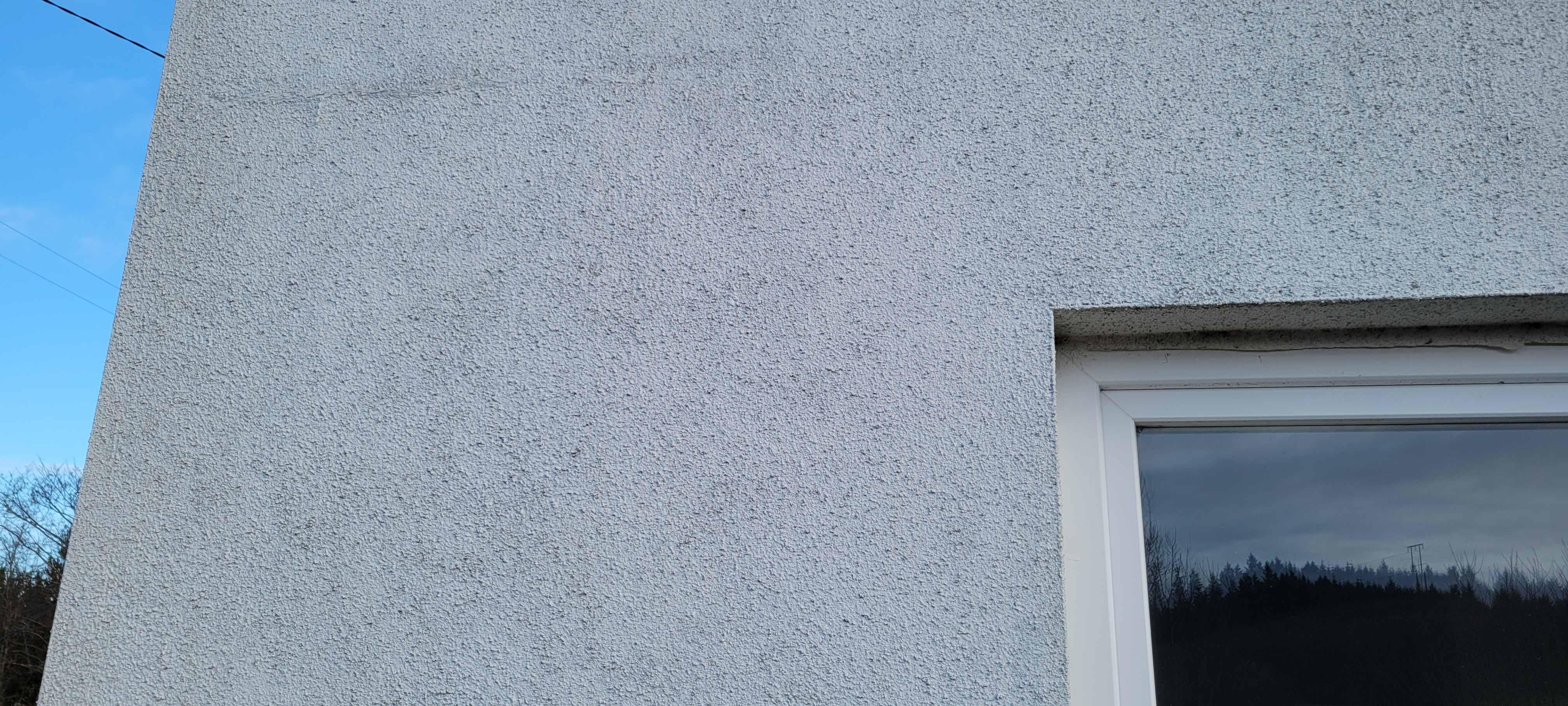

Yes house in Donegal, the house is quite warm despite the damp issues. Photos from pre Evertex time. First picture is the front of the house or south side Second is the east or kitchen gable end Third is inside of the south side Fouth picture is the Kitchen gable end- 31 replies

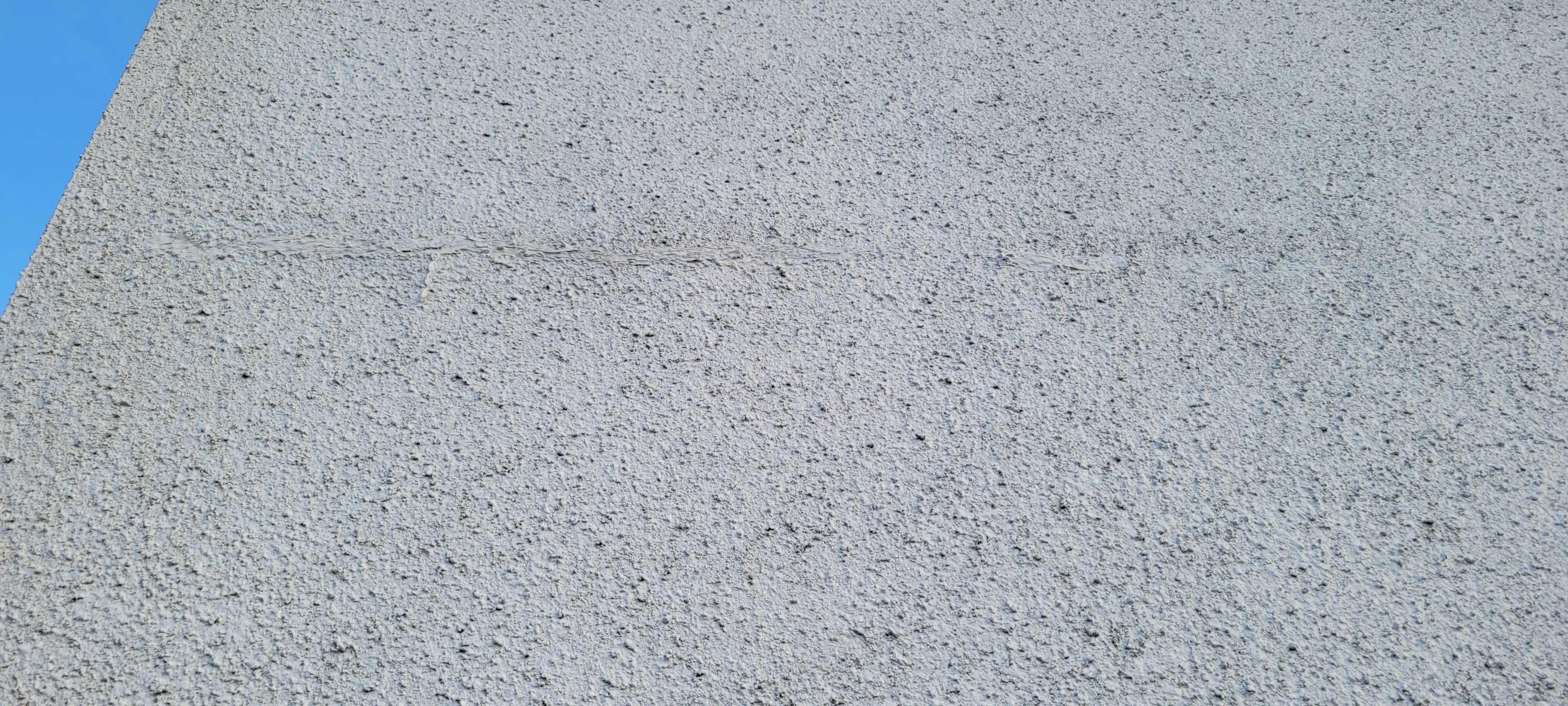

Thank you We have found old photos of the house before Evertex was applied. One interesting point is that on the outside the problems seem to be on top of the slab outside but on the inside it is under the slab. Is this of any help in diagnosing the problem? Is it simply gravity taking in the water on the weak joint at the top of the slab and flowing down and into the weak joint underneath the slab? Could there be a solution that involves repairing the wall outside ie the joint at the slab level on the gable wall? One suggestion I got was to strip a 40 cm section across the gable at the joint level and repair the problem in this way, to do something to stop the cracking of the wall. reinforce it in some way, mesh and lead were suggested. Thank you- 31 replies

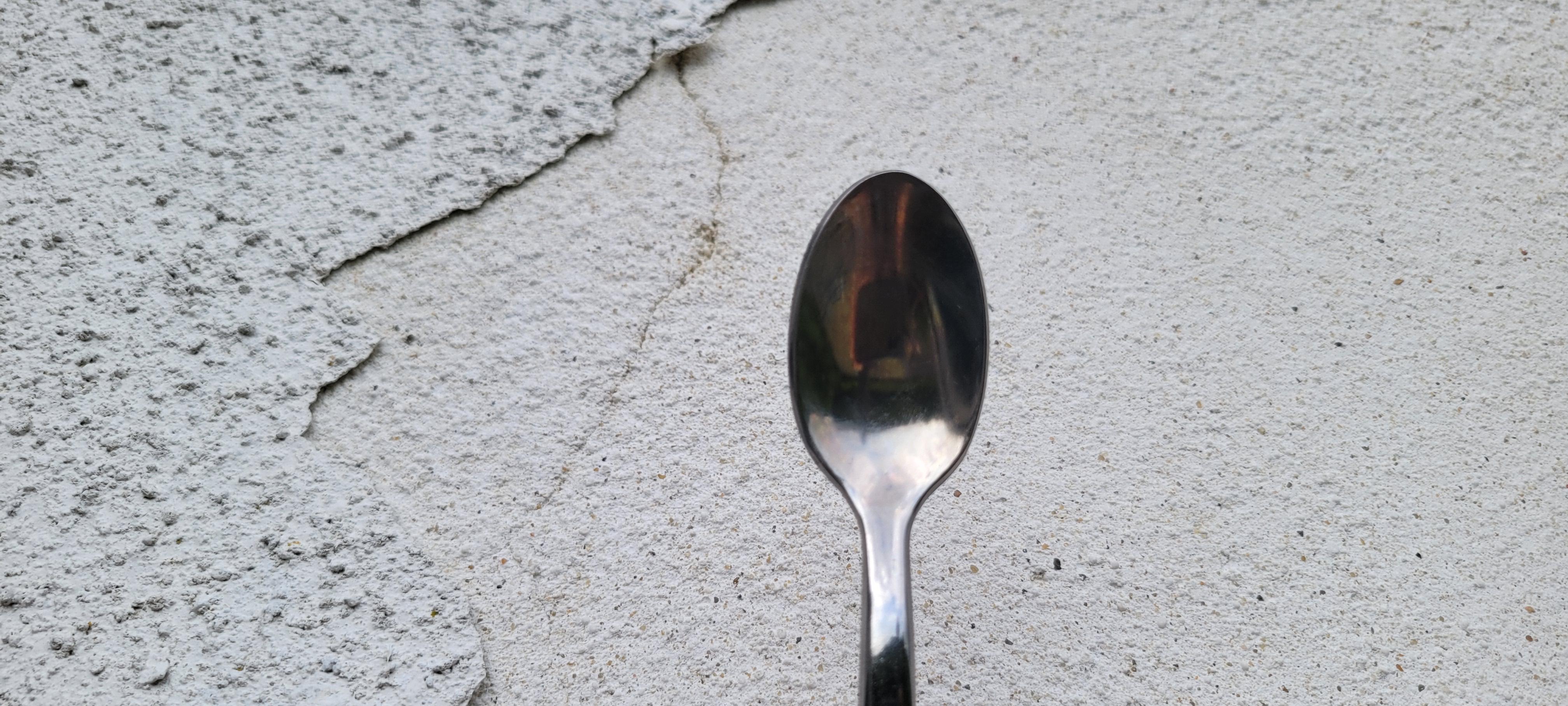

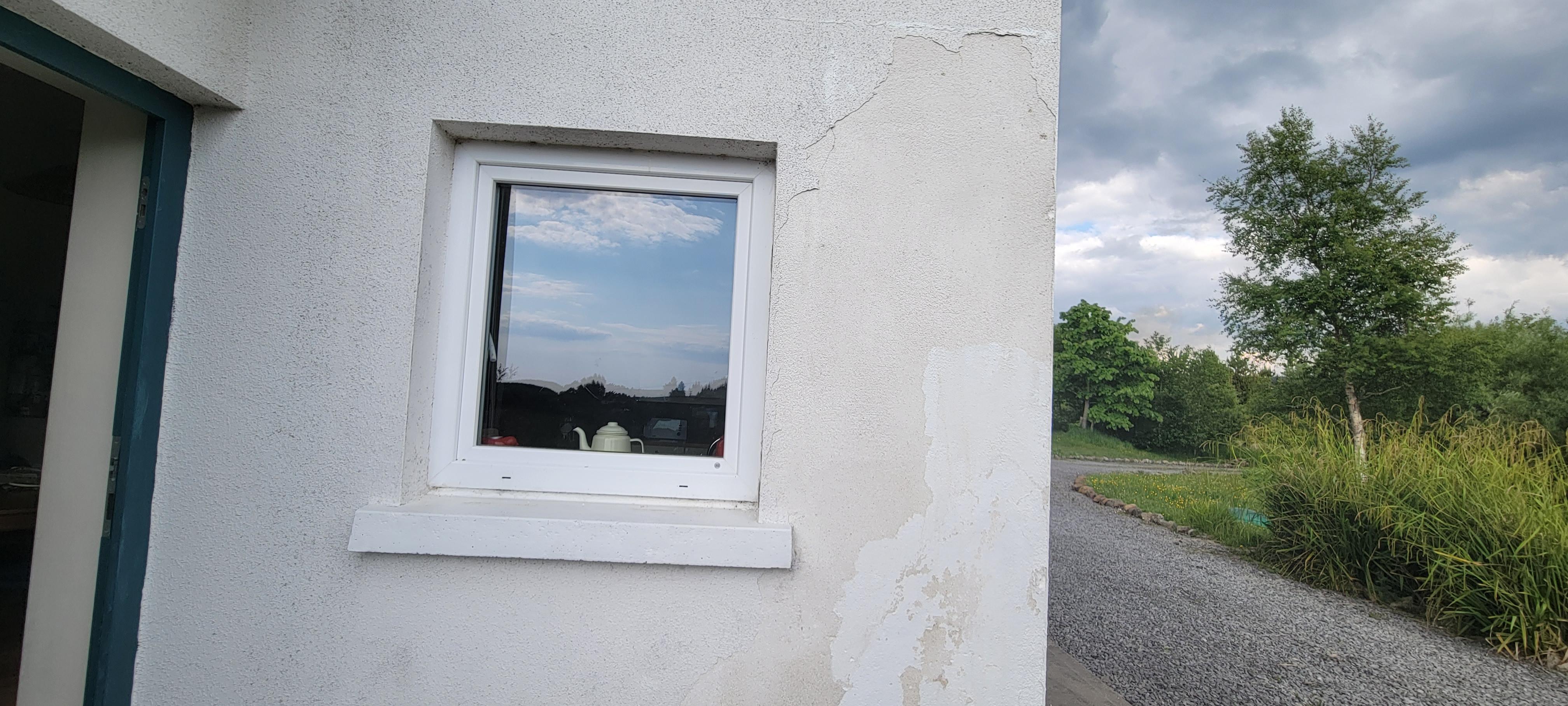

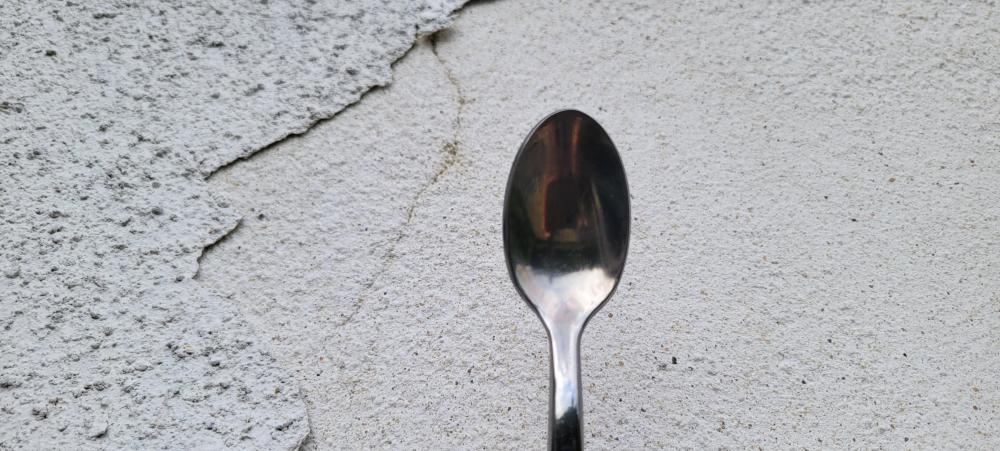

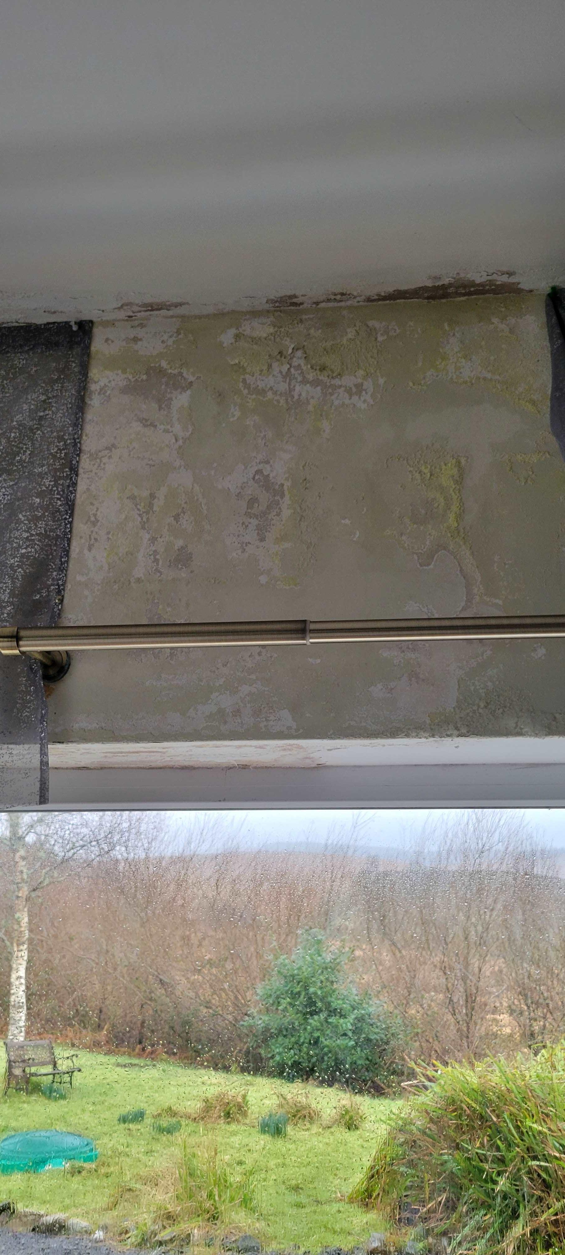

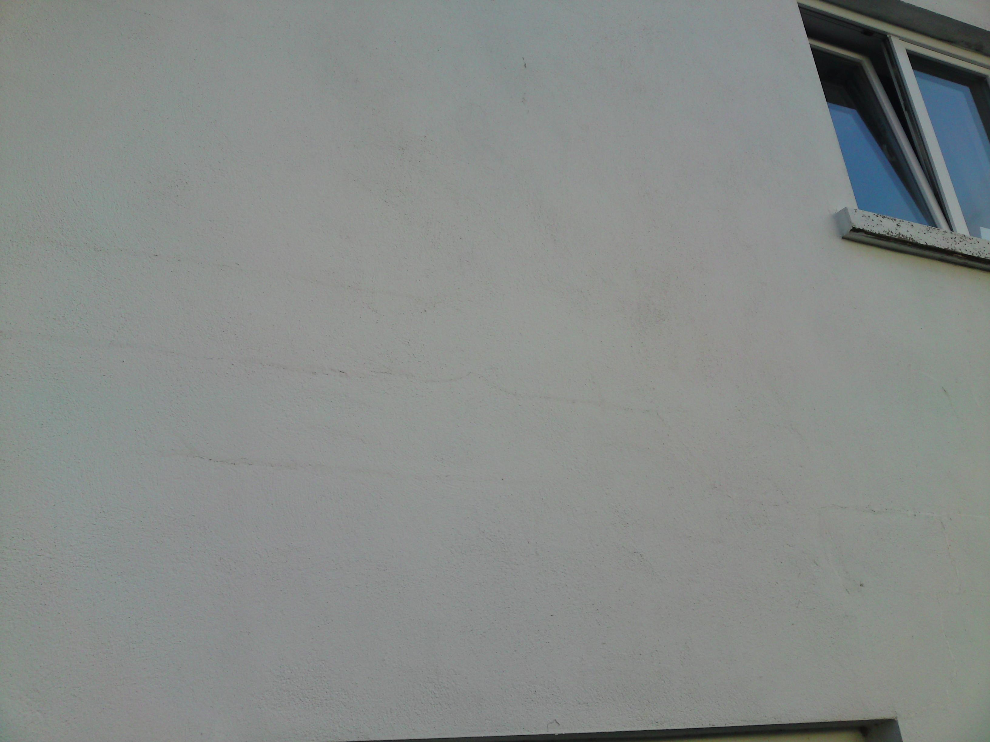

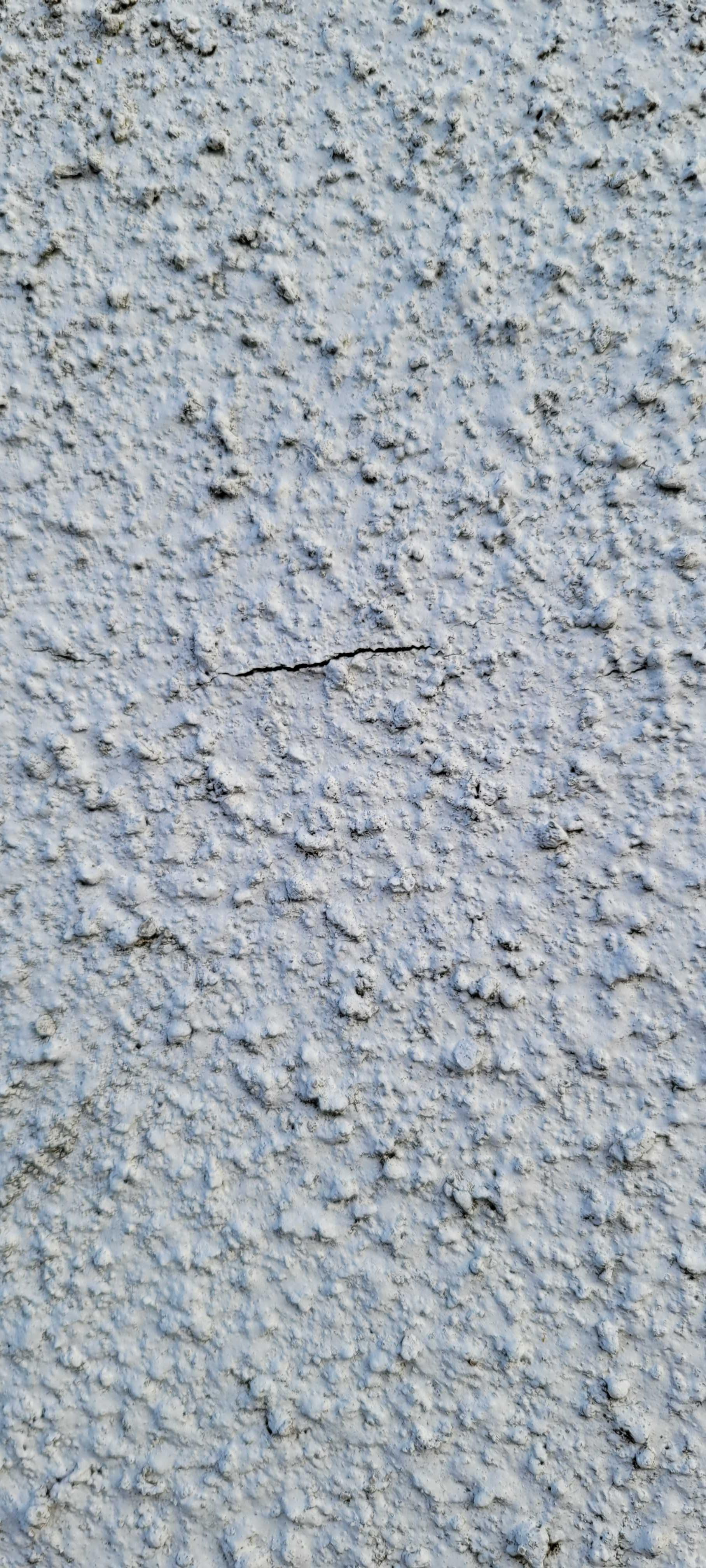

Thank you so much again for all the information in your reply 1. The paint used inside is plain emulsion ie not satin or plastic finish. 2. No extractor in the bathroom we just open the windows 3 I have 2 fireplaces which I use regularly in winter time .. not morning till night but a few hours each day 5 days a week approx 4. The picture that you said was most worrying is how all the patches started. 5. There is no plasterboard on the ceilings just plaster. 6, Pictures below show the outside of the wall The close-up show a crack in the Evertex which rain can come in. Above that was a previous crack in the Evertex which I filled with silicone 7. As the proton blocks are probably more porous than cement blocks (?) I had imagined that the crack on the outside plaster regardless of the cause of the crack is now the main culprit of the water coming into the house? Many thanks Catherine- 31 replies

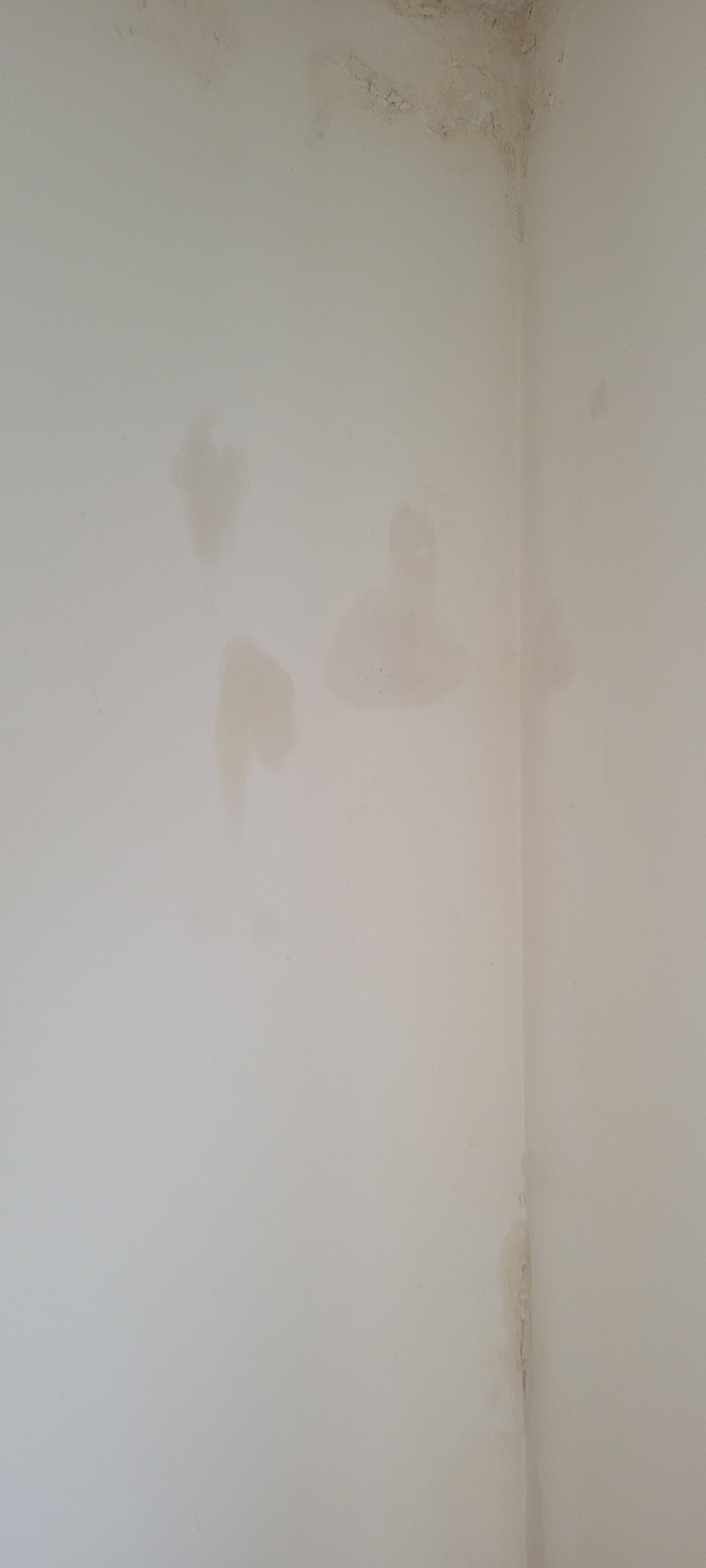

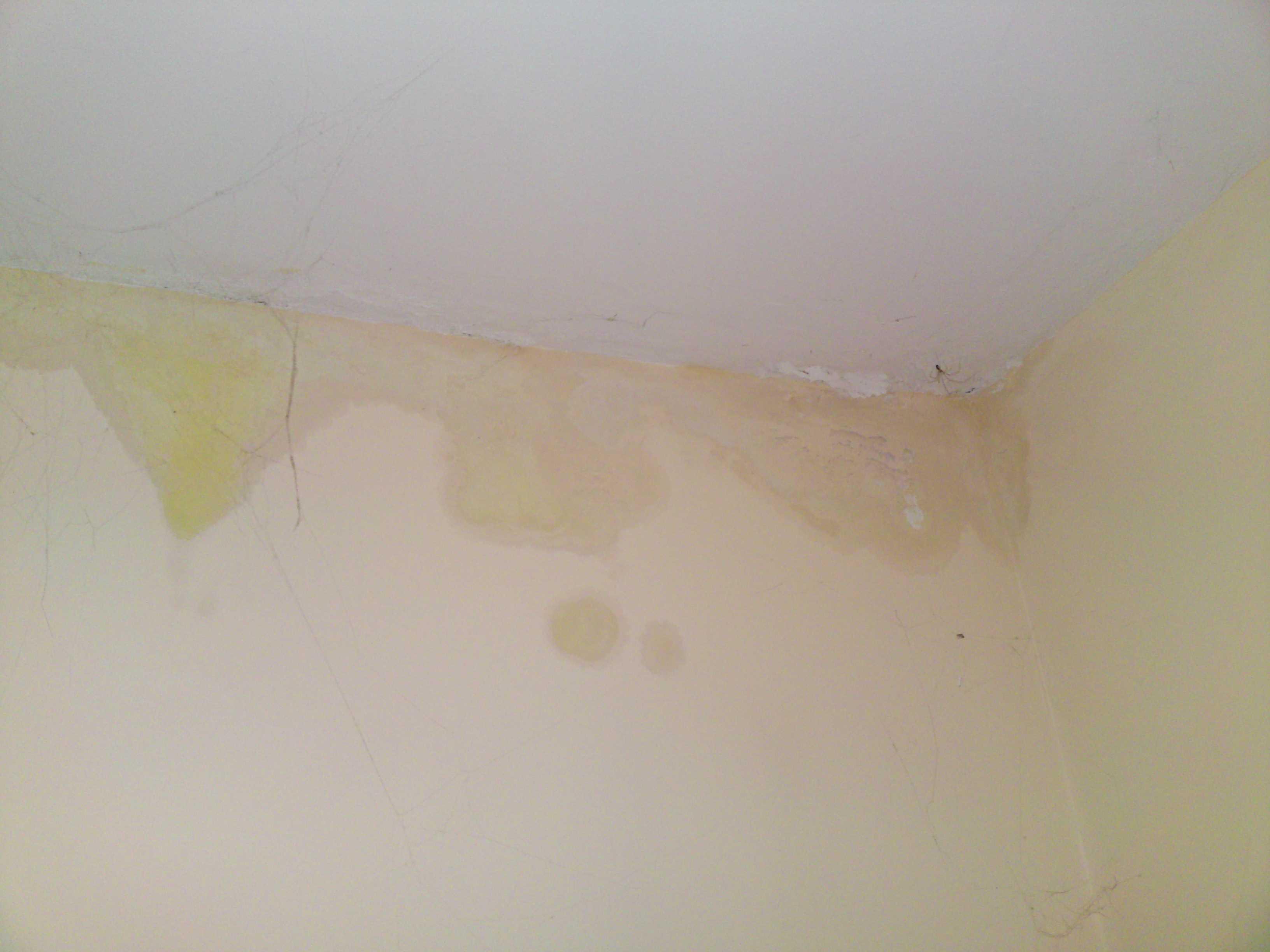

Thank you very much for all the great information in your reply. So to answer your questions- I dont have a mechanical ventilation system I moved the hygrometer around and to my surprise the bedrooms were higher than I thought ie at times almost 70% The problem was not ok before Evertex. We were searching for a solution and thought Evertex might help, in hindsight we now know it was not. I have attached a few pictures to show how the problem started appearing ie in the first picture and then how bad it actually is now.- 31 replies

More questions arising from Iceleverage's post 1 “When airborne vapour escaped from the interior of the house via air leaks it got to a point in the wall where the temperature fell below the dew point, the vapour condensed to water and as it couldn't dry out it soaked into the original line render, diluting the adhesives of the lime and it fell off as you can see. My question: Re the airborne vapour, if and when if condenses to water would it now follow gravity and move down inside the honeycomb poroton block? 2. My theory is that insufficient air sealing was done below and above the first floor slab. There was an easy path for indoor air of high humidity to pass right through to hit the back of the render. Here it cooled and condensed into water. As the original lime was of high permeability, the condensed water was ultimately able to dry though it to the outside so damage was limited. My questions: What do you mean by air sealing? It is true that the kitchen is just inside this wall but above the slab is a bedroom with low humidity. However when the Evertex was applied the water couldn't go anywhere, it soaked into the lime render and then you had problems, gravity did its part and the water migrated down the wall destroying the render below the slab area too. My question or rather my assumption was that it was the driving rain that made its way into the hairline crack and then migrated down the wall? The almost perfectly straight fault lines in the render are my evidence of air leaks combined with the impermeable paint being the issue. I would almost certainly rule out differential expansion of the slab and walls as they are similar materials, and the distinct two lines at slab level rather than a complete band point towards air leakage rather than a thermal issue. My question: The slab is concrete and the main walls are poroton ie terracotta so they are not so similar? I am not 100% sure what you mean by air leakage ie that the block on the outside of the slab is thinner that the blocks of the main walls? Again thank you so much Catherine- 31 replies

Thanks so much, I have attached some photos here, danke! Thanks very much for your post, I have attached some photos above under my description and also a link showing the ceiling construction. I think my main problem could be the expansion of the ceiling slab/ and the lack of adequate insulation outside the slab ...- 31 replies

Hi all, I am an unwilling renovator! I have an issue with my German style house, comprising of proton blocks, Lime plaster with a porothon ceiling topped with a slab of concrete. One of my issues is that the concrete ceiling appears to be causing a crack in mainly the gable end walls. My first question is - does a inside first floor concrete slab need to have expansion joints in it? The size of the slab ie 14 m x 8 m. Also it appears that the Lime render applied was not suitable for the driving rain in Donegal and that I may have to replaster some sections of the house. I would love some expert advice before I ask local builders who will be unfamiliar with my building materials. Thanks so much for looking here
