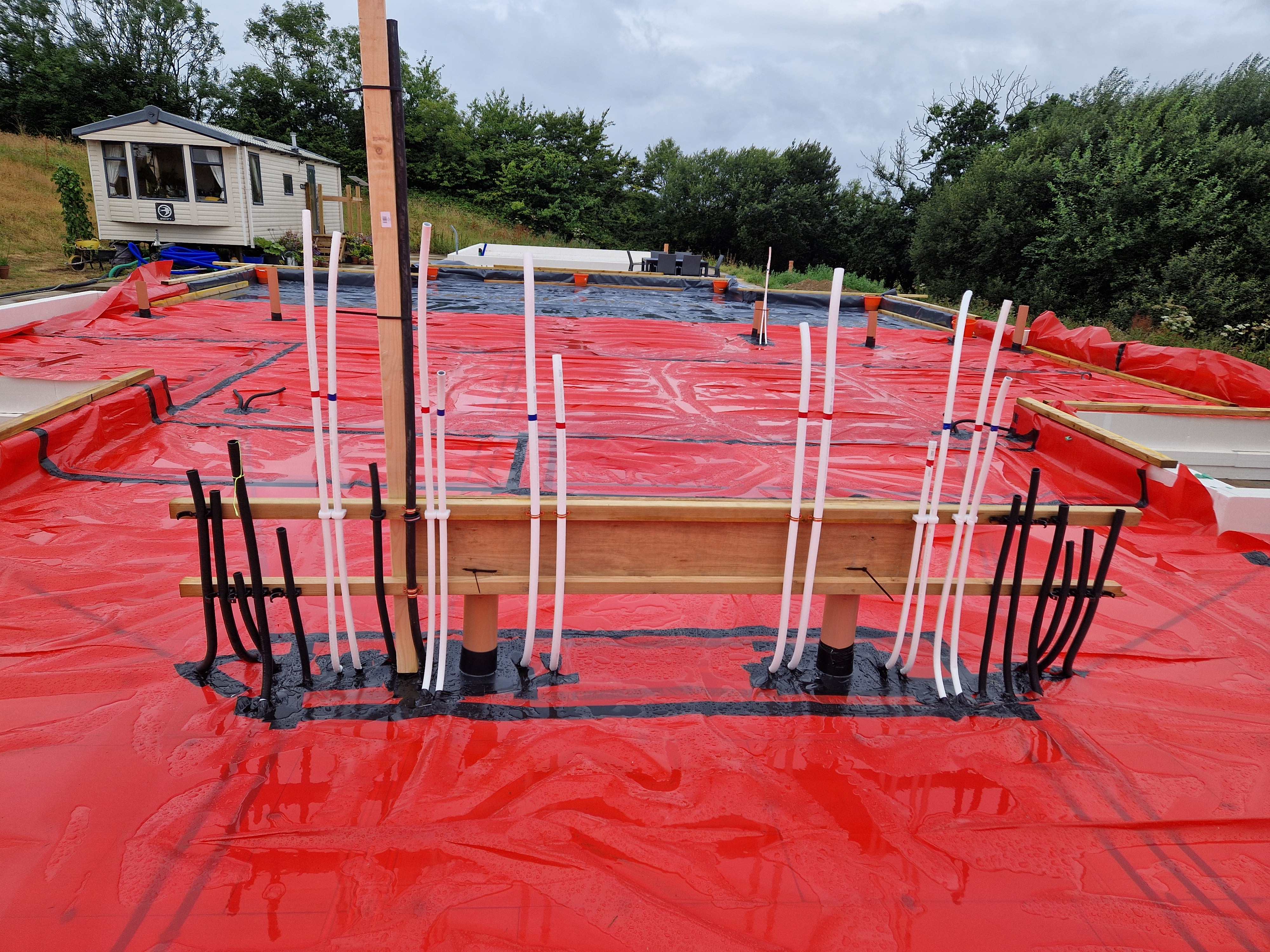

Here. Left pipe is the hot return (from the local ensuite hot manifold) middle is the hot feed (now run in) and right is cold feed. All 20mm Pex-al-pex. This ensures hot circulation at the main manifold (center of the house) and therefore short runs from there to each en-suite manifold.

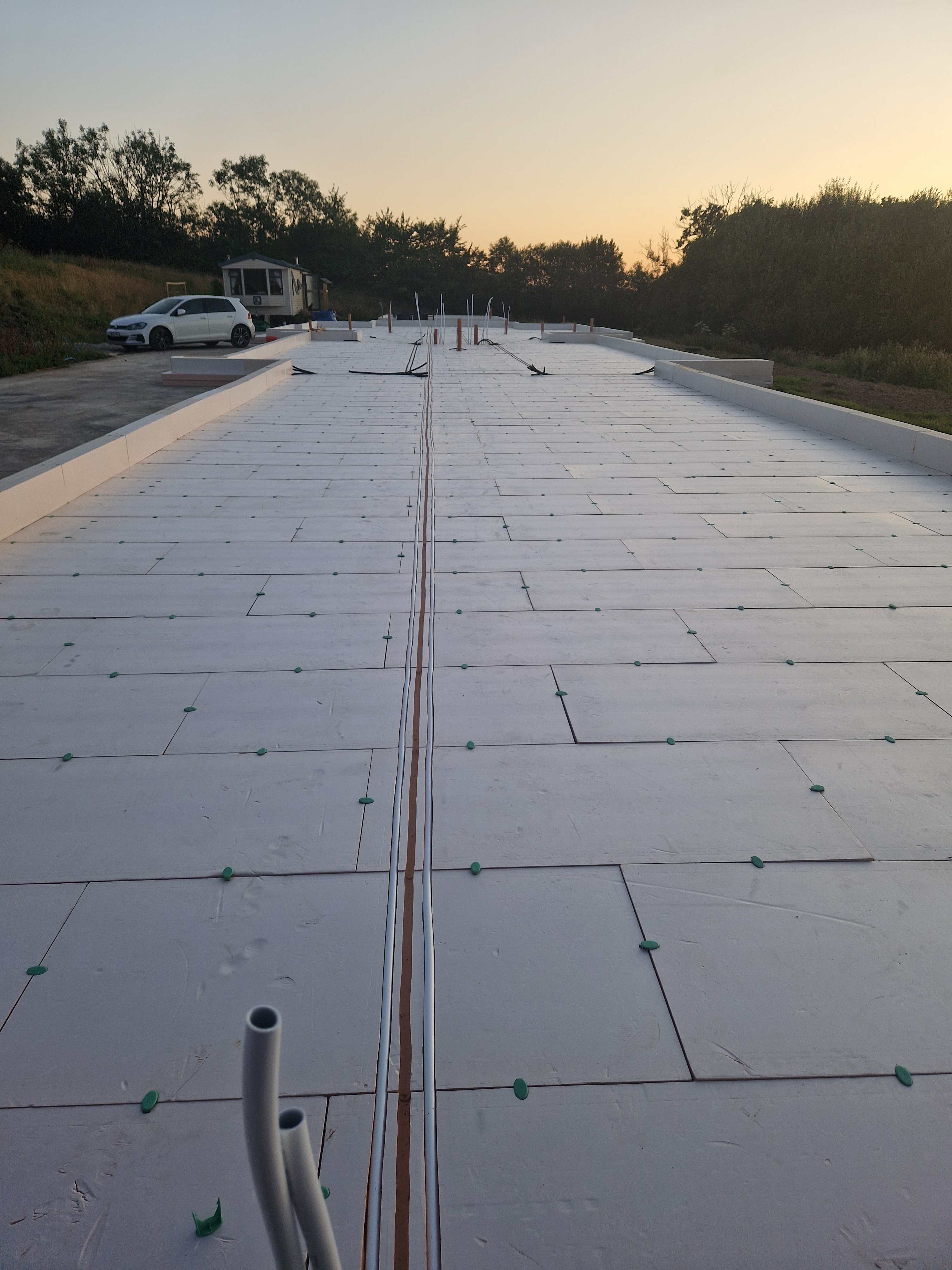

Its Sopera XPS. Interesting stuff to work with. I've bought a hot knife gun and have routed all the first fix pipe and conduit into the top of the insulation.

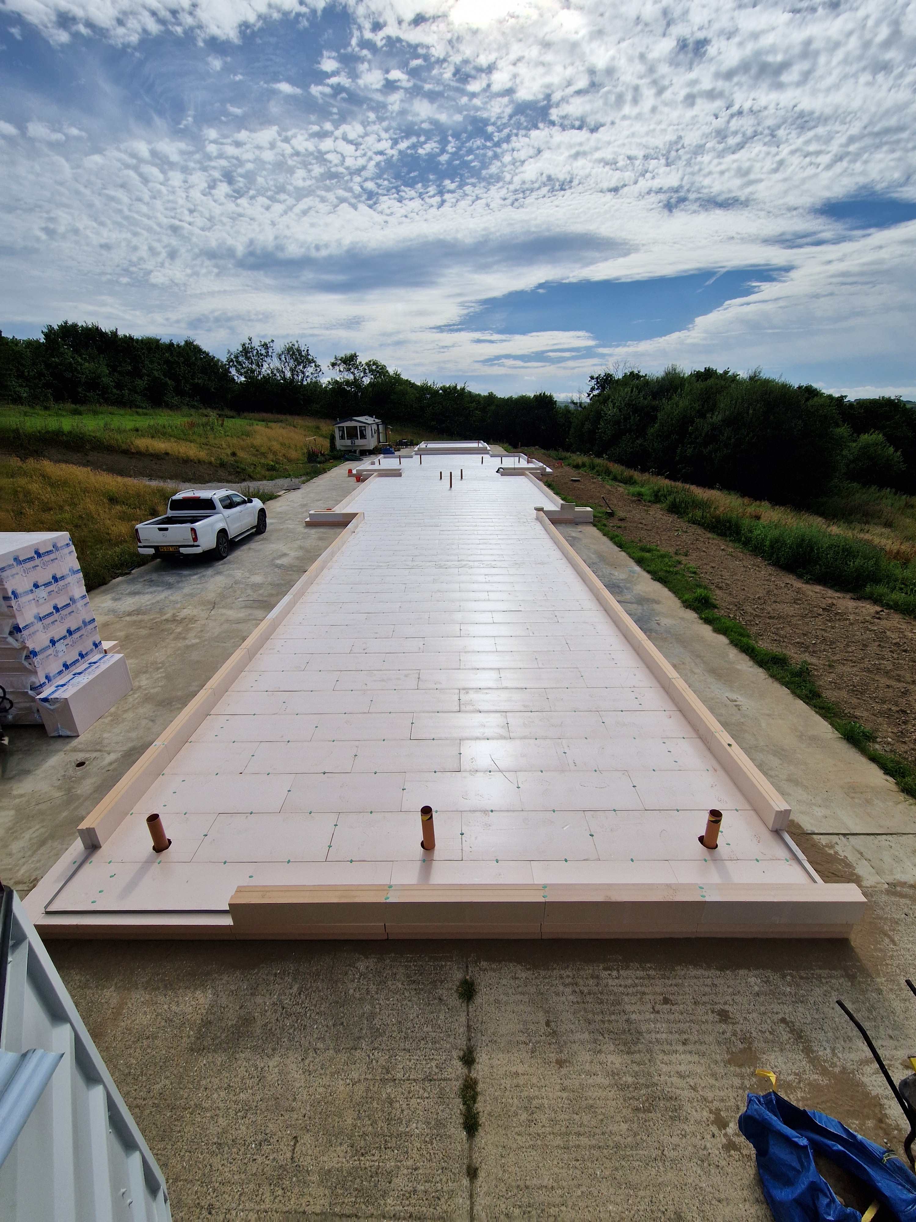

Sorry Gents, stepped away for a little trip. Back now. Yes Nick, 200mm of XPS under. On top of the existing concrete slab, that we're treating as subbase. Then a flat 250mm reinforced slab. This detail should provide more context it's the same section of H-H but without the reinforcement detail. Also an edge of raft detail to bring more context This is the GA for those that are wondering about shape and size of building. I'm definitely leaning towards clipping to the top mesh. Giving this some more thought it makes life much more simple and I'm sure there will be very few occasions where i need to drill the slab, so.... Thanks
