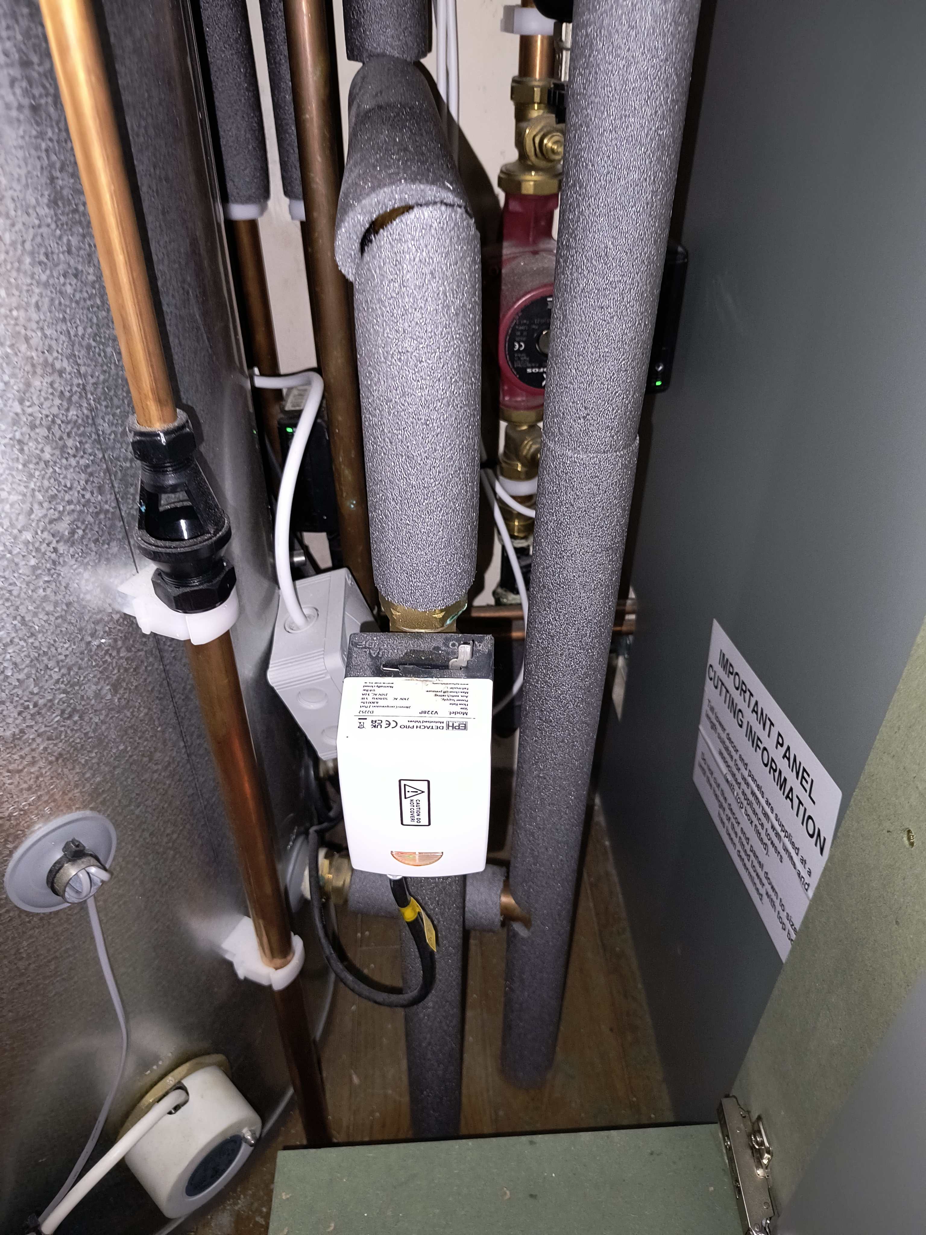

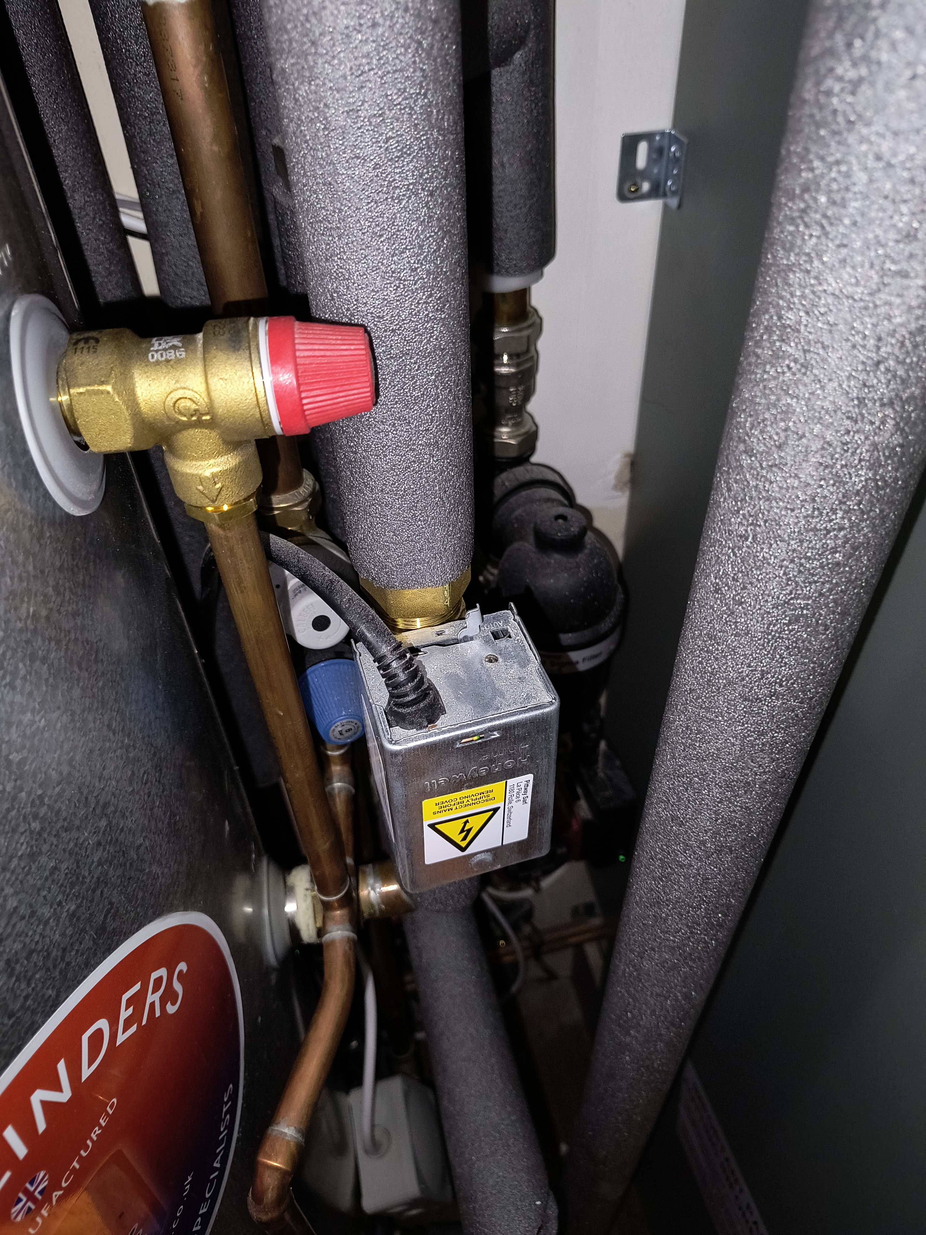

It is helpful thanks, though I think I'll definitely need someone to have a look. For a gas boiler it's quite easy, I would just need to get a gas certified plumber out, but for a heat pump it sounds more daunting. I've added two pictures, which I think are valves, do you know which one would be the one potentially related to the issue? As per the controller, I think it wasn't something major, just adding the wifi device so I don't think it changed anything.

Hello. I've noticed from our melcloud graphs that every time the heating is on, the DHW heats up too. Which I confirmed by touching the flow pipe going into to the cylinder. Is it normal? I'm worried it's affecting the performance of the system and costing us more than it should. We have a mitsubishi zubadan 14W and a unvented cylinder. Thanks in advance for any advice. N.B. the company who installed the system less than a year ago has folded so it's not an option to come back to them.
